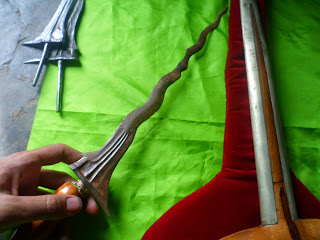

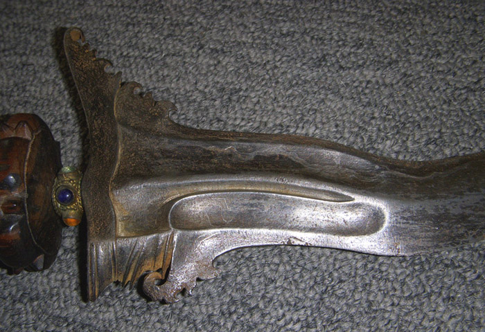

Happy New Year group, can I have help understanding what I'm looking at? I don't see a pamor.
Thanks

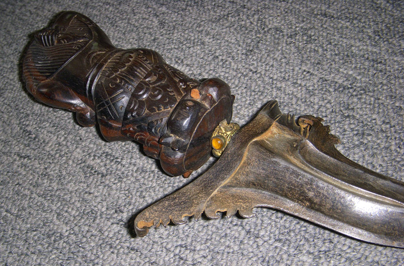

Cal, this is a Bali keris and therefore Indonesian and discussion belongs in the Keris Forum for this so i am transferring it over there.
I see pamor fairly clearly. However, this blade seems like it is a bit overdue for a cleaning and a re-staining with warangan. What you must understand about keris is that pamor patterns are raised on the surface of a keris through acid washing and treating with warangan, a mixture of arsenic and lime juice. The pamor on this Bali keris is merely faded over time and it needs a new treatment.
You should also keep in mind that not all Indonesian keris carry pamor. These keris are referred to as "kelengan".
BTW, this looks like a fairly decent Bali keris that has been dressed with a very low quality hilt usually associated with souvenir pieces. I would also think that this might very well be a late 19th century blade, though early 20th century is also possible. But it does not look like contemporary work to me.

I was wondering why I couldn't see the Pamor. I was looking for keris like it and came across Sardulo Mangsah. The description side the pamor doesn't come all the way to the top in this style keris.
Thanks for your response

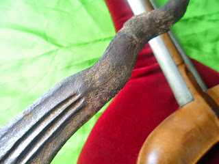

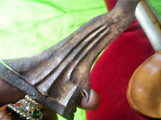

I just found this. What metal is this made from?

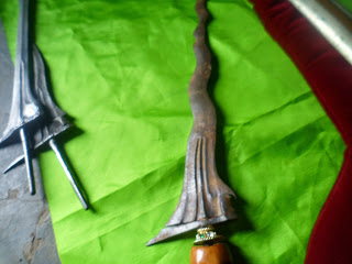

I'M not sure if my other post came through, but this one seems to be the same type. Do you know what it is made from? I read that railroad track is some times used in making keris.

Hello Cal,
You're making sure not to show keris that are currently for sale, aren't you? (If not, this should be taken to PM/email - a general rule to protect the forum.)
This is an uncleaned blade that is completely out of stain. You just can't expect anyone to give you a defensible answer on what it was actually made from, especially without being able to examine it personally under magnification...
Sometimes even from the worst ePray pics, something can be guesstimated and you can then decide whether to place a bid but this is still very much a gamble, even for experienced folks (and some even more experienced folks don't buy pieces they haven't examined personally). Vague hints in the pic of the middle section of the blade may suggest that this blade is probably laminated; obviously, it has lost a lot of its substance due to erosion from rust and repeated cleaning and/or warangan treatments - it's pretty much a ghost blade which will probably show some remaining patches of pamor; it's quite possible that the pamor left will be quite disappointing though.
I'm not sure what you mean by "same type" - the keris posted first is from Bali and the second from Jawa; one might argue that you're already comparing oranges to lemons...
The only similarity I see is the extension of the kruwingan to the end of the sogokan; note though that the Bali blade only has a single sogokan while the Jawa blade has two.

As Kai has pointed out, there is no way of telling the source of the iron for the last keris you have posted here. It looks like a keris of some age and one might well find that pamor was indeed used in it's manufacture. But when a keris is out of stain, as it is often referred, sometimes the pamor cannot be clearly seen.
But the Bali keris does rather clearly have pamor and the pattern can be seen if you know what you are looking for. Still, some keris do have no pamor at all, called keris kelengan. Whether a keris has pamor or not is not necessarily an indication of the quality of any particular blade.
