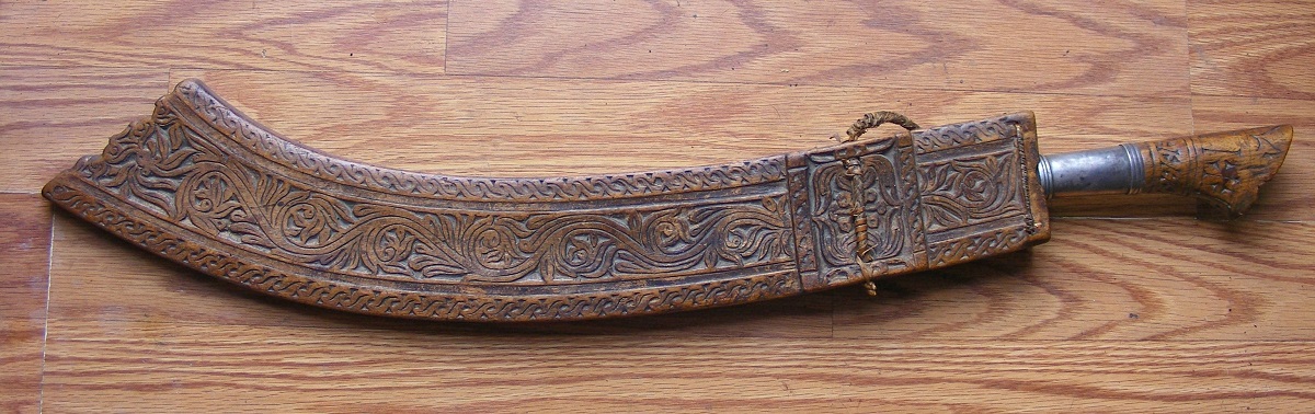

Hello All,
Some time ago I was fortunate enough to secure this rather nice Parang which I am confident originates from Borneo. My assumption is based mainly on the carvings, which are very similar to those illustrated by Banks (Sea Dayak Carving). I am, of course, no expert and am happy to entertain another origin if sufficient evidence can be provided.
The only other similar example I have been able to find on the forum is this one:
http://www.vikingsword.com/vb/showth...y+type+panabas
In that thread there was some discussion of these being a Moro weapon/tool, which doesn't sit well with my (albeit limited) knowledge. I would greatly appreciate forum members' thoughts.
Details:
Overall length = 63.5 cm
Blade length = 45 cm
Blade thickness = 7 mm (at ferrule)
Cheers, Russel

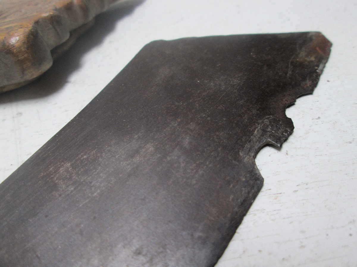

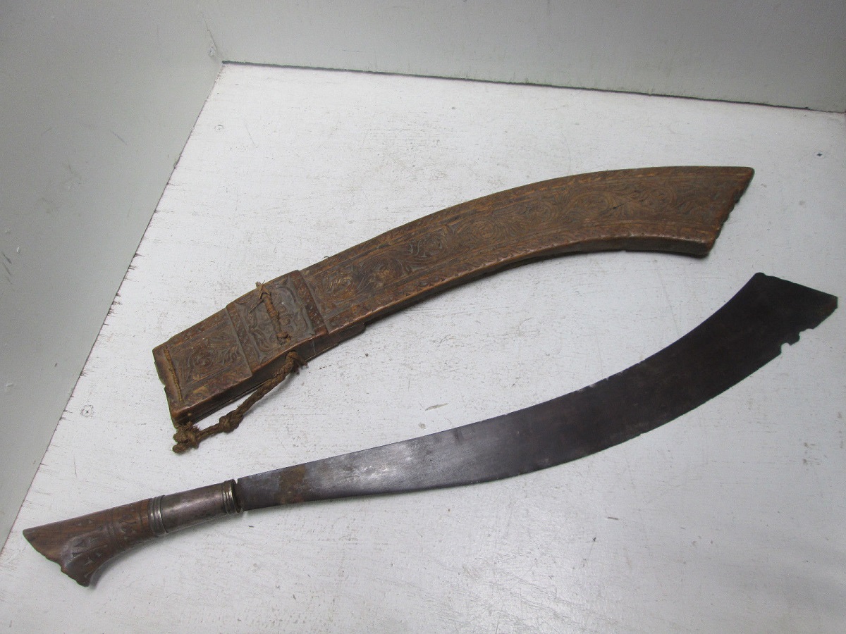

I should also mention the (yet again) extraordinary work Robert did in bringing this Parang back to life. It was in quite a sorry state when purchased, as usual Robert did an amazing job. Following are a couple of images prior to his efforts.

Default Close-ups
Before:

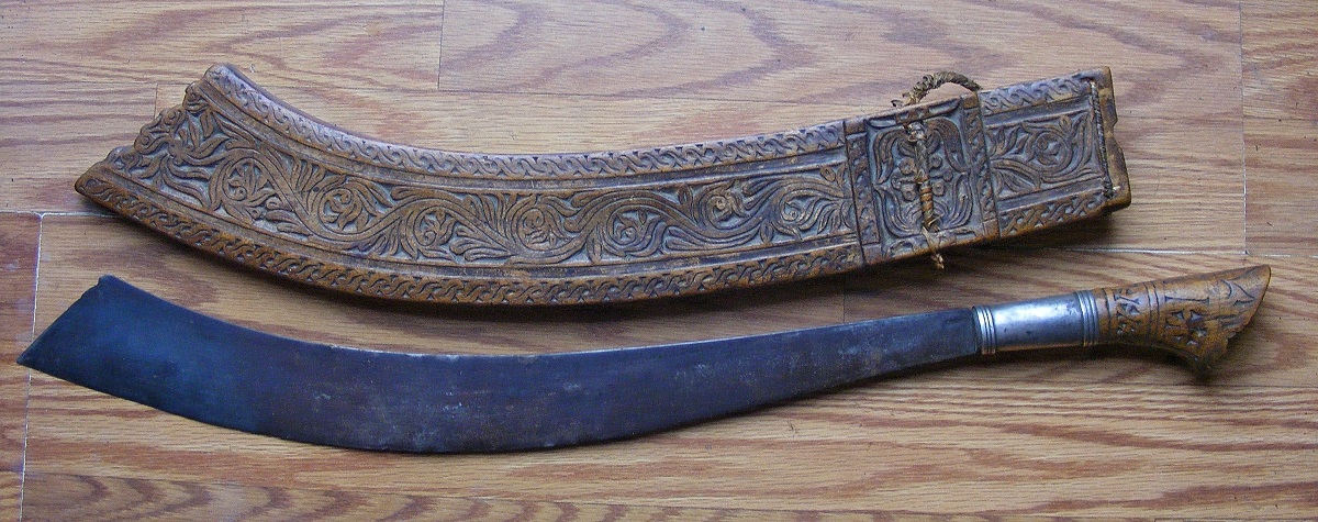

Old 4th November 2016, 12:16 AM   #11
russel
Join Date: Jul 2012
Location: Tasmania, Australia
Posts: 238
Default Close-ups
After:
