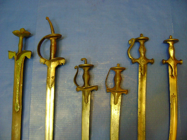

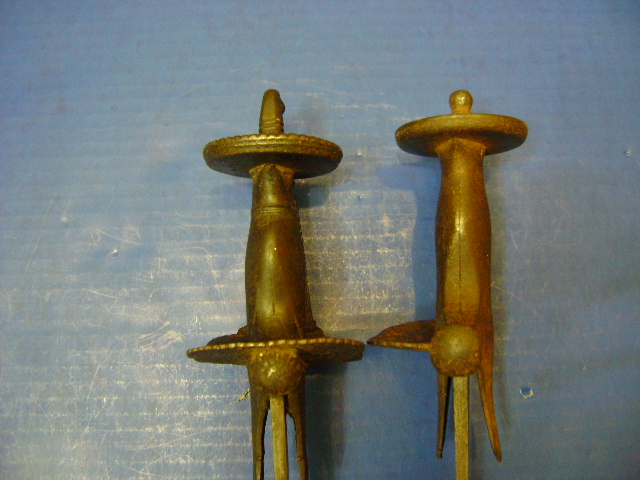

The first picture shows:
On the left:
1.Old South Indian handle See the bilateral wing-like handguard.
2. Later development of it, the Basket Hilt, preserving the old pattern of wing-like handguard but with the European-influenced wide D-guard and a stem arising from the pommel for a two-handed grip.
On the right:
Two classical Mughal handles with quillons ending in button-like terminals.
In the middle:
Two tulwars with handles combining features of both: wing-like handguards and wide D-guard of the Vijayanagara tradition ( the left one) AND the typical Mughal quillons.

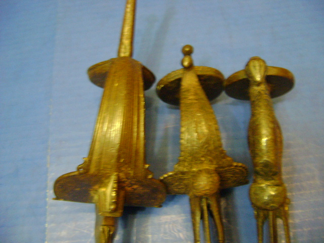

The second pic shows them from the side: they could have either one or two "wings"
The third pic shows the width of the D-guard: left to right Basket Vijayanagara Firangi, presumed "Deccani", classical Mughal tulwar
Interestingly, Elgood shows a Deccani Tegha with exactly the same handle and even mentions the crooked stem arising from the pommel, asserting that it is a feature of the 17th century ( see the left of the "mixed pattern" ones in Picture 1.
So, here is my question: is it reasonable to assume that the "mixed pattern"
handles are specifically Deccani in their origin?

Ariel, this is an intriguing ponderance! and I visualize you in a winged tufted leather easy chair, wearing a smoking jacket with your snifter of cognac in one hand and trusty 'Elgood in the other.
Actually I think you are pretty much on target, and its always fascinating when we get these 'in between' transitional cases. The Deccani classification as you know is an extremely broad conundrum in analysis of hilt forms, and Elgood notes it is particularly difficult to attribute them with certainty to specific states.
However it would seem most likely that these 'middle' swords with the Mughal type hilts retaining the 'winged' feature of the Hindu khanda would have been from Deccani regions.
The Hindu's were of course reluctant to relinquish certain features of their traditional swords' hilts as these often were key to apotropaic imbuement as well as religious symbolism.
As the Mughal Sultanates took over, many of the Vijayanagara types of hilts were likely amalgamated with the Mughal forms as these weapons filtered through the Bijapur regions.
I think the 'tegha' you mention from the Elgood article was listed as 17th c. so it would seem this time frame may well suit these unusual hybrids.
Well that's my take, think I'll grab a long neck!!!

When looking at hybrid examples, I am always of two minds. Does this represent temporal hybridism or geographical hybridism? In other words, are we looking at a transition between two forms that occurred over time (i.e., temporal evolution within a specific region), or, as you suggest, the mixing of two different styles in an intervening region?
Without provenance of specific pieces, I don't think one can distinguish between these two possibilities.

The hilt (no 4 from left) you show in the first picture is interesting.
Have a look at the way the hand guard ends, no animal head and no flower bud - it just ends, which is quite unusual, although it has been seen before. This could be a Deccani hilt, but the strange thing is, that I have a hilt where the hand guard ends in the same way, and I am convinced that my hilt is Mughal, wwith a very fine gold inlay of the decoration.
One could ask if this way of ending the hand guard is Deccani or is it Mughal. I dont know, and I have not yet researched these hilts, but as they are not so common I find it, untill I have learned some more about them, likely that they come from the area.

The winglike guard and the wide D-guard are unquestionably inspired by Vijayanagara; the general configuration of the hilt and the quillons are unquestionably are just Mughal. The ending of the D-guard might have been a newly-formed Deccani or a purely Mughal feature.
No matter how many additional "Southern" or "Northern" features we find, the very idea of the "mix" remains intact.

Overall, my point is that this particular hilt pattern combines both Vijayanagara and Mughal elements, i.e. the postulated mixed form that would be expected in Deccan, at a point of clash between the two traditions.
Of course, actual, attributable examples of Deccani weapons with such hilt are needed to substantiate the hypothesis. In this regard Elgood's Tegha may serve as one example. Are there others?

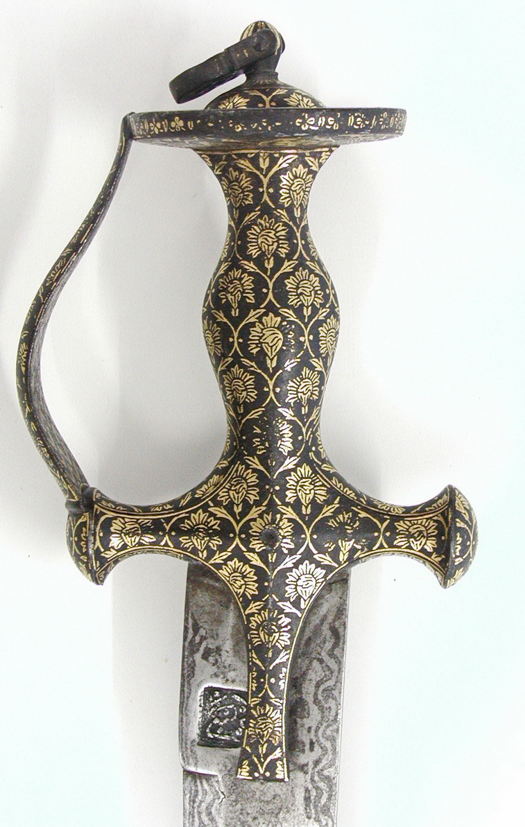

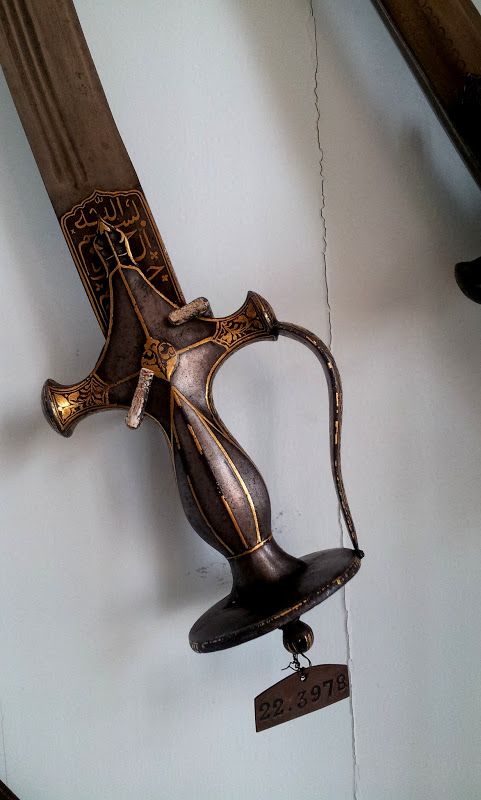

A hilt with a guard similar to your from the Prince of Wales Museum in Bombay.

Yes you are right. Do you know wat the text says to the hilt you shows?
Mine is Mughal 17th century.
It is a Quranic text starting with the word Bismillah.

I remembered seeing a similar one, and it came back to me: in the Elgood's paper on Deccani swords
http://www.vikingsword.com/vb/showth...808#post197808
there is a sword with very similar handle, that is attributed to Deccan

Ariel,
The sword you show, is the one I had in my hands 12 years ago or so, and I am convinced it is from Deccan.
These mixed hilts seem to be from Deccan, but they should be researched, to find out from where in Deccan, as I have a funny feeling that they came from the same area.

Jens,
Yes, the one from the Jaipur book you refer to: it has a very similar " khanda/tulwar" construction of the handle, but the artistic features are South Rajasthan, especially the beaded edges. Elgood specifically mentions khanjars from Deccan with similarly engineered handles and, as you notice, stresses the Deccani attribution of this configuration.
I know full well that I am skating on a dangerously thin ice, but if only we could finf several similar ones firmly attributable to Deccan, we might feel a bit more secure.

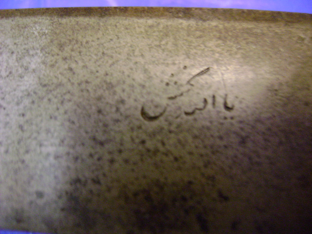

BTW, mine #3 from the left, is indian wootz, and has a very short Arabic ( Persian?) inscription, looking like a name, no more.
