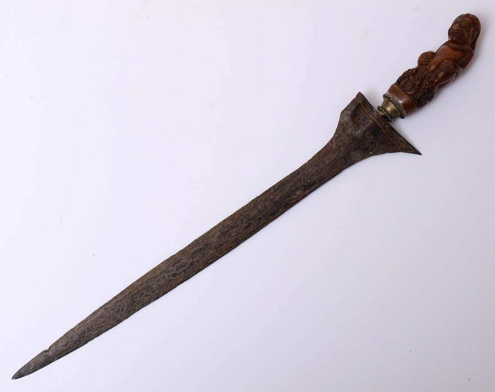

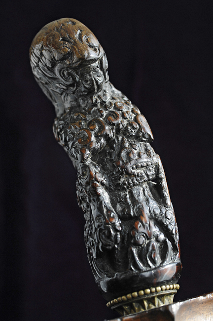

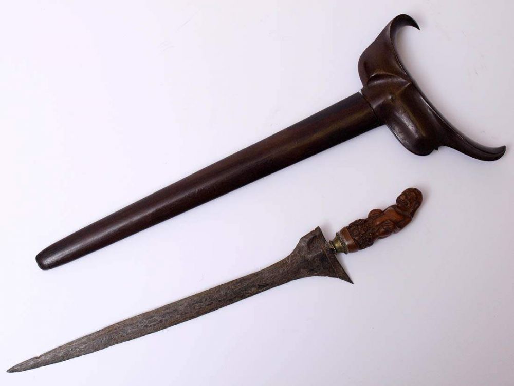

This week a hilt was auctioned, possibly made from rhino horn, and possibly from 17th cent. There are only 3 figural 16th/17th cent. horn hilts from european collections shown in Jensens Krisdisk - in Vienna (which is rhino for sure), Firenze, Dresden, so they are more rare then similar ivory hilts.
Two pictures of it for posterity.

I can't speak for sure to either the age nor material of this piece (though it doesn't have quite the wear and patina that i would expect from a 17th century hilt), but it is indeed lovely. I do hope that whoever won this auction has the wherewithal to undo the mad glue-man's atrocious and sloppy adhesive mischief.

Regarding wear, the most sensitive place on these hilts is the nose, and here it is very similar to some wooden specimens from Krisdisk.

I've followed the auction as well and think like you that the hilt is carved from rhino horn and think that we are not the only ones by the reached price. And I am also sure that the hilt have a very good age. Are you the winner of the auction? If so, good luck for removing the glue.

David, I have studied the kerisses and their hilts from old Kunstkammer collections for some years now, have visited many museum magazines in the last years and have seen and handled most of them. We have a very limited amount of pre-1700 hilts, perhaps less then a percent of figural hilts ever made let's say from 1500 to 1670, so each of them is singular and has sometimes quite unexpected features. Nevertheless, there are some indicators, which are typical for early figural hilts and doesn't appear on later Pasisir figural hilts, and this particular hilt has many of them. One of the keys is the symbolism within the Tumpal, and the state of development of the reversed Tumpal under the feet of the figure. Also modern replicas of these hilts mostly fail in reproduction of one very important feature.
Please take a close look at Chapter Banten in Krisdisk (attention to the noses, when a hilt is depicted en profile )

I agree that the materials look like rhino horn but it should be confirmed in the hand.
Regarding the indicators mentioned by Gustav differentating this hilt from the modern ones, I see 4 of them:
. The shape of the worn-out nose with distinct nostrils.
. The earlobes (or earrings) have a different shape than on the modern hilts.
. The small carving above the tumpal motif on the front depicts the male organs according to Jensen.
. The carving at the base of the tumpal motif depicts the female organ according to Jensen.
Accordingly I believe that this hilt is very old.

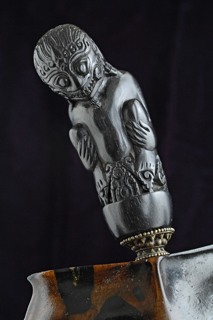

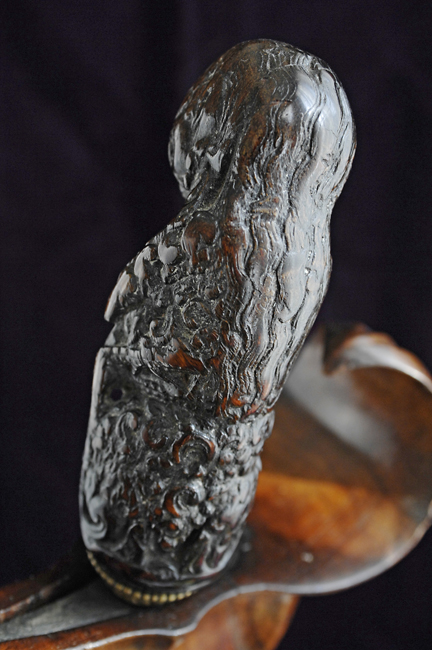

Alan, I will think about 1) and 2), yet I absolutely wouldn't like to answer the last one.
Today I received an e-mail with four pictures.

Folks, we have been through this already several times: From the pics supplied so far, there is no chance whatsoever to verify wether this hilt is made from rhino or waterbuffalo horn! We really need a close-up of a cross-section of the fibers, i. e. the top of the head or possibly the base of the hilt also.
We can argue about likelihoods but this never positively prooves anything for any given piece. Actually, the current pics make me feel albino water buffalo - I agree that the alternative is also plausible though...
Thanks a lot for those pics, Gustav! Could you please try to get additional ones? I also wouldn't mind better quality pics of the other parts of this keris...

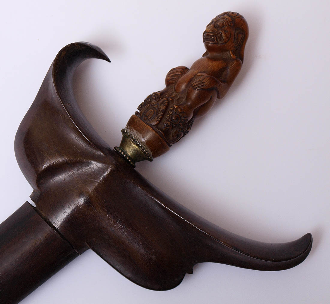

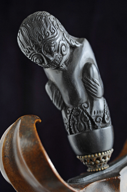

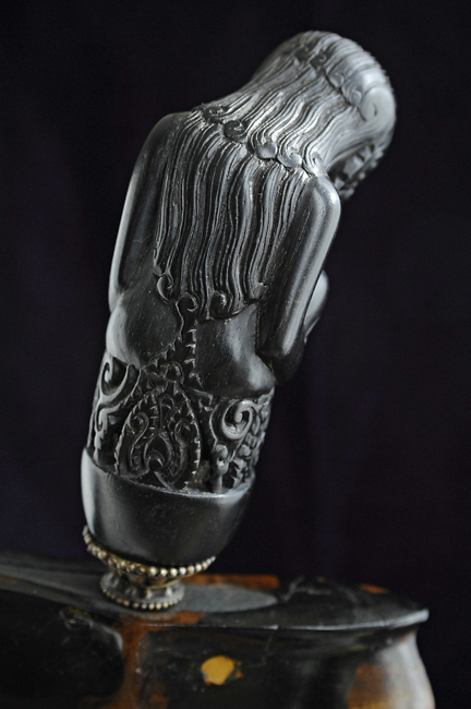

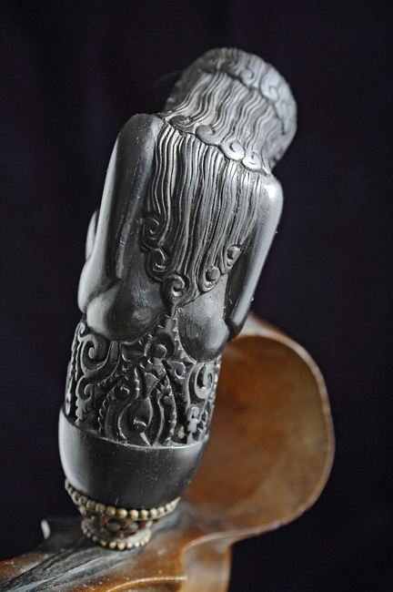

Kai, here are a couple of examples which i am sure have been carved within the last 100 years. To my eye you can still see aspects of the lingam/yoni symbolism in the tumpals carved here.
I am also including a front shot of the older example i showed earlier for a comparison of the tumpals used there. I am uncertain of the actual age of this hilt.

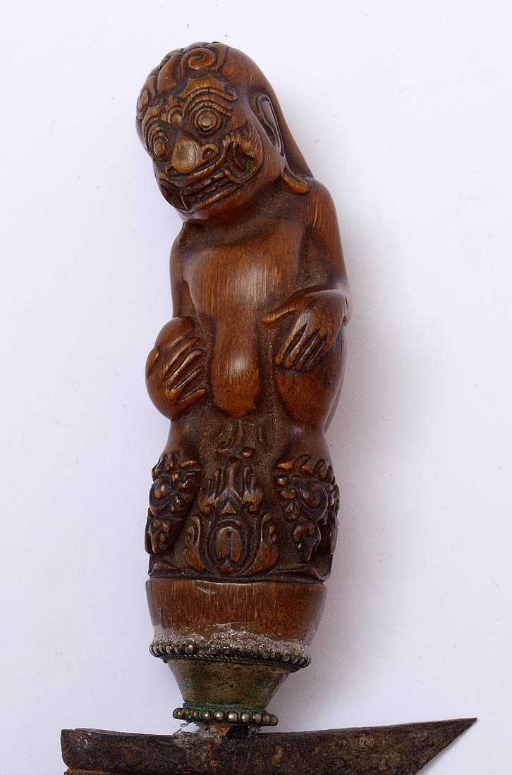

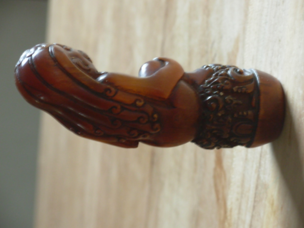

Hello Kai,
here two more pictures from the auction.

Thanks! I was hoping for additional pics, better resolution (despite the auction pics being better than from many auction houses), from other angles, or after cleaning/warangan since Gustav may have the opportunity...

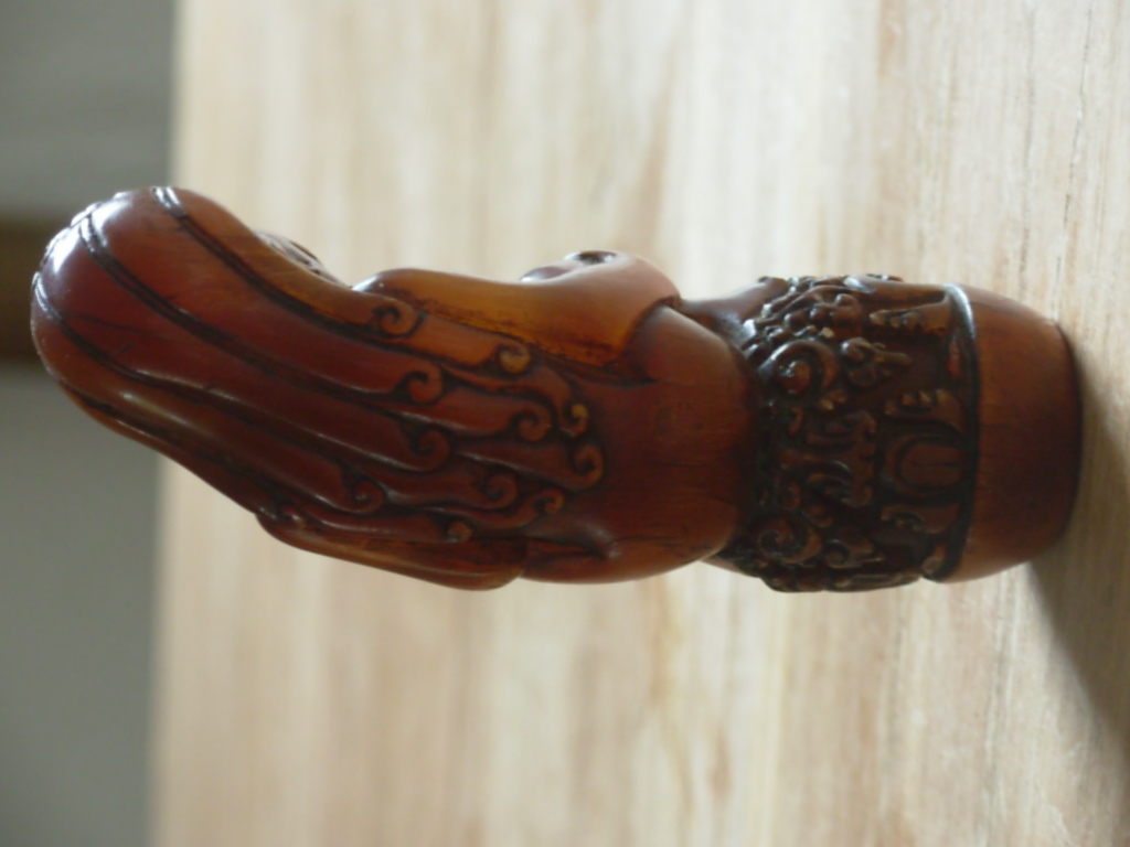

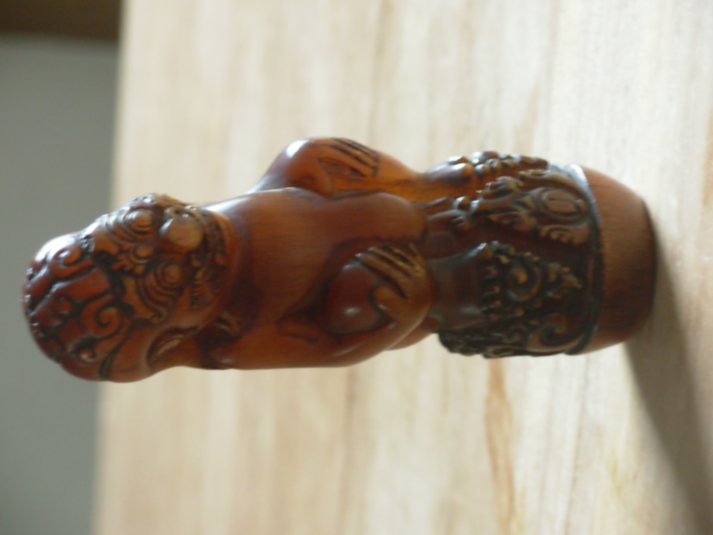

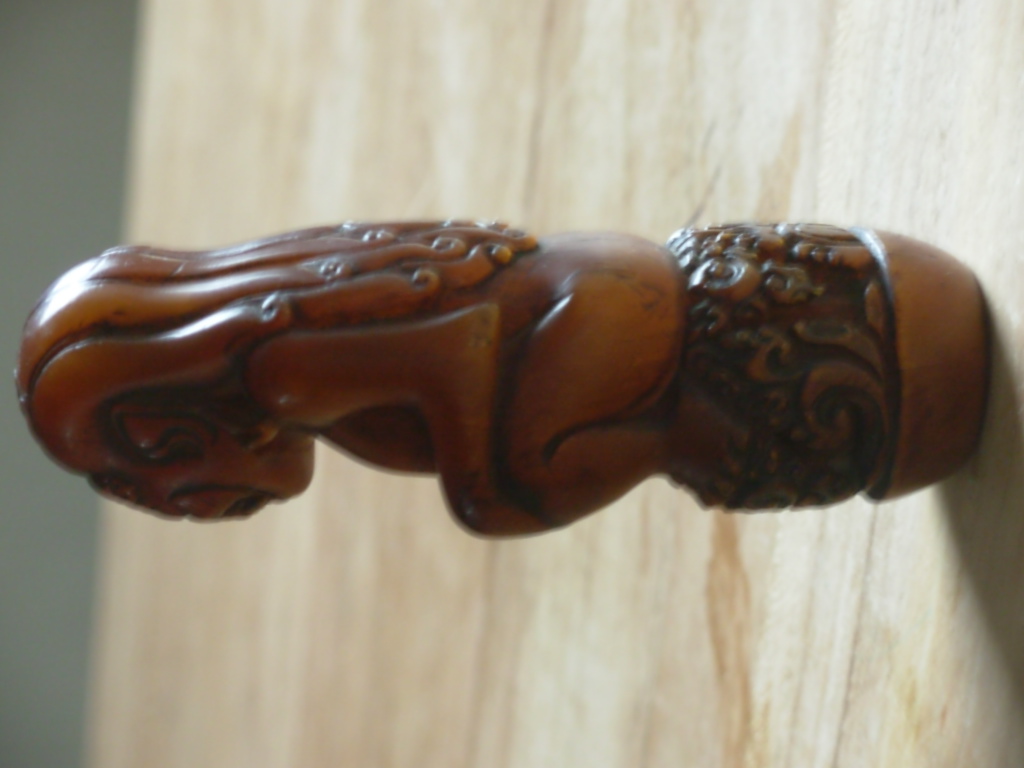

Here some examples from albino water buffalo:
(The greenish variants tend to be a bit darker, of course.)
Yes, these 2 do qualify as modern. Very similar workmanship, indeed.
While it is evident that these are offspring of the old style hilts, it's not about the similarity (nor quality of workmanship) but rather differences in detail.
Thanks, a really nice one! This "man in green" style makes it even more difficult to place (and the wear doesn't help either to discern details).
We need close-ups from all sides of this hilt for analysis. It might be older than you think...

Perhaps we (because it should be a discussion between many people in the ideal case) should start with the typical ornaments found on Bungkul of 16th/17th cent. hilts depicting naked figures of what is commonly called demonic character. These are my observations, I will try to be as exact as possible:
There are four upright triangular elements, dominating in size. The forward and the rear are mostly nearly identical to each other, as are the right and left ones.
The forward and rear consist of an elongated oval mirror, which sometimes is further partitioned, like on the initial hilt of this thread. There are tendrils on both sides of this mirror and above. So these two triangular elements are symmetrical in themselves.
The right and the left consist mostly of an bigger scroll (which in its size dominates the triangular element like the mirror the other pair). The second one, curving to the opposite direction is placed beside, sometimes the place for it is to small and it stays underdeveloped. From the top of the bigger scroll another smaller one in opposite direction is spouting/growing. So these "side triangles" are perhaps symmetrical in thought, yet not in the execution.
Above/between the upright triangles smaller downright ones are placed, and these consist mostly of tendrils with one more prominent scroll often more clearly distinguishable.
In the deep cuts between the upright and downright triangular elements sometimes more clearly the four edges of a cubic structure are visible.
This is the standard situation, which may slightly vary from hilt to hilt.
Now to the possible symbolic content of these features, at first the forward and rear triangles. This is the part, where I can only speculate and list the possibilities I am aware of.
The upright triangle as form could be expression of Gunungan and/or Kalpataru (the divine three). If together with the oval mirror in it, the range of interpretations widens. Then it could depict a Lotus plant with the blossom in the middle, which as whole can sometimes also be seen as a substitute for the divine tree. Important - Lotus as the base of a figure - the earliest clear depiction of a Mendak is a Lotus (on statue of Bhima/Kertolo in Museum Nasional). Lotus symbolizes the purity of divine descent, symbol of creativity and fertility, which leads to the understanding of the blossom (oval mirror) as Yoni and depiction as female genitals (the male genitals are that of the naked figure, they are placed exactly over the mirror. They sometimes have distinguishable Palang balls and do clearly belong to the shivaitic context. If you wish - when Keris is held in the hand, the Lingga is in the upright position pointing to Yoni (activated so to speak)). One more symbolic layer for the mirror is that of depiction of a Bintulu. Bintulu are often found at the base of East Javanese bronze figures, and have protective function. This all was always more or less clear.
Now to the right and left upright triangles. There are two possibilities:
1) the main element could be the bigger scrolll/tendril (which in size corresponds to the oval mirror)
2) we have the same three branches composition, which is distorted by the legs of the naked figure and becomes asymmetrical.
My thoughts to the first possibility: upright or downright scrolls are often prominent in gateways (Naga Temple in Blitar, 14th cent. or even more appropriate, gateway of mosque in Sendang Duwur, 16th cent.), and the source of this feature most probably is Makara. Together with the oval mirror in the middle of them, interpreted as Bintulu, it could be understand as a repercussion of Kala-Bintulu arch found at gateways of temples (and even schematically depicted on earliest Sunggingans as framing of water sources).
The second possibility - there is a depiction of the divine tree in van der Hoop, plate CXXXI. This is an asymmetrical Cirebon interpretation, and is quite close in general style to the triangles in question.
