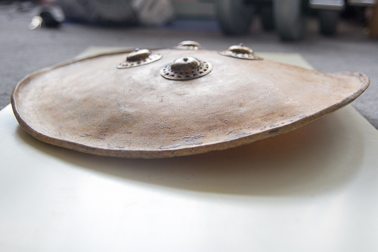

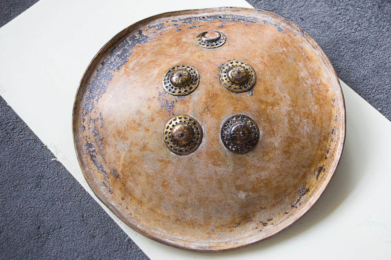

Hi all , sorry for so many treads! I've got this dhal and wanted to reshape it slightly just so its flat along the edge. Does anybody know how this can be done?
Any information on what hide this is? It is rhino? What do you guys use to maintain your leather dhals? I don't think pre lim and renaissance wax works well on leather..
https://www.youtube.com/watch?v=glzFgMHlr5Y I've seen examples for normal leather but not for dhals that have been hardened... My thinking would be you have to wet and vacuum form it around a wooden cast/mould?
I'm also looking for G.N Pants book called the Indian Shield.. apparently it has a lot to offer on this topic! Can anybody share pages from this book if they have it?

Firstly I should say that I have never tried to flatten a leather shield. The normal way to reshape leather is to wet it and then dry in some sort of jig to keep the shape you want, but I would not be too keen to do this here in case the decoration that is left is removed altogether. Perhaps a better way might be to use a source of steam on the under side, and some sort of adjustable "clamp" to GENTLY flatten the shield as it softens. It would be a pity to crack the surface in the process.....

Thank you kahnjar for your replies! I am currently testing this method on another warped dhal. It has a worse warp than this.
I applied steam on both sides on the sections that I intended to flex back into shape..
Next i wiped off the steam/residue and then applied pressure with weights ( around 50kgs) on top of the shield while the shield is laying flat. I have left the shield in this position and also heated up the room with a small heater and left it running over night to dry out any of the moisture..
Its been in this position for around 20 hours..
will post my findings soon. I may have to repeat this process 2-3x times for the flatter result i'm looking for.
