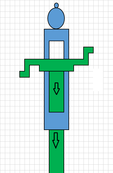

Concerning mechanisms, i wonder if there are more than one; possibly. I didn't see how this specific one worked in the begining, when looking at the small unclear picture in the book, but now i think i got the correct idea:

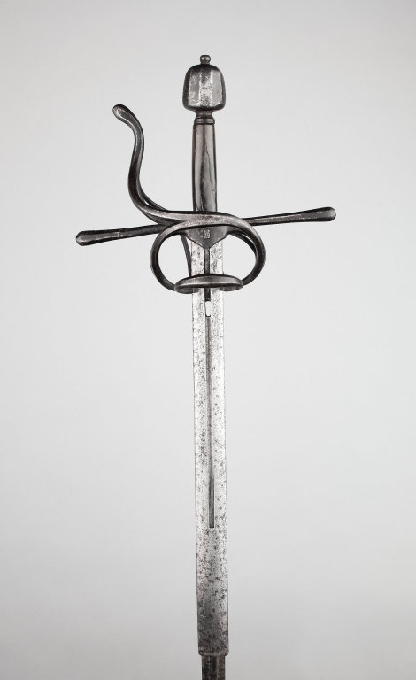

Speaking of examples in museums, you have the following German rapier (1590-1600) in exhibition at the Art Institute of Chicago.
Overall L. 167.6 cm (66 in.)
George F. Harding Collection, 1982.2844.
The mechanism appears to be the same as the one in the collection of Rainer Daehnhardt.

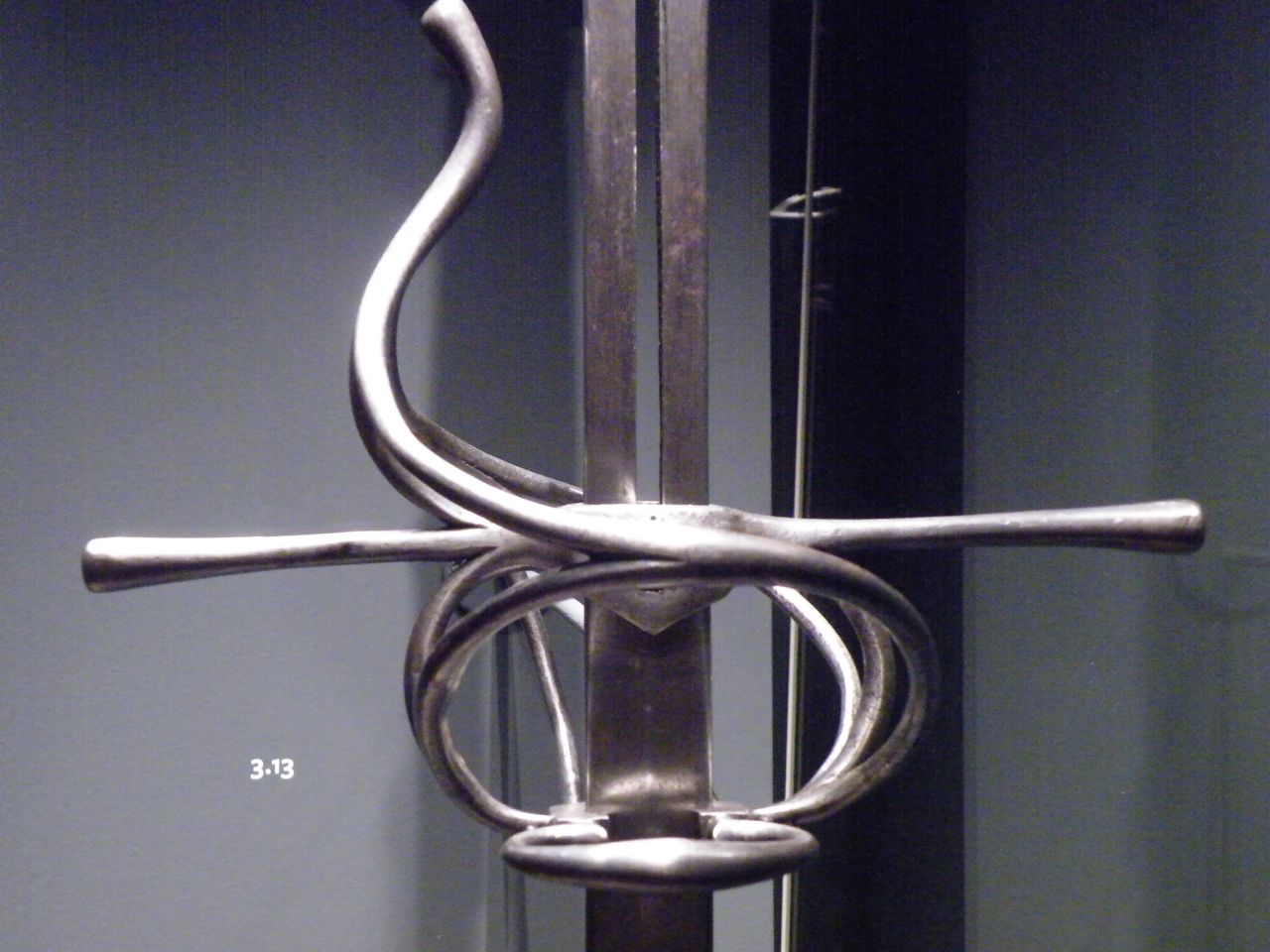

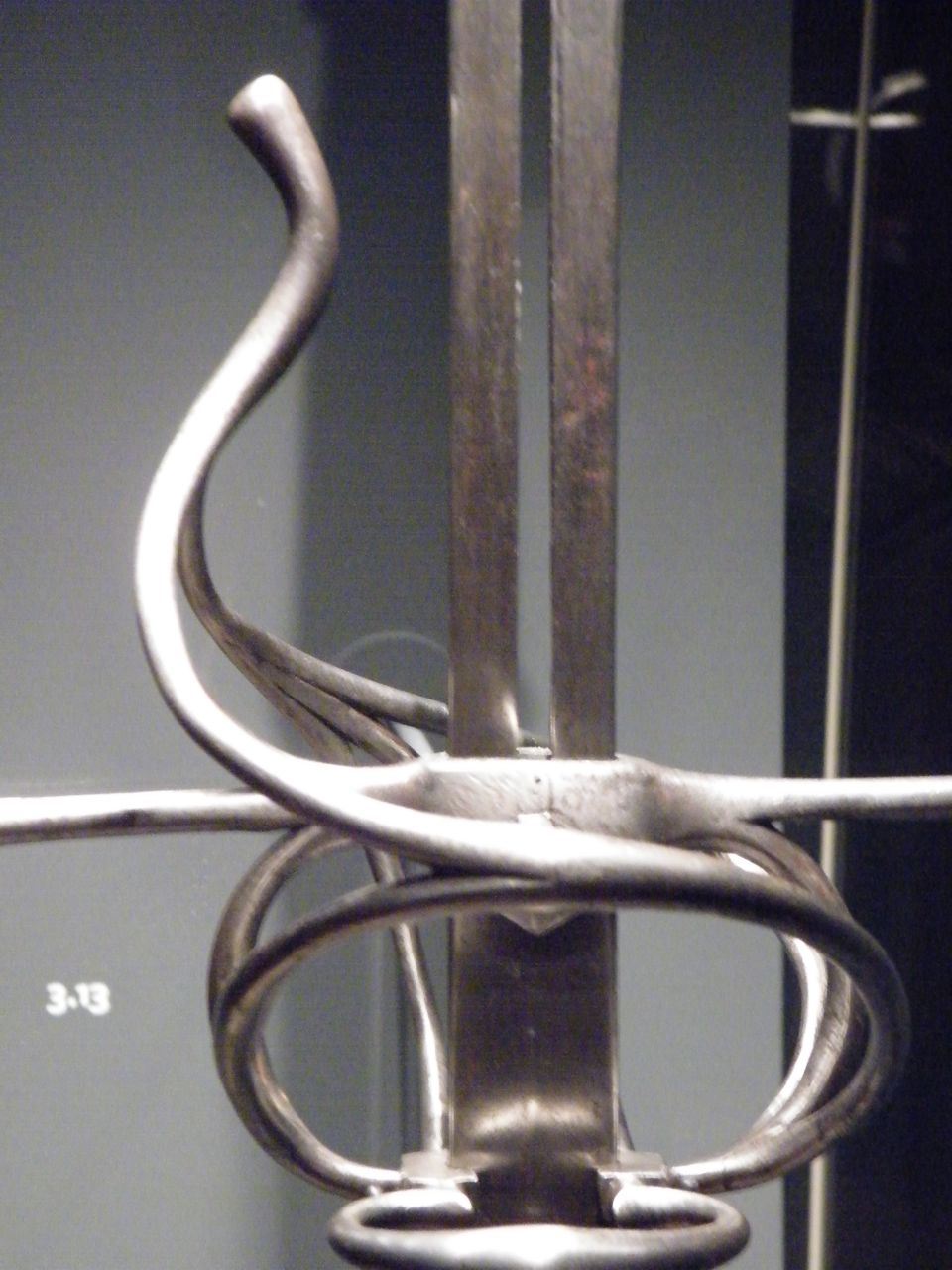

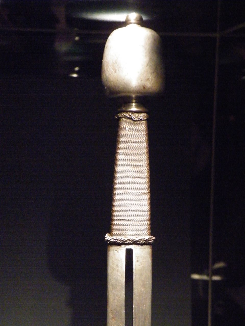

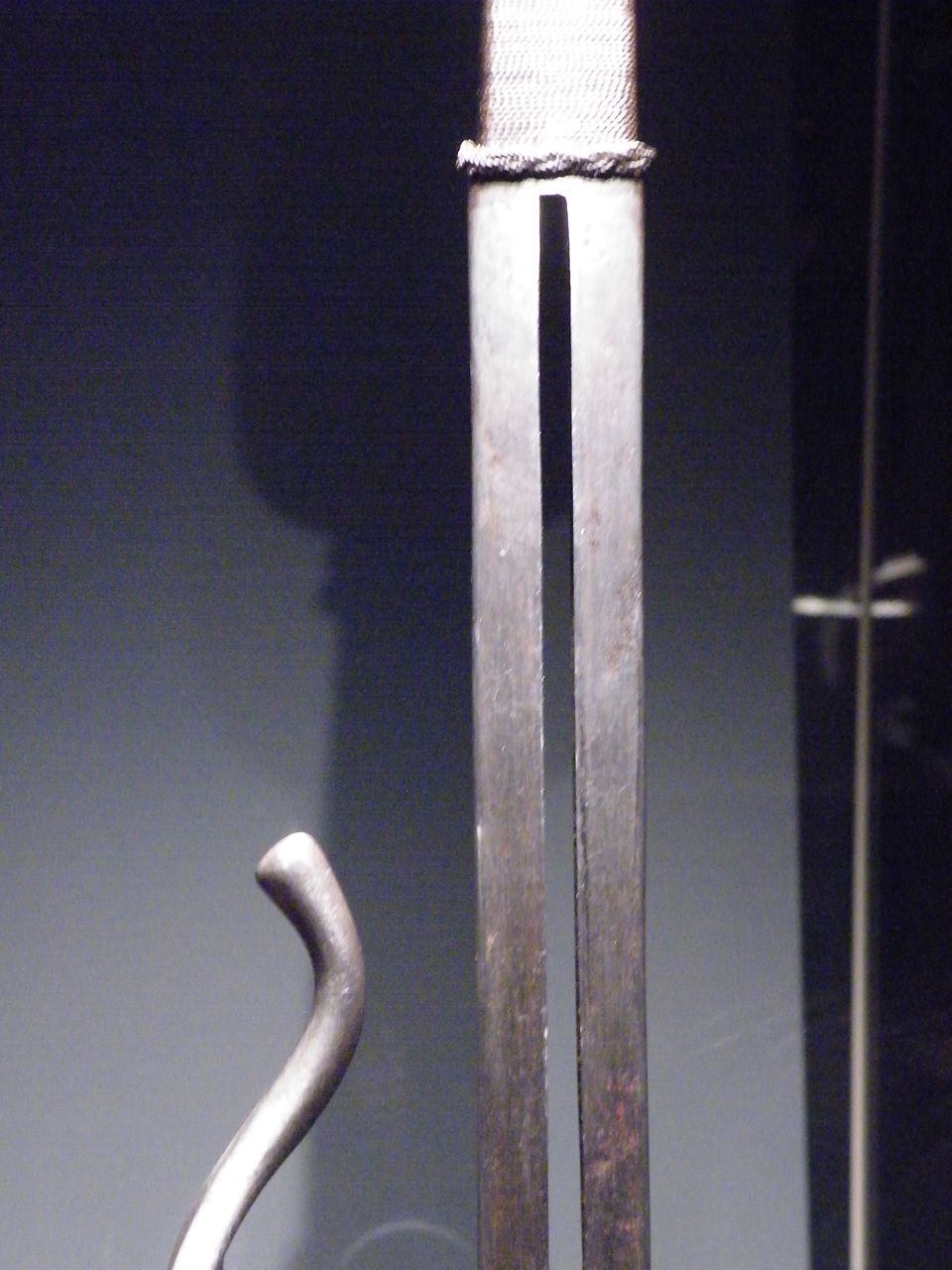

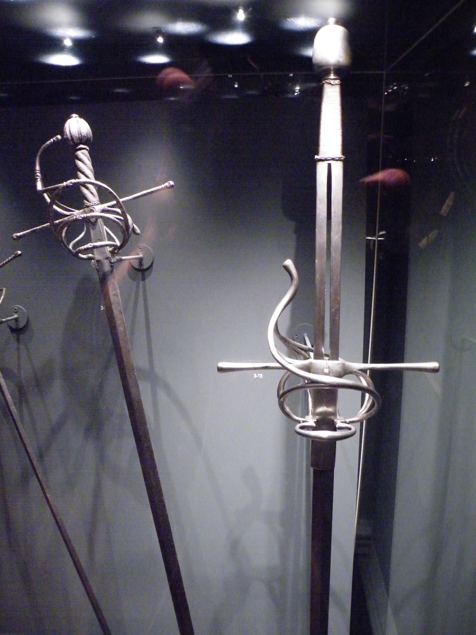

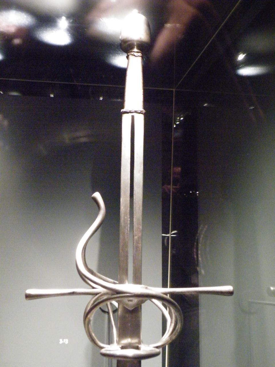

In 2012 the Wallace Collection in London staged an exhibition entitled 'The Noble Art of the Sword' with weapons drawn from many European collections, including the Royal Armouries. I took many pictures including some of the RA's extendable rapier.
I'm not sure just how practicable the design would be - unless I'm misreading the structure of the sword it doesn't actually look as if the actual length from pommel to point would change. Only the position of the guard. I may be wrong.
Apologies for the quality of the pics - as usual it's difficult getting good shots through reflective glass.

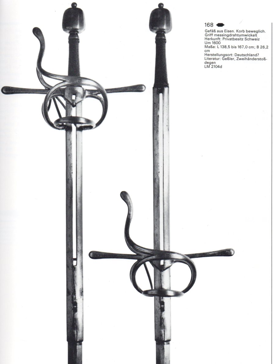

I was paging a catalog from the Scheweizerischen Landesmuseum and found a good picture of one these "growing" swords.
It looks like, after all, there are quite a few of them around.
