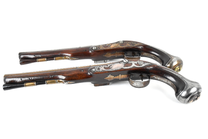

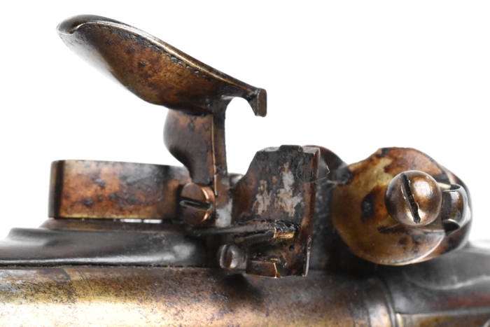

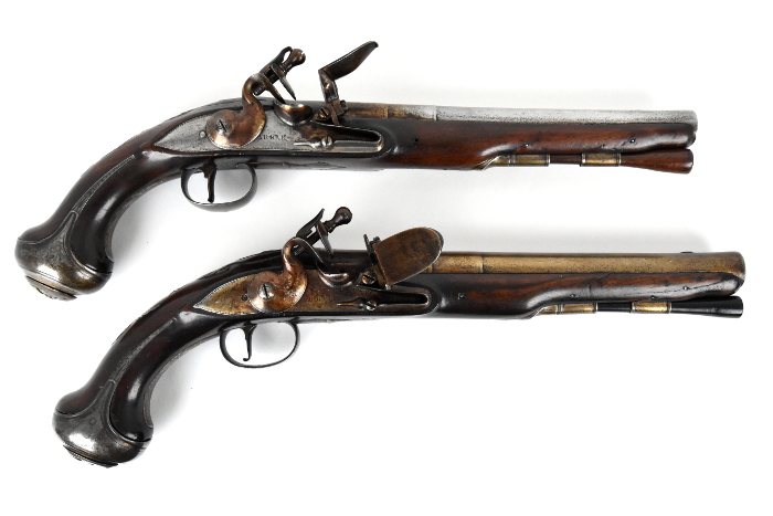

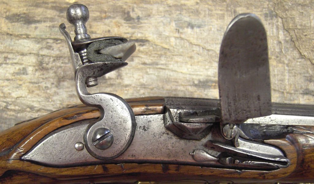

This pair of silver mounted flintlock pistols have a very unusual safety mechanism. The Frizzens can be swiveled out of the path of the hammer. Along with British view and proof marks, the barrels are marked with a star over "IB". This is the maker's mark of the highly regarded James Barbar.
http://weaponscollector.com/j_barbar_c1740.php
Unfortunately these pistols are covered with a dark brown substance which is believed to be dried linseed oil. A few years ago Cheaper Than Dirt republished an article on firearm preservation by Springfield National Historic Site and National Park Service. To quote that article “When linseed oil oxidizes, its molecules cross-link with one another, making it increasingly more difficult to remove as time passes.”
http://blog.cheaperthandirt.com/cari...toric-firearm/
I would like to clean these pistols. So far I have tried using fresh boiled linseed oil, WD-40, turpentine, and (God forbid) lighter fluid, all without any notable success.
Has anyone seen an antique weapon preserved in this way? Does anyone have an informed suggestion on how to safely remove the ancient dried linseed oil?
This means that to get the results you see on your pistols needed a very long time. So cleaning needs the same time too. So you can try to put all metal items in turpentine at least four or five weeks and see afterwards what has happened.

Thanks for sharing these very interesting pistols. Did you know that swiveling frizzens were pretty much the norm on many early flintlock mechanisms from the Baltic countries, especially Sweden, from the mid- to late 17th cent.? There are several examples showing various stages of development and refinement in H. L. Blackmore, GUNS AND RIFLES OF THE WORLD (1965), figs 137, 139, 141-45. On all of these, the pan-cover and the steel were attached to each other via the swivel-screw. The design allowed the gun to be carried safely with the pan primed and closed, and the cock lowered with the steel pivoted out of the way, with no need for a half-cock detent. I would imagine that the locks on your pistols also have a half-cock safety notch on the tumbler as well.

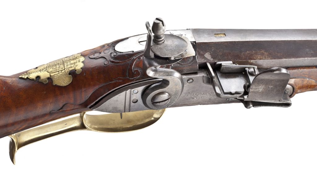

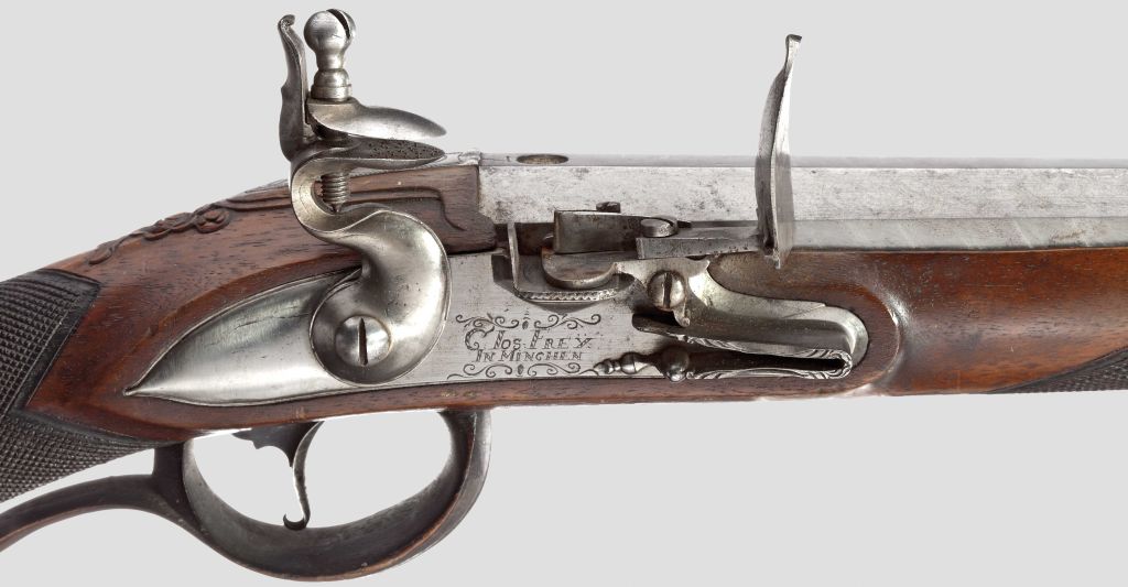

This safety system is rather often to be found on German and Austrian flintlocks as show the fotos of a gun by Christoph Frey, Munic, a pistol by Wenzlau in Koblenz, a carbine by Niklaus Koch of Vienna and an unsigned military officer's carbine of Saxony.
corrado26
I didn't know that Philip. I've been lucky enough to handle hundreds of flintlocks from the period, but most of those were English, French, or Spanish. This is the first swiveling frizzen I've seen other than one published image.
Would you disagree with the assertion that the design is rare?
Originally Posted by Philip
DidThere are several examples showing various stages of development and refinement in H. L. Blackmore, GUNS AND RIFLES OF THE WORLD (1965), figs 137, 139, 141-45.
I own several books by Blackmore, but not that one. I'll ask around and see if one of my friends has a copy. Thanks for the reference.
Yes they have a half-cock safety.
corrado26
Thanks for the great photos corrado26. It is helpful to see some other examples.

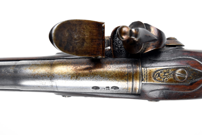

Attached is a picture of Lewis Barbar's mark, and am sure this is the same mark on your pistols.
Thank you for showing them here Dana.
Richard.

The hard thick brown substance proved very difficult to remove, until my friend Bob Calder recommended a product used to remove linseed oil from old paintings. That product's active ingredient was ammonia, and ammonia proved to be the answer to my dilemma. A day and several hundred q-tips later the first of the two pistols is ready to be rephotographed.
All photos are copyright (c) 2016 Dana K. Williams. All rights are reserved.

Old 20th April 2016, 07:21 PM   #25
dana_w
dana_w's Avatar
Join Date: Nov 2012
Location: Southeast Florida, USA
Posts: 437
I talked to a lot of well known collector's before deciding to remove the nasty linseed oil, and I am happy with the results. Anyone else think that they should have been left the way they were?

The problem with any thick opaque finish is what it may hide underneath. If corrosion has started, or starts later on, the damage can be irreparable before it is noticed.
I would guess that the Linseed oil varnish was originally applied by a previous collector rather than the original user, given how it would interfere with cleaning and maintenance during it's lifetime of use.

Dana, the linseed oil was not the original metal finish on the guns, and considering the problems that these caked-on, after-market coatings can cause in the long run, you were right in removing it. This is not analogous to the aggressive treatments used by some collectors and dealers, namely abrading the surface with polishing agents, or enhancing it via re-bluing or redoing the browning.

I agree with Philip.
This old oil may have been applied over the centuries to prevent rust, maybe not linseed, as all old oil will gum and solidify in time.
We often see this accumulation. A little can look very nice, but if it starts to cloud the appearance and gum up the works, it's best removed and as Philp said, has nothing to do with any original finish.
Of course, a light oiling afterwards is again required............starting the process over again? :-)

Using oil on an iron or steel surface is better than no protection at all. But think of the downsides:
1. It comes off on your fingers (or soils your curatorial cotton gloves) as you handle the piece. Worse, it can smear onto the wood stock and over time cause it to darken in places when accumulations soak into the grain.
2. Over time, it can harden and form a nasty gunk which is likely to cause its own set of problems, as has been discussed heretofore.
3. On guns that are displayed out in the open (i.e. on wall mounts or atop a shelf) and are not periodically wiped, oil attracts dust and while it slowly dries out, the dust attracts atmospheric moisture like a wick, and the metal eventually rusts.
You can avoid these problems by using a high-quality wax in lieu of oil. "Renaissance Wax" is a popular brand, but I have had excellent results with more mundane equivalents, like a good carnauba-based automotive wax, or the household standby, Johnson's paste wax (designed for furniture, it's good for the stock as well). Remove oil from surface before waxing, and use a toothbrush or toothpick to remove excess buildup from crevices and screw slots after wiping with a soft cloth. A wax finish lasts a long time, I've gone several years before having to renew it (although I live in an arid part of the country, you might want to do it more frequently if your climate is damp or you live by the seashore).
A good time to wax a gun is when it's all apart, you can catch the underside of the barrel, the parts of iron fittings that nest in stock recesses, and of course the screw threads. Oil still has its place, to lubricate the mechanical contact points. If you make it a point to scrub and clean the bore, do the same as you would do for a sporting gun, but it's best to reserve that operation for when the barrel is detached from the stock so that bore cleaning solvent (and the suspended rust and gunk) don't drip onto the wood.

Dana: Those are a great looking pair of pistols. And I'm glad you found a solution to the cleaning issue. They sure turned out nice. So much better without that old, hardened oil. Your decision to clean the metal parts in the fashion you did sure gets my vote. And thanks to all for the knowledge on the saftey frizzens. Most interesting.
Here is the stainless scrubber that Philip mentioned. It does in fact work better and faster than steel wool. Terrific item.
And I really like Renaissance Wax. That is what I usually use. But have also used a good quality carnuba wax with similar results as Philip mentioned.
For inside of barrels after cleaning, I still use old fashion gun oil. It will evaporate over time, but their is no build-up so it's easy to run a solvent patch down the barrel and re-apply the oil.
