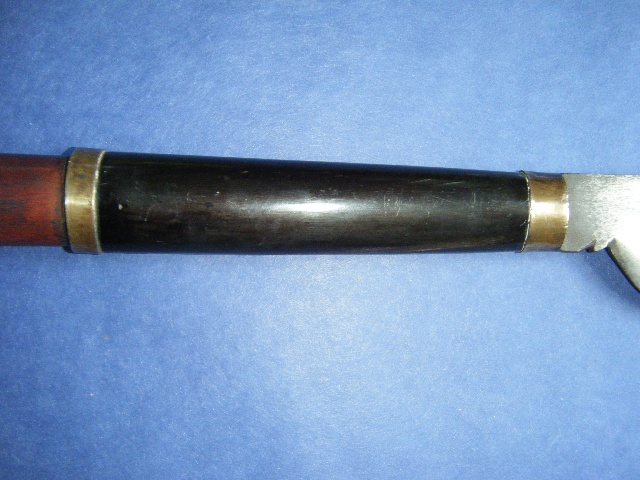

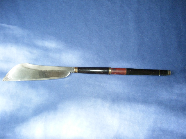

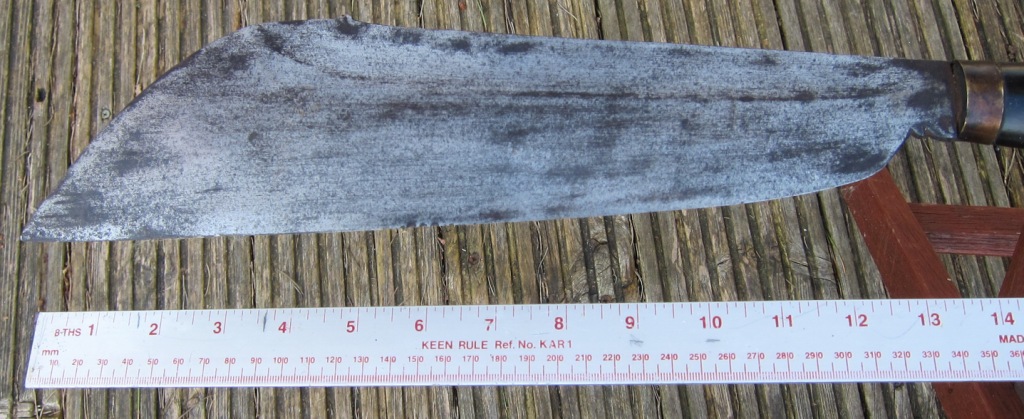

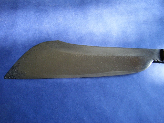

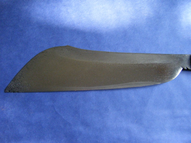

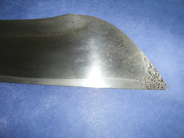

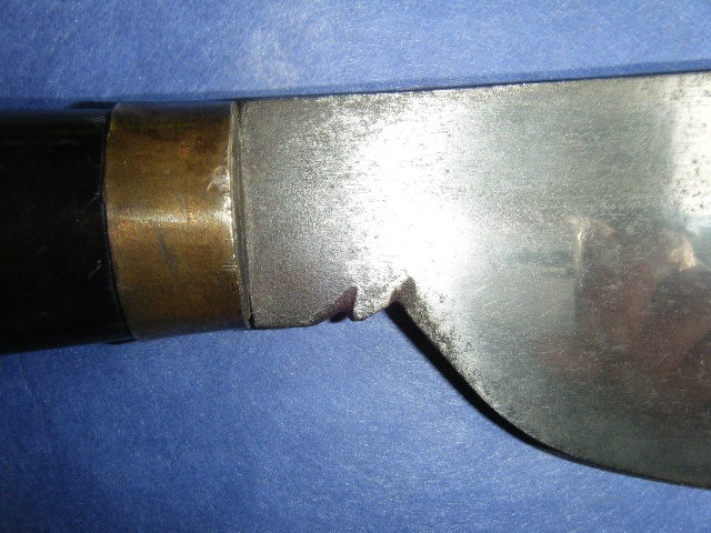

By my last trip to Indonesia I get a completely rustet stick sword from Solor (see Albert G. v. Zonnefeld, Traditional Weapons Of The Indonesian Archipelago, page 129). I have had removed most of the dark rust. After I have shown this sword to our member Roland M he offered a polish and etch of the blade. So a big "Thank" to him for the great job he have done. The blade show surprisingly a hamon at the edge. This blade is a high quality forged blade. Enjoy the pictures of this very rare weapon.

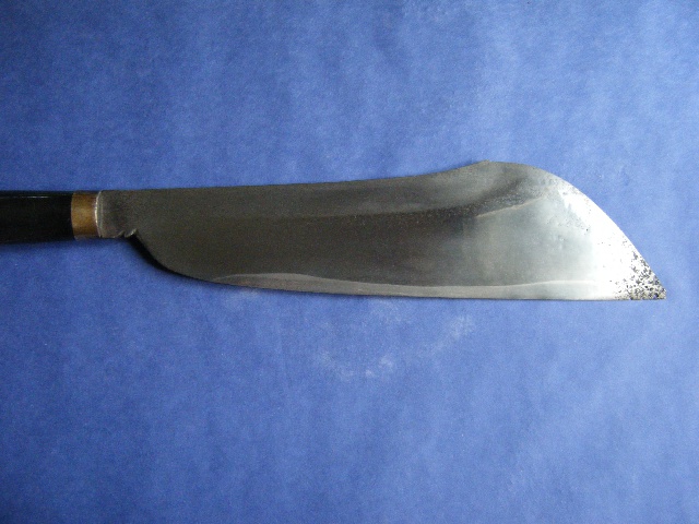

I just ask: why is it surprising?

Old 13th March 2016, 11:41 PM   #7
Hello Timo,
a hamon I know from dha but I have seldom seen it by Indonesian blades, most of the time this blades are laminated. To create a hamon is not easy and I am nearly sure that this blade wasn't forged by a local blacksmith from Solor.

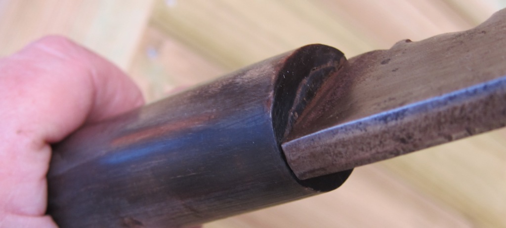

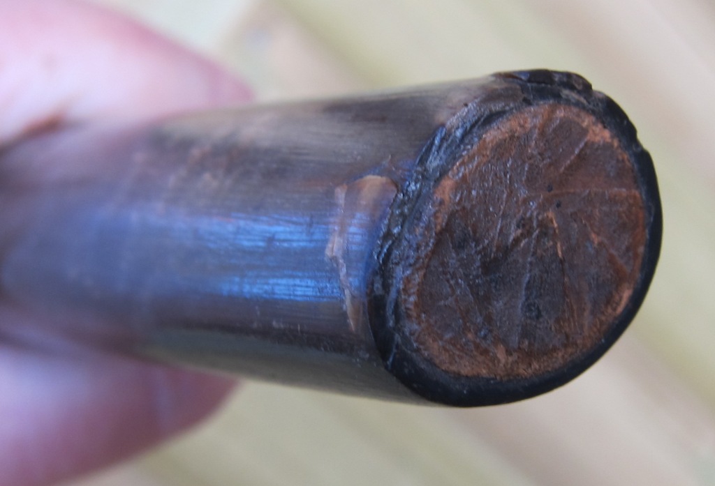

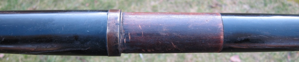

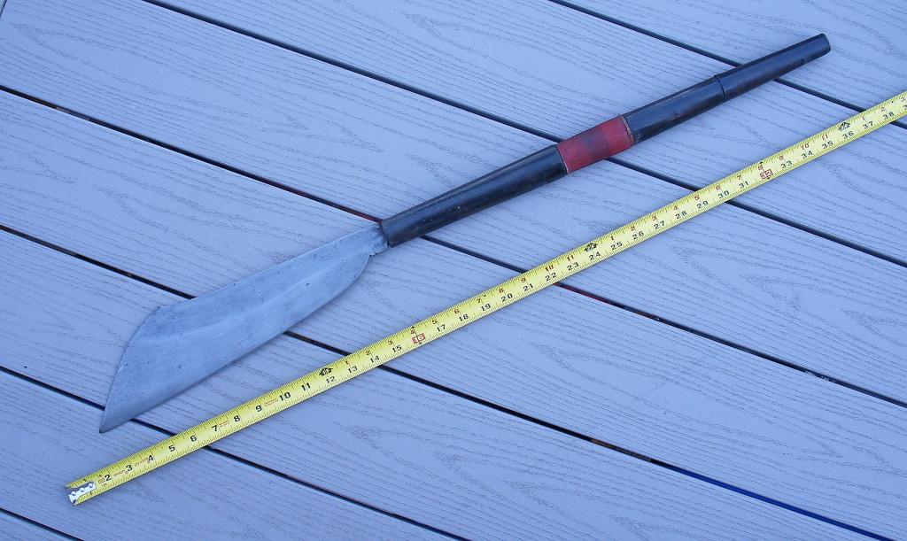

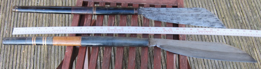

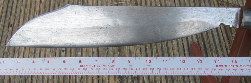

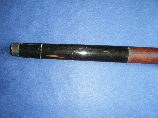

Default A couple more
Yes, I know, I am being greedy.
I have collected since the 70's and these are the only two I have ever seen. Both are horn, wood, horn although the horn is wrapped around the wood on the pommel end so I think they are one piece wooden hilts with horn decoration.
Sajen, I think you are correct about their rarity. Not surprising seeing the size of the Islands.
Roy

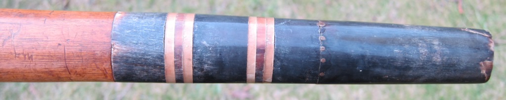

Old 14th March 2016, 06:39 PM   #12
Royston
Join Date: Mar 2008
Location: Poole England
Posts: 445

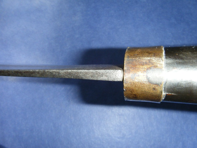

I forgot these two photos. Note how the pommel end shows wood with a thin layer of horn wrapped around it.
Roy

Old 19th March 2016, 02:43 PM   #18
Roy
Hello Roy,
thank you very much for posting your two nice examples, the one in up seems to be very similar to my posted example. May I ask how long it is overall and the length of the blade?
It's most interesting that the handles are not simple wrapped with horn but the horn is covered with a piece of horn without a joint, a technic I never have seen before. This is also the problem by the restauration of my other example.
Again, two very nice and rare examples you own!
