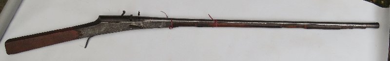

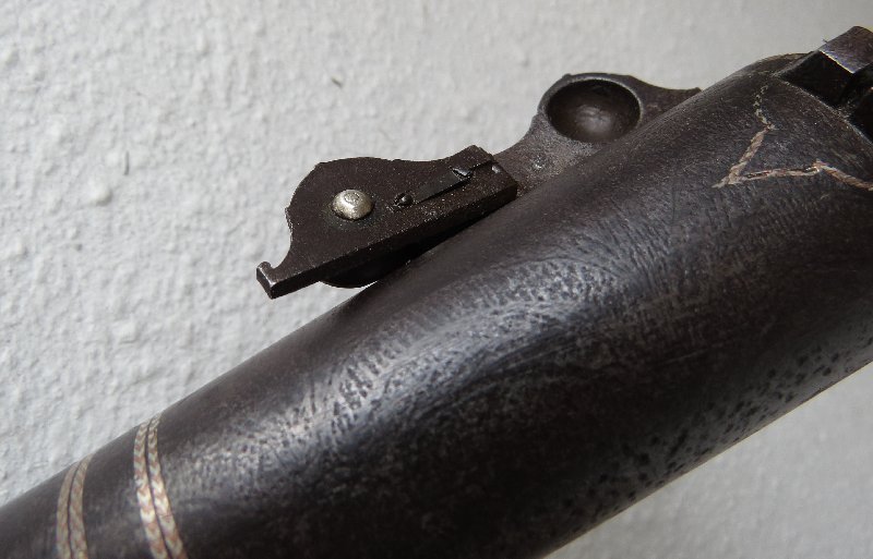

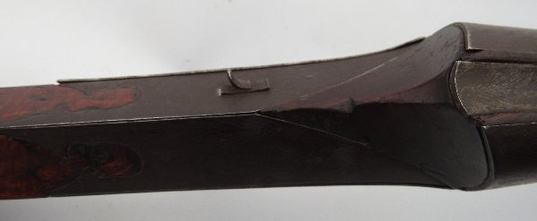

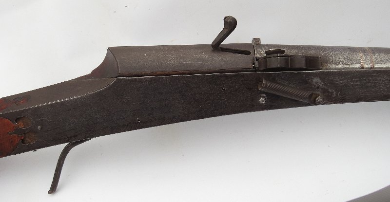

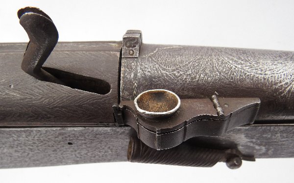

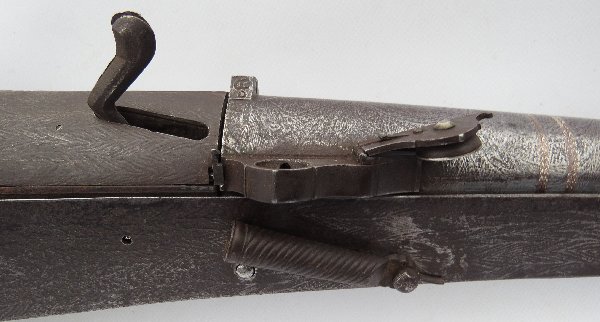

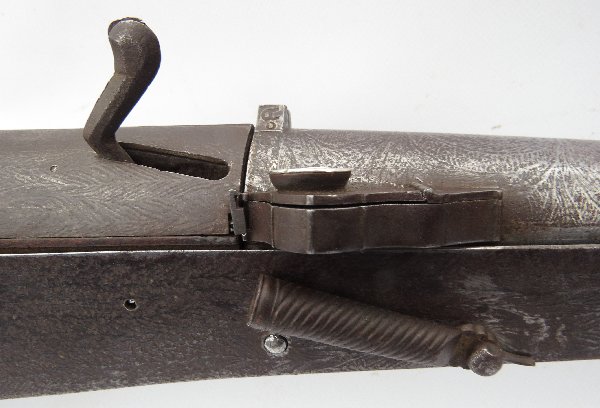

A preservation project, Indian matchlock of good quality with a very unusual sprung loaded flash pan released by a catch on the rear of the stock.

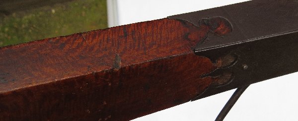

Sadly someone at some time had taken it apart, so one side plate, the trigger guard plate and another plate were missing, the trigger is a later blacksmith addition to repair a broken trigger. Stock was snapped in two and various parts of the wood work were missing. So I've just tried to put it back together so it can survive another 200 years.
When the catch on the stock is lightly touched the pan springs open.
What's also interesting is the fake flash pan on the top, perhaps to allow you to appear to have any empty pan or to have a fake flash in the pan.

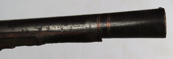

The barrel is decorated with fine bands of silver and copper/gold inlay very similar to a Indian Flintlock shown in Firearms of the Islamic World by Robert Elgwood as fig.94, attributed to the maker Seetaram and Sons, from Rajasthan?.

most unusual , I like this feature.

This arrangement doesn't look Indian. I Think it was designed by an English chap, (working up in Rajasthan) but have to re-check the details.
First time I have seen it though!
Can't say more at present, as I Will get the facts wrong! Be back later though.
Thanks for showing it!
It looks good and solid, you should sort is as a shooter. :-)
I believe the upper pan was to try your match. that's the only thing that comes to mind as plausible.
Very interesting set -up.

Just when I thought I've seen everything. LOL. That is the most unusual - and interesting - feature on a Torador matchlock that I've ever seen.
As Richard says.....it does look like an invention/addition to the gun at the time of manufacture. (?). But it is certainly cool !!! Never seen/heard of one before. Richard's guess as the reason for the fake pan is as good as I can guess for the moment. This highly unusual feature alone would be justification for restoration IMHO.

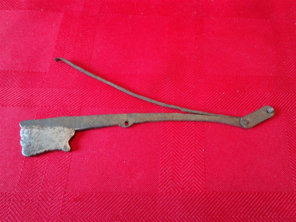

Speaking of restoration: If possible, could you provide some photos of the complete gun as well as photos of the areas of missing parts? I might have some original parts you could use (?) such as this original trigger assembly
PM me if you prefer.
Thanks for Posting this really unique feature on a common gun.

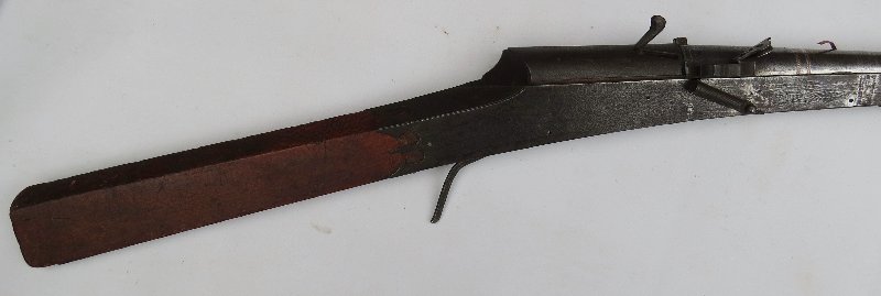

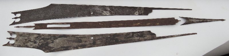

The top side plate in the photo below is original, the other three plates I made to match the cutouts in the stock. Trying to tone the new steel down takes some time.

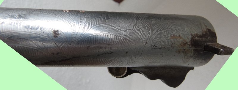

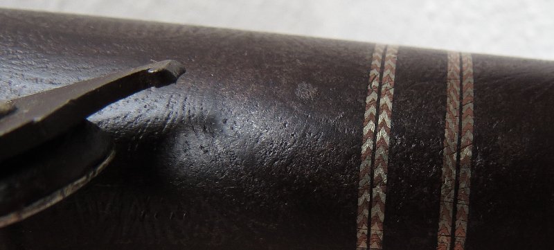

Whats also very interesting is the pattern on the barrel is etched, while very worn/pitted along the top of the barrel, the half of the barrel in the stock came out looking like its new, showing the barrel was always in the bright. They clearly etched the barrel in the round and then put the best half facing up.

As requested heres an overall and a few other photos.
55" overall with 37" barrel.

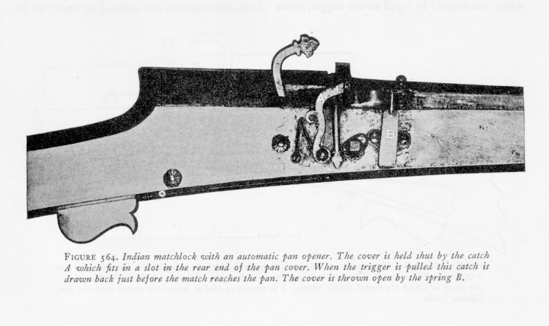

Looking at the fine print further in Elgoods references I see he mentions a image of the flash pan in "A Glossary of the Construction, Decoration and Use of Arms and Armor in All Countries and in all times" by George Cameron Stone as figure 564.
But although he references it with regards to Sangster's design from Agra, I think it is the improved "automatic" design from Mysore.
(image of fig.564 from stones included for academic interest only)

This latter design in your last post, I see as Indian, Stenoyab.
It hasn't the clean look of the other, which I am sure is made or designed by Sangster.
Probably others tried to make something similar, if not in mechanics, at least in function.
Yours isn't just a munitions grade piece, and probably variations were made on the same basic theme for local worthies and as examples.
As we had up to this time, no known examples of this mechanism by Sangster, I believe yours is the first to come to light!
