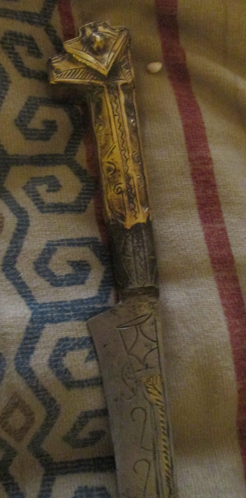

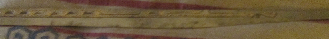

After all these years, I finally received my dream sword/antique in the form of a flyssa and finally hung it up on my wall after two weeks in a box. The sword's a beautiful piece: 97.5 cm and still has the brass on the hilt and the blade's roof and sides.
I am curious as to how to maintain this weapon's condition. The person who sold it to me said that I can use olive oil to clean it, but I'm still on the fence about this. I'm pretty sure I need to put a small amount on a washcloth and run it along the length, but I'm a bit adamant to try it. After all, this is my first treasure and I'd rather not touch it too much.
Also, I'd like to get an assessment about this sword. I believe it's around 150 years old and from Algeria. Though as I'm not an appraiser in weapons; my knowledge on swords is novice level. Is there any significant features I should be aware of other than its usual physical shape? I understand this is likely a ceremonial-styled sword based on its wave and needle point instead of a cavalry form (slender blade for stabbing akin to a saber) or a butcher form (broad, thick blade for slashing and chopping like a dao).

Yes this is an old early 19th century Kabyle flyssa. I recommend baby (mineral) oil. It will clean and protect the metal and won't go rancid as olive oil could.
Congratulations!

Panzer I just re-read your post. No worries about damaging your treasure with the oil. The brass looks well bonded to the blade and it will not come off. Washcloth or paper towel will do. Wipe on, let sit for a bit, then wipe off any heavy excess. The oil will clean off gunk and surface rust. Just wipe repeatedly until the paper/cloth is clean.
If you're ever tempted to use heavy duty brass polishers like Brasso, be aware that it REALLY cleans the brass down to a bright white look, stripping the patina.
Emanuel

Thank you for the note on the brasso as well.......I always encourage maximum restraint on cleaning and restoring these weapons. I have always thought of patina as literally embodied 'history', and belongs to the weapon itself.
