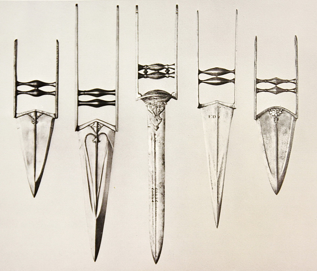

From 1650 to 1800 the Danish kings had their own private museum, containing many different things - katars as well.
From 1648 to 1845 Denmark had a trading post called Tranquebar on the south east coast of India, and many Indian items were shipped home to the royal Danish museum. Amongst the things were also the five katars shown on the picture.
The ones who collected the items did not write from where in India the different items came, nor did they write in which year they had been collected, or if they were new or used at the time, but we do know something else, we know when the katars entered the collection. They entered the colelction in the end of the 17th century.
Old 25th July 2015, 04:00 PM   #2
Posts: 4,736
Jens:
Thank you for posting these most interesting pieces with a clear provenance to pre-1700. They are all in great condition, with the two left-most examples looking as though they were just made. Excellent preservation over the years by museum staff.
The central one looks the "oldest" to me, and it appears that the left edge of the blade (as we look at it) is shorter than the right. Also, there appear to be some marks on the blade further down. Could this be a remount of an earlier knife which had a partially sharpened back edge? Is it possible this might be a European blade that was custom remounted? Just a passing thought.
Ian.

Ian,
In the book it say that it is a shortened European sword blade.
What I find interesting is, that even with dated blades you can not be quite sure, the dating was made when the katar was new, or sometime later, maybe 'helping' a bit on the age when dating it. But in this case we know for sure that the katars are, at least from the 17th century.
Jens

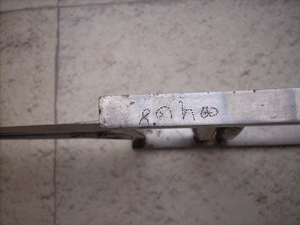

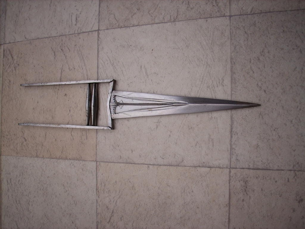

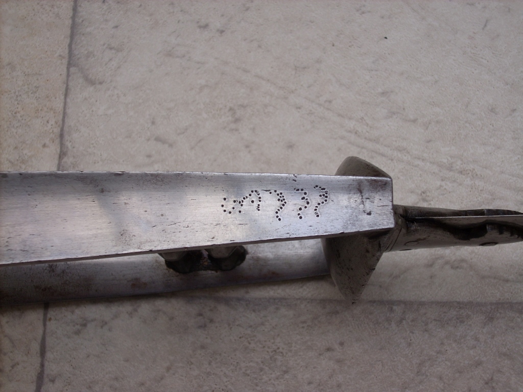

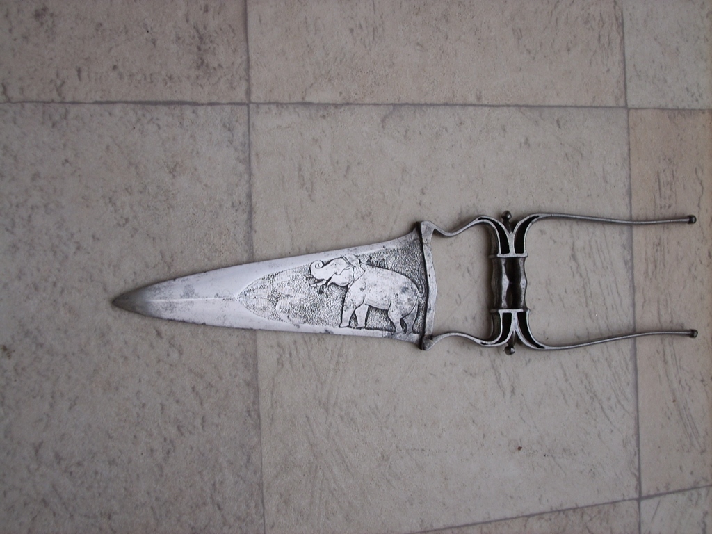

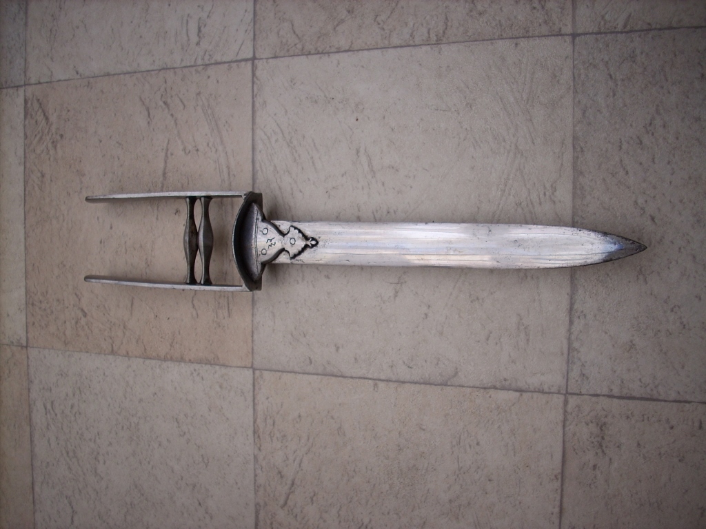

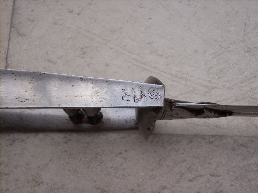

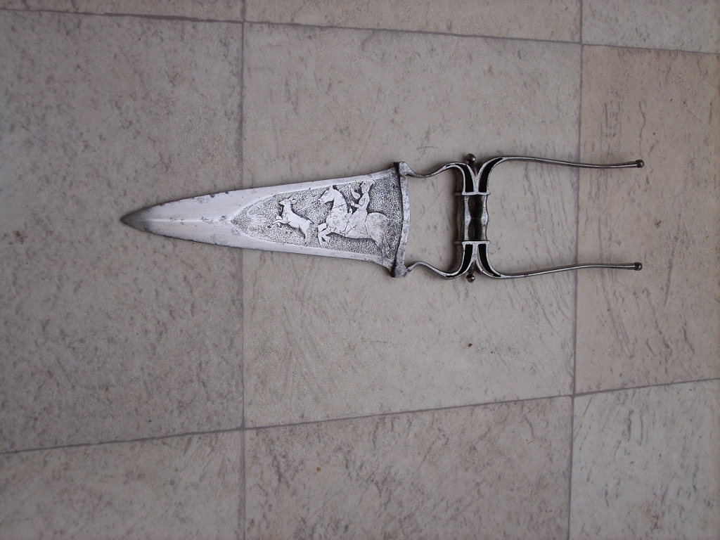

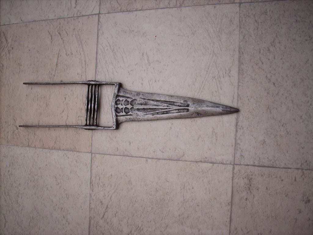

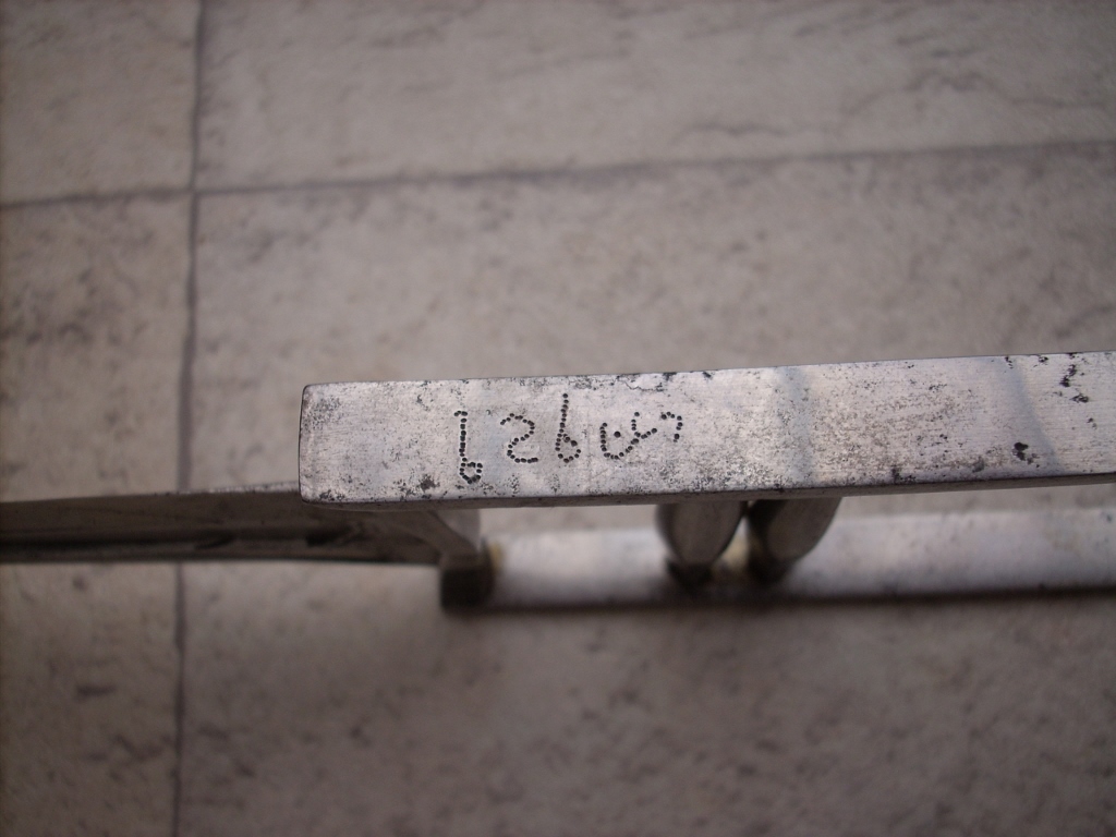

Hi Jens,
Thank you for your comments and information for which I am most grateful.
I have attached the photos of the Katar arms showing the inscriptions together with photos of my other Katar which has a more intricate design fo cross bar and more slender shoulders, it looks to be older than the Katar with the European blade and the one with the newer looking blade that I attached previously. Thanks again for your comments.
Best regards
Miguel
Old 10th August 2015, 04:56 PM   #12
Jens Nordlunde
Jens Nordlunde's Avatar
Location: Europe
Posts: 2,718
Miguel,
The first katar you show id a so called garsoe katar from Sind/Kutch.
The othe rone has the typical dot markings used in Bikaner - but I doubt that it is from Bikaner. Please show the whole katar.
Jens

Hi Jens,
Thank you for the info on the katar with the chased blade. The other images showing the dot marks are in fact are on the two katars I showed you previously, these being the one with the clean triangular blade with two cross bars and the one with the European blade respectively, apologies for the confusion.
Best Regards
Miguel

Miguel,
When you in the future show pictures, make sure that the friquence you show are of the same weapon - or everyone will get confused - I am still a bit confused.
Jens

Miguel,
Jens
Hi Jens,
Point taken sorry for the confusion. On my last set of photos the dot inscriptions on the arms of the katar shown on photos 2 & 3 are the arms of the second katar shown on my original photos and the inscriptions shown on photos 4 & 5 are those of the third katar shown in my original photos, trust this clears the confusion.
Best regards

Miguel,
You can sometimes see, the dot markings, on the side guards or on the blade, and some other markings on the weapon as well. these will likely be fro other armouries, although you can not be sure which of the marking are the oldest.
However a humble guess would be, that the Bikaner dot marking is the latest. If you look at where Bikaner is placed, quite to the north and in the midth of a desert, this is the likely end place for the weapons - but sometimes you are surprised.
Jens
