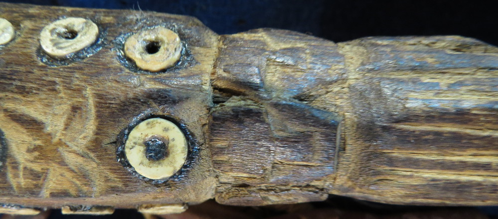

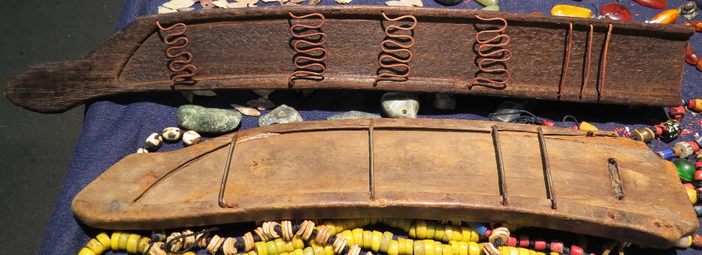

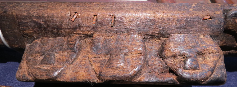

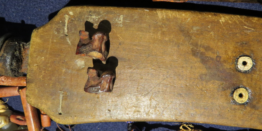

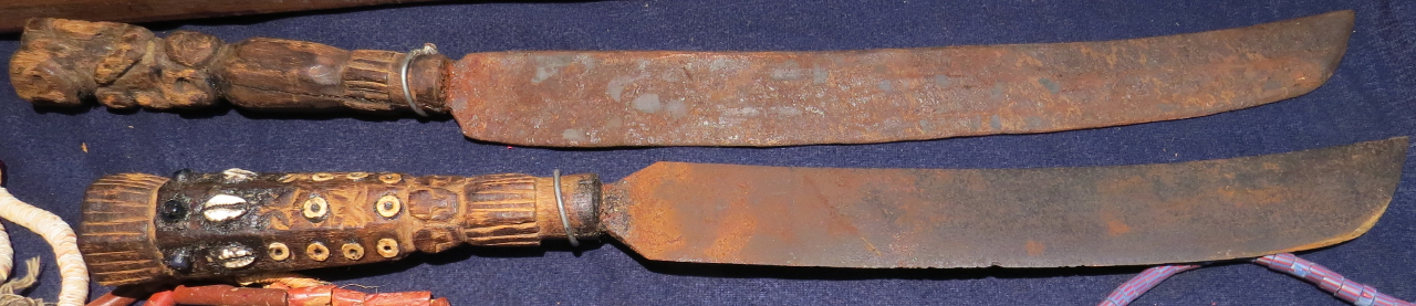

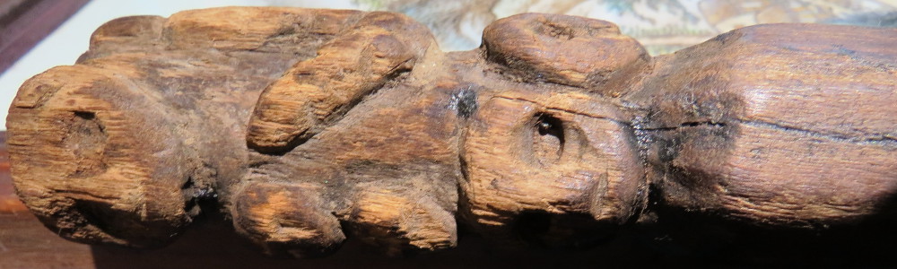

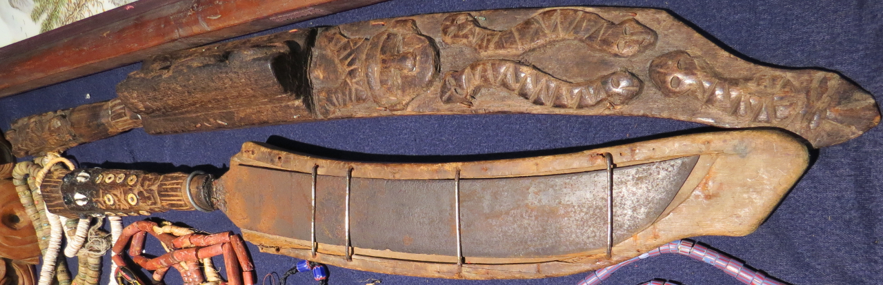

Hi all! I visited the Taipei Weekend Jade Market two days ago and found these for sale at a small stand. From what I've seen on the boards, they look legitimate. However, I'm no expert and would like to get your informed opinions before going back to buy them this coming weekend. The merchant let me take these photos, please tell me your thoughts! He's asking 6000 NTD for the small one and 9000 NTD for the big one (roughly $200 and $300 USD, respectively) as an opening price. For me, this is a significant amount of money, but if these are legitimate, they're also something I've been wanting to get for several years.
I have a few more pictures, but these are the bulk of them.

Driftwould:
We don't discuss prices on this forum, so we cannot comment here whether the prices you were quoted are reasonable. You could contact a forum member via email or PM if you want to discuss costs.
The two knives you show appear to have some age judging from the blade patinas and the wear on the wooden hilts. However, the scabbards may not have started out with these knives. In particular, the lighter scabbard looks as though it was made for a more curved blade--also, this scabbard was probably made by the Atayal people while the knife hilt resembles the Paiwan style.
The second scabbard appears to be Paiwan and the knife could be Paiwan although the hilt is so degraded it is hard to say which tribe that knife comes from (but probably not from the Atayal whose hilts are usually plain and straight).
There is information elsewhere on this site about Taiwanese knives and you can find discussion of the various tribal characteristics using the search function.
Do you have any more information from the vendor as to the possible ages or origins of these knives? How large are they?
Ian.

Your comment about the knife not matching the scabbard was very helpful, it seemed obvious once you pointed it out but as a pretty rank amateur that's the kind of thing I'm likely to miss. As for the state of preservation, I'm not sure what to expect to be available in the first place. They're obviously old and degraded, but as to how that compares with what else is or isn't out there I really don't know. Also, I'm not sure how to tell how old they just might be - except for what's been written elsewhere in the forum - and then I'd doubt my own dubious "expertise." That's actually the main reason I was posting about prices, was just to get a feel of where these knives fall on the scale of what's out there.
So... any other observations or comments would be quite appreciated, and thanks again!

Driftwood,

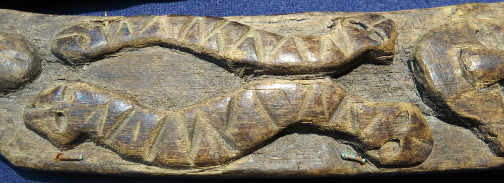

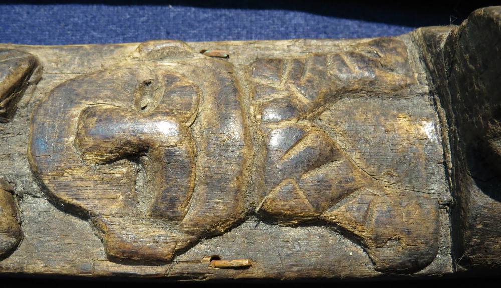

To my eye, these are age appropriate. The designs of ancestor figures and the representation of the paipushe snake are typical of the Paiwan. You can compare these renderings with others kept in museums and I believe you will find a strong match. Not proof of authenticity, but certainly proof of careful workmanship.
One must remember that the island tribes have been substantially affected in the last 100 plus years by the arrival of large numbers of Han immigrants from China and also by the long Japanese administration. Intermarriage, relocation, and other social mingling has occurred. As a consequence, the distinctiveness of the aboriginal tribes has diminished. Nevertheless, traditions carry on.
It would be my guess that pre-Japanese artifacts from individual tribes such as the Paiwan (Baiwan) are scarce and there is scant chance of such items appearing at a local market. but it could happen!
These do not look at all like mainland Chinese replicas. Pictures are seldom sufficient so you must judge the quality of the steel and the rest with your own senses. What I do know is I that you already have a story and also a that you are unlikely to find these weapons outside Taiwan. If you don't buy them, you will think about it for years. Finally, should you buy them and then decide you'd prefer the cash, I have little doubt that you could pass them on to another collector.
B/r
Dave A.

I would not go for any of them.
They do not look good, shoddy workman shift, possibly not authentic (kitchen knife blade made up rusty and recent sculpture aged for the sheath)
You can't expect to pay a real Paiwan knife less than a certain amount, and believe me, swords are expensive in Taiwan; they are scarce.
It might be easier to find one in the USA. Anyhow, I am sorry to say your budget is not enough.
Just go to Shung Ye Museum of Formosan Aborigines, to the Ethnology Institute of the University, go to Museums in Taiwan and enjoy the best quality. One day, you might be able to find and purchase a good sword.

I do agree with Bernard that these are not good items.
1- He is right when he says that there is a certain price to pay for Taiwanese knives. When authentic, average ones would be from 1000 USD (30000 TWD) to 5000 USD, the exceptional ones being able to reach 10000 USD, depending on the quality, age, provenance, tribe and rarity.

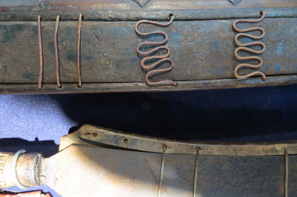

2-The one you are showing here are bad models made in the 50-60s for American troops stationed in the island. They are tourist items made 50-60 years ago that have been in addition bathed/dipped into a acid product to give them this "old/used" look. Believe me the authentic old ones are in better shape!
3-I would advise you if you really want one of these to follow the international auctions, some are popping up sometimes, but not cheap. or you can buy a new one, recently made by a taiwanese aborigine art craftsman/artisans. They are beautiful and cheap! Some of these knives have been discussed on this forum and some fellow collectors on this forum have bought some!
All the best,
Nicolas
