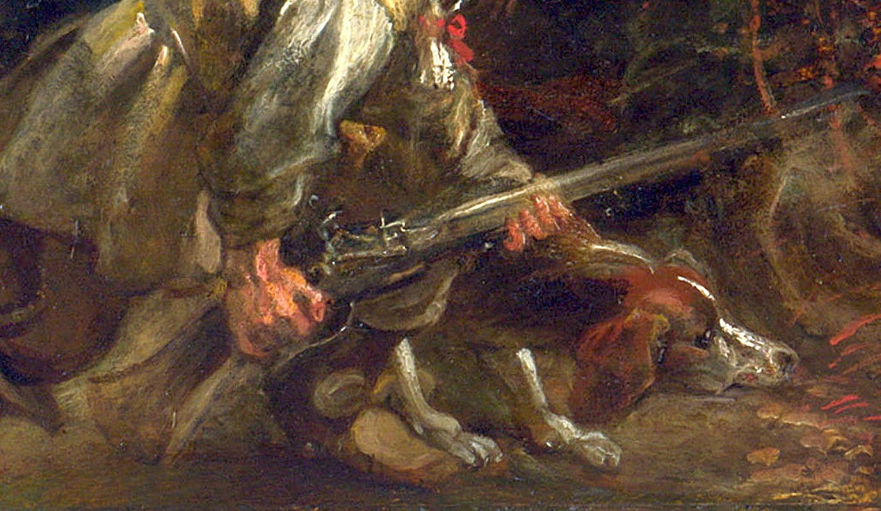

Greetings, I have been wanting to ask the members what variety of gunlock is pictured in Peter Paul Rubens An Autumn Landscape with a View of Hetsteen circa 1635. I believe it to be an agujeta of sorts. Detail in paintings leave a lot to the imagination. But given the time and place of the painting, agujeta or maybe some sort of romanlock seems likely.
Anyone care to take a stab at it?
[IMG][/IMG]

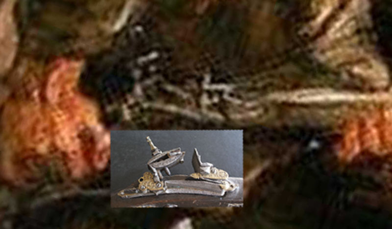

Fernando, as you may suspect, I am not a whiz at posting photos, so this one may be overkill.
[IMG][/IMG]

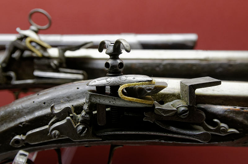

A comparison with one of our Algerian toe locks shown cocked and viewed at a similar oblique angle . Surely it has to be a toe lock which is one of the simplest and probably earliest form of snapping type locks . Competitive with the Miguelet in Spain , contemporary with the wheelock in Italy, widely distributed though Russia and primitive versions are still being used in Tibet.

i suspect there is a bit of artistic license in the depiction of the weapon in the painting (and of the dog).
p.s. -i'd posted (as attachment) a large screen capture of the hunter so we'd have it available in case Miqueleter's link broke. i have since found a much larger image of the whole painting to cut the hunter from & attached it above instead.
p.s. - don't think that helped much, still too little detail of the lock.

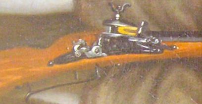

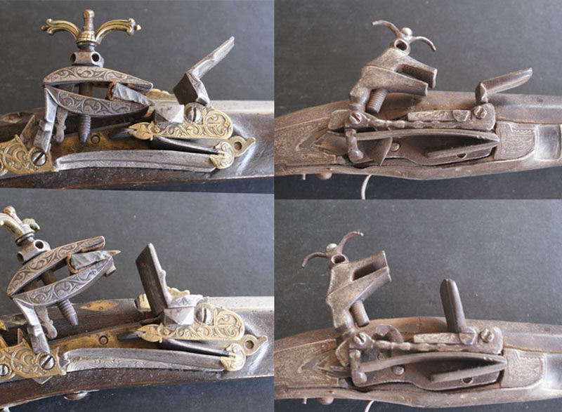

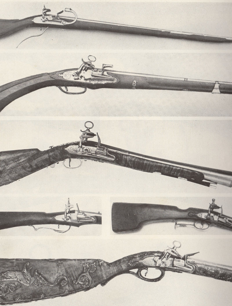

Sorry to labour the point . If we are going to assume the diagonal line across the lock plate is an external mainspring then in both miquelet and toe locks the mainspring starts being roughly horizontal , that is parallel with the barrel . Or in some migulet's slightly up hill . In the Minqulet since the spring acts on the rear of the cock at full cock it points either downhill or roughly horizontal . in a toe lock at full cock the mainspring points uphill which I think is what is shown in the painting . Yes, the miquelet shown is Albanian but the principles the same . Anyway , to help people make up their own mind here are a couple of aqujetas ; sorry I have lost the source of the painting but I think its Spanish and the other possible candidates which are italian locks .
For clarification the aqujeta was the Spanish version of the Italian toe lock or romanlock and may have been introduced from Italy. The defining characteristic of the aqujeta is the dog catch behind the cock used to resolve the half cock problem. The cock is pulled back beyond the full cock position and the dog catch pushed forward to engage with the cock . Pulling the cock backwards slightly automatically disengages the catch and the cock drops onto the horizontally moving full cock sear which engages with the rear foot of the cock .
