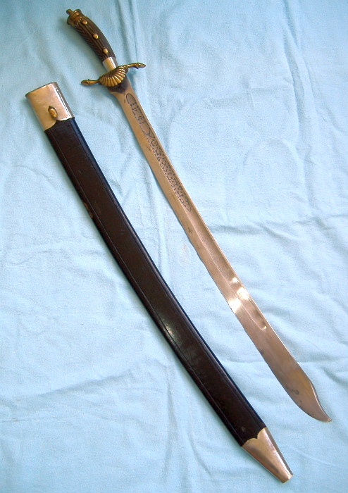

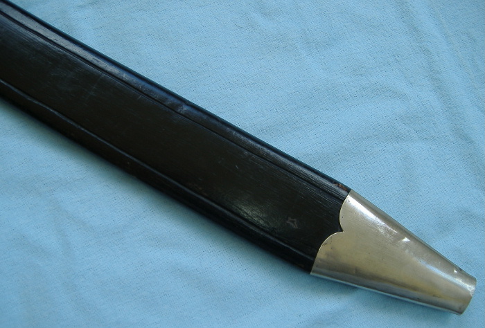

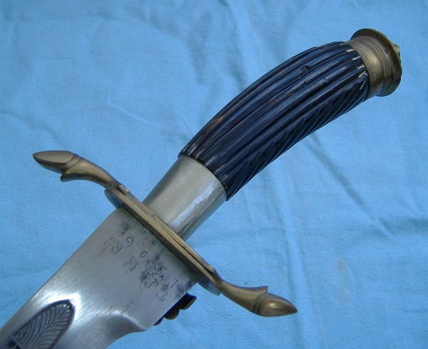

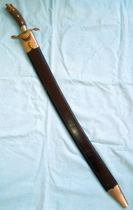

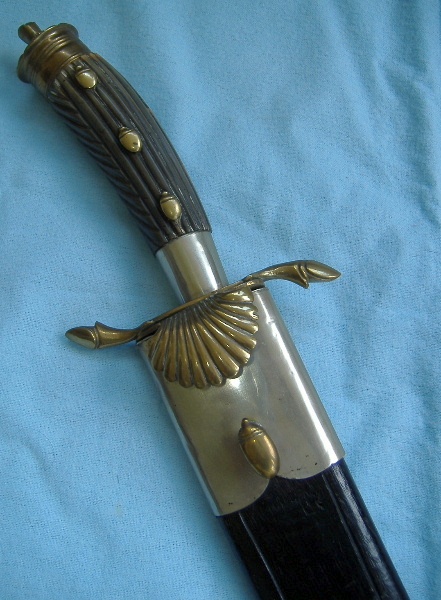

ebay auction just ended at 8pm (GMT+1), so i posted this for info & discussion. thanks for any comments or further info.
titled "SUPERB Indonesian/Dutch Klewang European "Hanger" Style Sword"
and it is.
vendor's description: (in part)

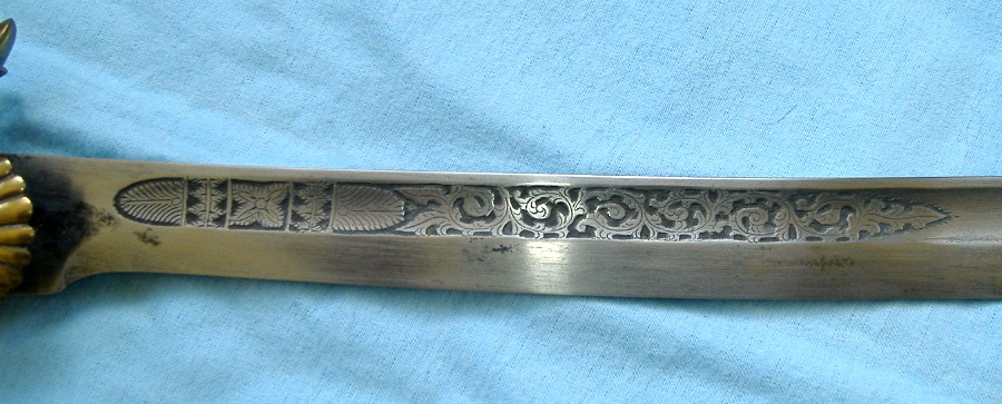

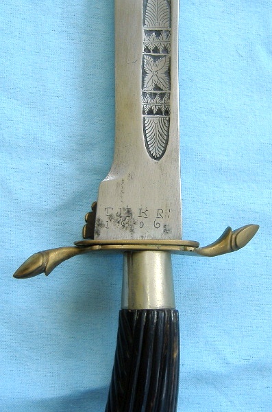

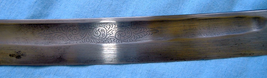

Here is a lovely old sword made in Indonesia for either Dutch or colonial troops there. The sword was made in Tjikeroeh/Cikeruh with its abbreviation on the forte of the blade along with the date '1906'. The sword is Indonesian made in the style of a European hunting sword or "hanger". The sword is 34.5in. overall, with an elegant blade of 28in. The blade has a "clipped" tip and is decorated in both chiselled and engraved floral motifs. The hilt is carved Asian water buffalo horn with a silver alloy bolster and brass "shell" guard and brass pommel and rivet rosettes, in a more European tradition. The scabbard is designed/carved to look like it is covered in leather, like similar traditional European types, but it is actually wood painted or lacquered black, as leather does not hold up well in tropical climates. The scabbard has brass and silver alloy mounts.
This is the finest example of this type of sword I have ever seen and is complete and in superb condition with a flawless blade!
nice pertinent and decently complete info.
blade appears to have a few age spots, but then, so do i.

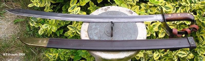

anyway, it's shortly making the journey from the USA to live with me here in the UK.
i noted a few very similar hunting swords from the same period (1st decade 20th c.) in earlier posts here after a search on 'Tjikeroeh'. (Linky)
ebay's vendor supplied (now public domain) photos attached, better than i could take

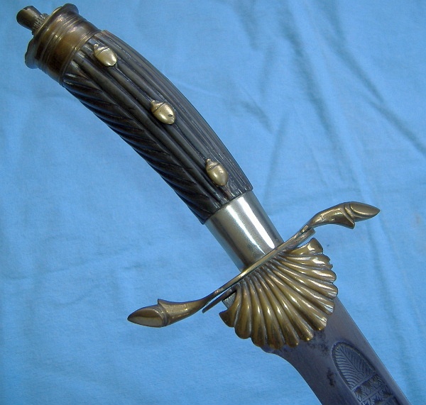

Very nice example of an Indonesian version of the Dutch military klewang done up as a European style hunting sword. Congratulations on a good find. Although there are a few of these around, this is a really nice one. I like the brass beetles on the hilt and the one on the throat of the scabbard--very nice touches.
The fittings on these are usually brass, so the white metal (silver?) ferrule is a bit out of place, especially given that the other ferrule on the hilt appears to be brass and there are brass mounts on the scabbard. The white metal ferrule might be a replacement and this would be an easy change to make since the tang on these swords is threaded and the small nut on the butt of the hilt unscrews, readily allowing the whole hilt and guard to be unmounted quite simply.
I would be interested to know what you think the horn handle might be from. These are often a type of stag horn rather than from buffalo, and I wonder whether yours is also stag that has been rounded, carved and blackened--you may be able to tell by removing the hilt and examining the ends and insides of the horn.

That is a HUGE blade for one of these !
Beautiful .

might be the photos but the scabbard mounts are supposed to be silver alloy the beetle is in brass as a contrast. it goes brass -silver-brass-silver-brass-silver, which seems OK to me.
thanks for pointing out they are beetles - i'd not noticed that detail. cool.
i gather it's blade quite long for the area. good size for a sailor.

Those are supposed to be Acorns not beetles; traditional European hunting sword decoration .

p.s. the dutch hembrug klewang has a blade about 63.5 cm. (25 in.) which is the same as my solingen one. i gather they were developed to replace the longer european swords which were not doing well in the jungle against the shorter swords of the insurgents they were fighting.
so this new one is a few inches longer at 28. which is my size. i remember being measured for my USCG officer's sword which was 28, just long enough so i did not hit the ground saluting during parades. saw someone who mixed his sword with his taller room mates once during a pass in review. he hit the ground and the blade snapped off. he finished going past the admiral with just the hilt and an invisible sword his partner with the too short version managed to spear his dress hat as he went to bring the hilt to his lips in the start of the flourish. it did not turn out well for them two, but it was funny. i do always remember i take a 28 tho.

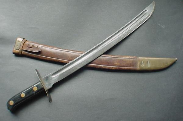

Another Indonesian (Tjikeroeh) sword based on the Dutch klewang (bottom) shown with two Dutch klewangs: a traditional Dutch military issue klewang (top) and a Japanese-modified version following capture of the Dutch East Indies in WWII.
Old 20th June 2015, 07:34 AM   #12
interesting & beautiful heiho conversion. most retained the riveted grip, cutting back the hand guard to a simple shortened cross guard. they also shortened the blade, removing the clipped point.
std. heiho (left/top - not mine), my solingen dutchy (bottom/right)

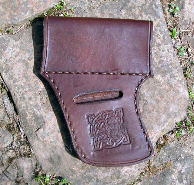

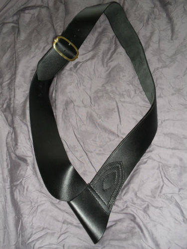

sword just arrived, i'm happy.

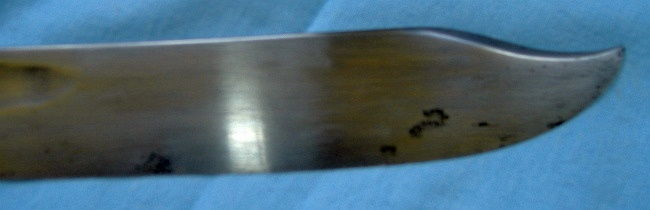

blade is actually 26 in. long, from guard to point. 1 1/4" at the front of the ricasso. 5/8 in. thick there. distal taper to point. 1 3/8'' wide at mid point, 1 5/8 wide just before false edge. razor sharp with no apparent secondary bevel added by user sharpening. some blackened spots but not really pitted. one major ding in the edge needs steeling and a light stoning. corresponding ding in the wood scabbard, so unlikely battle damage. horn grip, pommel, guard all tight to blade, shell guard wiggles slightly. weight 990 grams in scabbard, 790 grams unsheathed. silvery metal on scabbard looks like german silver sheet. the scabbard is not up to the quality of the sword itself.
feels quite nimble in the hand, balance is about 7 in. from guard.

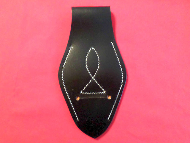

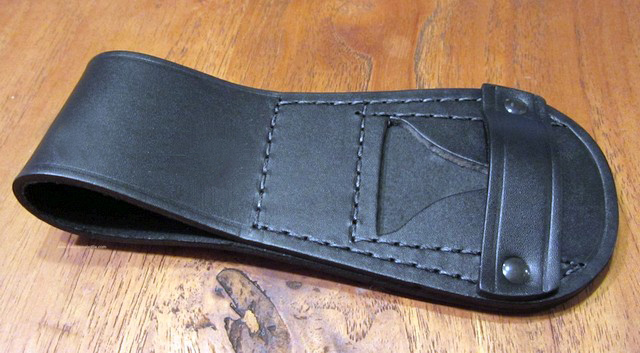

next, i'm looking for a suitable belt frog, anyone have any photos of what kind of frogs or baldric that would be appropriate? ive so far pinned it down to these: the brown one may get dyed black.
