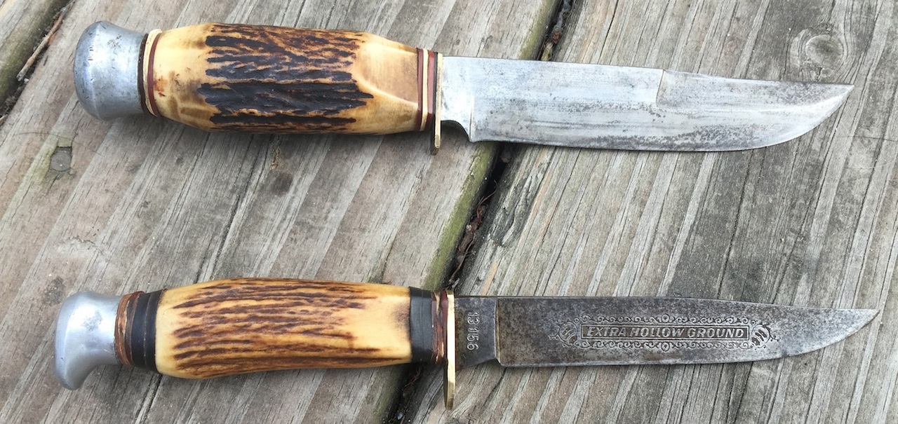

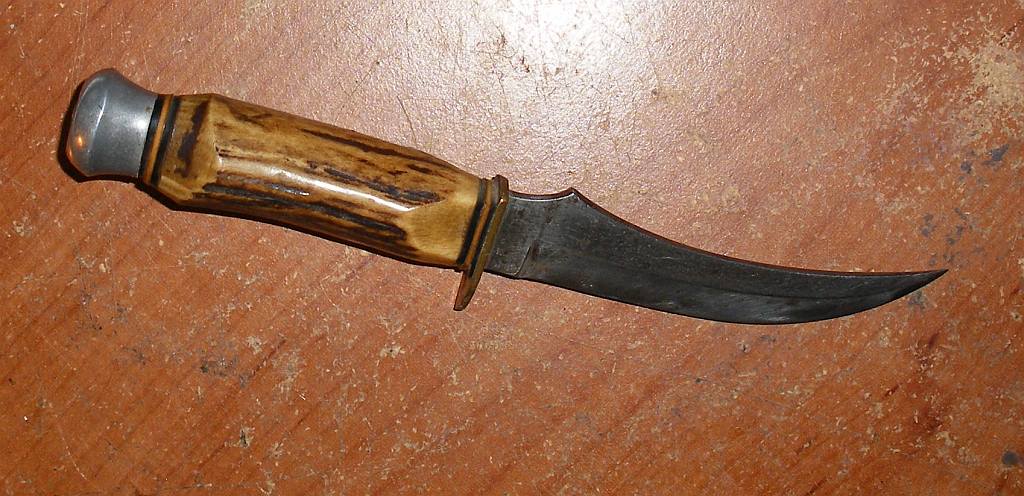

OK, here are some pics. I would love to get them cleaned up to carry. I live in a state where you can carry anything you want anywhere, although I usually carry smaller things. I do hunt though, so they may be tasked for that. You can see the marks, the spacers, and the strangely abused pommels.

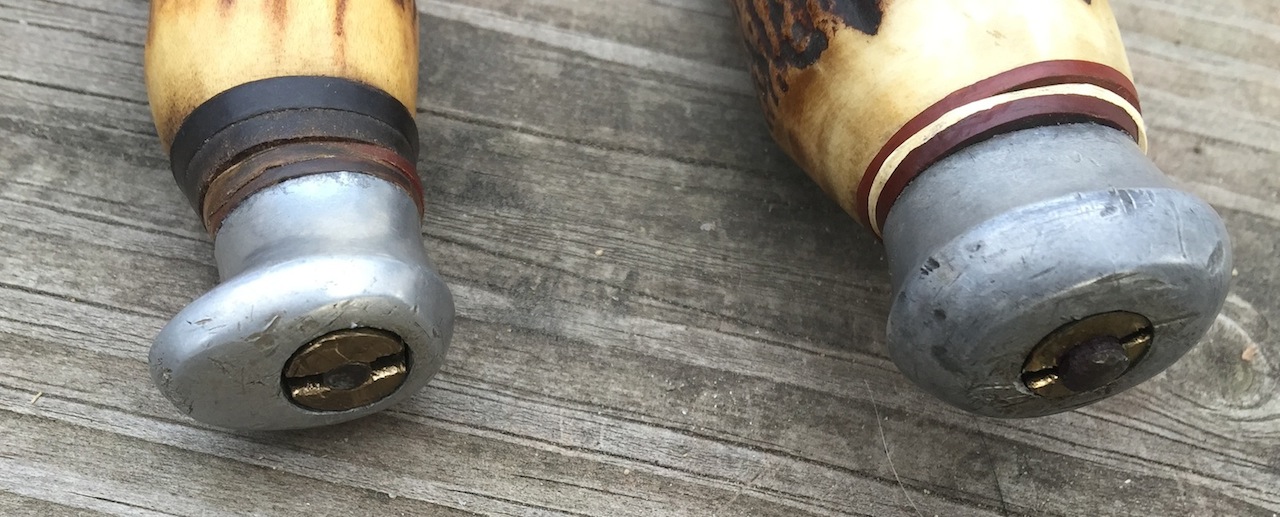

You can see that the tang is peened within the brass slot, so to replace the spacers I think I would have to grind off the peened over end and thereby shorten the whole thing by some amount. On the hollow ground knife the spacers look to be horn, but they are plastic on the other one, bakelite or something.

Old 3rd May 2015, 11:22 PM   #5
trenchwarfare
trenchwarfare's Avatar
Join Date: Oct 2008
Posts: 385
If the spacers, and ferules are out of alignment, the handle is probably loose from stag shrinkage. First, see if the pommel will unscrew with just hand pressure. If not, try wrapping in leather, or rubber and use a vice. Don't use too much force, if corroded, you might snap the tang off. If the pommel just turns around the nut, penetrating oil, and a spanner wrench is needed for the nut. Once you get the handle off, clean the blade with whatever method is needed. Really need some pictures to know how rusted the blades are. If not bad, oil, and steel wool will do the trick. Then, clean the handle components of crud, and re-assemble, using a drop of epoxy between them. Screw the pommel back on. It can be a little tricky, keeping them all aligned. They weren't made that way. Handle components were tightened down with the pommel, and final shaping was done after assemblage.
OK, so the end of the tang is threaded in there? I had thought it was peened over, but thats good news. Can you not see the amount of rust on the blades? The only one Im only concerned about is the etching on the one blade, its not too deep so I don't want to get too aggressive with the polishing.

Old 4th May 2015, 12:22 AM   #7
trenchwarfare
Join Date: Oct 2008
Posts: 385
You hadn't posted pictures when I replied. Must have been while I was typing. OOOO steel wool, and oil is all you need for the blades, It won't hurt the etching. The pommels look loose to me. There has been some sort of spanner wrench in the slots.
Yes, some kind of tool has gnarled the bejeezus out of the brass. I think I can dress it with a very fine file and then use automotive sand paper the polish it back up. I don't know how much time I will spend on them, but they are nice little knives. Its funny, normally I can find some kind of particular collectors website on any variety of knife, but not these. One thing is, Im given to understand that the "RJ Richter" is the importer, not the manufacturer.

You need a screwdriver that fits the brass pommel nut. Grind a "U"shaped groove in the center deep enough to fully engage the slots on either side of the tang and unscrew. When you grind this, make sure the screwdriver blade is kept cool or you'll lose the temper!

Thank you for that process. I'm thinking about replacing the spacers since many are chipped at the edges which contributes to them not lining up properly. Jantz supply, here. I come. I'll probably end up making new sheaths since the originals are so tattered. These are another example of what happens when someone who does not esteem blades has them in their possession.
Btw, I think that someone tried to get rotation on the nut by tapping in with a nail set or something, it would explain why the pommels are loose and the nut is chewed up.

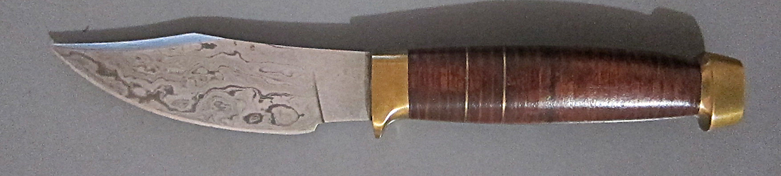

You can use other materials for spacers, when I've restored this same type of handle, I've used gasket material from an auto parts store, but I've also used brass shim.
I would not use wood because I can't think of a wood that could be relied upon to take the pressure. Maybe lignum vitae would be OK --- that's the stuff they used to use for bearings in marine engines --- but you probably don't have any of that. Wood would absorb moisture too. Not good. Nope, wouldn't use wood.
The pic is a knife I made maybe 20 years ago, rip - off of one of the old Marbles patterns:-
http://www.bladeforums.com/forums/sh...rble-Woodcraft
I think this pattern was maybe the most popular pre-WWII belt knife in USA. Great knife. I had an original for many years, some misbegotten mongrel thought he needed it more than me.
Anyway, look at the Marbles, couple of different coloured materials as spacers.
The knife I did has the handle on in the same way, but it is stacked leather, and includes brass shim.
I like old Solingen knives, I've got a lot of pocket knives, and I never move without one, but probably the one I carry most is a 1930's Dirlam. Excellent design, excellent performance.

You need a screwdriver that fits the brass pommel nut. !
Here's a commercial tang nut tool that fits Marble's and many German knives like yours with a tang nut in the pommel. It gives a good idea of what you need to make to remove the nut.
I did indeed make one but it's interesting to see that a multi width tool is or was available. I wish that they had put a hole in the center so you could run something through there and get more leverage/torque.

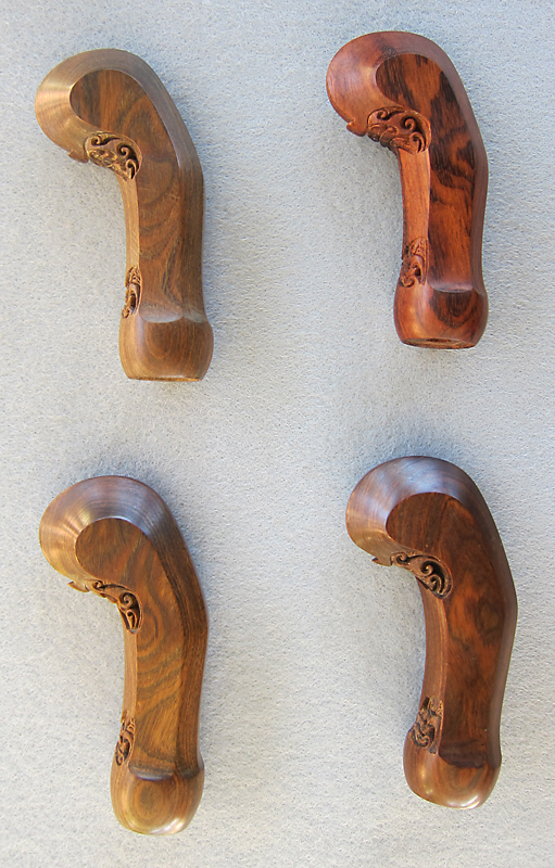

Old 6th May 2015, 08:03 AM   #23
just to expand on AGM's fine info. lignum vitae is/was used in stern tube bearing & seals around the hull penetration of large low speed ship's propeller shafts. the seals used a trickle of water to lubricate and cool the wood bearing. lignum vitae essentially doesn't absorb water and is very hard and wear eresistant in this service. it also is denser than water (it sinks) and is not only expensive, but hard to find any more, the true LV is an endangered species, but small chunks for gun grips and knife handles can be found. wear a dust mask if you DIY (LV has medicinal uses when powdered). i used to see a lot of it around ship yards in sea ports as the wood was installed in dovetailed strips and needed replacement every decade or so. that source has dried up. modern seals are mechanical oil seals. great when they work, but a horror if they leak.
LV also makes nice clubs and walking sticks. and it looks really cool polished up. also traditional for carver's mallets, marlin spikes, gavels, lawn bowls, wooden jars, etc.

This is what lignum vitae looks like.
Old 8th May 2015, 01:21 AM   #25
Posts: 6,436
I have a good sized LV carver's mallet; you keep it waxed or it will check; it's a heavy bugger .
Good for deadeyes also IIRC .
