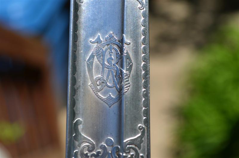

Thanks for the input; this sword is a bit of a mystery to me.I can not really make out the stylized royal cypher or the crown and the sword seems transitional.I'll post pictures after negotiating with my photographer (my wife), and hope for help from the forum.

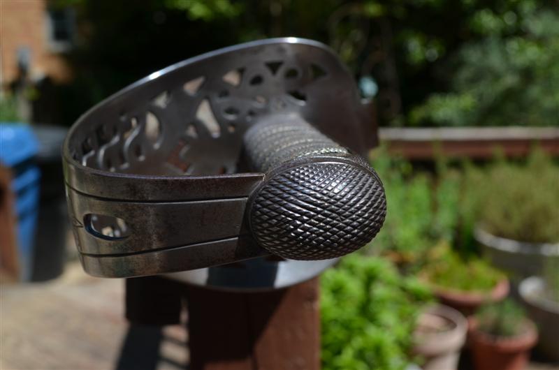

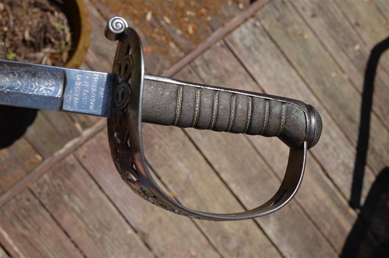

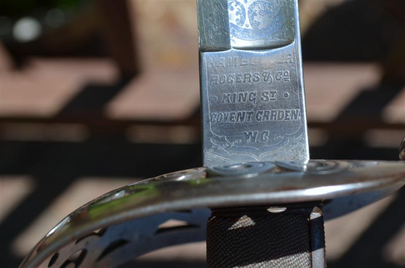

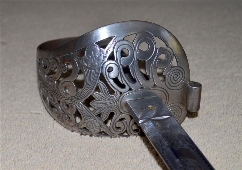

I hope these pictures will help.

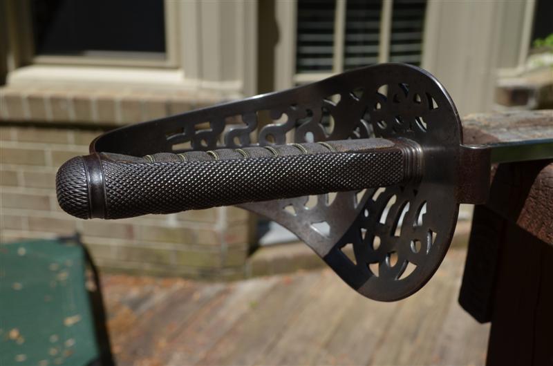

This is distinctly an Edwardian era (1901-1910) cavalry sabre as indicated by the Royal cypher. These are discussed in Robson (1975, pp.75-77) and of the basic pattern used 1822-1912. There were however some subtle changes in the hilt.
What is notable in this example is that the crosshatched backstrap of the hilt extends full length. In the heavy cavalry undress pattern of 1887, the hatching breaks mid point with the top part smooth. The pommel in all is a crosshatched dome (the 1887 example has a capstan, this does not).
On p.75, Robson notes that in the Army order of June 1,1896, there was not actually a new sword (of this type) introduced for ALL cavalry officers (the distinction between heavy and light cavalry remained by regiment in degree but not as far as swords from 1853 onward).
Apparently the order simply introduced a NEW pattern for LIGHT cavalry officers....and the variations in this example lead me to believe this is one of these.
Hamburger, Rogers & Co. were quite high end outfitters who had been appointed officially to the Crown in about 1850s and while carrying swords they also provided high end dress uniforms and regalia. While Hamburger, the original owner died c.1850s, his partner Rogers maintained the highly established name well into the 20th century.

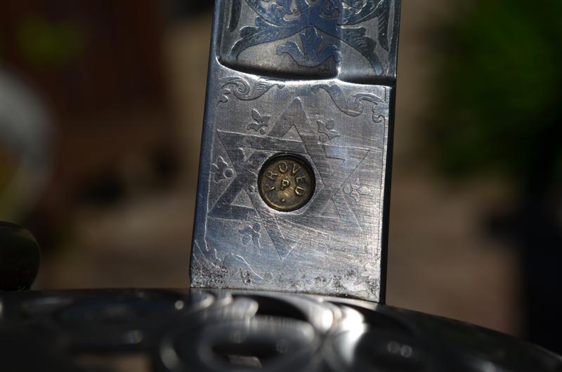

I believe it would be accurately classified as a Light Cavalry Officers sword 1901-10. The brass plug proof device (as begun in general use by Wilkinson in 1850s) with Star of Solomon surround typically had an initial or symbol in the center denoting which outfitter may have made the blade, however regardless of the chart in Annis & May, I have often found these unreliable.

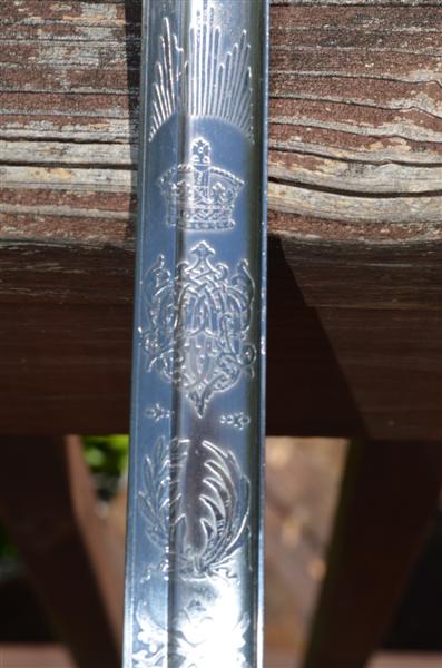

Thank you for your extensive and informative answer.The sword must have been for a very tall fellow as the blade measures approx. 36 1/2" x 1 1/8" at the base.Would the 4 digit number on the spine be a batch number, an issue number, a model number, etc.,?

Comparing this sword to that on pp. 166-8 of Dellar's new book 'The British Cavalry Sword 1788-1912' it looks very like the 1896-1912 Universal pattern cavalry officer's sword. The illustration used, of a sword of the 3rd Dragoon Guards, has a blade 35" long by 1and1/8" wide, double-edged for the last 8and1/2".
Hope this helps.

I just noticed that on the spine there is a very prevalent , well done fletched arrow, about 2 3/4" long; before the fletch there is a C, in the middle of the arrow there is a star, and after the point there is a P .Does this have any bearing on the sword?
Old 27th May 2015, 03:35 AM   #10
Will M
Will M's Avatar
Join Date: Mar 2012
Posts: 431
Centre of percussion mark. It shows the point where the sword gives the most cutting power by striking your target with that point of the blade. Usually about 2/3 to 3/4 the length of the blade.
