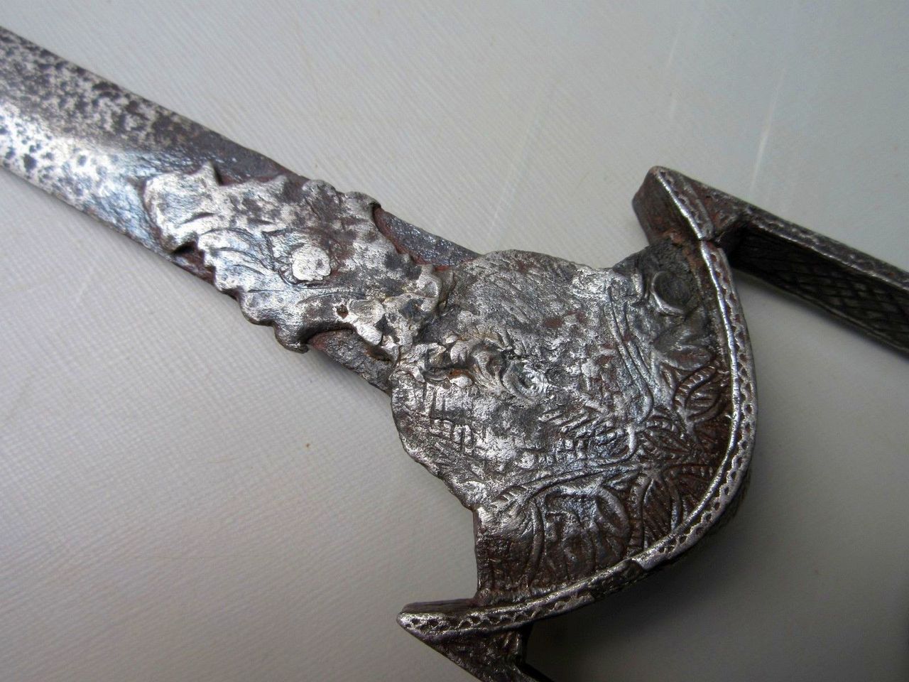

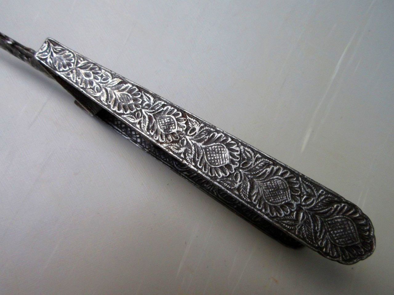

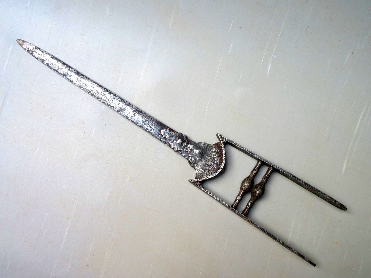

thanks for any info on this. i've always wanted one, but missed out on auctions till now. got this reasonably cheaply from a dealer in the middle east.
billed as:
Antique Katar Dagger South India 17th c
Interesting South Indian Katar dagger . Early 17th century.
General dimensions:
505 mm – Total Length
330 mm – Blade's length
30 mm - Handle's Width

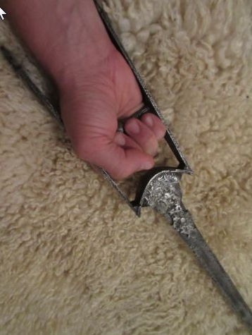

note: queried him on the handle width, it's larger. dealer sent me pics of him holding it by the bar grips, which he says are 70mm.

Interesting piece. Many of these from South India have this type of blade.

Posts: 61

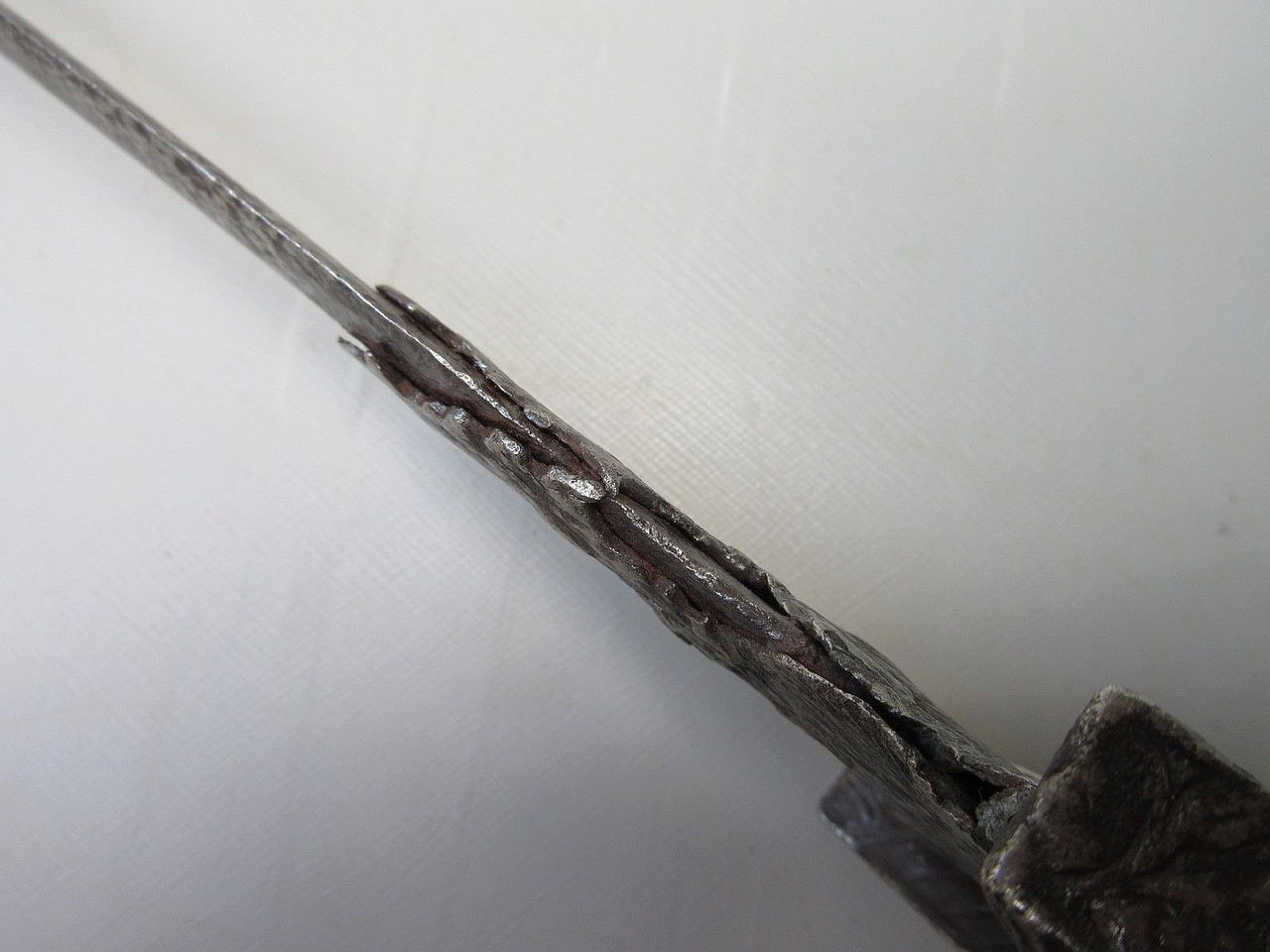

maybe a cut down rapier blade. A shame about the welding repairs to the blade mounts though

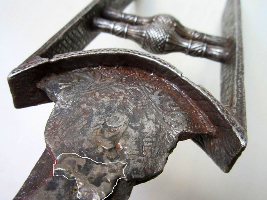

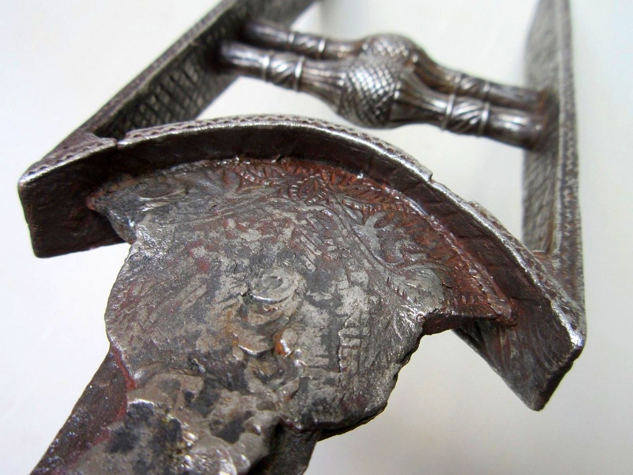

he has a number of similar ones on offer, i got mine for about half what the others are starting at. can't discuss those tho.

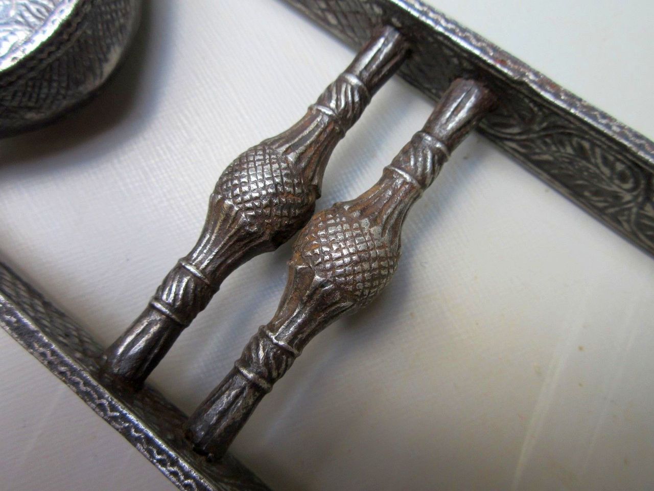

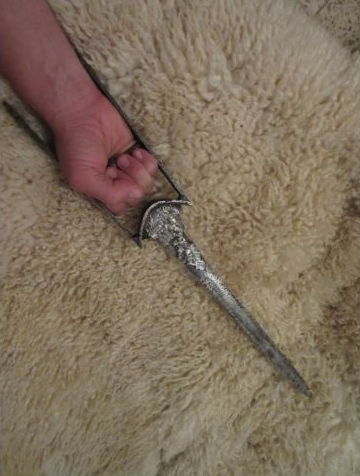

top 2 in-hand photos from vendor - he may, of course have small hands
p.s. - vendors/forumites - always best to show an in-hand photo for scale.
bottom, edge on view of blade mounts

Jens Nordlunde
Jens Nordlunde's Avatar
Location: Europe
Posts: 2,718
The length of the cross bars can wary, but not very much.
I have one katar where the cross bars are 6 cm, one where they are 8 cm, but the rest are 7 to 7.5 cm.
Should I use a katar the cross bars would have to be 10 cm.

she's here. weighing in at 554 grams (1.22 lb. or 19.5 oz.)
75mm across the bars inside & a tight fit for my hand for all 4 fingers, better if i leave the pinky out

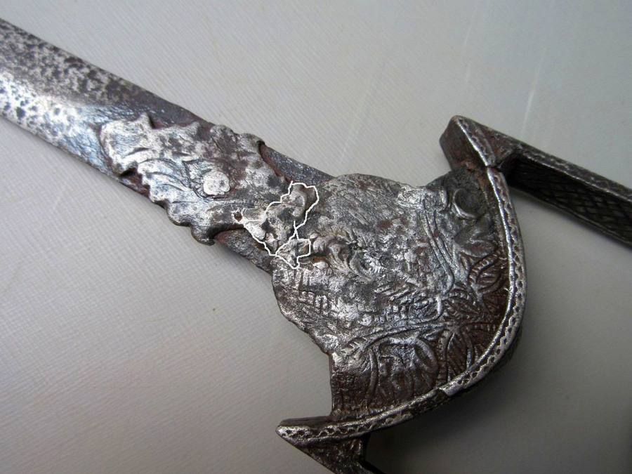

the red rust in the photos not evident, even in sunlight, i suspect the vendor brass brushed it and oiled it before shipping. no evidence of welding i can see except for where the mounts join the main bar & that looks like it was made that way. the filleted corners of the side bars also smooth and look like they've always been there. the blade while lightly pitted looks a fully functional broken off sword tip. what appered to be 'cracks' in the mounts are not & no sign of welding, just some sort of worn figurine or decoration & well worn rivets.
all in all seems a nice old gal - a bit tired but still up for a good go.
Old 7th May 2015, 08:40 PM   #8
ashoka
ashoka's Avatar
Join Date: May 2005
Posts: 61
nice early Katar, welding areas circled. They've been blobbed and ground down a bit to make them less obvious, at least that's what it looks like from these photos.
ashoka is offline   Reply With Quote

Kubur
Kubur's Avatar
Posts: 2,145
I totaly agree with Stefan.
Now what does it mean?
- A weakness of the joint between the old German blade and the Indian hilt?
- Or a fake?
I just ask because I always wondered about this kind of katar...
Old 7th May 2015, 10:27 PM   #10

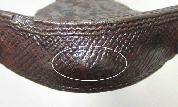

i see the areas mentioned- not as obvious when you actually see it under a daylight light. oddly, in the inside of the bowed area, which is chequered, it looks like there is an area in the centre about 10mmx5mm where it is polished, but chequered and slightly raised almost like a slot where a stub of blade tang was peened (or hammer welded) over & polished & chequered over. in any case the weld repair was a long time ago.

ashoka
ashoka's Avatar
Join Date: May 2005
Posts: 61
Just a common spot of weakness at the thinnest point after centuries of rusting. Not a bad way of repairing it really, if repair is what you're after. Lots of things surface in bad condition especially katars, and unrepaired would make it harder for the Indian dealers to sell to most collectors. I also reckon the welding at the base of the mount is new within the last few years. The stub at the back of the front bar is probably where tangs from the blade mounts went through and were peened over. There was no welding used originally at the front.
- Or a fake?
