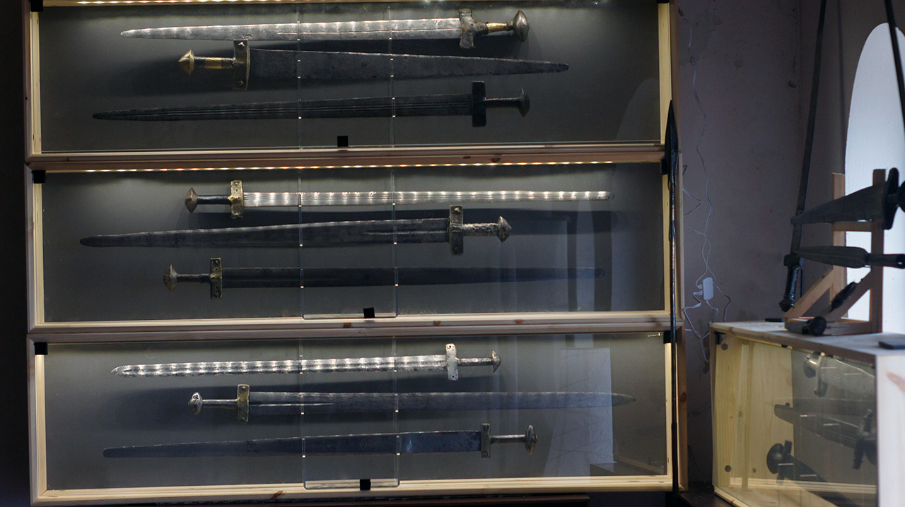

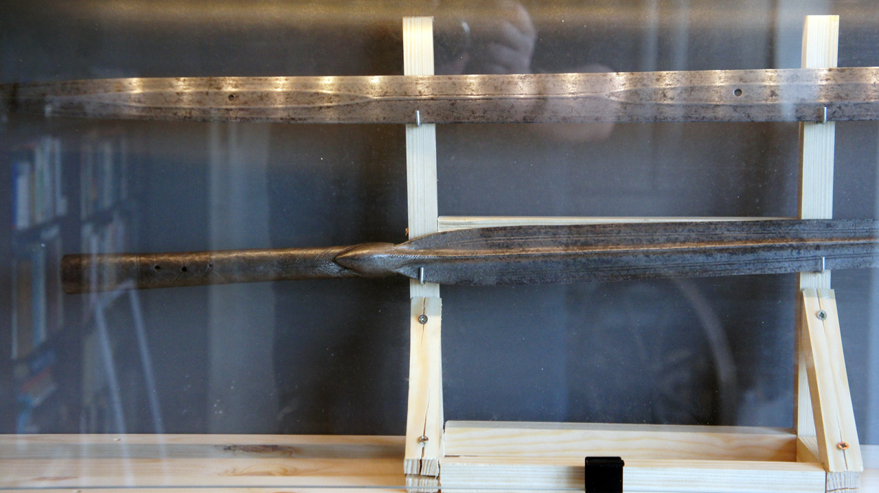

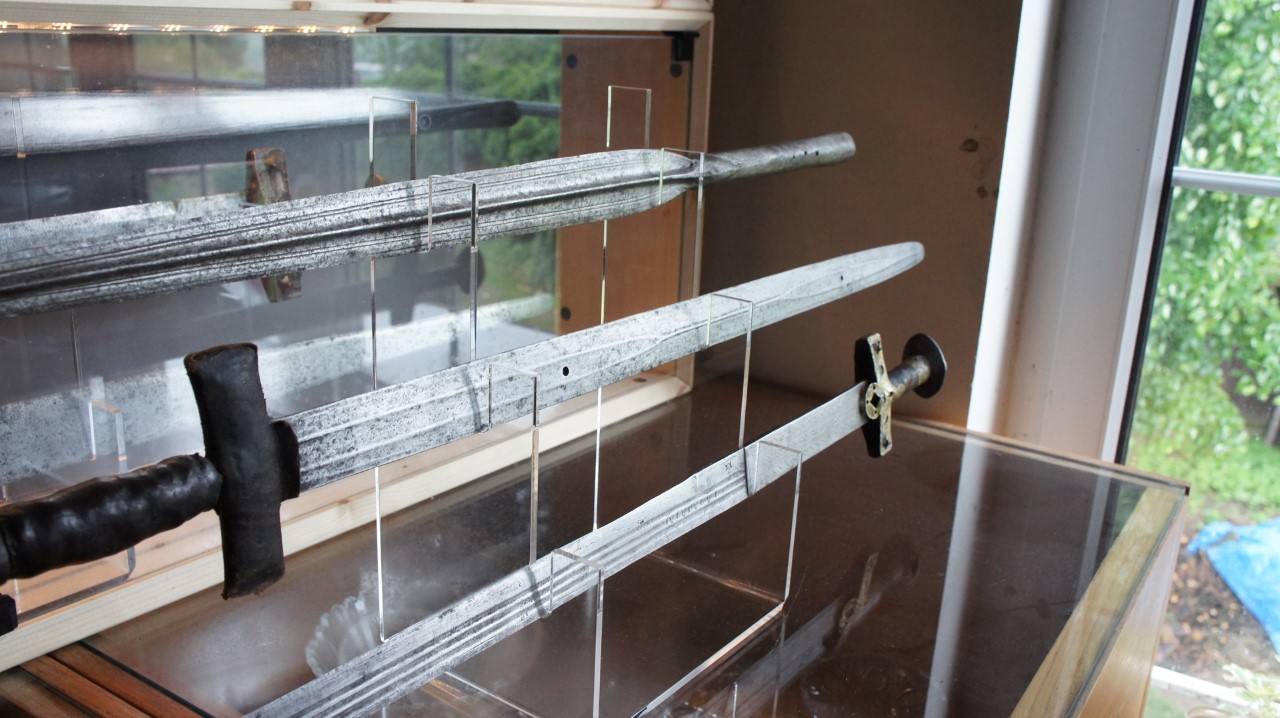

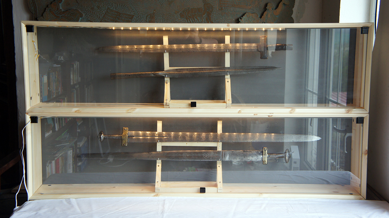

This might be of interest for some. I have been testing out some sword case ideas recently.
These have glass doors and I have fitted LED lights inside. The stands inside are rough and not a final design.
If anyone is interested the main cases and the LEDs are all from Ikea, not very expensive and very easy to put together.
These are just a few quick pics, the glass is still a bit dirty as I just put everything together!

I'm in the process of making up some clear acrylic stands and hoping to get 3-4 swords into each case.
The dimensions inside are about 120 x 35 x 18cm. Not sure if its enough for guns, but would definitely work for most swords.

Highly recommend it! They look nice and are very easy to fit. I just used some double sided tape.

Posts: 1,720

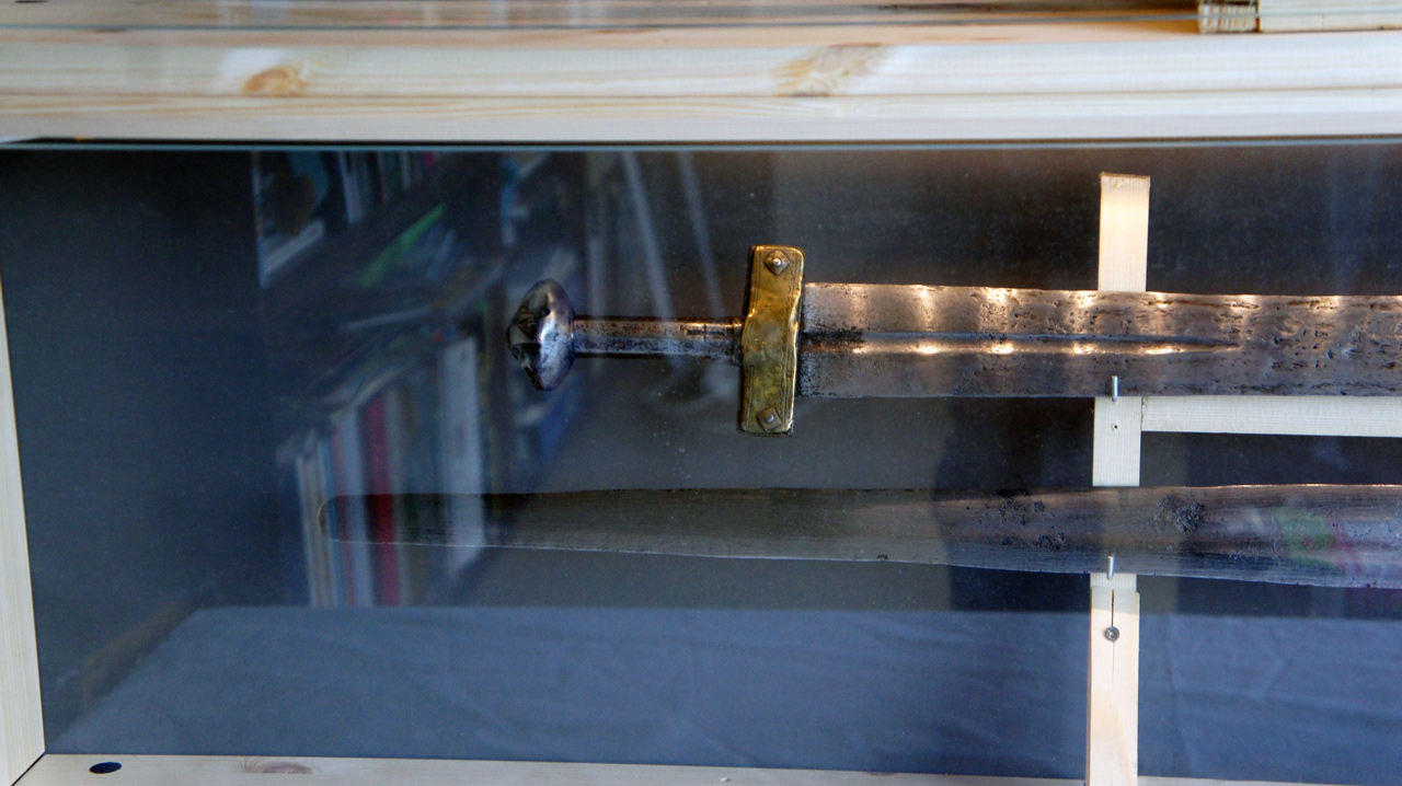

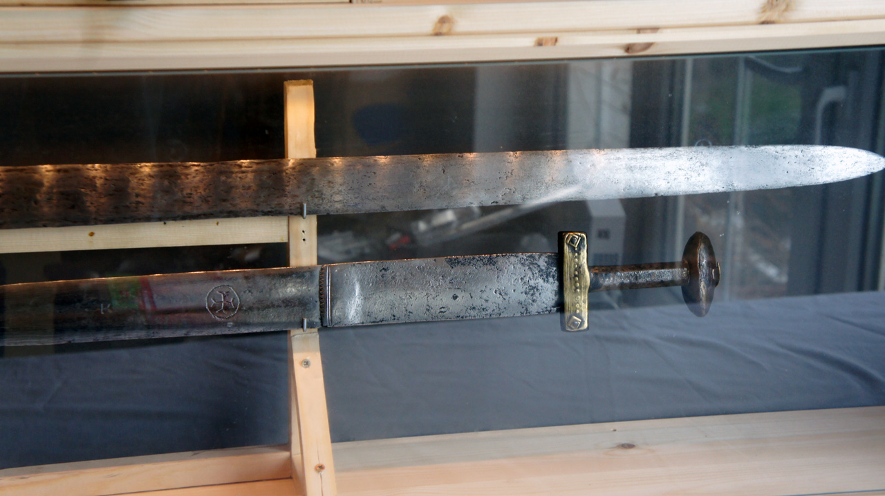

Got some acrylic stands made up. Still working on lighting...

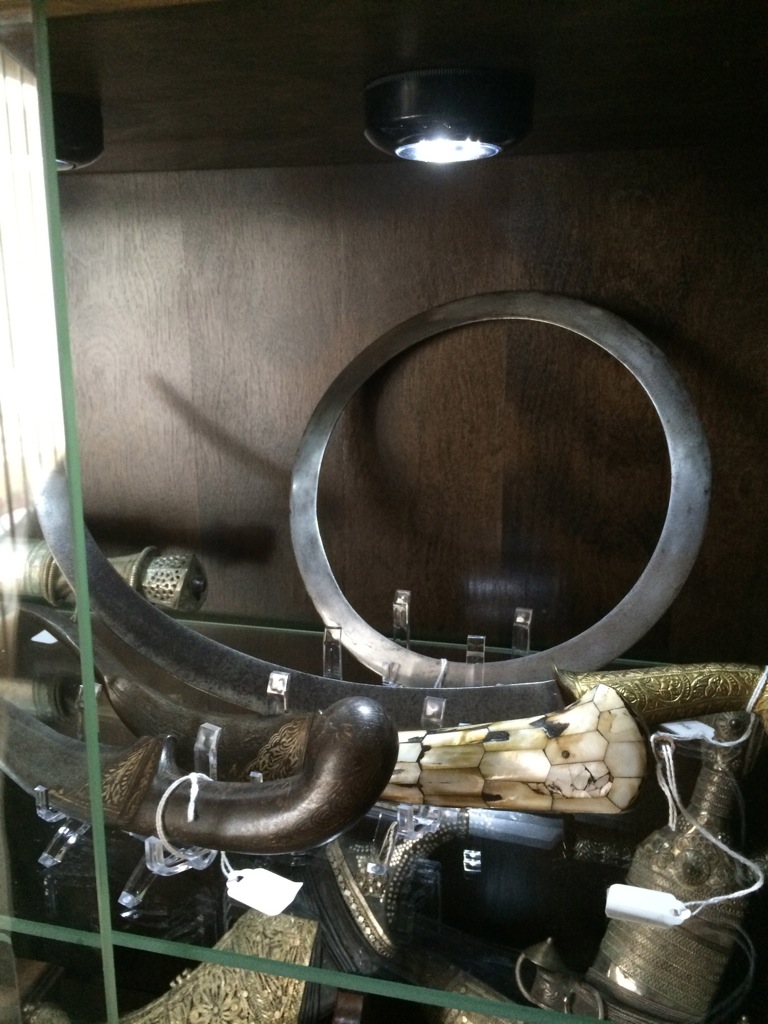

Lightbulb LED Lighting

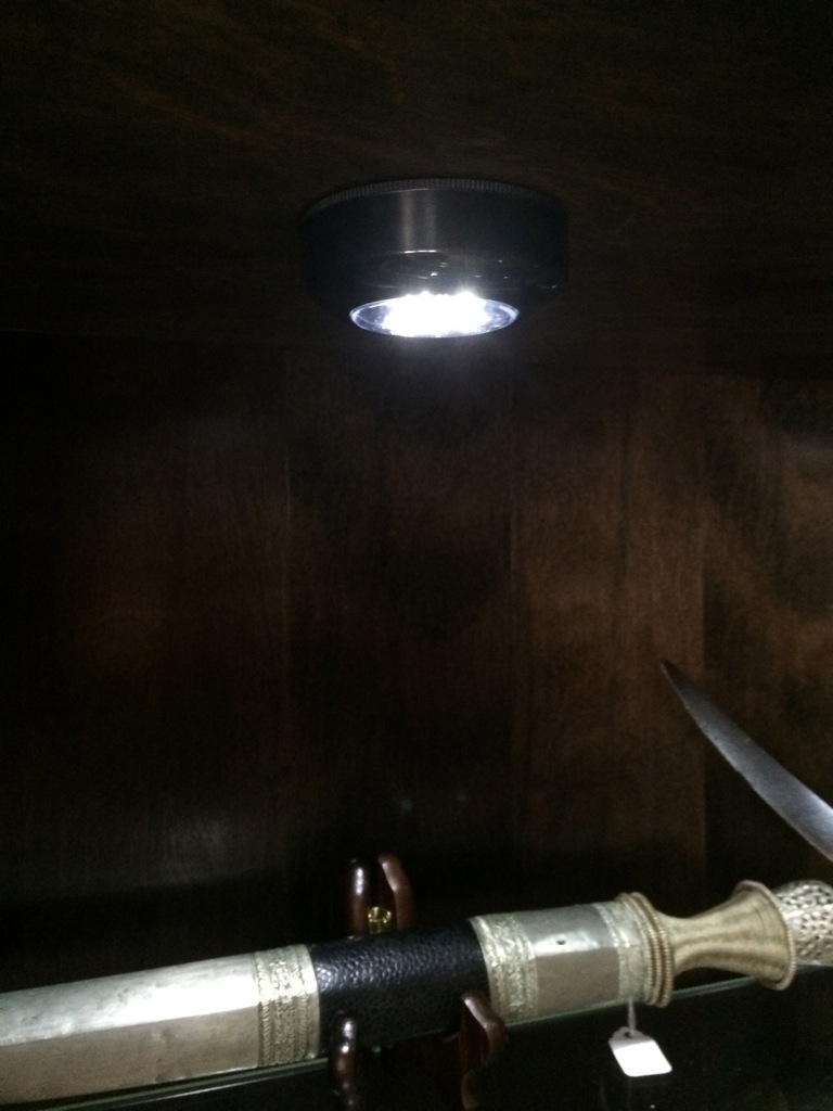

I've tried the strip LED lights in display cabinets but the light and shadows are very unnatural. Recently I've found these online:
Fulcrum LED Battery-Operated Stick-On Tap Light, Black
The lighting is very natural daylight spectrum. The are in-between spot and flood up close. AAA Battery powered, tap on tap off. Super easy install. If use use the every day, evenings, expect to change ordinary batteries about every six weeks. And, they are very inexpensive so it won't cost much to experiment.
I use mine in a wood case, behind glass with interior painted flat black. Anything silver really jumps out and looks great. I will post pictures later,

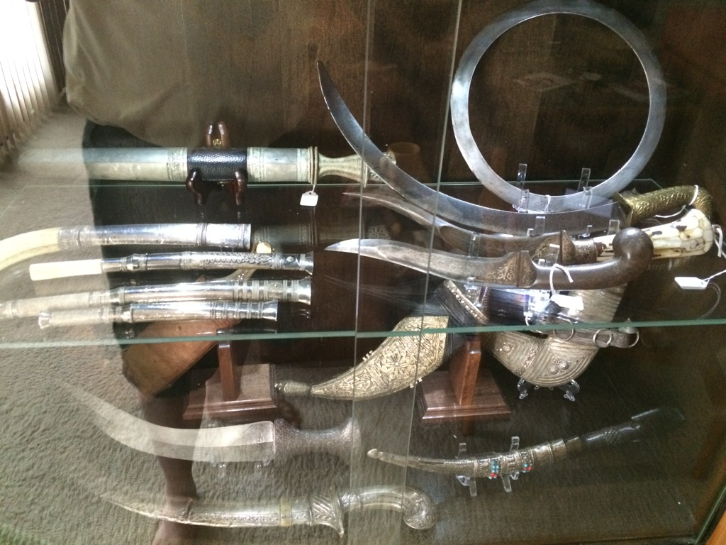

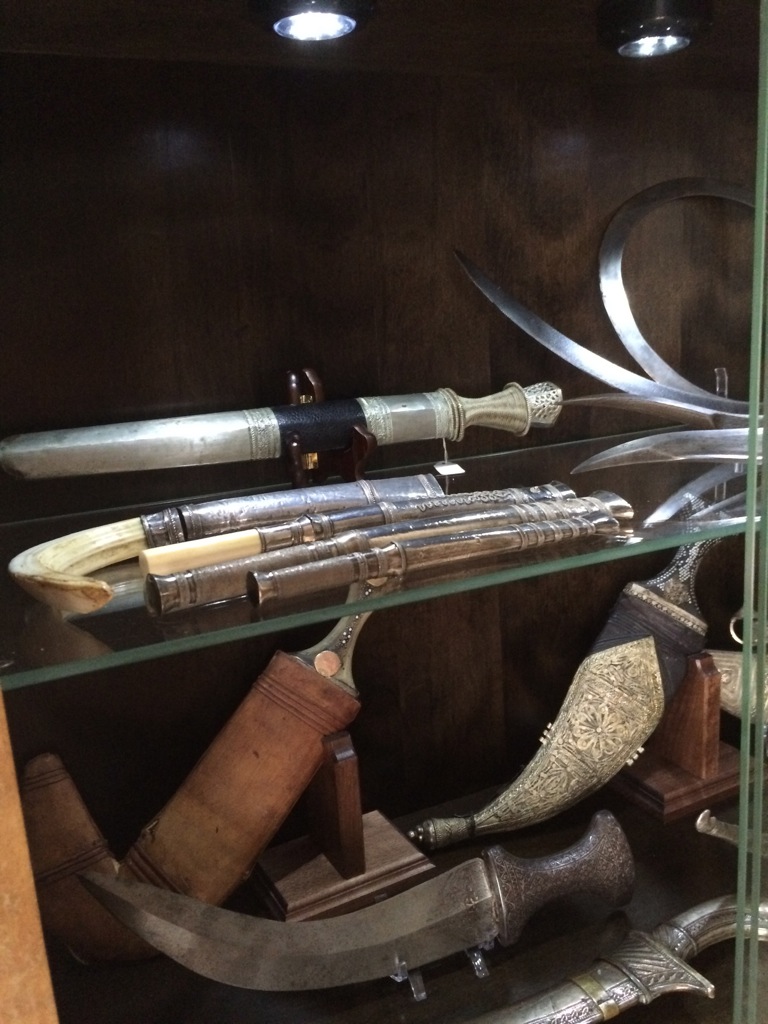

Default Puck size
Originally Posted by Iain
Hi Dave,
Thanks for the suggestion! My only concern would be how thick are the lights? I've got limited headroom in my cases.
Iain,
The pucks are just under 1 inch. I too was worried about the headroom and also whether they would be obtrusive. I turned out not to be an issue in my case.
Here are some photos, taken in daylight (shades drawn) with the glass doors open on the case. In the last photo you can see the lighting through the glass doors. Even with reflections, the visibility is quite good.
I use three in this case, each one centered left to right.

Thanks Dave,
Reason I mention it is that mine are designed for three swords and there's not a huge gap to get 1" in without blocking the top sword. But I'm intrigued and will probably order a few. If they work well I think I'll look to router some holes in the top of the case and recess them.

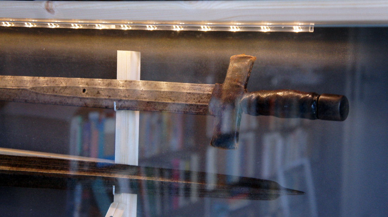

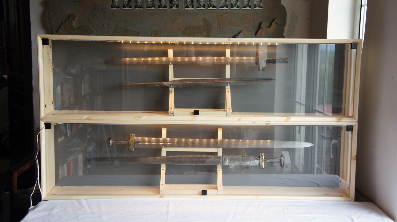

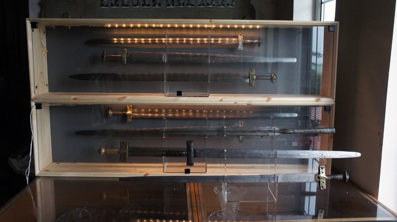

Well I finally completed these cases. In the end for lighting I ran a strip of flexible LEDs inside a groove in the top panel of the case. I'm pretty happy with the result.
The photo makes the light seem more uneven than it really is.
