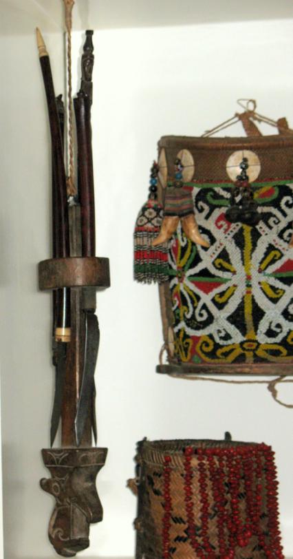

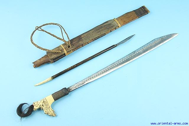

In addition to Maurice's story a picture from Hornbill and Dragon.
And a picture of a special hanger that can hold 4 carvings knives.

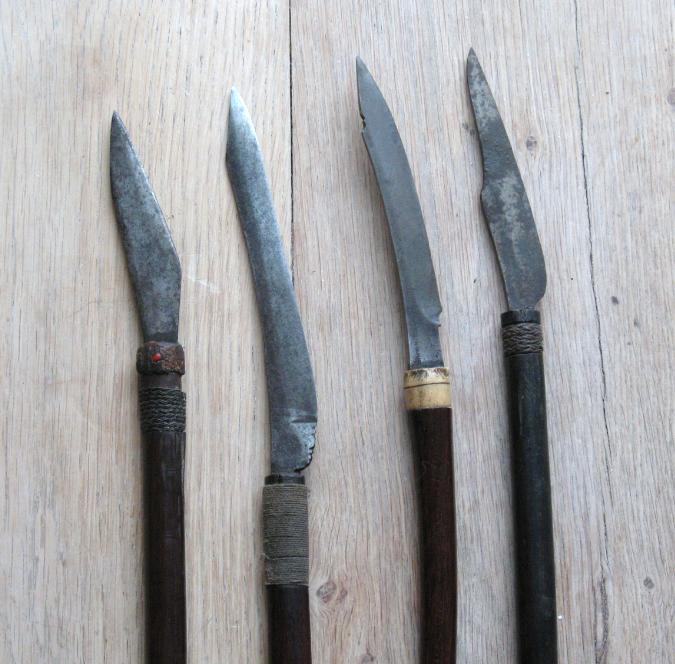

Here a picture of the variety in blades.
These are the 4 knives in the hanger.
