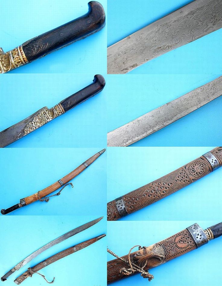

Greetings folks. Here is an Ottoman bichaq with a pattern welded blade. The hilt slabs are of rhino horn and the rest is silver with a little leather and ladder stitching in the middle of the scabbard.
Please take a look at the marks on the marks. Are these silver marks or something else?
Many thanks and Zukran!

Oh yes - those marks:

Habibi
I have the same marks on a blunderbuss.
I will post some photos tonight.
There are stamps on the silver parts.
My blunderbuss is from Algeria.
It's possible that your bishaq comes from North Africa too...

Posts: 7,416
Already helpful, thank you. Although my bichaq is Ottoman, the empire also included Algeria as well.
Old 4th March 2015, 10:56 PM   #6
Posts: 7,416
I was originally thinking that this was more Balkan due to the silver motif and style used. I did not think that the same motif and style was also used in Algeria, even though it was part of the empire.

Hi Battara
It is from Algeria and Ottoman.
I will post later some examples with the same plain and simple hilt/grip.
Exactly like yours.
Plus surprisingly when I did some researches about this bichaq I found yours on a very famous dealer website
https://www.antiqueswords.com/produc...q-ca-1830.html

Posts: 7,416
Yes Kubir, it originally came from him, although I didn't get from him directly (did some trade of some of my restoration work.......)

Posts: 1,492
Exactly like yours.
Kubur I would like to see your examples as I have never seen another one with the same grip shape Kubur as the one that Battara posted.

The scabbard of this yatahan has a clear North African influence. The scabbard of the bichaq that battara posted looks like a typical Ottoman scabbard.

So far I do not see anything about the bichaq that Battara posted which shouts out as being "Algerian", but since I am not as familiar with Algerian weapons as some other forum members I would appreciate anyone who can show me what in particular would make the bichaq that Battara posted appear to be Algerian or even Balkan. To me it looks like a flat out Ottoman bichaq with not enough distinguishing characteristics to pin point a particular region of use or manufacture.
