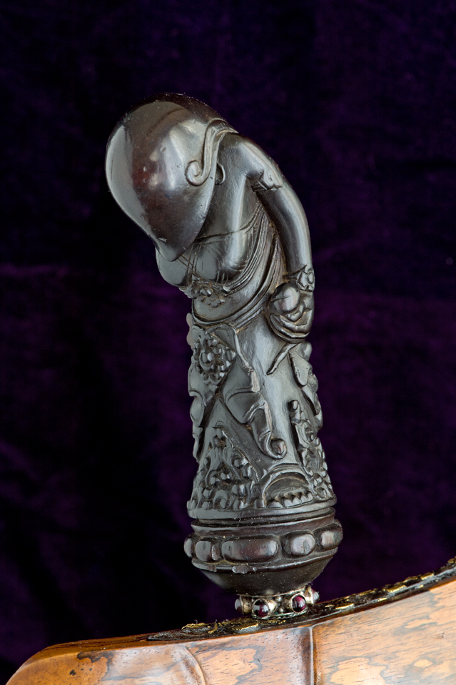

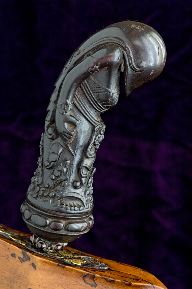

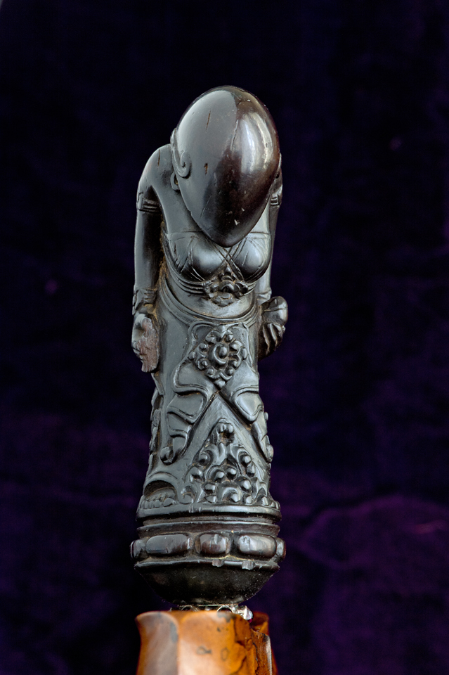

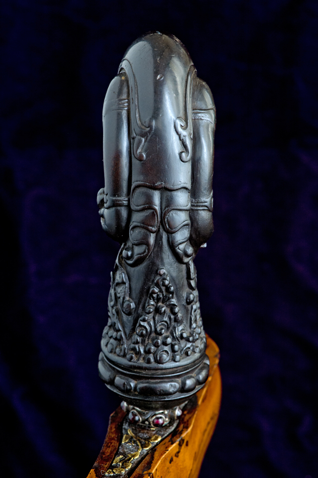

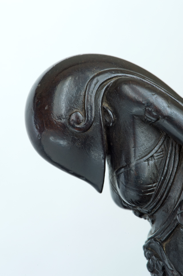

I know we have discussed these hilts before, however, it's been more than 5 years since our last serious discussion and in that time we have all had opportunity for gaining more knowledge as well as our group gaining new membership. Since i have recently acquired an example of this hilt form i thought it might be a good time to revisit the question.
I realize that "wadon" is a Javanese term (for woman) so pehaps it does not apply to this Bali hilt. These hilts have been described as Durga, but despite the assertion by Kerner, Jensen and others who follow them i have yet to see any real evidence for this assumption. Though certainly female in form it seems to me that this figure is most probably divine and therefore more than simply a "woman", so "wadon" seems inadequate as well.
I certain welcome speculative thinking here, especially if it can be supported with logic. What, do we suppose, is the meaning of the veiling of the figure? What is held in the hand?

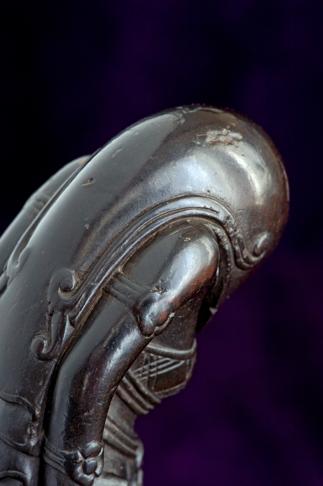

The figure is decidedly alien-like. In this example i have noticed a certain insect-like quality as well, similar perhaps to a kocetan hilt. Does it look to anyone else that the features that start at each side of the head and travel over the shoulders to the back are somewhat antenna-like, as those often seen on kocetan hilts? I am making no conclusions here, simply trying to decipher the elements of this hilt and get the conversation rolling.
So, she seems to be a goddess or divine being, but i don't see any symbolism in the form that would tie her to Durga per se. Who could she be? Who would carry such a hilt in a cultural context (as i have always assumed that certain hilts are more appropriate for certain people than others)? This form seems relatively rare so it doesn't seem it would be carried by just anybody.
Below is a link to that last good discussion we had on these hilts 5 years ago. I quick look there before responding would probably be helpful.
http://www.vikingsword.com/vb/showth...ght=durga+hilt

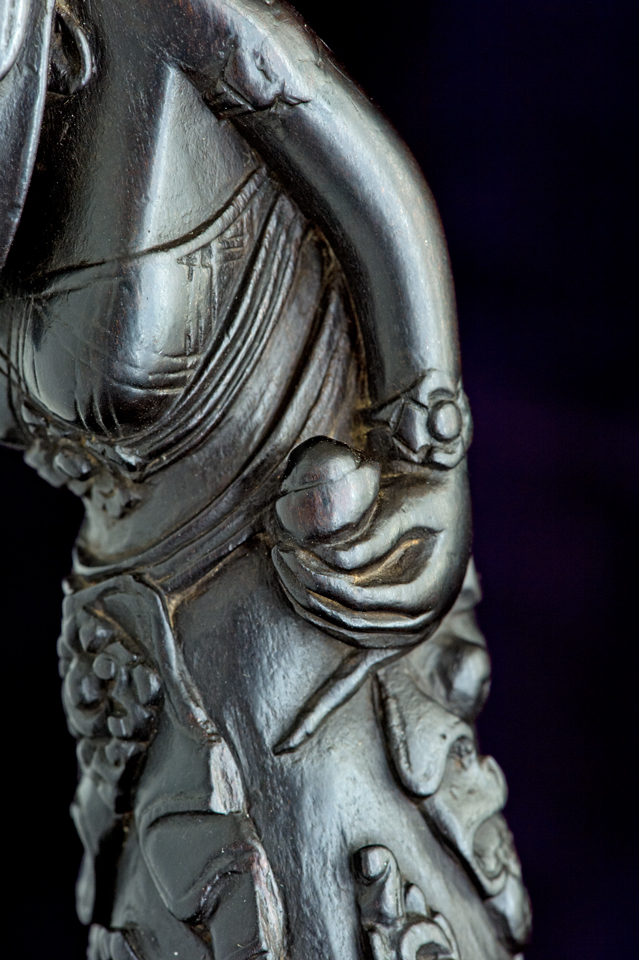

Now in my example posted here it does seem most likely that the figure is in fact covering herself. If not then i don't know quite what else is supposed to be depicted here.
Whether this is intended to be a veil or not might still be in question though. In this example the covering seems almost like a helmet.
I cannot say that there is proof of divinity here, but it seems likely. The hands are seen a mudra position which is often the case in statues depicting Hindu deities.
As for the Durga question, i still see nothing that specifically ties this figure to her though any of the symbolic gestures or poses of the figure, nor to Rangda/Calon Arang for that matter. I am afraid that i cannot accept such an identification based solely on the fact that "all the authors agree on this interpretation in absence of any other one", especially when as far as i can tell, these authors have presented no logical argument for such an identification.

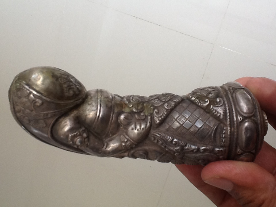

In Lombok, hilt like this named "Balu Mekebun"
Balu = widow
Mekebun = Condition where the hairs screws up
with the explanation of a process during a woman become a devil. (LEAK = devil in Lombok language). She will bring down all of her hairs to cover her face until no body know she will be a "LEAK / devil "
I've got the hilt on my room made of silver.
Hartadi is offline   Reply With Quote

Hello Hartadi,
Nice hilt, thanks!
And do you know if this woman is just an unknown demon or if she depicts an Hindu Goddess?
Old 21st February 2015, 11:49 AM   #14
Hartadi
Hartadi's Avatar
Join Date: Sep 2009
Posts: 56
Originally Posted by Jean
Hello Hartadi,
Nice hilt, thanks!
By the name " Balu " is divorced women. Thats what we believe here.
