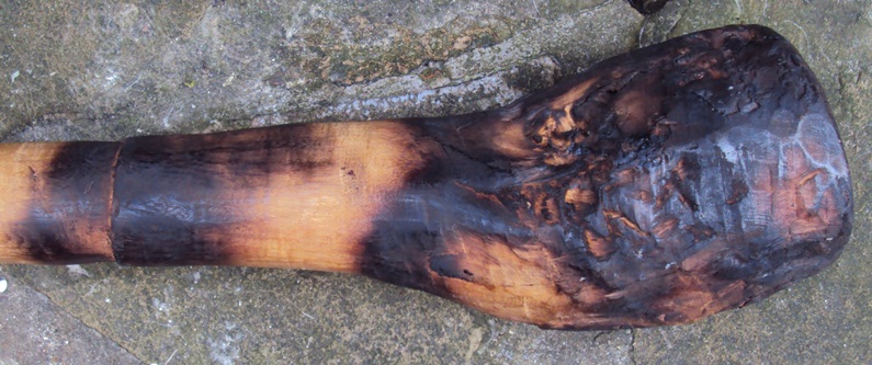

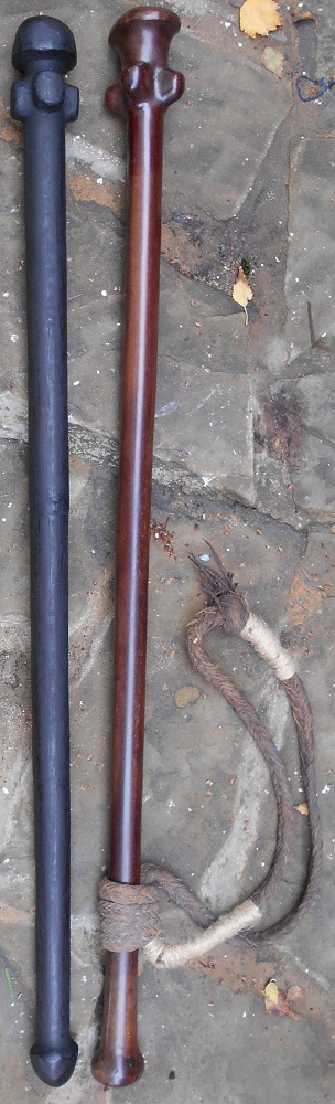

I recently purchased an early 20th or even late 19th century New Hebrides club. This club sparked a deeper thought. The club has been fire hardened, or at the very least fire has been used to alter the nature and appearance of the wood. I show it here with a similar version with a rich patina. If one looks at the close up of the handle ends. You can see where the dark red brown wood shows through the charred surface, and has taken a polish patina through use. The distal end remains black but it too has taken a patina.

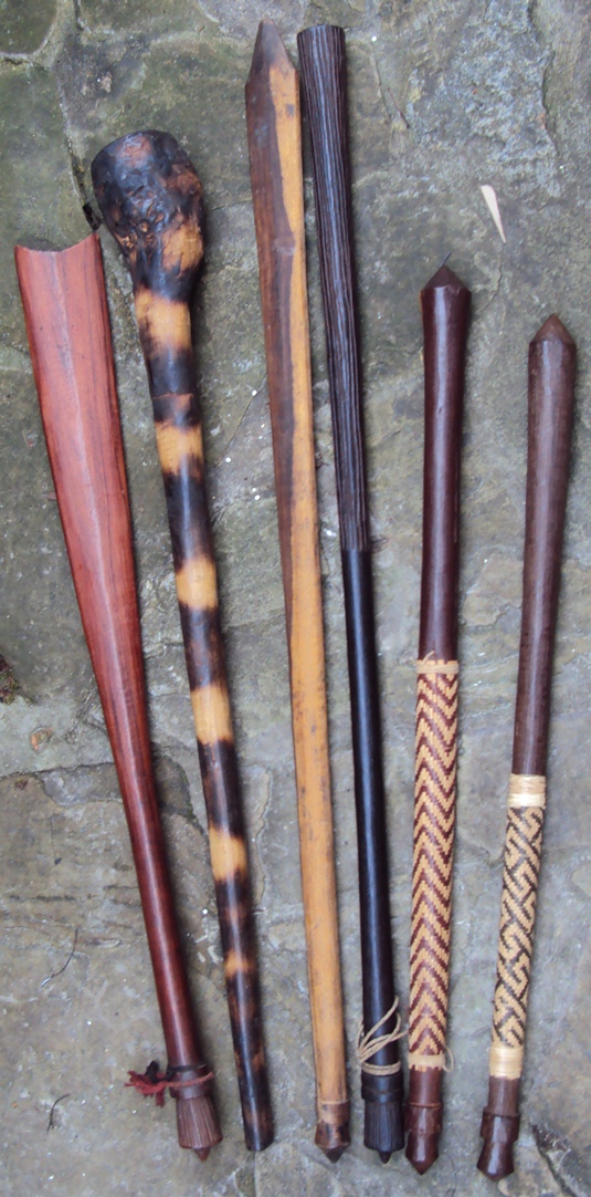

Look at the big Amazon Shavanti club. Here we see the wood has been charred and polished to form a contrast pattern. To achieve this the maker must have used a fire retardant material much in the same way as Japanese sword smiths. Obviously not for the same reason, but does show it is not just an object made crudely for the purpose of killing. There is more to it. i find it all very interesting.

I think Tim, It could also be done in a localised area of the stick with large candle or even a butane gas torch...Leaving unburnt areas of wood. There nothing I can see to imply it was done during over a camp type fire scenario?

That is possible. What if they where also after the overall tempering. Simply burning the surface is not fire tempering. Also the people mentioned where no Larramie Loafers?

I agree burning is not tempering... I cant tell from photos if that piece is burnt or tempered though? if tempered , intermittent pattern seems strange?
