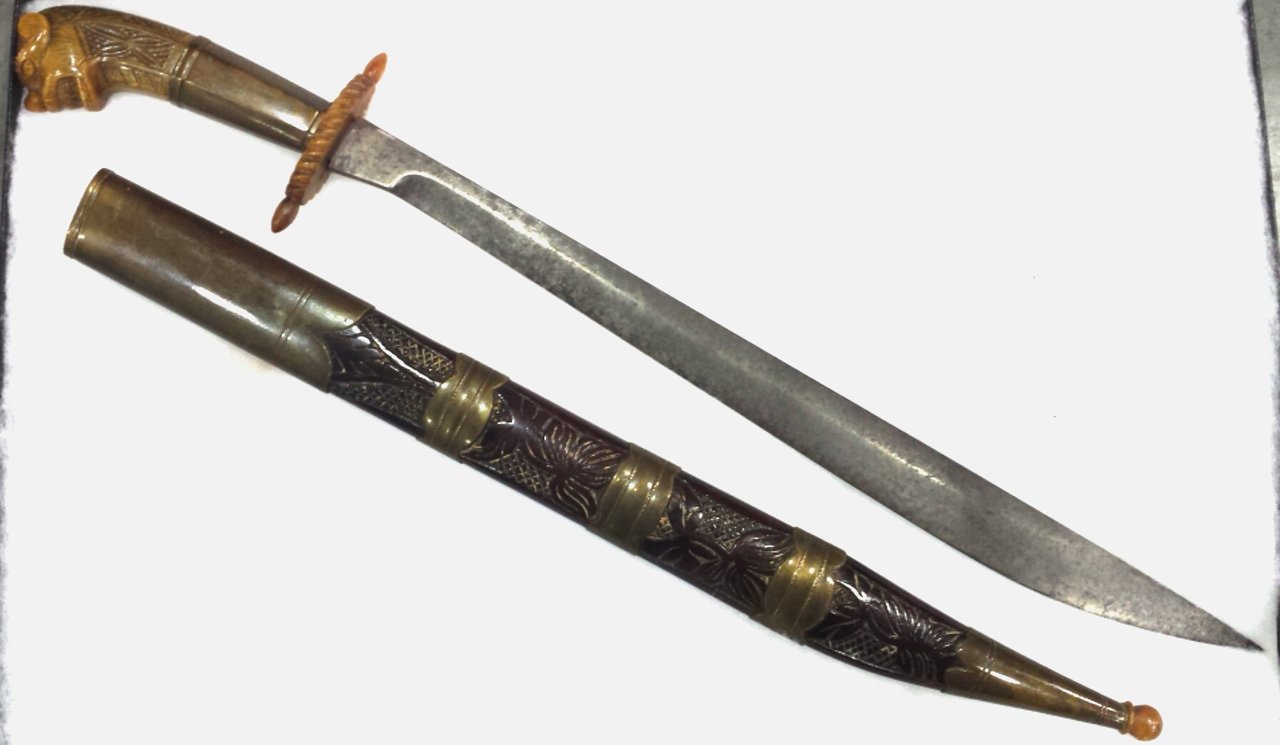

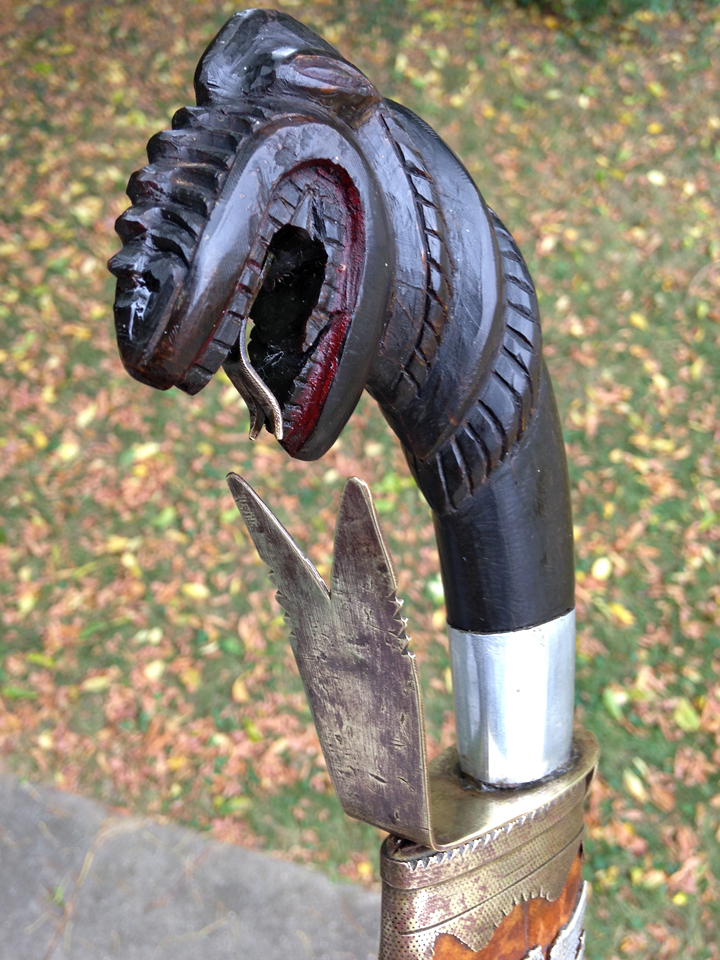

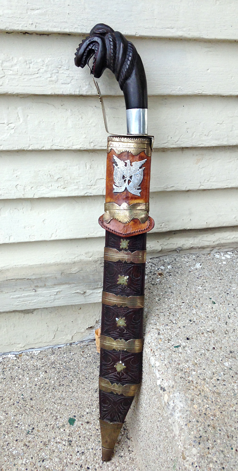

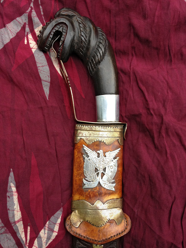

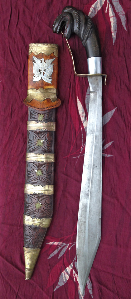

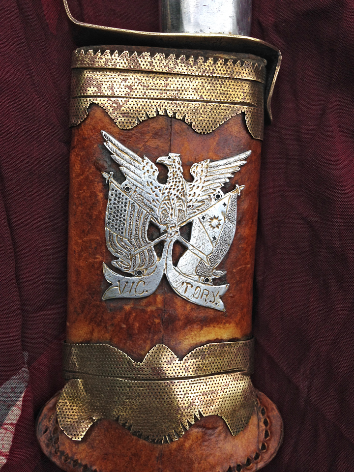

Here's one for the Philippines aficionados in the group. This is not really my area (when i buy filipino weapons they are usually Moro and insurrection era), but when i saw it at the antique mall today it just sorta called me. My guess is that it is end of WWII based on the use of aluminum on the ferrule and eagle crest and the fact that the banner says "Victory".

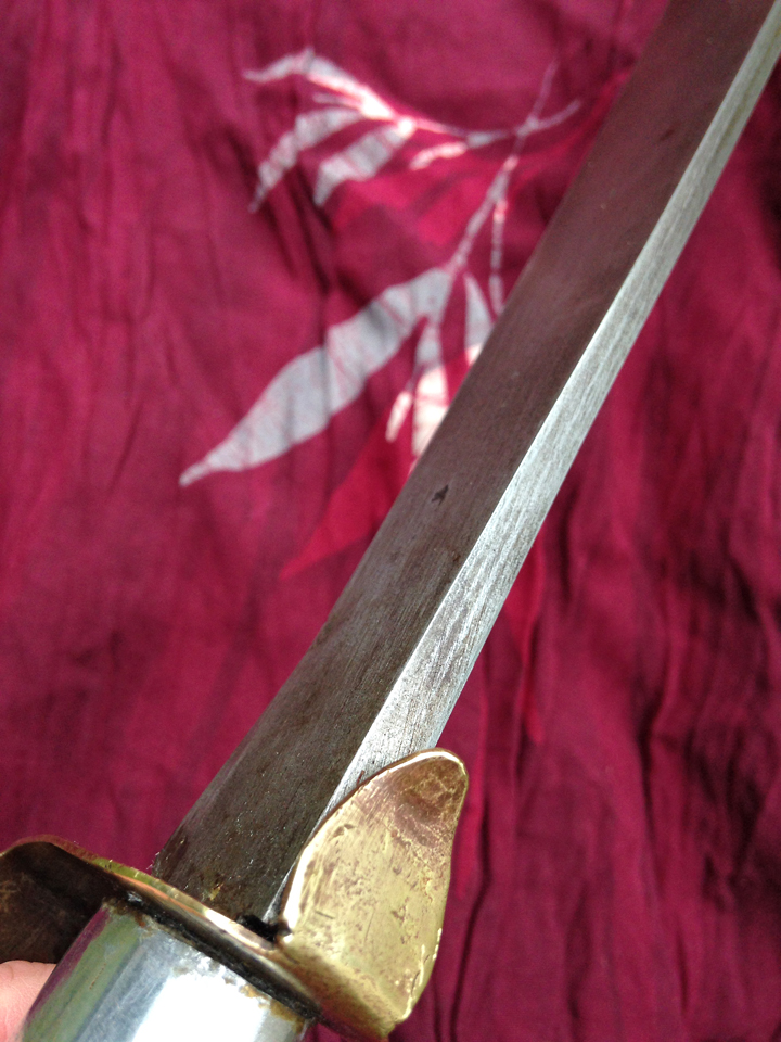

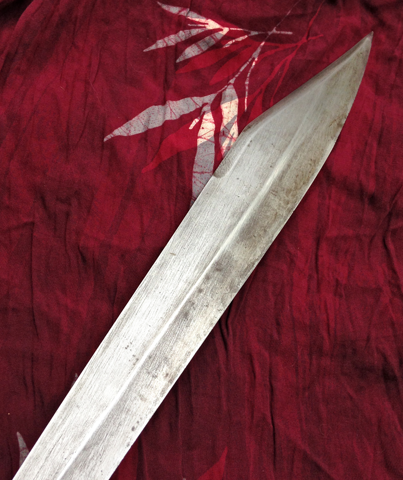

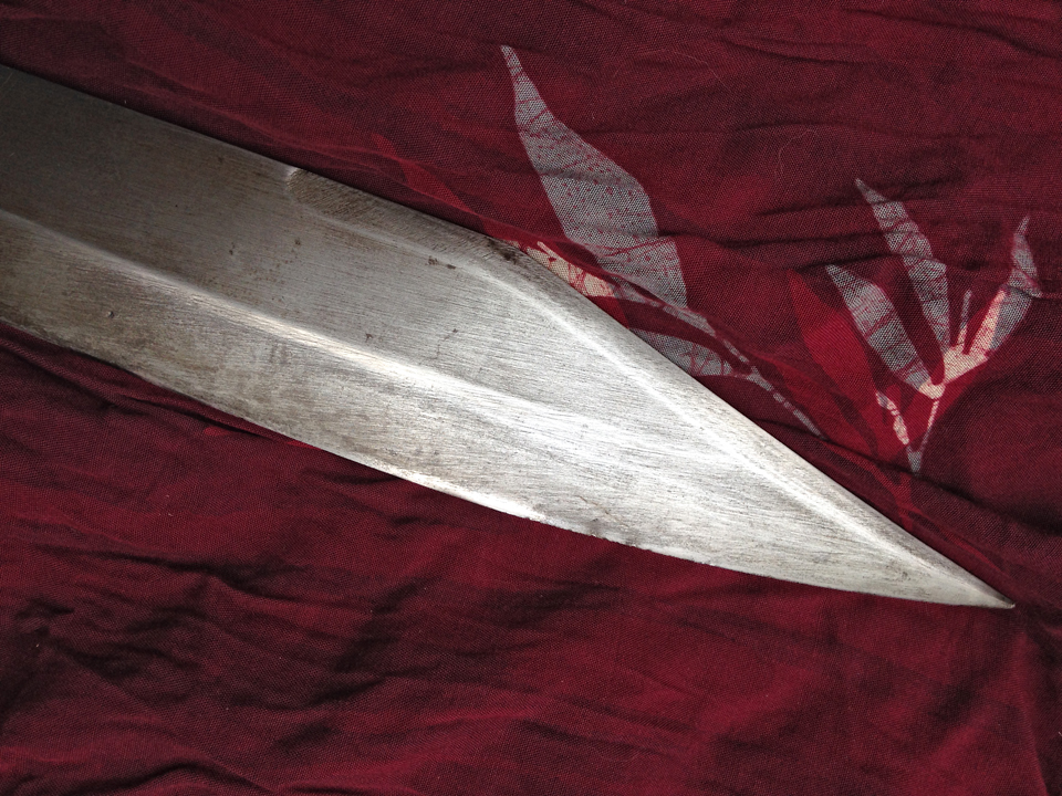

The blade is fierce and razor sharp. The length is about 19 3/4 in. and the thickness is about 1/4 in. at the base. It is flat on one side and sort of convex on the other, not unlike a mandau. Feels very good and well balanced in hand with a nice weight.
The guard and bands seem to be brass. The guard is quite solid, firm yet springy.
The hilt appears to be horn with some paint on it (note the red around the mouth).
Sorry about the photos. Just quickies with the iPhone, but hopefully they are good enough for an ID.
I would like to know more about what tribal affiliation this blade might have, it's proper name and if you think i have the dating on it correct. Thanks!
Old 5th October 2014, 01:02 AM   #2
Posts: 4,749
Hi David:
Interesting WWII-era piece. Looks like a dressed up sword from the western Visayas--probably from Panay. As you say, the aluminum decorations are a good guide to age. It's not the traditional daemon figure on the hilt, but there are quite a few examples with mythical creatures as well, "dragons" and such.
Good find.
Ian.

Ian.
May be a "dress up sword", but the blade certainly means business. Is there a proper name you know for this type?
I was wondering if it might have been a presentation piece of some sort, but i would certainly not hesitate to grab this one in a fight.
My first thought on the figure was Godzilla and much to my amusement i turned on the telly to a Godzilla festival.

Posts: 2,196
I think that I would call it a tenegre. If it wasn't for the tapered scabbard tip I might have guessed that this could have been an older sword refitted to a more modern taste. Either way I like it. The antique malls around where I live have little to no edged weapons at all anymore. It seems as if everyone thinks that ebay is the answer to where to dispose of Dad's or Granddad's old junk. Congratulation on your new addition.

Thanks Robert. I don't think the antique malls around here are any better than around you. In the 16 years i've lived here the only other thing i have ever found worth buying was an old and unusual mandau which i finally traded to someone here on these boards.
I wondered if the blade might be older, but then i get the feeling this is all an original match as the blade suits the sheath so well (one of the things that was attractive about it for me) so WWII seems the most logical conclusion to me.

Posts: 1,730
nice catch, David! yes, definitely WW2 era. a lot of these were made not necessarily for tourist consumption, but rather as souvenirs for G.I.'s during that time period. on the same note, i'm starting to think why moro weapons became more flamboyant at the turn of the century, which is for the same reason...
check out Springfield area antique malls; i found quite a few pieces from that area.

Hello David,
agree with the others, a WWII area tenegre, nice one. Here my one with an other blade shape from the same time frame: http://www.vikingsword.com/vb/showth...hlight=visayan

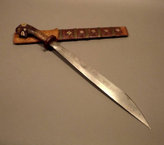

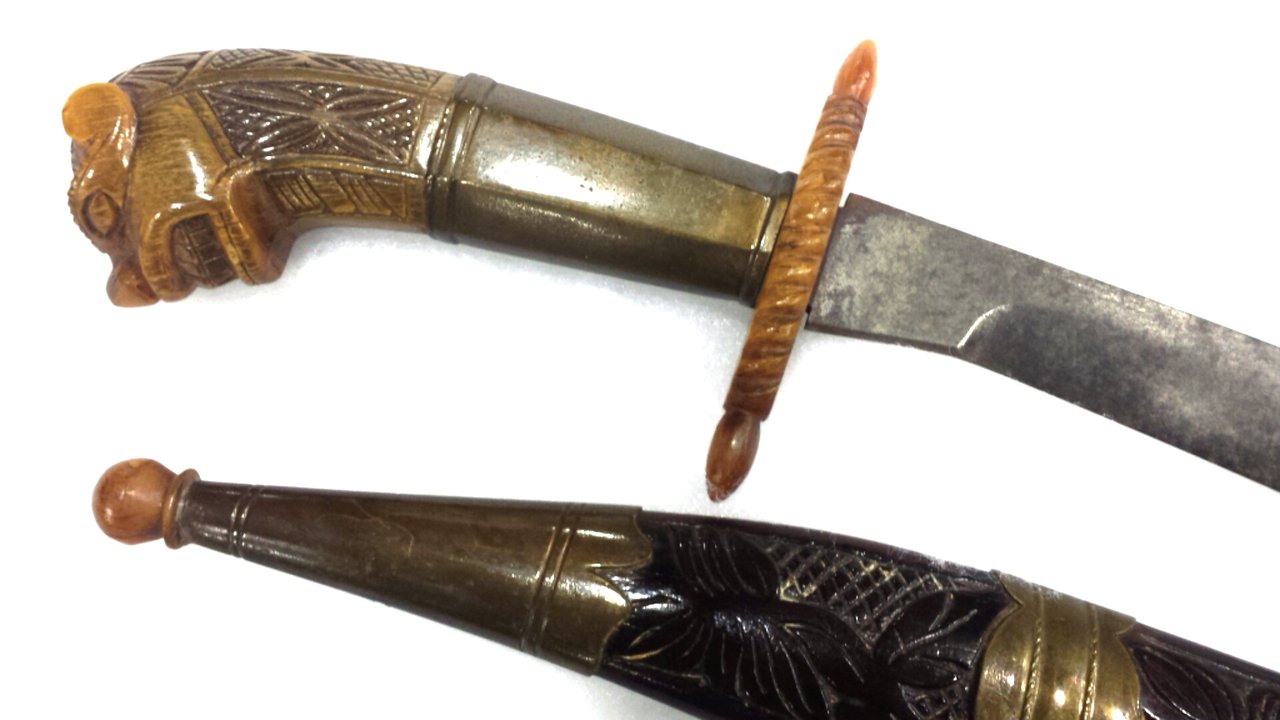

Here one which was sold not so long ago by ebay. I believe that this one is from the same time frame.

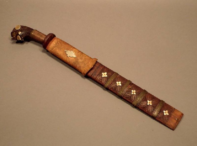

Old 7th October 2014, 02:27 AM   #12
Posts: 7,421
Yes Ron your mounts on this one are brass. Ron's is a great example and rare - the horn is albino carabao horn!
There were a lot of these blades made for GIs, but this one is nice.

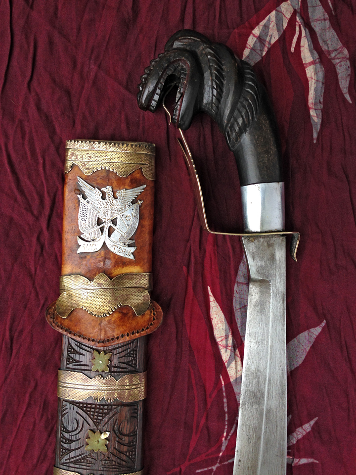

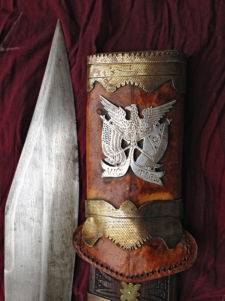

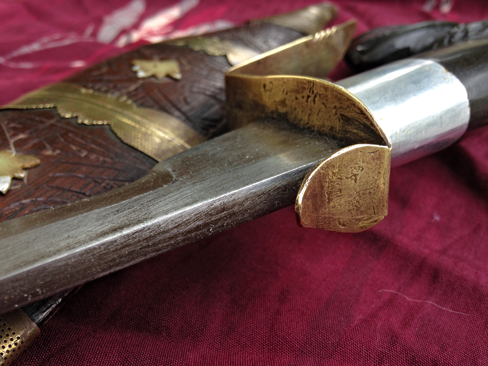

Join Date: Jun 2024
Posts: 2
here’s a similar Binangon that I have. this was identified by a blademaker in Cabatuan, Iloilo, Philippines.. the hilt and the use of carabao or cow bone on the handle is similar to the work of his grand uncle he said.
Very interesting. It sure does seem to be pretty much the very same hilt form and is possibly the same maker. Would love to see a few different angles of the hilt as well as the blade. Thanks!
