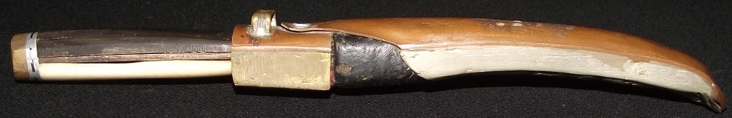

I just won the auction for this, the seller describes it as a "Mongol Dogpa" knife. It doesn't look Mongol to me, at least not Khalkha Mongol, but it seems to fit somewhere along the Mongol/Tibet/China spectrum.
After some googling it seems that there a couple different ethnic groups called Dogpa or Brogpa. One is a group of Aryans living in India while the other seem to be an ethnic group in Tibet. Can anybody help me narrow the origin down?

It does look a little bit like the lothi in your second link. What struck me as most different about this one compared to what you usually see is that the scabbard is sort of bow shaped rather than tubular. It also seems to have a belt loop of some sort. I've never seen those on a Mongol/Tibetan/Chinese one as they were usually carried by tucking them into your belt or sash.

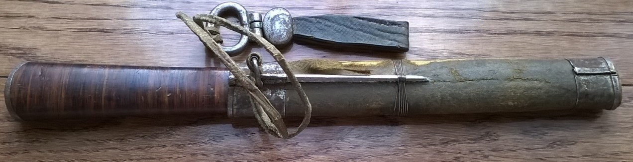

I've attached a picture of my Mongolian knife, which is more or less tubular like your Tibetan one. Both look like they've been sharpened quite a few times. I'm sure mine had dispatched countless sheep during its working life.

I have seen several with this bow shaped scabbards, special by ebay. I think that your second one is indeed from Mongolia, the handle seems to be typical for the Mongolian version. Like you I have noticed that there are tubular scabbards and more rectangular scabbards, some of these are set with stones. But I know not enough about this knives to say from where the different forms coming.

That other one came from a seller in Ulan baatar so I'm pretty confident its Mongolian. Obviously a work knife rather than a fancy outfit holiday knife. Still trying to track one of those down.

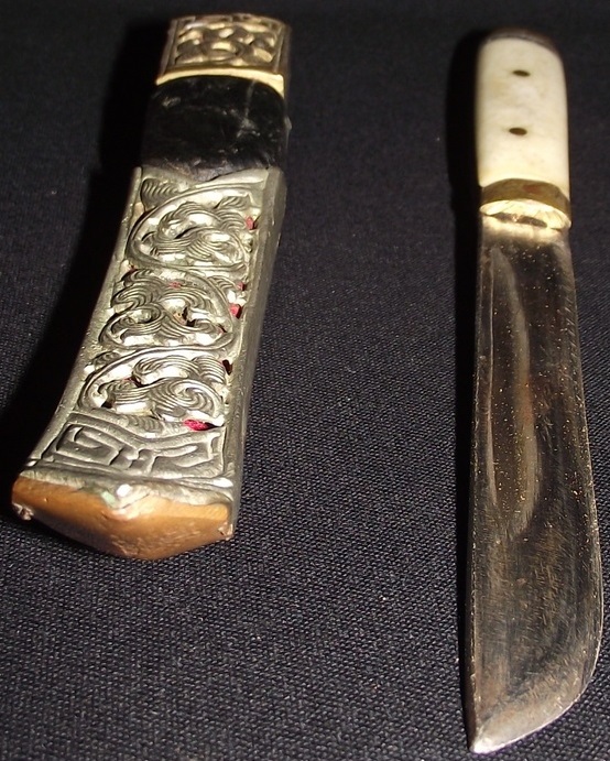

While we're on the subject of Central Asian knives of this family, I've attached a picture of what are supposedly a Buryat knife and a Yakut knife. Both are from e-bay auctions several months ago that I didn't bid on because I was concerned they were just tourist pieces. The white and silver one is Buryat, the other Yakut.

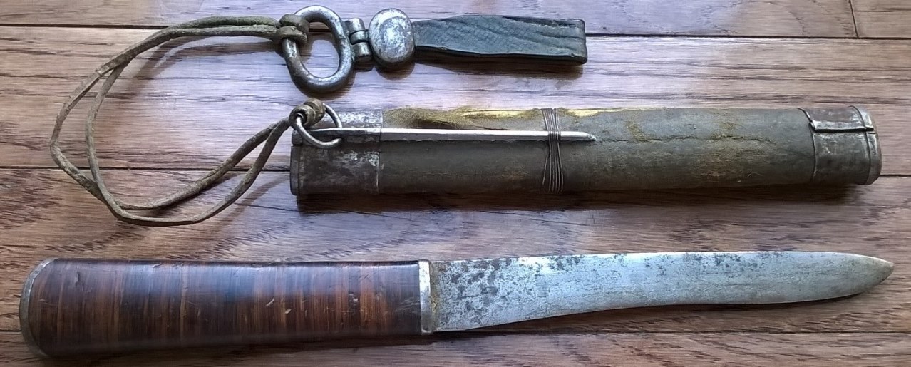

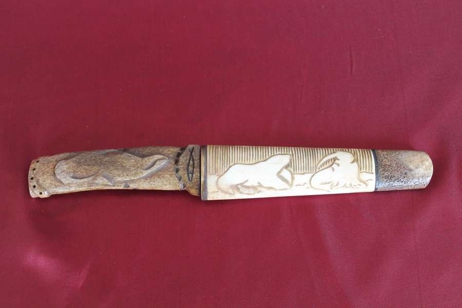

I've noticed that I never post pictures from my one how it look now. So here some pictures and a question: what is the sort of "leather", ray skin? Or what I have read somewhere frog skin? Could be lizard skin also. I am unsure about this. Have someone an answer?

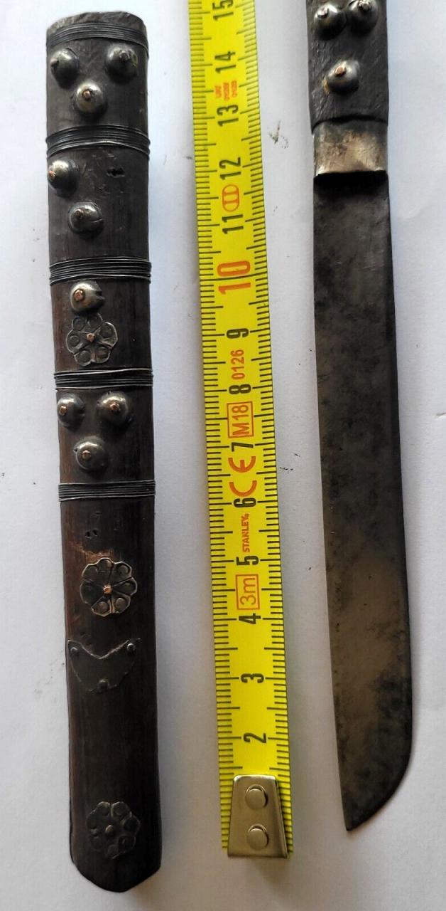

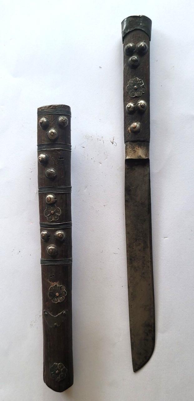

just bought a knife at an auction and whilst looking up more information on it,

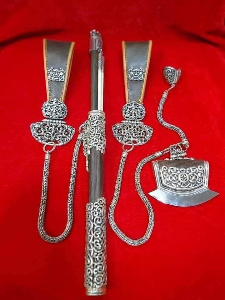

and a picture of some art work: Mongolian national knife made of 1 kg of silver

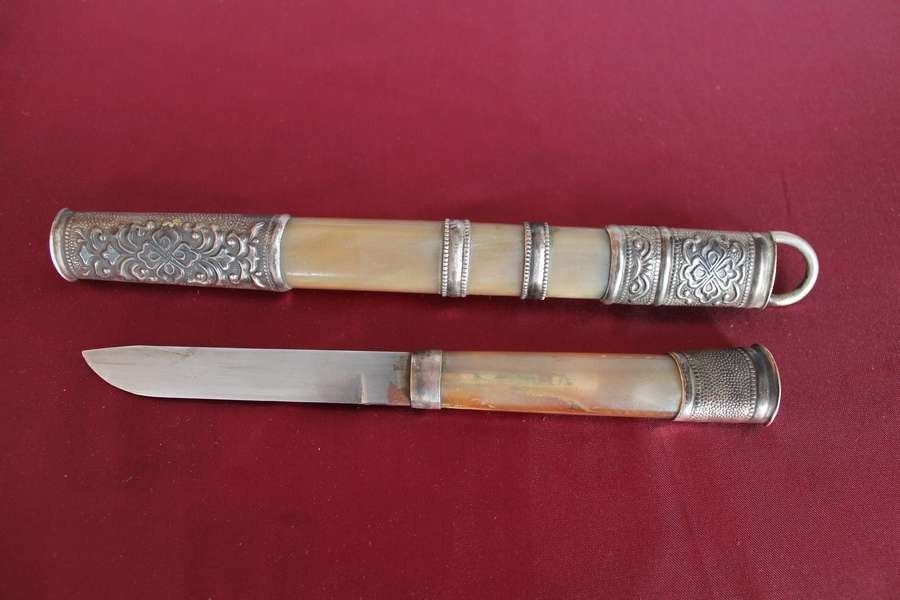

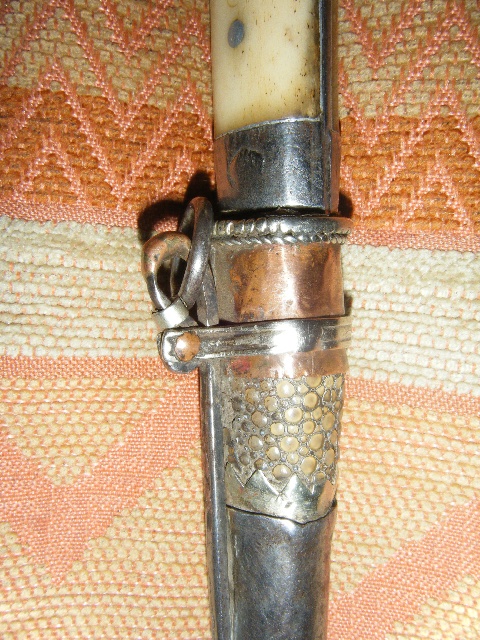

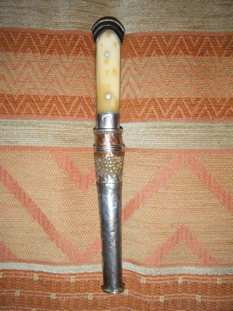

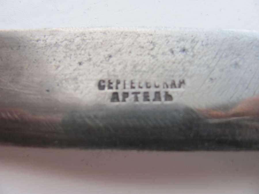

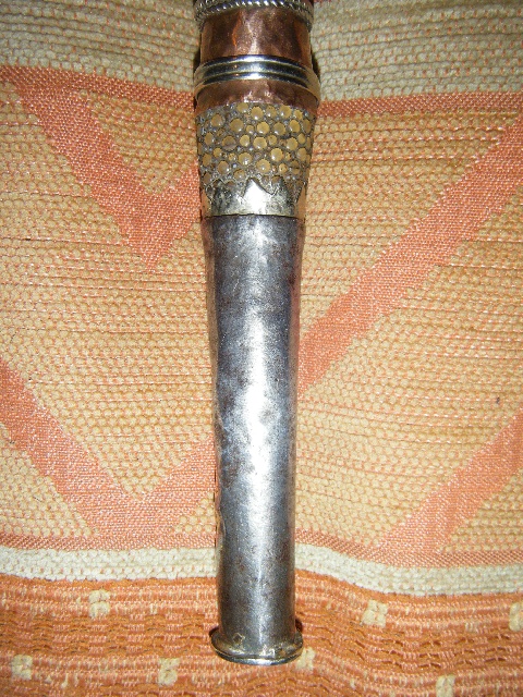

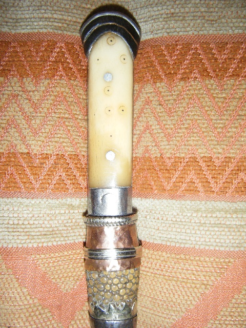

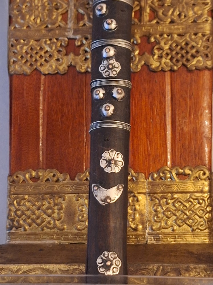

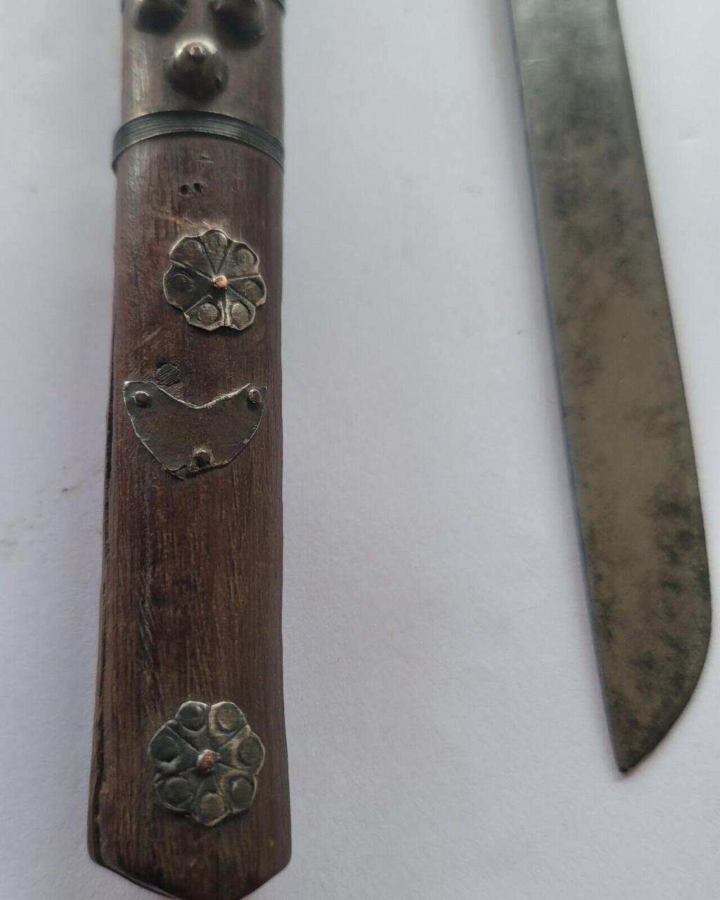

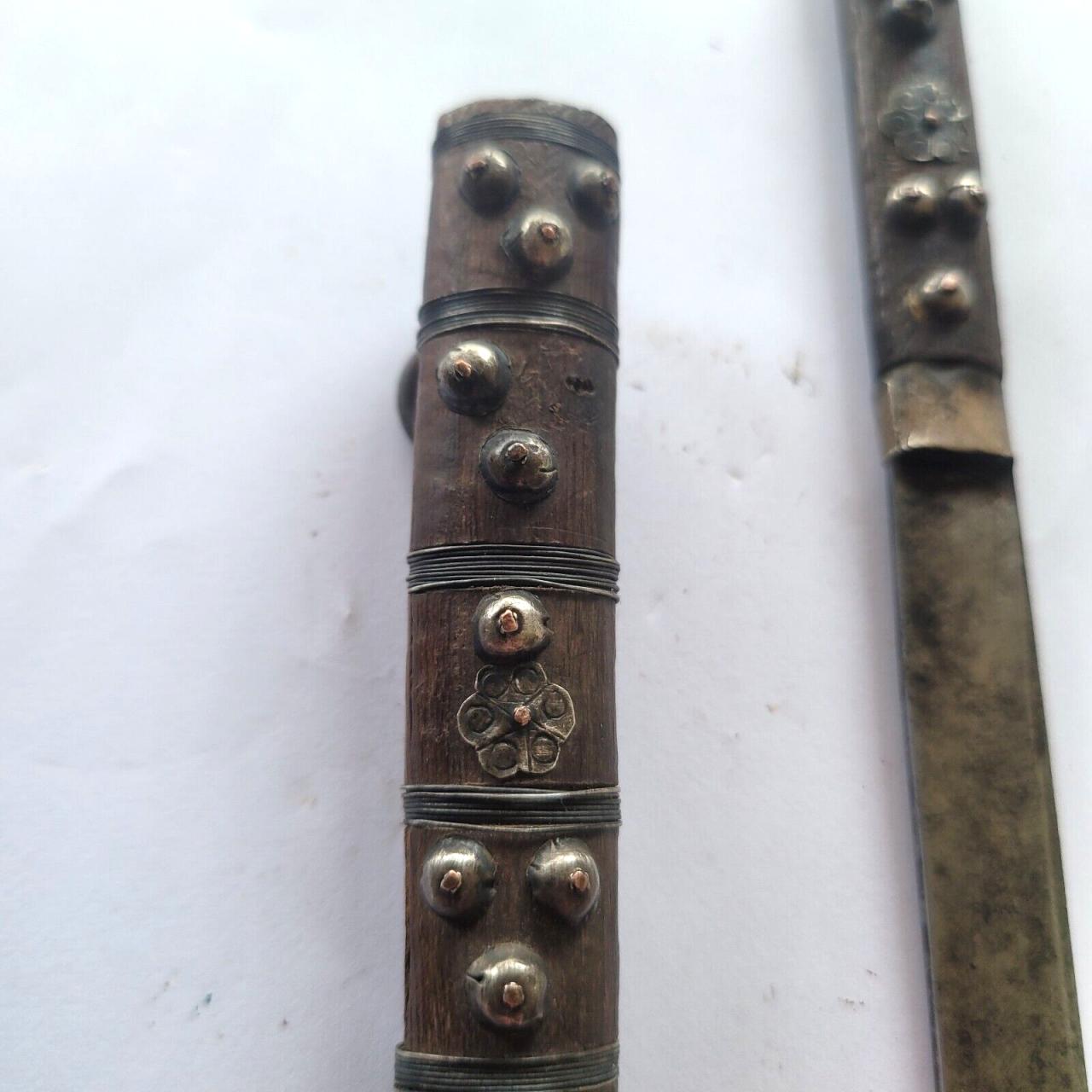

the first 4 pics show how it (it was sold described as a Mongolian knife ) looked like and the other 3 after I did some cleaning.
Material is wood, steel and decorations in silver, sadly no Citipati ( skull) on it
FYI: I have seen them also described as coming from Nepal, Buthan and Tibet,
like the first one in this thread
http://www.vikingsword.com/vb/showpo...77&postcount=1
versus
http://www.vikingsword.com/vb/showthread.php?t=31275
your thoughts please and kindly requested if you have some as well, to show yours, thnx a lot !
