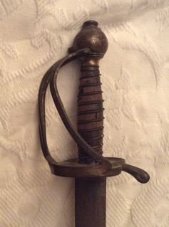

Hello all, I am a new member and this is my first thread. (I hope everything works out and loads correctly!)
I've been a collector of American, European, and ethnographic weapons for probably forty five years or more and discovered this forum within the last year. I am looking forward to participation in the future, when time and topic allows.
I turned this saber up about twenty years ago in a rural Louisiana flea market, near what we call the German Coast, which was settled sometime in the second quarter of the 18th century (that's very old for us!).

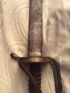

My best guess is that its a cavalry broadsword, circa 1735-1750 or thereabouts, but, as I do not have any German references, it's just that; a guess. I tried to get an image of the marks, but one of them was only partially struck. The blade is 37.5 inches long, brass hilt with a leather covered wooden grip. Heavy, single strand brass wire wrapping. It does not appear to ever have been dismounted in a very long time.

This is an interesting example of the general type of hilts found on hangers and cavalry swords (typically associated with 'Walloon type) with bilobate counterguards in the 18th century, usually second quarter to mid. While unable to find an exact match in some of the German and North European references at hand, it follows the general style indeed seen with German forms.
Though the blunt ended quillon suggests those origins, the thumb ring usually present is notably absent. Naturally by this time there was distinct movement away from this feature it seems many, if not most, examples from Germany and Europe in general had them.

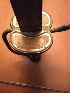

What I found interesting in checking through the examples in Neumann was markings, typically on the underside of the counterguard as seen here.
While it is tempting to think of the FA as Friedrich Augustus II , Elector of Saxony in these times, I think these letters more likely regimentally noted.
On the examples in Neumann there were many combinations, it seems invariably on counterguard underside and most British (a couple of American). Many were referred to as 'common British fraction markings', such as 9/56; 2/48 etc. Others has an RA; No.9: 28 but most telling was one reading 'R No.9' .
In looking in Wagner ("Cut and Thrust Weapons", 1967, E. Wagner )Plate 7, p.257 is a Saxony Dragoon sabre end of 18th c. and at the forte is the monogram F.A. surmounted by a crown and No. 104.
This monogram is noted as Frederick August (Elector of Saxony), and the number combination in similar form to this example.
The sword in plate 7 is not the same but the initials and numbers seemed to be pertinent.
I would then reassess my view on this sword as probably a Saxony dragoon sword mid 18th c. and quite likely among the arms brought into America with those German mercenaries previously mentioned.
