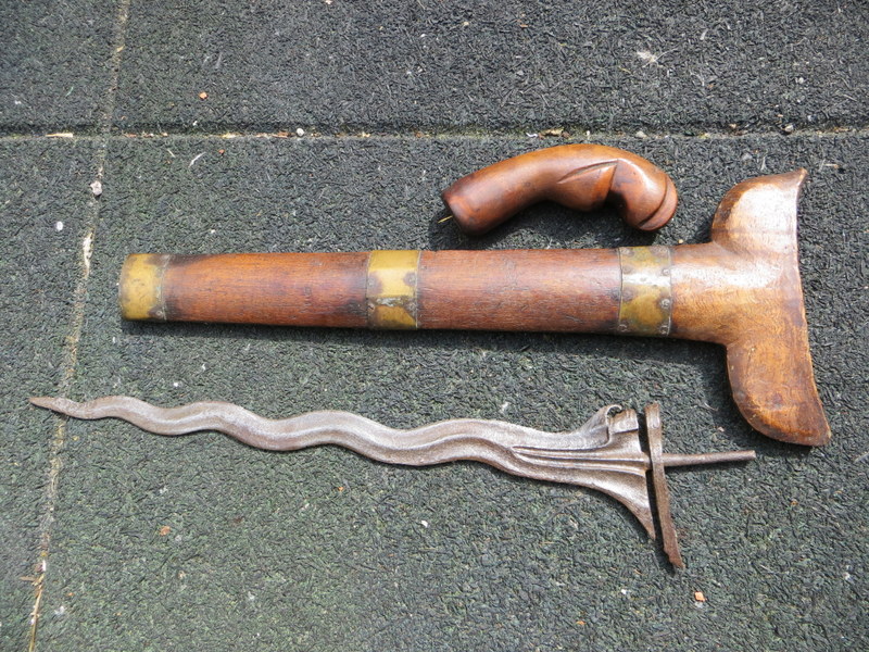

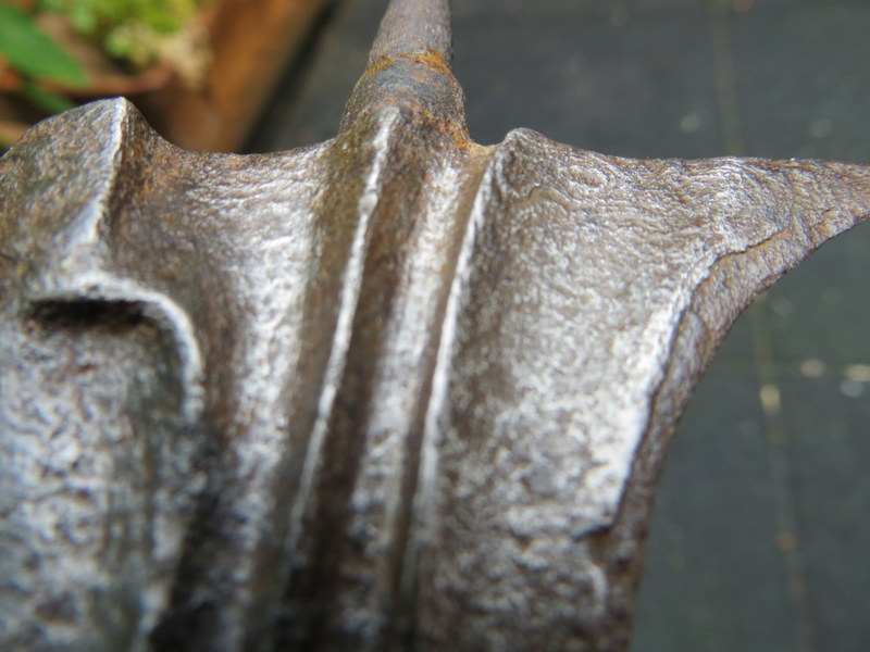

Keris is not really my thing, I am normally to be found on the ethnographic forum. However, I do have this, possibly old, keris. The blade has been been badly rusted and pitted but it is still possible to see the remains of what looks to have been quite a complicated pamor. What makes me think it might once have been quite a good one are the remains of, quite thick, gold encrustation to the top of the ganja.
Any and all comments welcome.
Richard

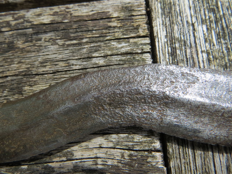

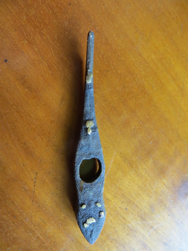

A very lovely blade, with golden remains on the ganja. I would clean the rust with pineapple or lemmon juice. Lemmon juice is more agressive but is mostly used to clean a keris blade. Is a mendak present? I only see the ukiran.
Maybe Alan can tell more.

Nice keris.
I can't see much rust on this blade.
Yes, if I was going to stain it, I'd clean it first, and that clean would be vinegar, simply because our pineapple juice these days is garbage.
However, the gonjo would not be cleaned with vinegar, pineapple juice, Coca-Cola, tomatoes nor any other sort of soak.
I would use a very bright light close up, along with a saddler's needle held in an awl and a 3X tool maker's loupe. I would very carefully remove all the corrosion manually. That gold may not get through a soak.

Thank you Henk, Rick and Alan,

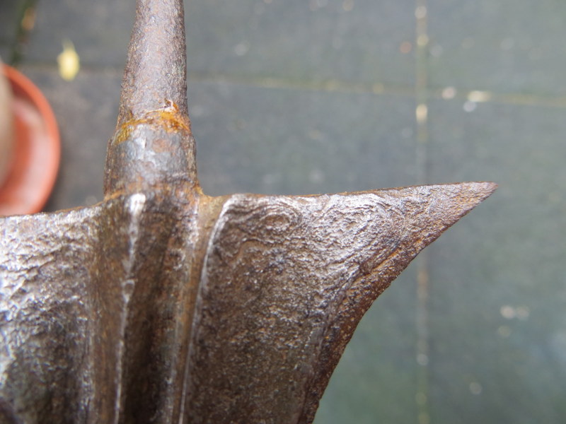

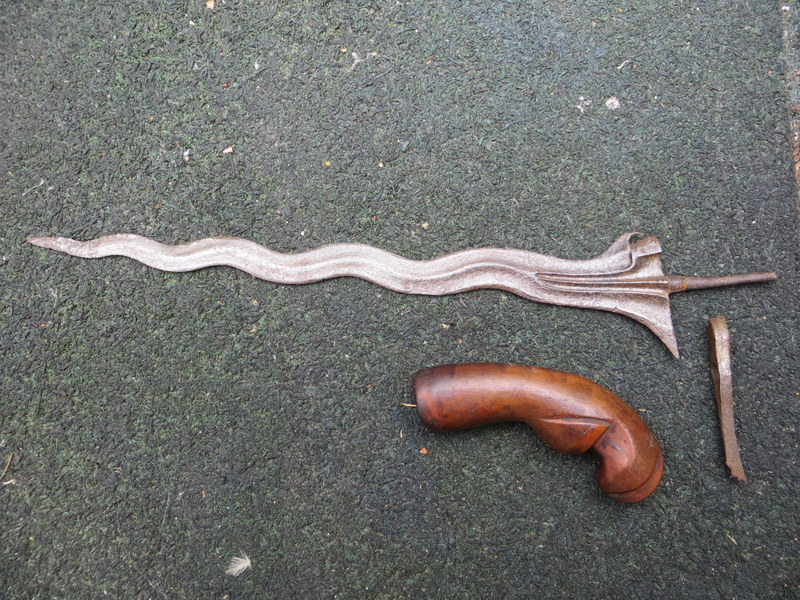

No, Unfortunately there is no mendak. I have already given the blade a preliminary clean by soaking with Plusgas and rubbing down with crumpled aluminium foil. this has got rid of most of the surface rust but it is still present in the "pittings" which gives the blade a brownish tinge. I will try vinegar, lemon juice etc. and see what happens.

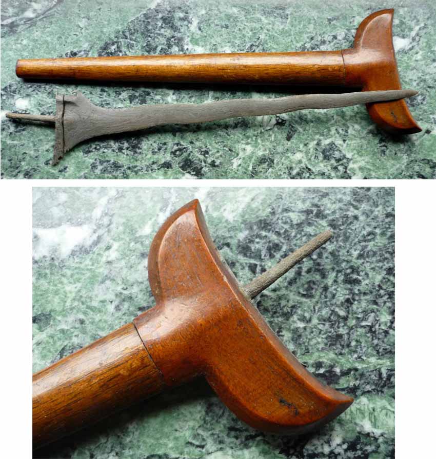

I also attach photo's showing the scabbard. I am not sure whether or not this is original, it is a very close fit but not perfect. And another showing some of the pitting on the blade.
Any idea as to age or origin?
Richard.

Now that you show us the scabbard as well i think the keris is from Sumatra, Palembang. It certainly has some age. I strongly advise you use the cleaning Alan sugested.
Vinegar is a good option to soak it, but for more control i usually clean a blade with a slice of lemon or lime. That gives me more control on the cleaning process. But with te remains of gold on the gonjo i would be more careful as Alan said.
Sorry Alan for still using the term ganja in stead of gonjo. That's a dutch habbit just like we say Wrangka in stead of Wrongko. But i still do remember your wise lessons. But learning something new is easier than turning an old habbit into another one

The sarong might be an indicator to determine the origin of the blade but in this particular case I have some doubts if Palembang is correct.
Similar sarong with the same sampir attached. This Palembang keris has a typical blade of the specific area.

Re the use of brushed on lemon or lime juice for cleaning.
Yes, I agree that the use of this is an excellent method, and for a blade with a relatively smooth surface, and made from non-porous material, it is without question the premium method to use. It uses a lot of time, but it is the best.
However, for a blade that has pitting, or a blade that is made from porous material, a soak method of cleaning is required. The medium used for the soak could be coconut water, citric acid, vinegar, or any acidic medium. Some commercial blade cleaning in Jawa is done with very dilute hydrochloric acid.
For a long time I used pineapple juice, but in recent years that has not been my preferred medium, simply because good pineapple juice is no longer available.

Henk, I would suggest that when we use lime or lemon to clean a blade, it is easier, neater, cleaner and in all ways preferable to use strained and filtered juice together with a small, stiff brush, than to use raw fruit rubbed onto the blade.
Lemon juice should not be used in combination with warangan for the stain, as the result is never correct.
The inside surface of lime skin used under running water, after the juice has been removed, can be rubbed onto a blade if the stain has become too dark, in order to lighten the colour.
