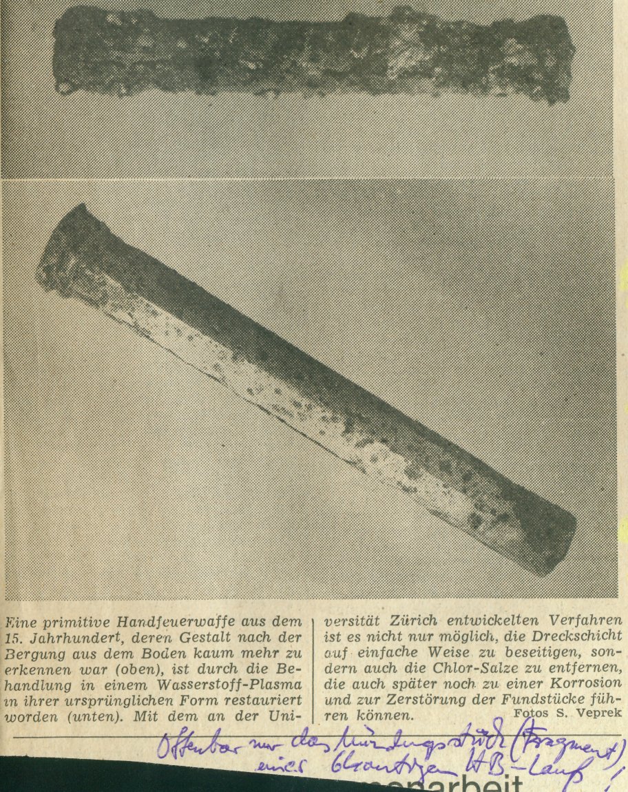

Please see top attachments, and sorry for not being able to help the fact that the article is in German
