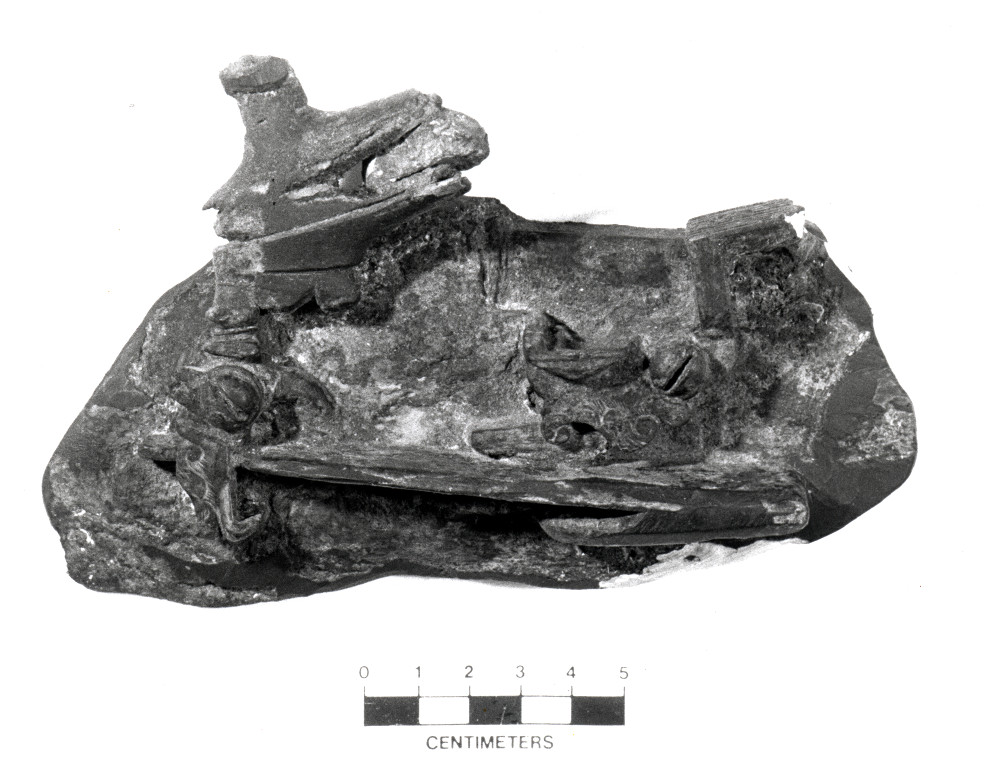

On July 30 1715, A large fleet of Spanish galleons encountered a hurricane off the Florida coast near Sebastian inlet. An almost unimaginable treasure and more than a thousand lives were lost in the storm.
Miqueleter recently sent me photos and drawings of some artifacts recovered from the site of the wreck in the 70s and 90s. This wonderful photo of an encrusted Miquelet Lock was included.
The back of the photo is labeled:
#7367L
S-26
85L-017
Recovered in 1990 from 1715 Fleet Wreck

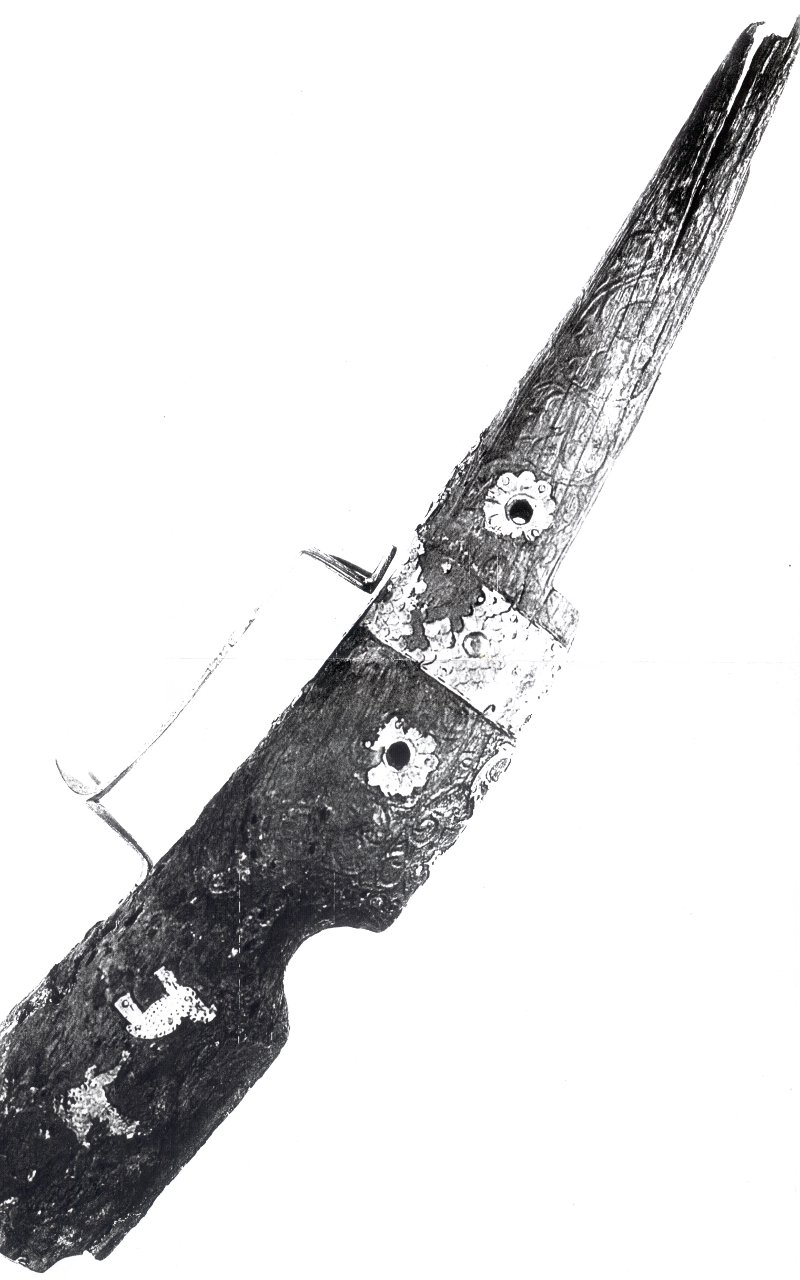

This was scanned from a xerox copy of a photograph. The copy has some notes from James Levy who was a conservator for the Florida Bureau of Archaeological at the time.
"This is a very ornate piece from the 1715 Plate Fleet. Lots of brass overlay and the stock carved all over. Brass trigger guard. PRATS was engraved on the barrel from Ripoll Spain."

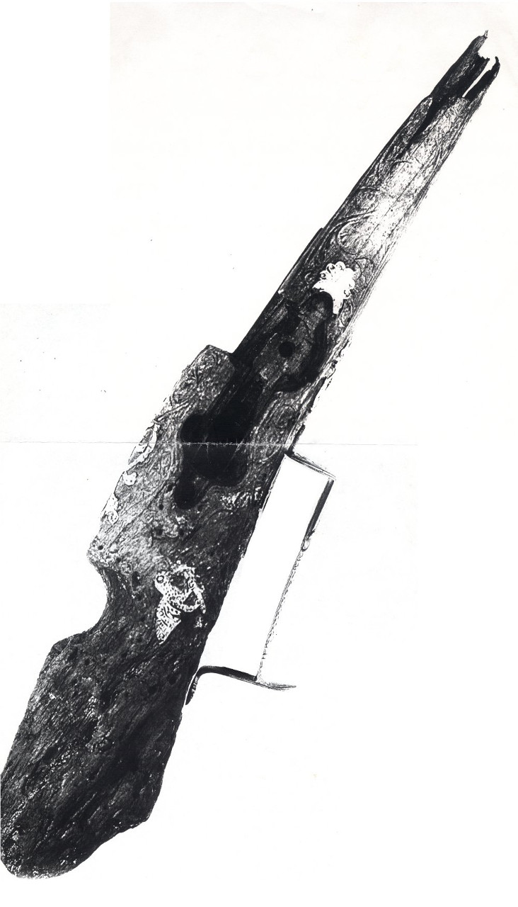

The other side of the stock shown above.

Friday I had a chance to speak with James Levy. He was the original source of these images. He sent them to Miqueleter (along with others) in the late 90s. At the time he was the conservator for the Florida Bureau of Archaeological.
Mr. Levy tells me that the image of the lock is actually a casting that he made. He also says the stock is now on display at Museum of Florida History in Tallahassee Florida.

Hi Dana,
First of all I wish to say thanks for posting those images, even though the scans of the xeroxed copies are, as stated by you, not the best.
What we see here is obviously the sad remains of what used to be a long and heavy Spanish miquelet-lock musket of arsenal/'military' type. Both the shape of the butt stock which originally terminated in a trapezoid form, also called a fishtail, and the style of the bone inlays clearly indicate the Spanish-originated style of what was to become the characteristic 'musket' stock by the mid-16th century.
The flower-like shaped engraved bone rondels reflect the Late Renaissance style prevailing all over the European continent from ca. 1590 till 1620, thus allowing to assign a close date line of ca. 1590-1600 to the gun - which is both very early and quite important to research on firearms of that period in general. The scrolled style of the high-relief wood carvings in the area of the molded thumb recess, on the comb of the butt pointing towards the shoulder of the musketeer aiming the piece, is typical of the decoration of top-quality German muskets manufactured by many workshops in ca. 1600.
For more information, please see my new thread:
One more note of important historical interest, concerning the lock:
The piece of stone wrapped in a strip of lead (German: Bleifutter) clamped in the jaws of the cock, used to strike the steel, producing the red hot sparks that actually ignited the primining powder on the pan, is pyrite - not flint as one might expect!
This fact additionally backs up the time line which I assigned to that fragment of a Spanish miquelet lock musket of ca. 1600, as it proves the historic closeness to the wheellock ignition era, which also employed pyrites, at least from the very beginnings until the outbreak of the Thirty Years War (1618-1648). To my knowledge, the oldest recorded wheellock mechanisms of 'military'/arsenal type, excavated and salvaged with their original flints still clamped between the jaws, and almost always in lead wrappings, can be dated to the period of ca. post-1630.
In the famous
Tøjhusmuseet in Copenhagen/Denmark, I researched and photgrapically documented several detached wheellock mechanisms, preserved in virtually 'untouched' primeval 'as they were left' condition since they were laid aside some 400 years ago! On all these instances of detached wheellock mechanisms, the pyrites are wrapped in lead strips, now heavily oxidized and discolored to a pale gray.
I will post my photos soon.
Michael
(Michael Trömner)

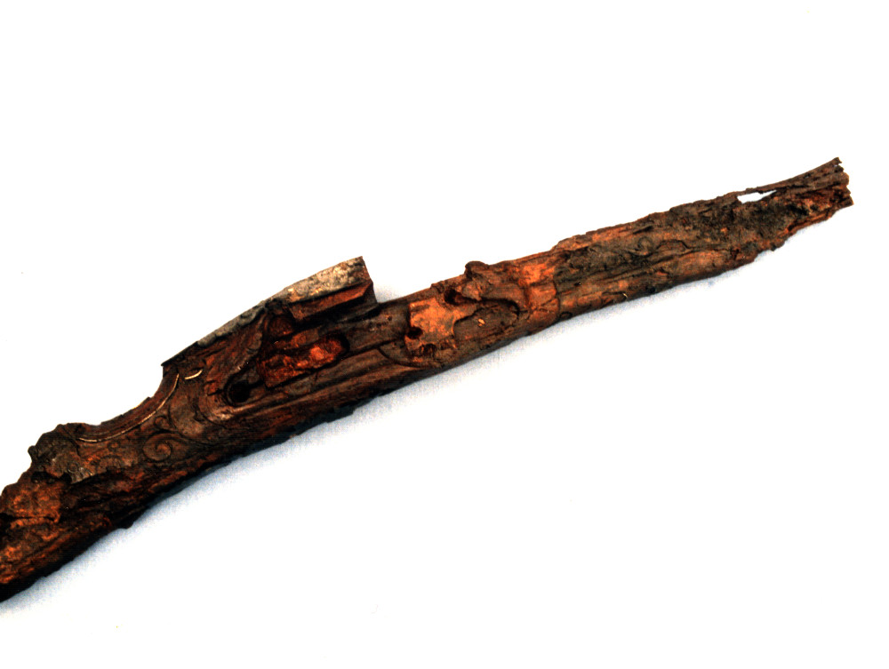

The notes on this photo of a stock say "1715 Plate Fleet, lots of silver wire inlay and overlay".

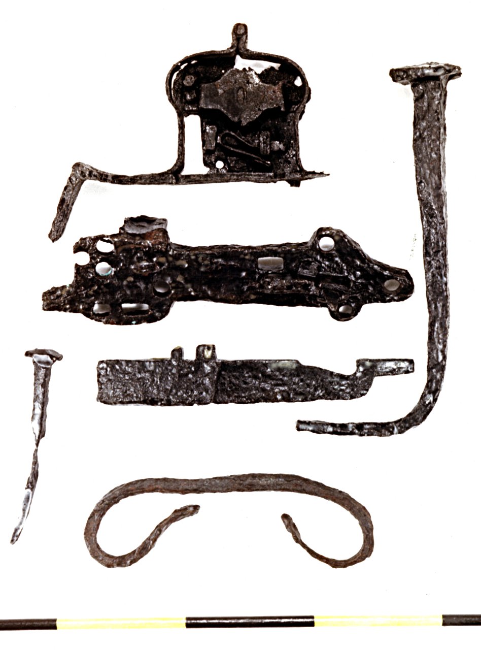

The other 1715 images are not-to-scale drawings, but there is a photo labeled "From one of the Tallahassee Mission Sites ca 1656 - 1704" in the mix. A miquelet-lock and main spring are easily recognizable.
