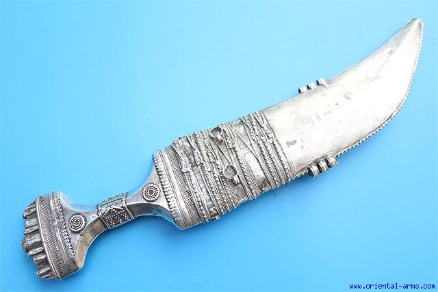

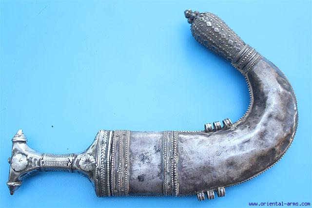

AFAIK, Yemeni jambiyas are worn under the belt, kind of "tucked in"
However, many scabbards have little rings at the back of the scabbard? What are they for? Are Yemeni scabbards sewn to the belt through them?
If so, why at the back? Wouldn't front of the scabbard be more logical?
Furthermore: here is a pic of the late Jordanian king Abdulla: his bodyguard on the left ( and, perhaps, even the one on the right) wera their Jambiyas outside the belt. Using the little rings? Any ethnic preferences? Any other thoughts?

Hey Ariel,
These are worn outside the belt with leather through the rings and inside the belt. The examples of ones tucked behind the belt I saw are new marriages mostly.

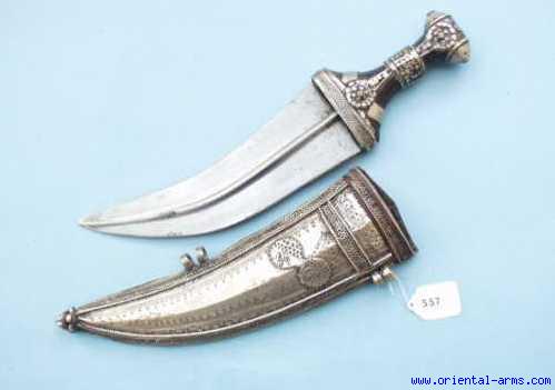

Picture with the black background shows a touristy khanjar so the rings are not right.
Old 28th April 2014, 10:35 PM   #4
Hey Ariel,
Thanks.
But I am still confused: all jambiyas shown in the S. Gracie's book are tucked behind the belt and there are no visible retaining cords/ straps.
Furthermore, most jambiyas on Artzi's site have no little rings.
If what you are saying is correct ( some worn inside, some outside), is there a tribal/social class/ ethnic distinction between them? I can imagine the way to secure these "ring-y" jambiyas outside the belt, but IMHO, the only way to do it would be to wear them vertically, i.e. Manassib-style. How would it influence the Thouma jambiyas?

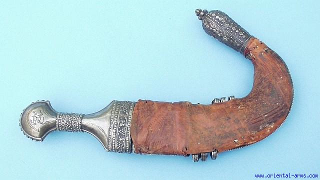

I looked again at Gracie's book. And... I think I might have found the answer:-)
If one looks very,very carefully, many jambiyas worn behind the belt seem to have a set of sturdy staples or even rivets at the junction along the side of the scabbard, implying metal rings underneath the belt. If so, they just created a single piece: belt/scabbard that was worn together as one unit. That assured firm fixation of the scabbard behind the belt and prevented jambiya from being lost. An interesting thing, is that the same feature is present on the belt/scabbard unit dated 1707. So, it is not the feature of the new jambiyas. Perhaps, vice versa, - the old ones.
Still, the last one in my series is puzzling: the rings just stick out behind the scabbard. What were they attached to?

Salaams~ Rings on Yemeni and Omani weapons are unrelated. On the former the rings appear as anchor points tie down points onto the belt but on the Omani Khanjar they are huge , frontal and part of the architecture and structure of the scabbard... and may be 4 ringer, two ringer or 7 ringers... In fact the odd variant appears with more than the usual 7 ring maximum on occasions. The Royal Khanjar with 7 rings was redesigned from essentially the 7 ring Muscat Khanjar but beefed up with an Indian style Hilt by Sheherazad the Persian wife of a previous Sultan see.. The Omani Khanjar.
Ibrahiim al Balooshi.
So, do you think I was right in my suspicion re. staples/rivets attaching the scabbard of the Yemeni jambiya to its belt?

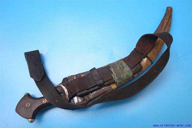

I know that the jambiyas in northern Yemen usually have a strap on the back side of the belt with the sheath often sewn to the strap though they have rings from time to time. The south Yemen Jambiyas shown in your picture are often just tucked into a twisted sash or worn with a thin belt. I would assume that is why they often have rings. In the 60's the British had outlawed the wearing of Jambiyas in the protectorate so I have only seen photos of this style of Jambiya worn. The Saudi and Mecca style are worn outside the belt in most photos that I have seen, even the Wahabbi style.

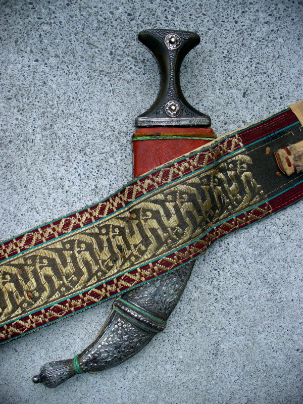

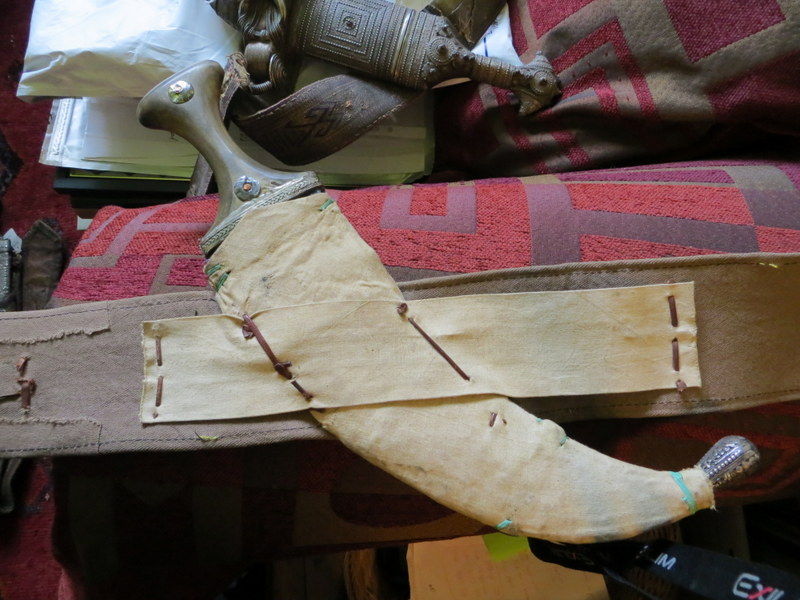

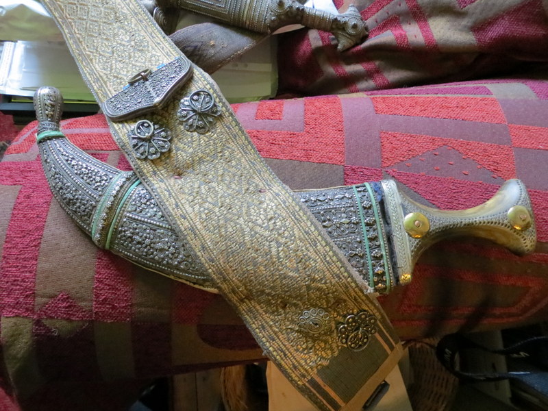

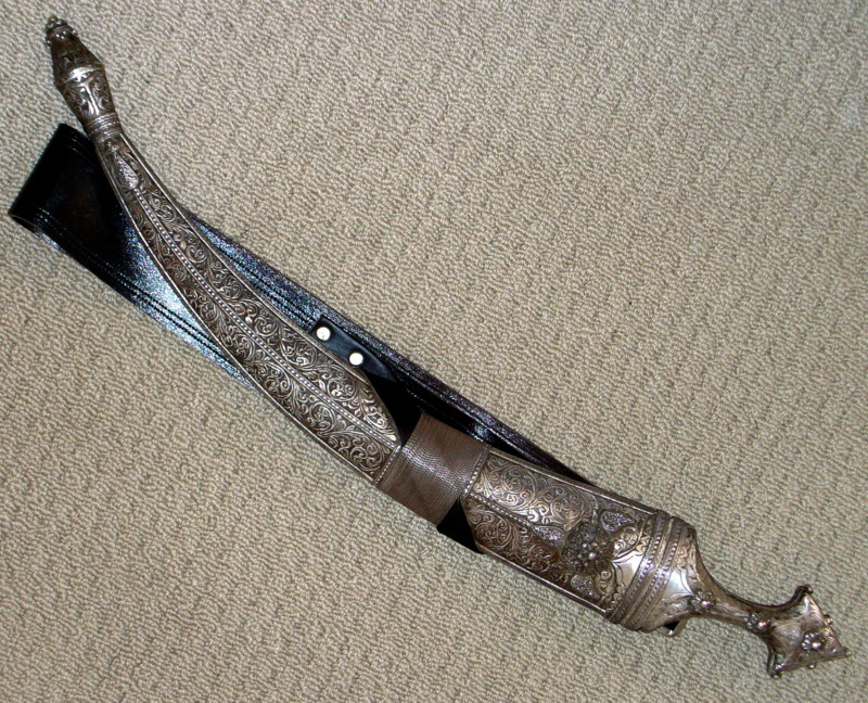

Here are photo's of the front and back of a Yemeni jambiya attached to its belt. My understanding is that the jambiya is very often bought separately from the belt hence it is logical that the jambiya would be fully finished in it's own right and yet contain the "eyes" necessary to attach to a belt.
Incidentally, I would not be surprised to learn the British banned the jambiya in Aden during the insurgency, but not so sure about the hinterland. British colonial administration was nothing if it was not pragmatic.

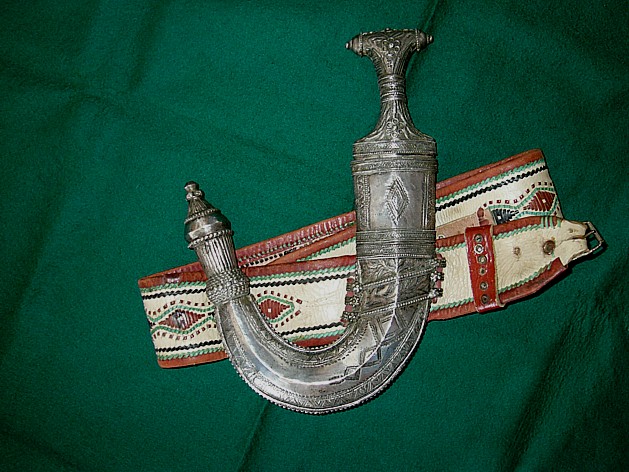

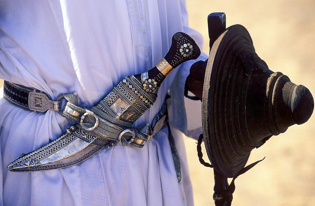

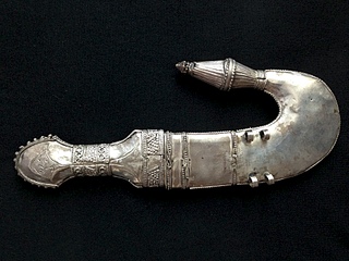

Salaams Ariel~So far as I can see you have sorted the rings out...Omani Khanjars don't have these peculiar rings except in the case of the weapons shown which are Jebali Salalah variety very closely aligned to the Yemeni form. You can see that when the belt is tightened around the waist that the top weapon lies flat as opposed to vertically. The rings in this case are decorated florally..and function as ties to the two section belt.
Another picture is shown below and at http://www.vikingsword.com/vb/showth...8&page=5&pp=30 at #127 with it configured on an Omani style belt showing the 3 rings reduced to two on each side and somewhat redundant.. The weapon has apparently been fully retro fitted with the mid-scabbard Khanjar style of silver belt wired to big support rings. In the case of the small rings you are analysing it seems the position is variable but is determined by how the weapon sits with the belt....flat or more upright.

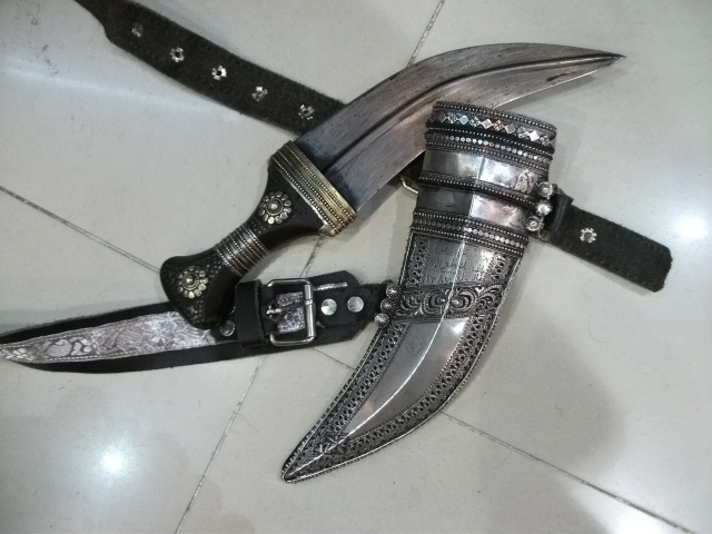

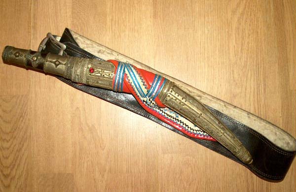

I agree with Ibrahiim's comment regarding placement of the anchor rings. They always seem to be in the position suited to the way a particular style of Jambiya is worn on the belt.
Just a comment regarding the pic of Richard's showing the way Thouma Jambiya from Yemen are attached. This style in my experience does NOT have rings but is attached as shown by lacing to the back covering of the scabbard.

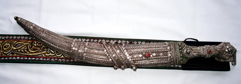

I have attached a few pics of different styles of Jambiya WITH rings showing how they sit on their particular belts. I note that even though these all have attachment rings, they do not all use them. Some as you can see use a strap across the scabbard even though rings are present.
Stu
