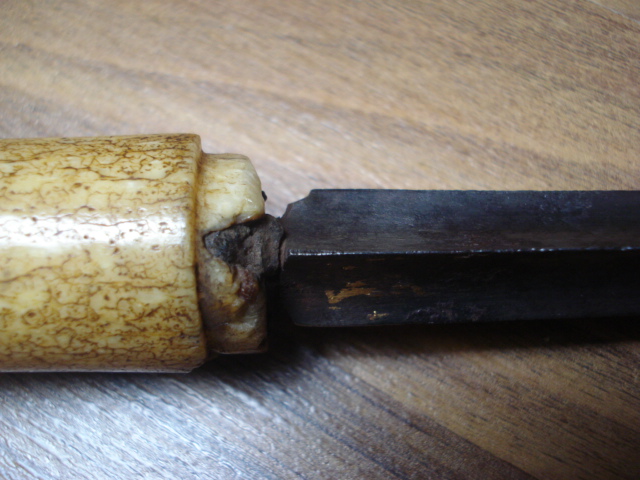

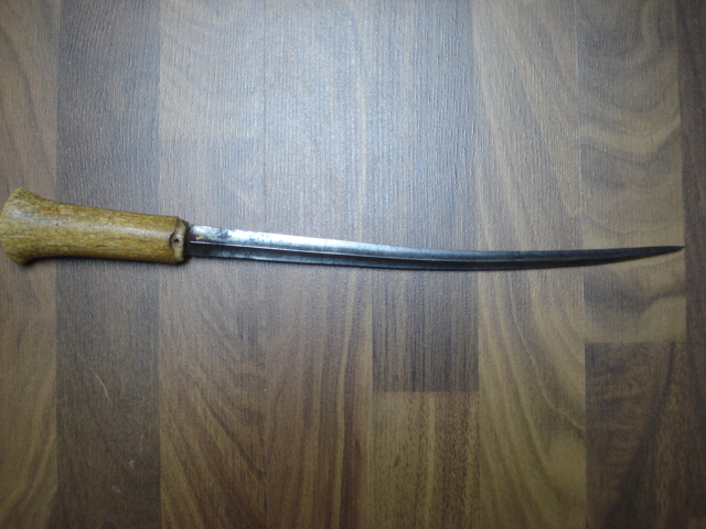

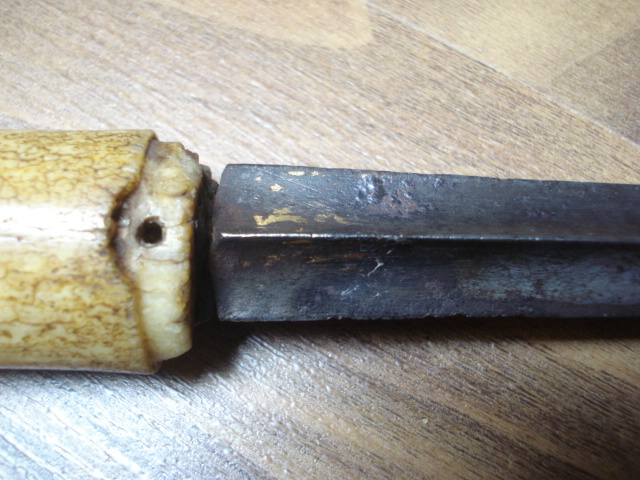

Hi All
Would like to know more about this dagger.
It has a rectangual blade (armor piercing?)
Walrus Ivory grip.
Some traces of gold to the blade.
Length is 40cm.
Maybe the steel is wootz but this is hard to see.
Would like to know age and origin.
My feeling says its Ottoman (court dagger)?
Would like to hear your opinions.
Thanks!

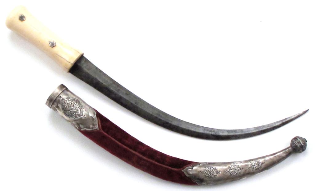

It is Ottoman. Could be a marriage of Court dagger handle and a Hancer dagger blade. the handle could be retrofitted for crossguard or bolster, and the blade yet another later addition. it is of substantial age. Is the ridge on one side only? Here's another hancer dagger without the ridge.

The blade has 4 ridges and as far as I can see the grip and blade are very tight and looks like they Original to each other

both handle and blade are of substantial age, so could be original or of same period. The handle had some sort of attachment in the past, so this made me think it was lost and blade added later.. just a guess. I've seen at least one Ottoman blade with 4 ridges, and it was quite old, around 17 century, so they are known. I think others may have more suggestions. Its an interesting dagger

I'm think it's a cut down and curved bayonet blade added to an Ottoman hilt and is clearly missing its original bolster....which may also have hidden the mystery of whether the two were meant to be together or not.

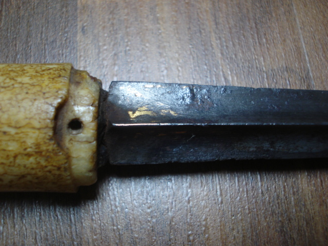

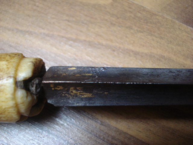

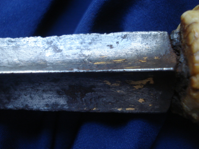

The blade has on the base on all 4 sides remains of gold inlay,so I dont believe its an old bayonet blade.see extra pics

nice walrus handle, i could be wrong but it looks like a marriage to my eyes,the blade looks like its from european smallsword re shaped perhaps

Looks like a genuine item. Was there smallswords with 4 ridges made curved? everything is possible, but this item would have looked alot better if the missing part was there.

If you see it in real you can see that the steel and shape of the blade is well made in that way,also the proportion in relation to the grip.
What can be the missing part shape etc maybe a simple silver ring of 5mm thickness?

The recesses in the ivory suggest a four-sided quillon arrangement to me. (just an idea)

But mjamerks although despite description of 4 ridges, this can not be seen in the pics, , can we have a photo of other side of blade & hilt please to confirm ?

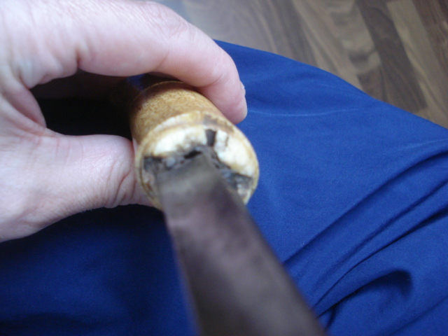

I believe that this shows both sides of the blade on this dagger as the hole in the hilt is broken out on one side and not not the other. I hope this is of some help until better photos can be added by Mjamerks.

Hereby pics of all 4 sides.
every side is 1 cm wide,the blade is exactly 30 cm long.
Martin

Lebel Model 1886 ? That has 4. It could perhaps be a cut down sword stick... or some variant gilded bayonet used in hunting..?

The ridges of a lebel bayonet are much thicker,compared with this blade the ridge is very thin almost sharp also the point is different compared with a lebel bayonet.
Maybe it is not a bayonet at all but made in the shape it is specially.

The blade could be something similar to this. This one is not bayonet's, could be a spear, alam or something similar. I've seen another Ottoman dagger with a huge ivory handle and short 4-edged blade - an obvious old retrofit. these types are not common and likely old put-togethers from different parts.
