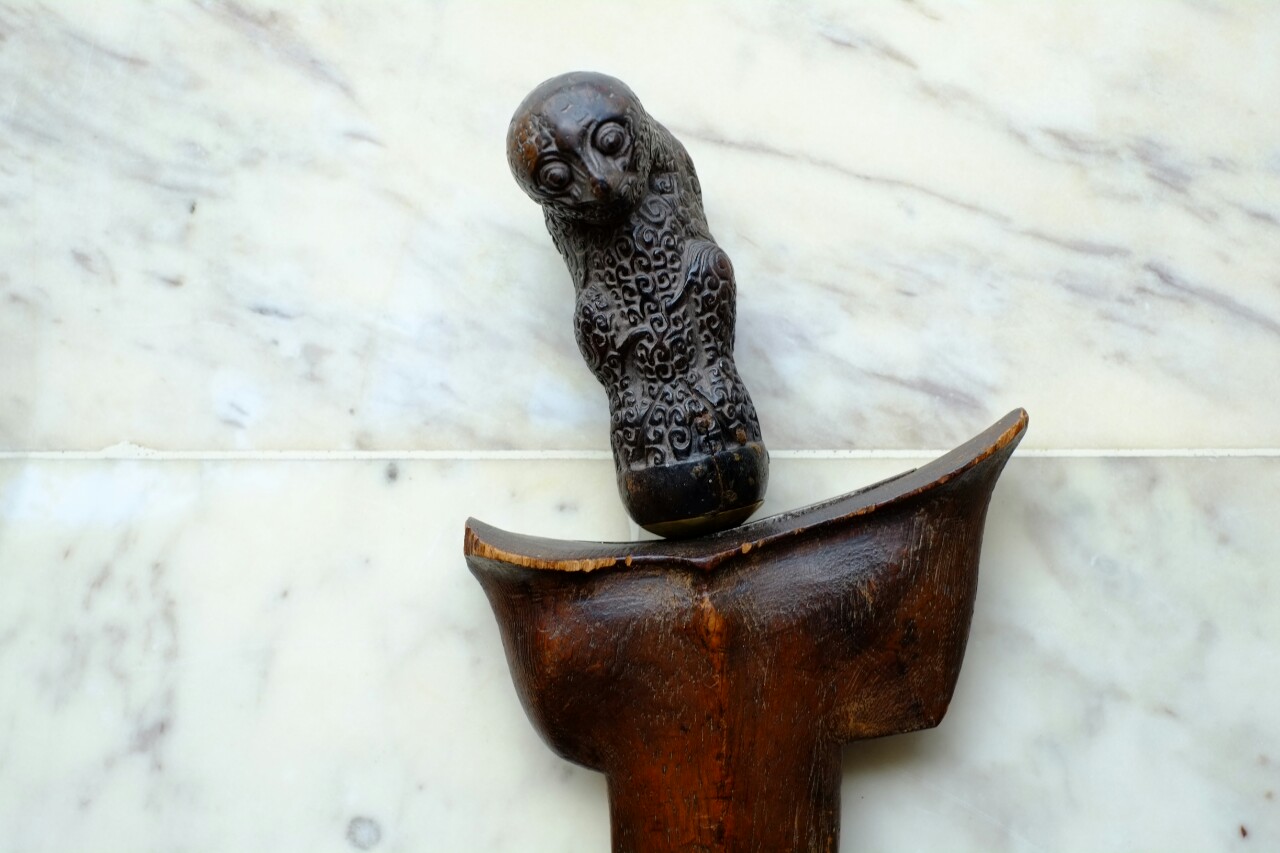

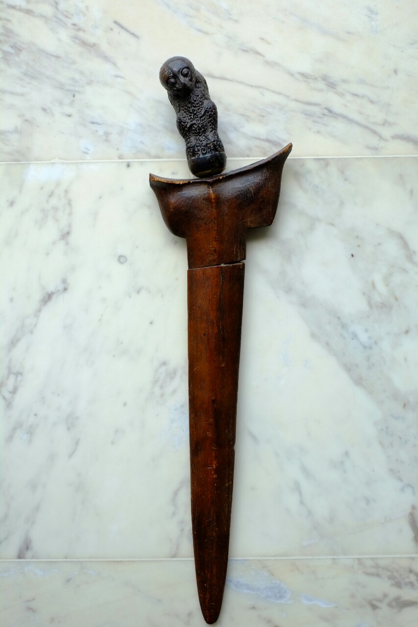

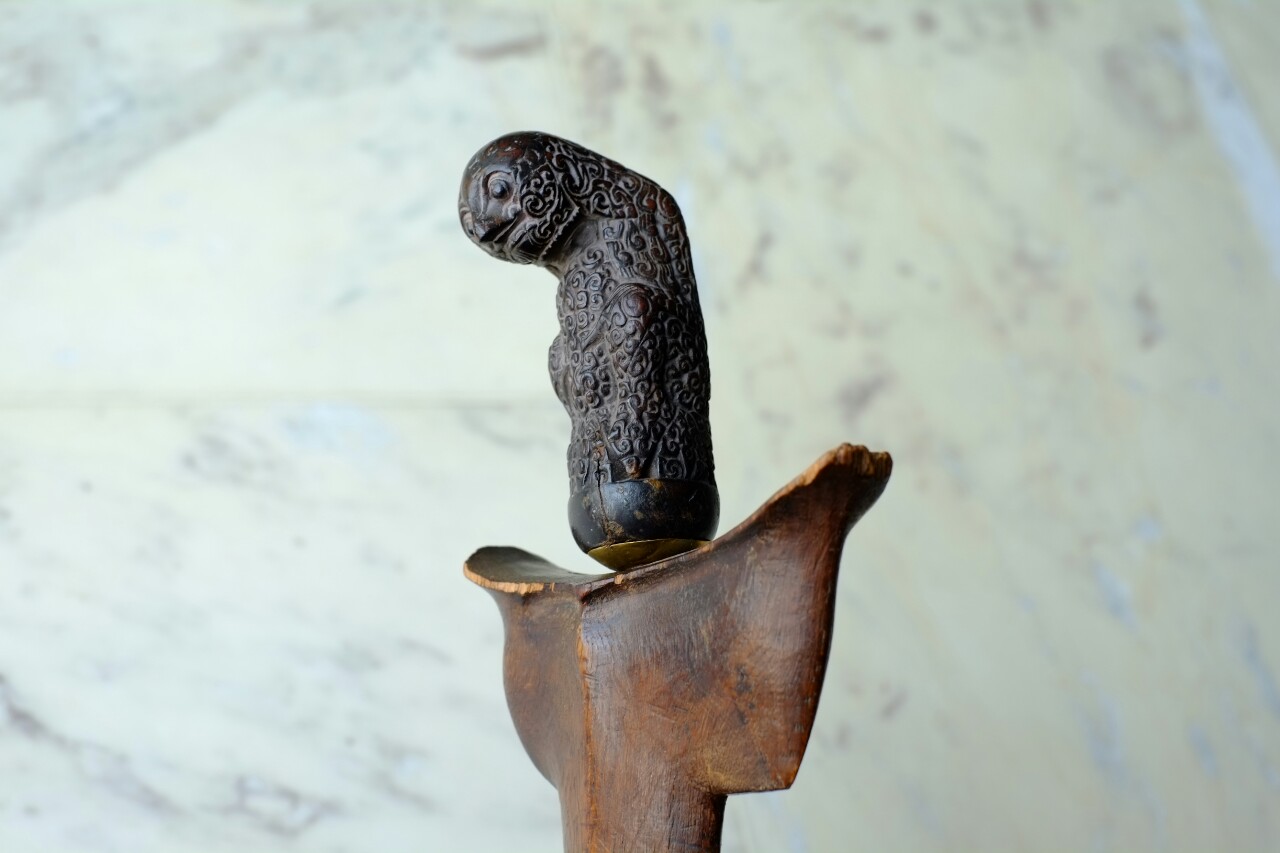

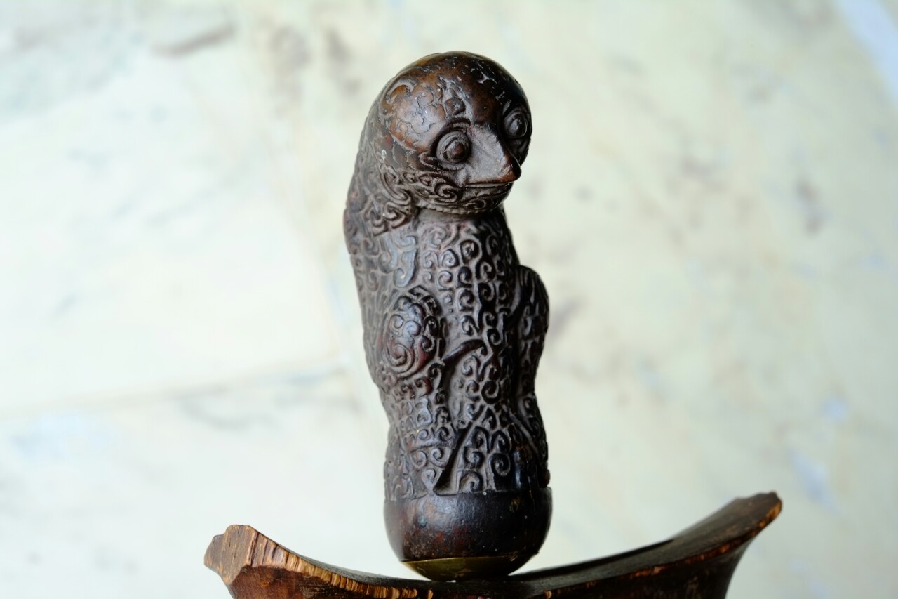

Sharing this keris I bought off ebay recently. Looks like an old Cirebon keris. The original hilt had its nose and face chewed off by mice. I replaced it with a similar hilt from my collection.
I always wanted to have an example of this old keris form because the sheath form seemed to be the preceding form for later Central Javanese sheath forms, as well as Bugis, Malay sheath forms.

Hello Kai Wee,
nice to read again here from you!
I think that I remember this keris. Certainly a very old keris but I am not sure about the Cirebon attribution, could be a Banten keris. But North/West Java origin for sure.

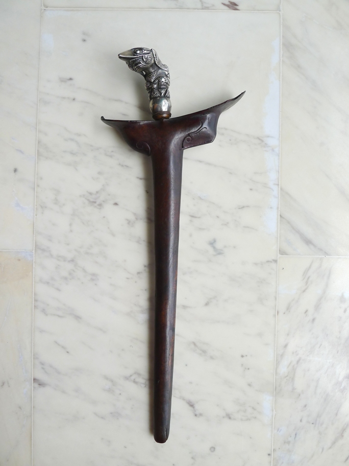

I mentioned in another thread my hypothesis that the tajong evolved from Cirebon kerises. Here's an early coteng keris with a sheath that is reminiscent of old Cirebon style. The hilt is probably younger than the sheath, but of a older form, which is closer to the Cirebon rasaksha/Garuda hilts, with its shorter nose and similar posture.
