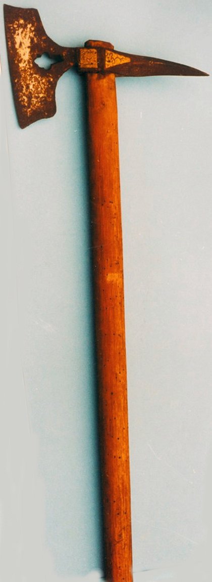

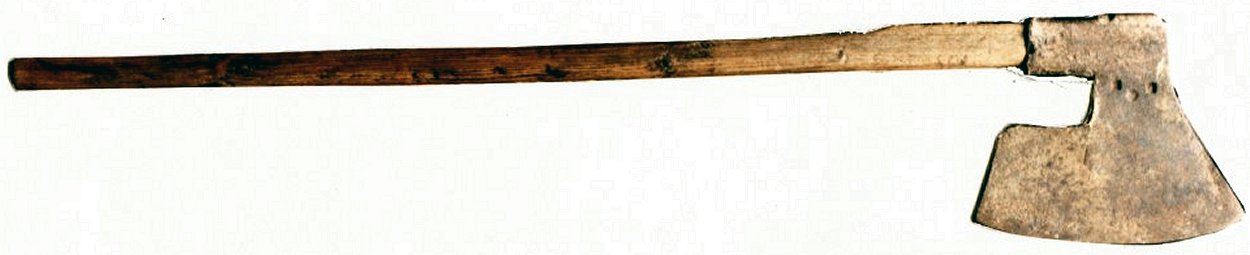

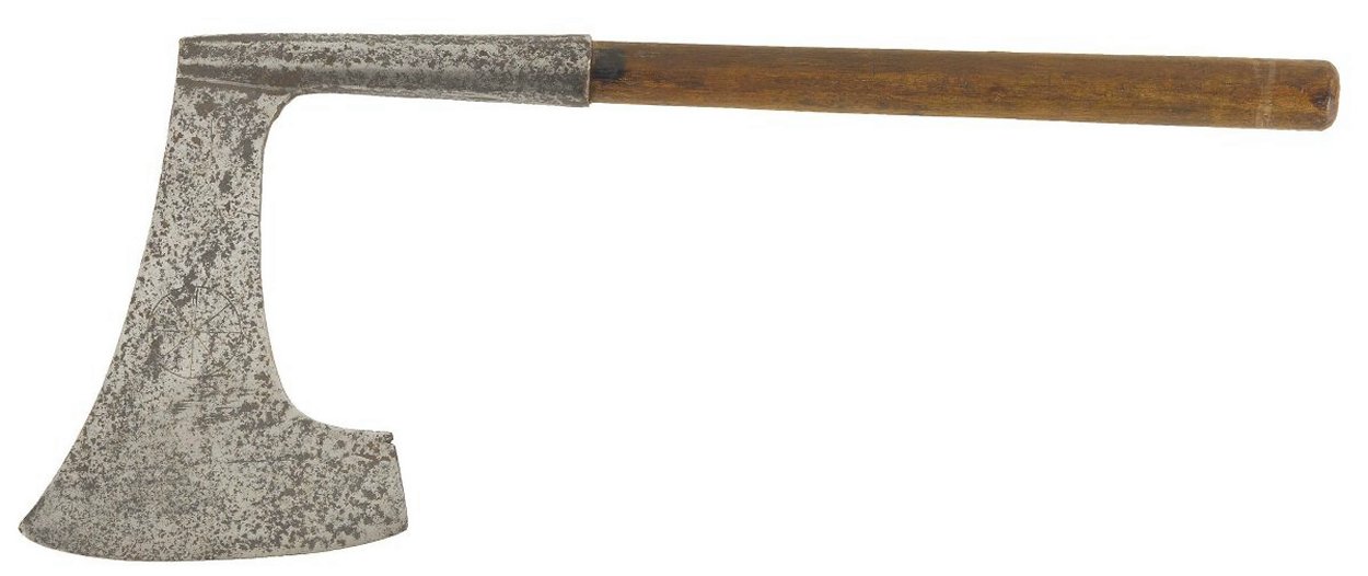

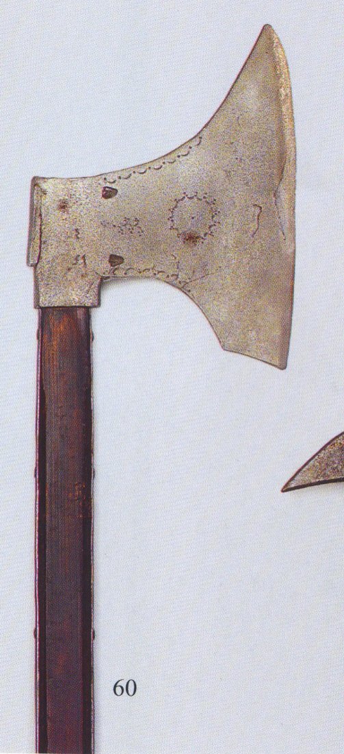

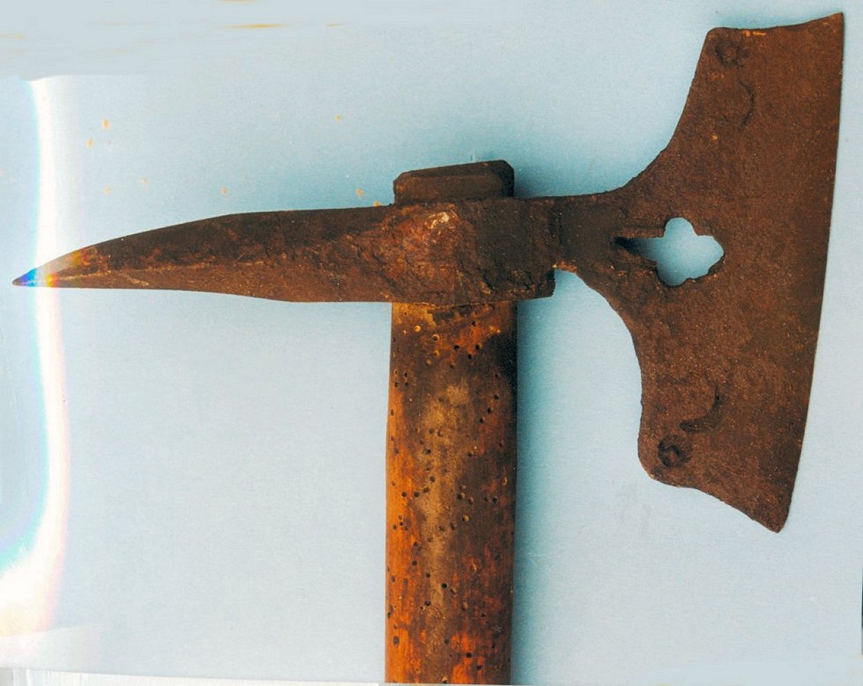

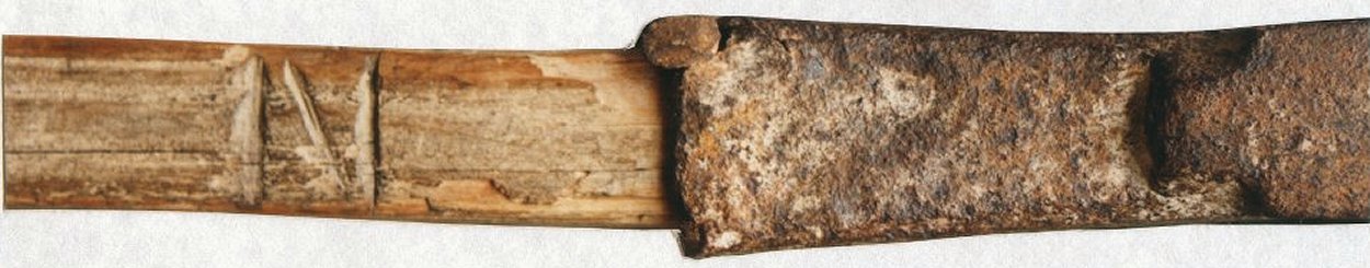

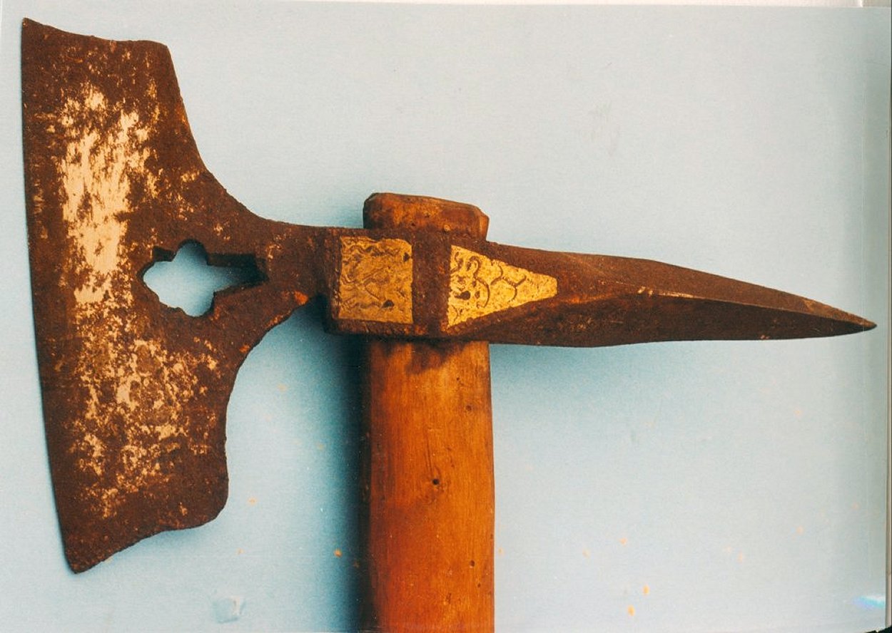

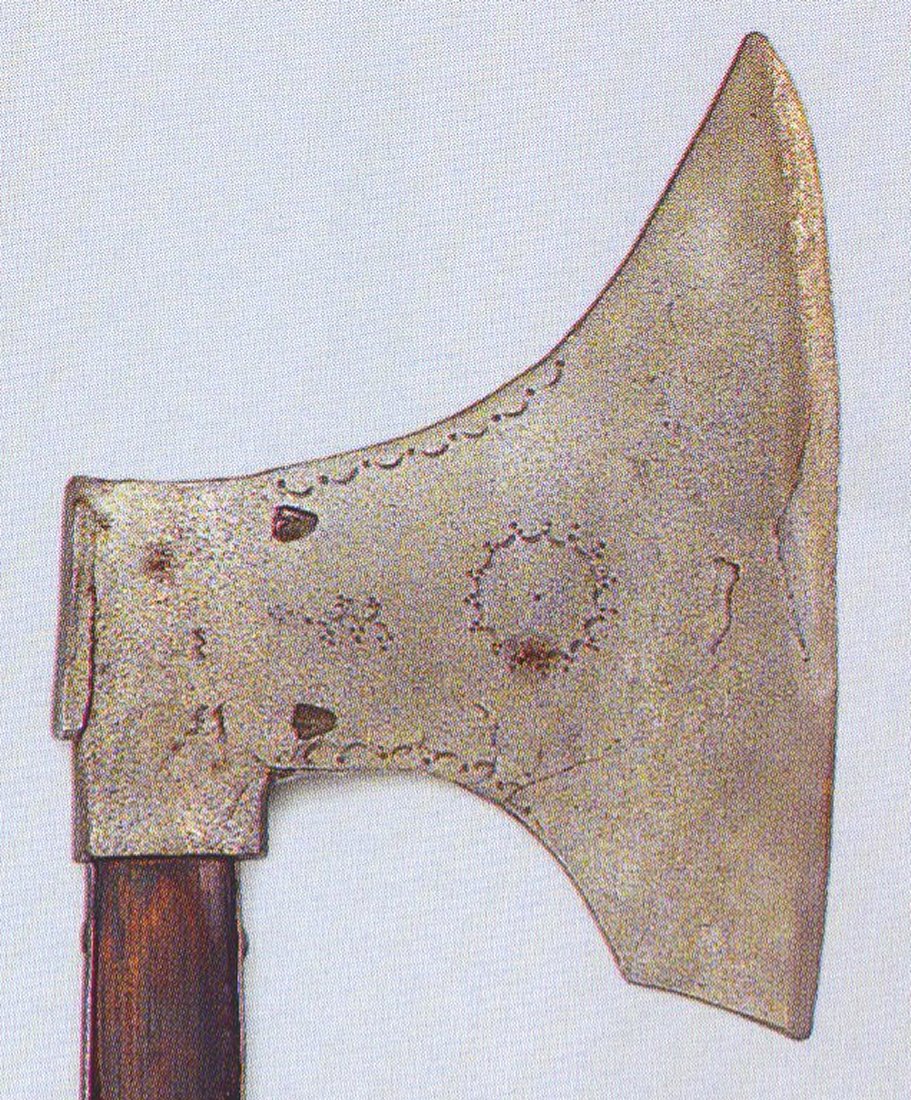

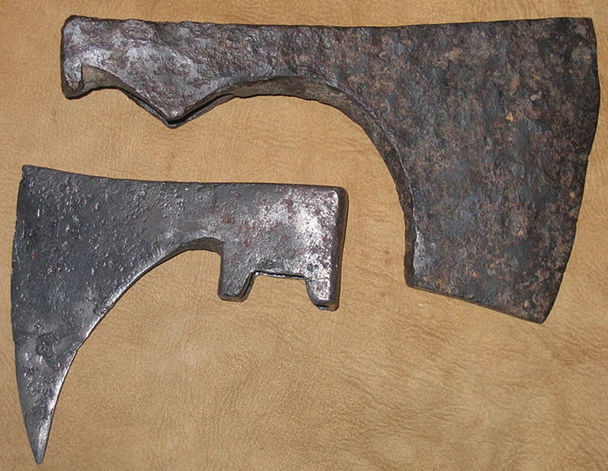

The hafts of most samples I have seen were of ash wood, just as is the case with long spears (pikes), but some were made of oak. By the 16th c., the blades mostly have sturdy spikes to them, often pointing to the rear.

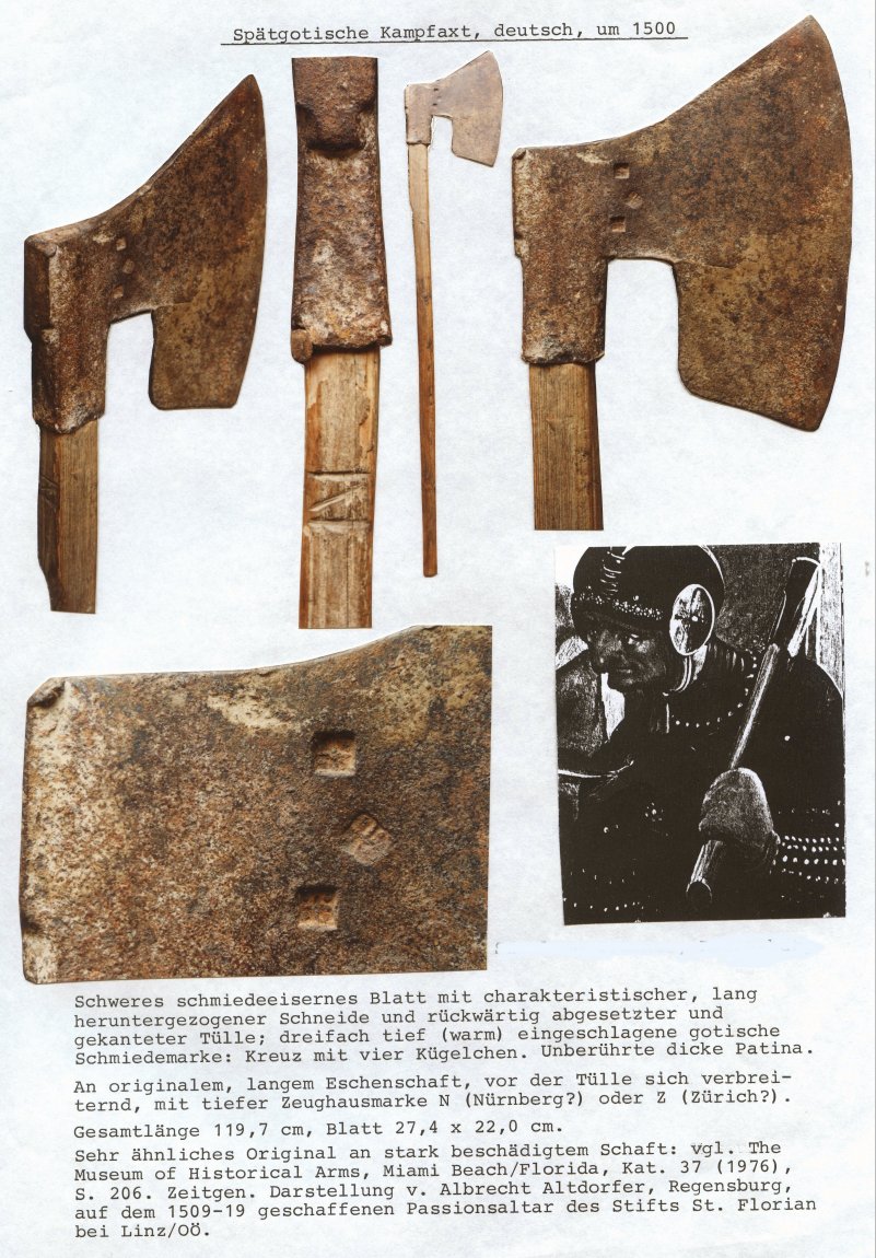

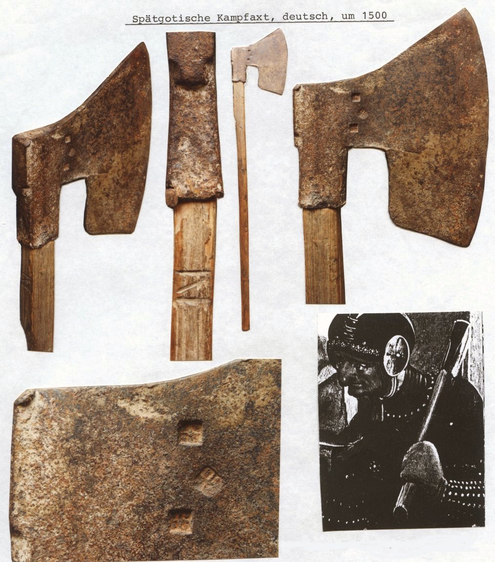

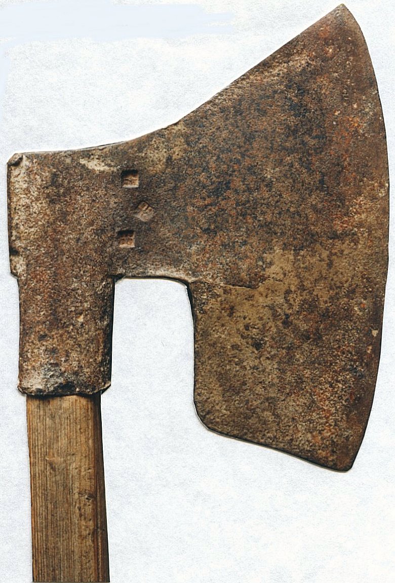

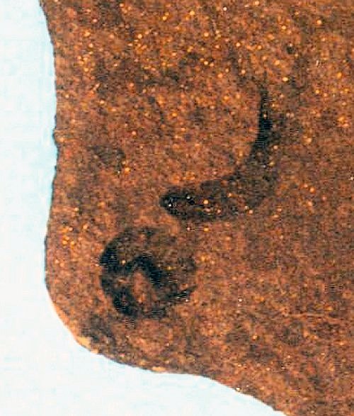

The first complete axe attached, from the Late Gothic period, 14th-15th c., I found on the internet; it is believed to be in a Russian museum.

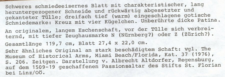

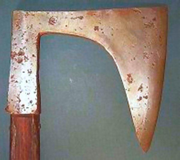

The second axe used to be in my own collection; it could be dated to ca. 1500, the blade and figured ashwood haft both retaining a congruent and stable old patina. The blade was deeply struck three times with a Gothic traditional blacksmith's mark, a cross with four pellets, the haft was incised with was either a letter N (for Nuremberg?) or Z (for Zürich?):
http://www.vikingsword.com/vb/showth...ht=foot+combat
Overall length 119.7 cm, the blade 27.4 x 22.0 cm.
Michael

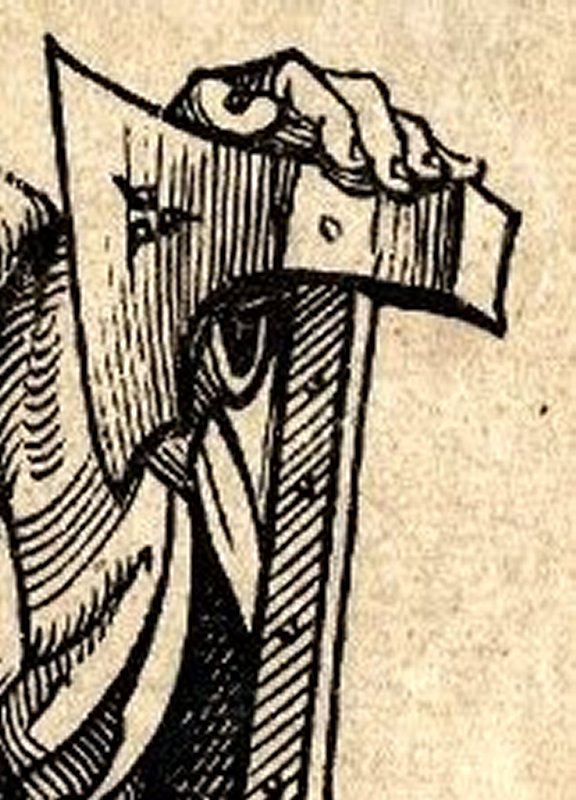

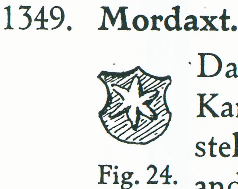

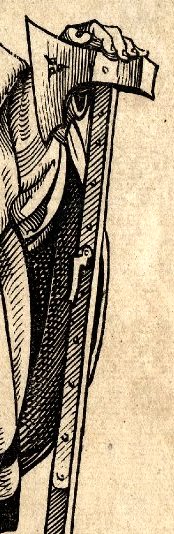

Albrecht Altdorfer, the famous painter belonging to the so-called Donauschule (Danube School), created the altar of St. Sebastian in St. Florian near Linz, Austria, in 1505-19; a mercenary soldier on the right is depicted with the very same type of axe as 'mine' on his shoulder (top attachments).

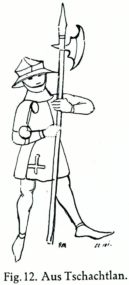

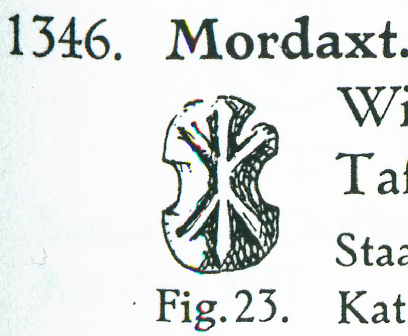

Next there is a line drawing based on Benedikt Tschachtlan's earliest Swiss Chronicle of 1470, and another drawn after a watercolor by Diebold Schilling from his Bern Chronicle of 1483.

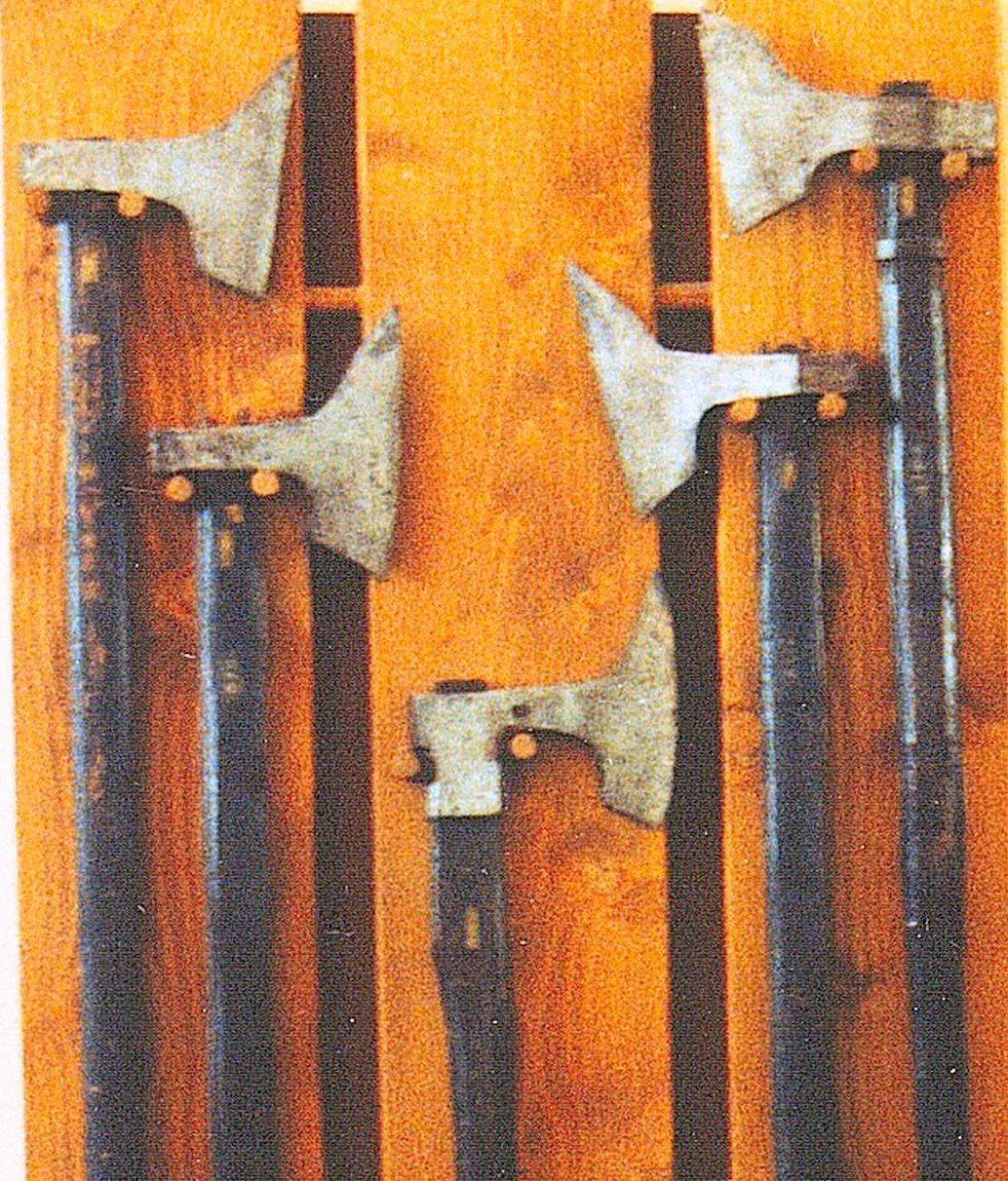

Attached next is a group of foot combat axes, mid- to 2nd half 16th c., which I photographed in the former Munich Armory in the City Museum of Munich, which was sadly closed down to the public for some 20 years. Their blackened ash wood hafts conveyed the characteristic somber 'armory' atmosphere.
A fine and very similar axe, one side of the blade partly gilt, retaining its original figured haft painted red (now wormed), 2nd half 16th c., was discovered near Augsburg, Bavaria, together with other weapons of early Thirty Years War Date; one piece of printed paper found was dated 1621. The blade was struck with a maker's mark (attachment) and pierced with a short-stalked Gothic trefoil ornament (gestielter Dreipass).
As some of the guns featured Augsburg marks we may safely assume that that axe too was of local make.
All items were preserved in completely untouched condition and stowed in the false ceiling of a 15th c. house, seemingly under the pressure of an imminent conquest; all firerams were left uncleaned after firing and heavily rusted, the pyrites in the dogs of the wheellock guns completely abraded down to the jaws of the dogs!

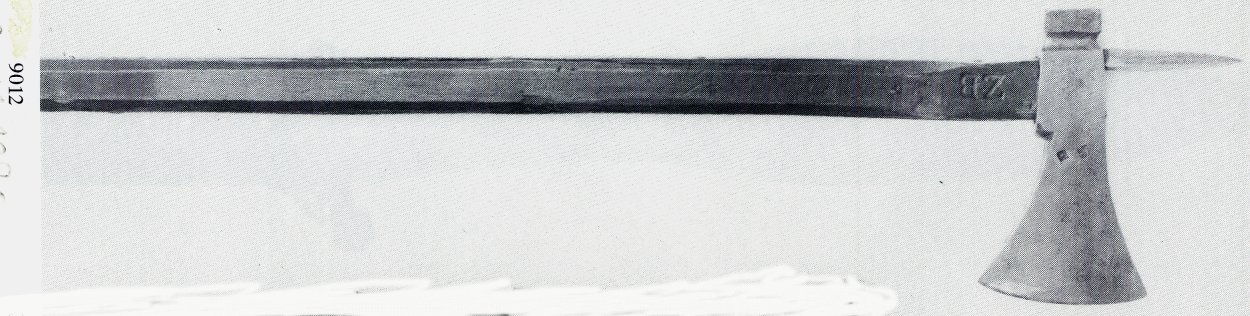

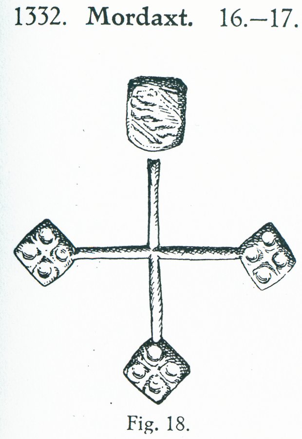

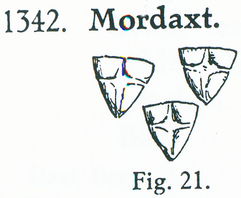

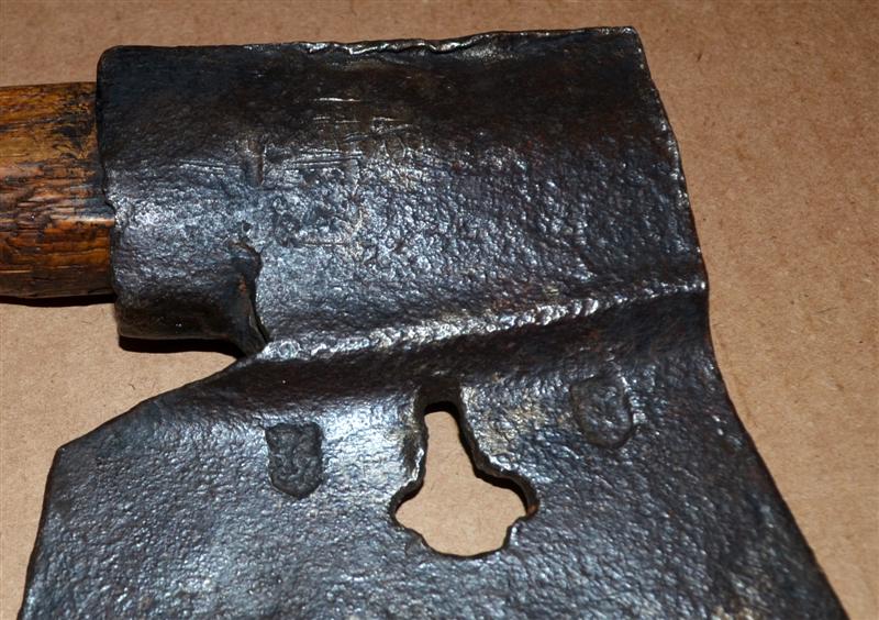

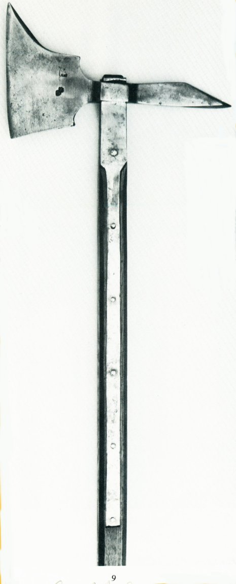

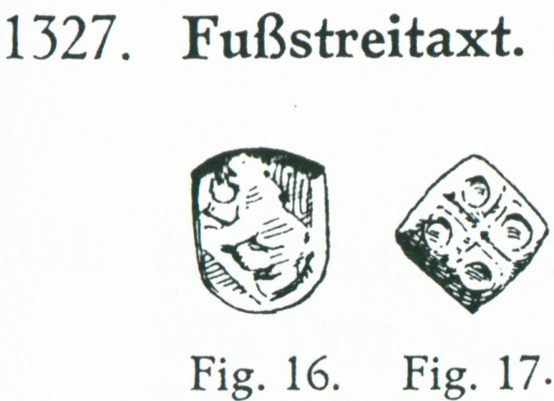

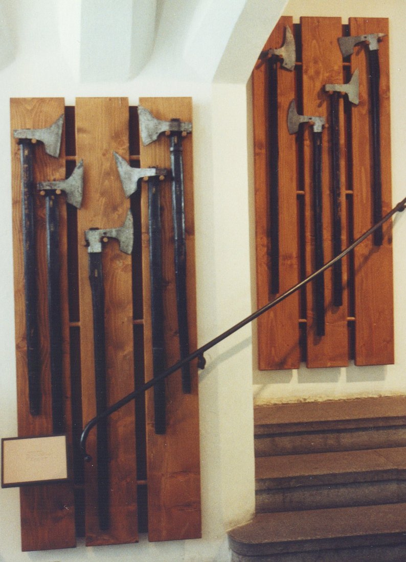

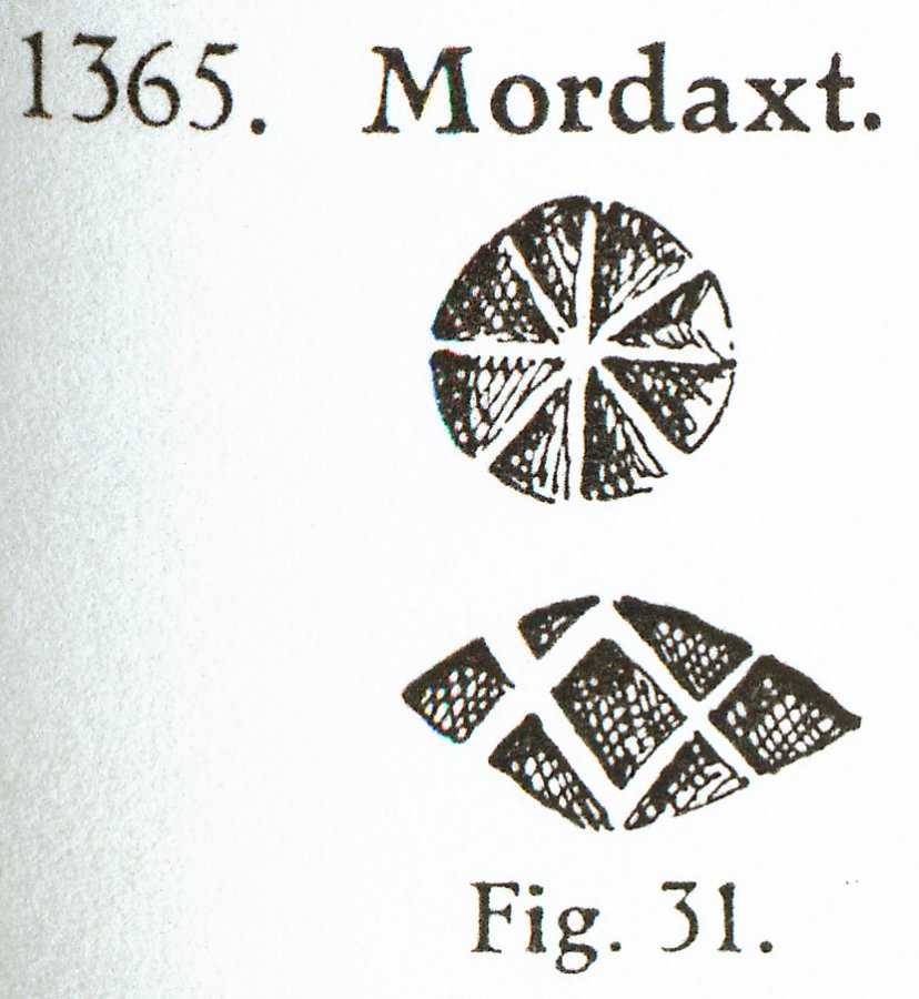

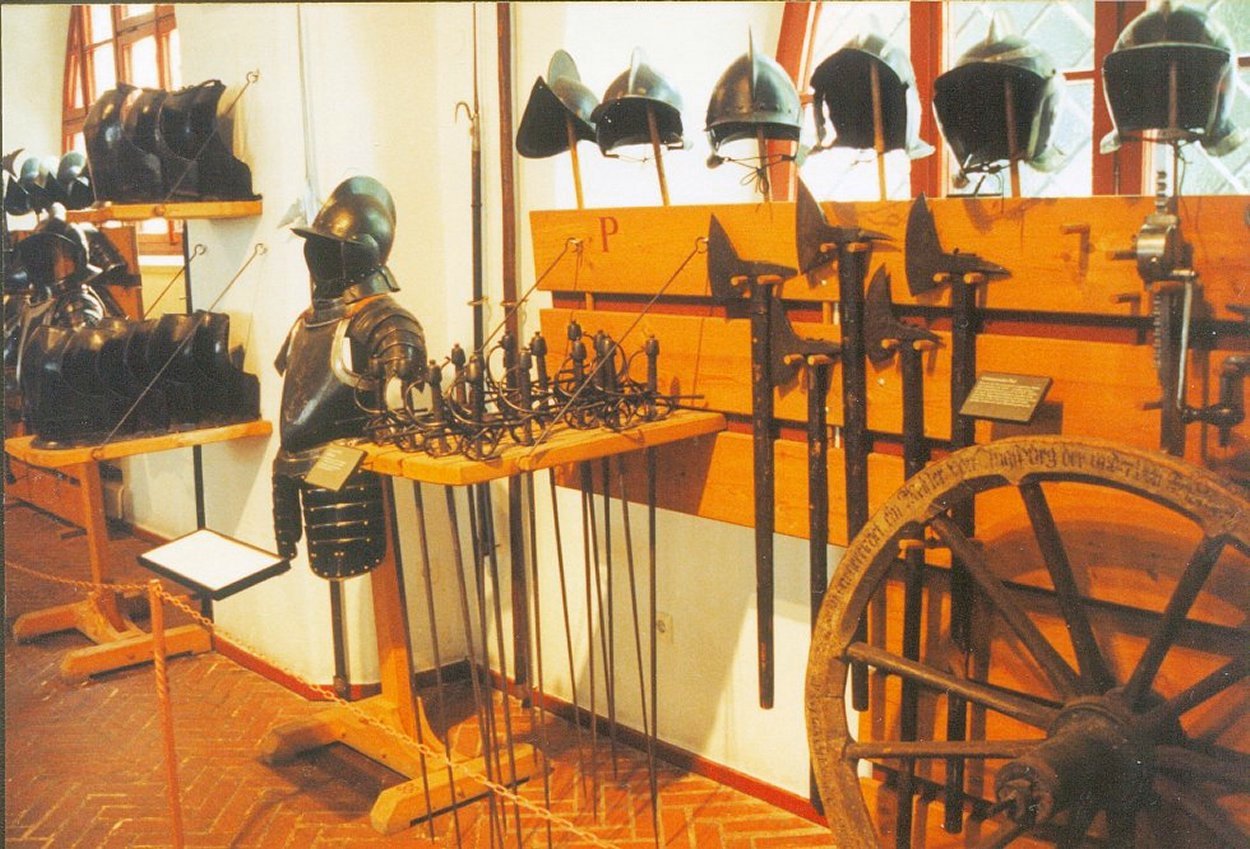

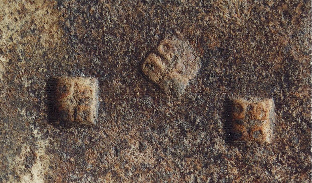

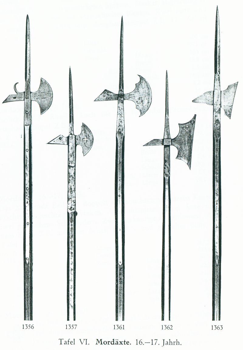

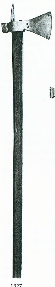

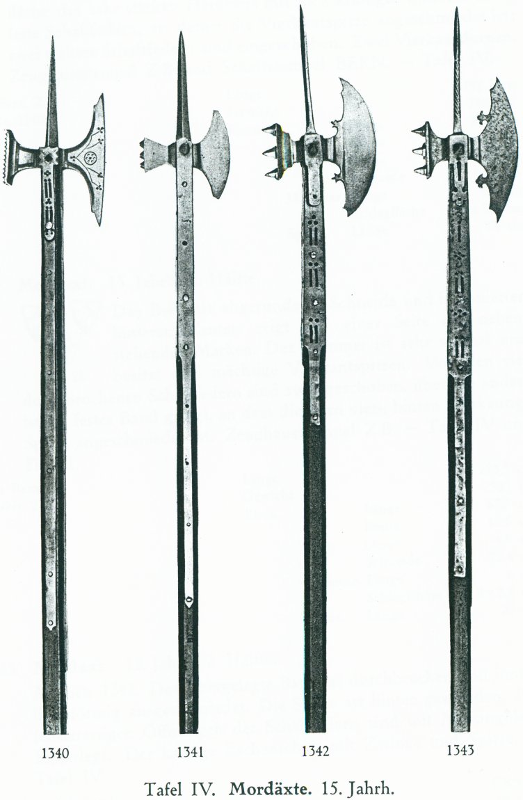

The Historisches Museum in Bern, Switzerland, possesses an impressive number of various types of foot combat/poleaxes which were illustrated, with their measurements published by Rudof Wegeli: Inventar der Waffensammlung des Bernischen historischen Museums in Bern, Vol. III: Stangenwaffen (polearms), 1939.
Wegeli started out with two early blades, 10th-12th c., 21.3x16 cm and 16x8.7 cm, and another of 15th c. date, 17x10.5 cm (b/w attachments), before introducing the type of Swiss poleaxe called Mordaxt (murder axe), hafted in ash, branded with the initials ZB for Zeughaus (armory) Bern, and with a short vertical spike on the top.

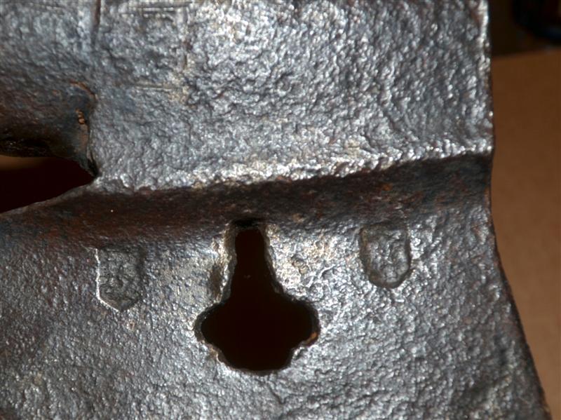

The first hafted axe attached is 2nd half 16th c., no. 1127 in the group scan, the four-sided pole of ash wood. Two long lateral iron straps are attached to the narrow sides of both the haft and blade; one is riveted to the spike, the other bears a horizontal reinforcement. The blade is struck with the Bern city mark, a bear, and a maker's mark, a cross with four pellets, just as on the axe formerly in my collection.
Overall length 151.6 cm, weight 2.260 kg, the blade 20.5 x 12.2 cm, the spike 7.5 cm long.
An axe from that very same series, the blade struck with identical marks, the haft also branded ZB, 153 cm overall, failed to sell at Galerie Fischer's, Lucerne, on 26 May 1988, lot 9012 (see color attachment).

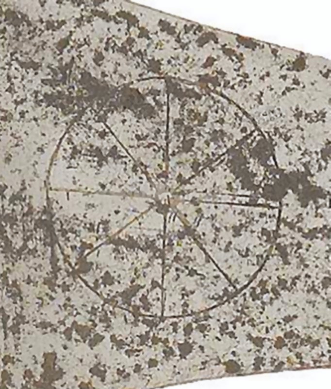

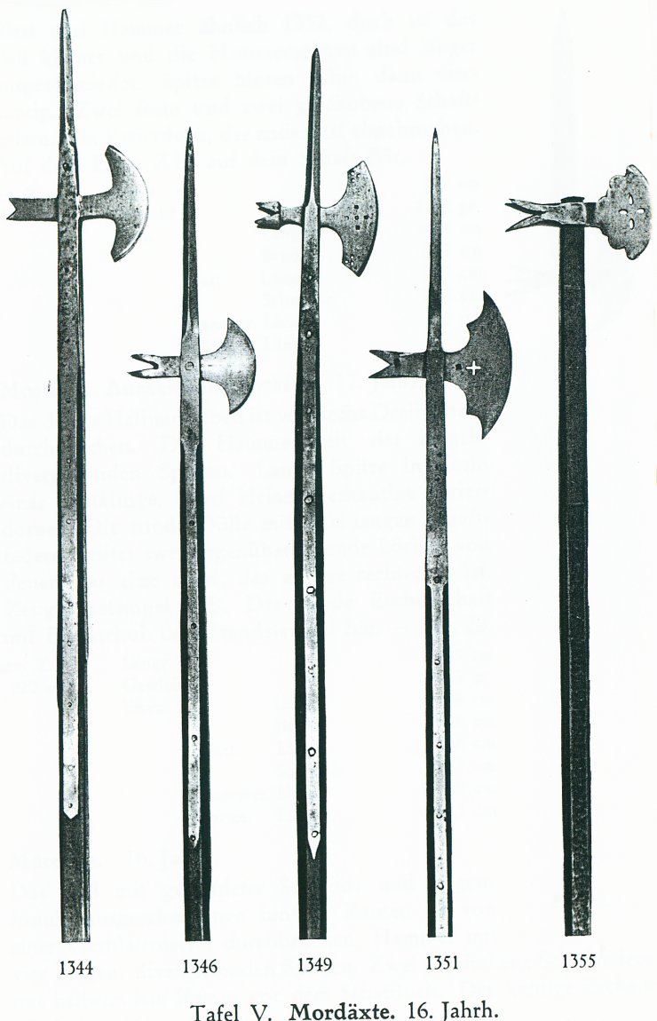

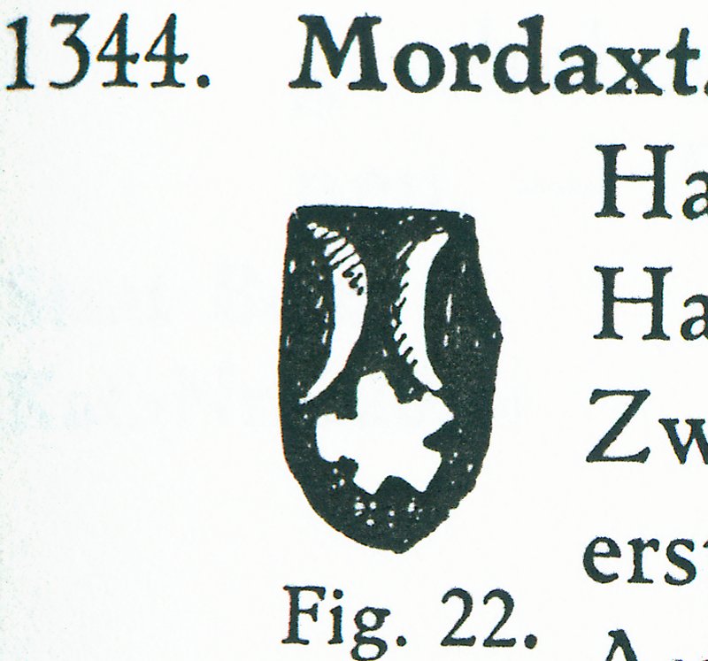

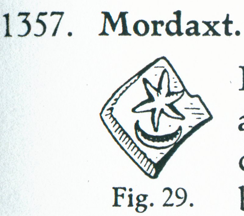

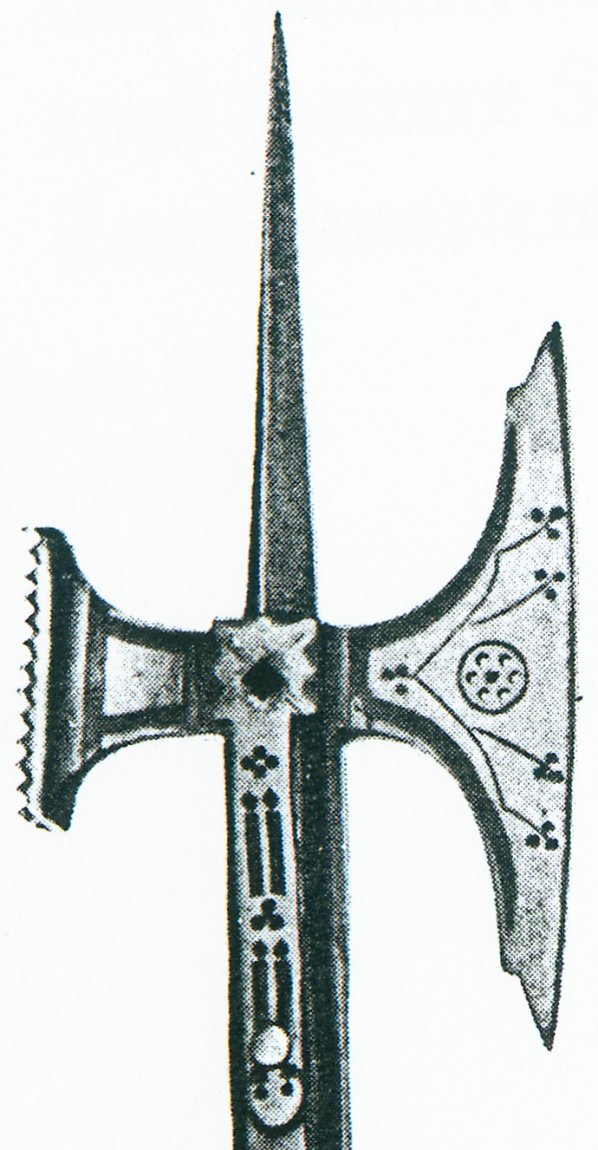

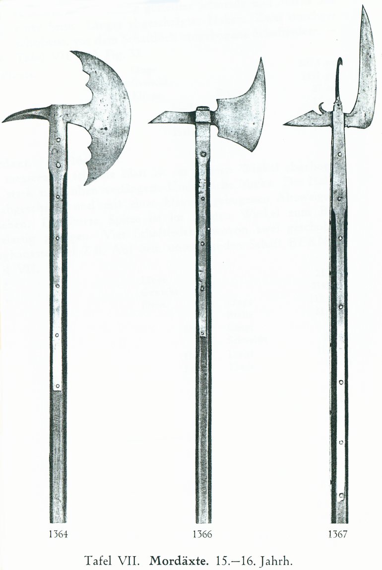

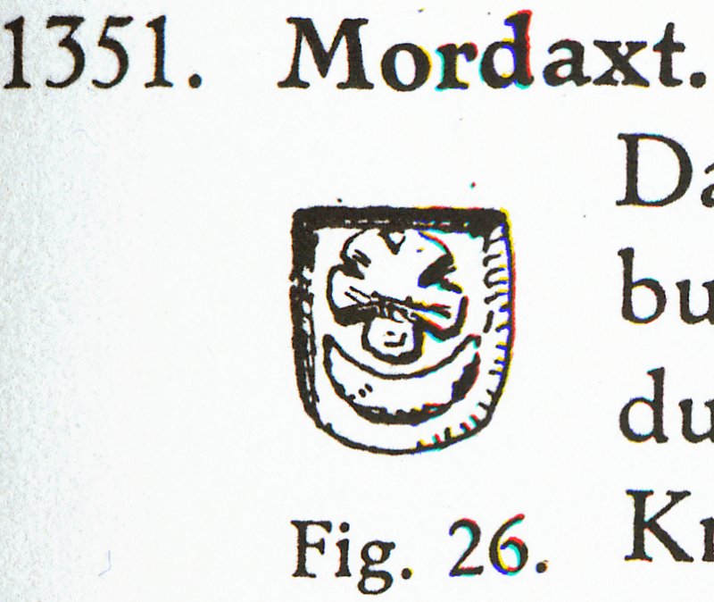

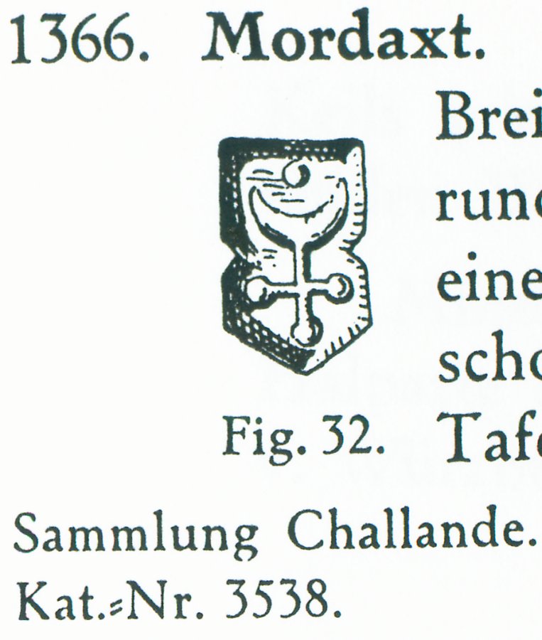

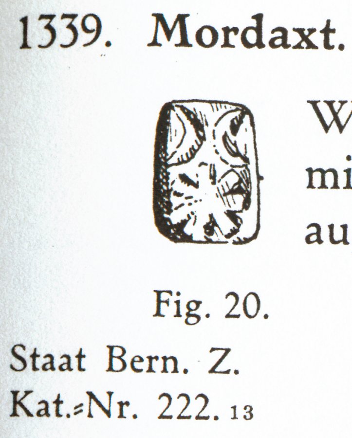

More variants of 15th to 16th c. poleaxes in the Bern Museum, and their marks, starting with a 15th c. detached axe blade and socket.
m

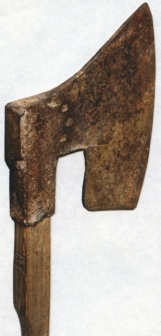

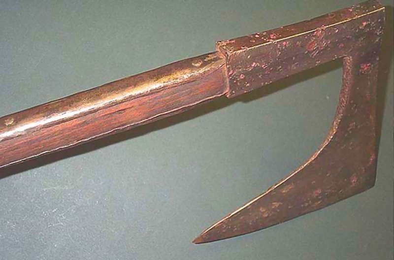

Finally attached are images of two Swiss axes of types represented in the Bern arsenal that were in Fischer sales on Nov 24, 1976, lot 9, mid-16th c., the blade struck with an orb and cross mark, and on Sept 6, 2007, lot 60, also ca. 1540-60.

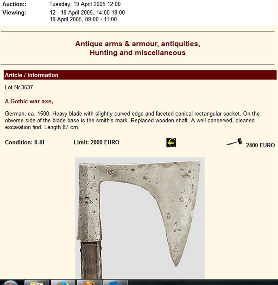

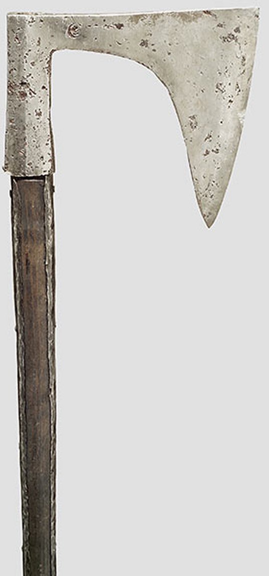

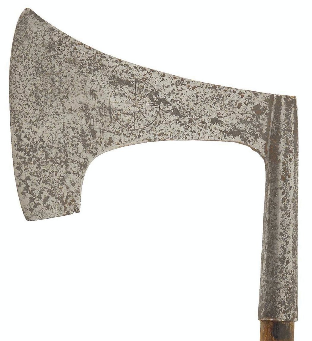

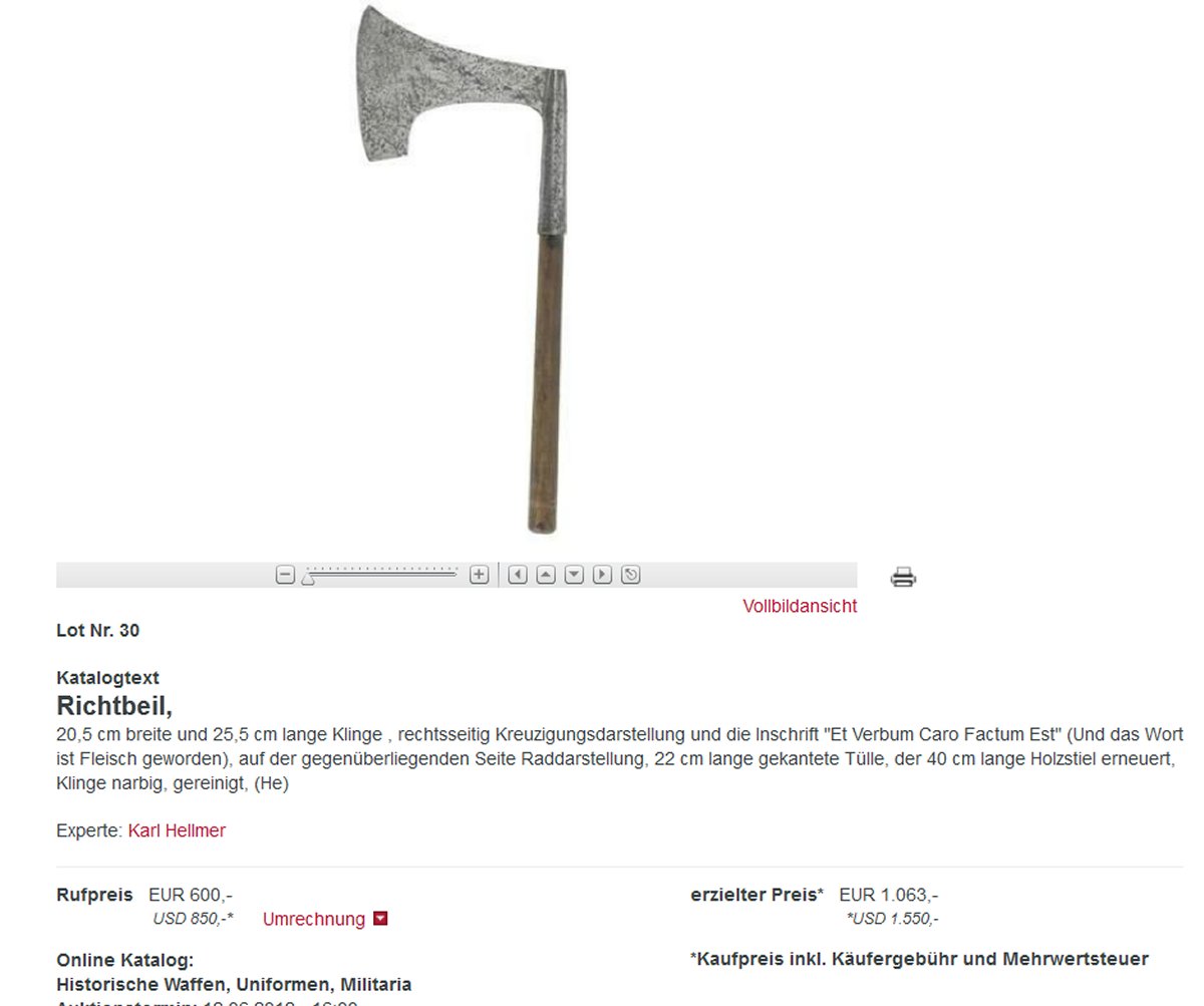

Mid-15th c., sold at the Dorotheum, Vienna, 26 Februar 2012.
m

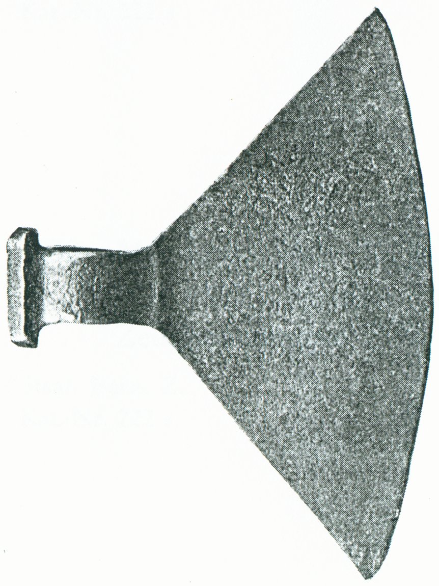

Default Early battle or executioner's axe

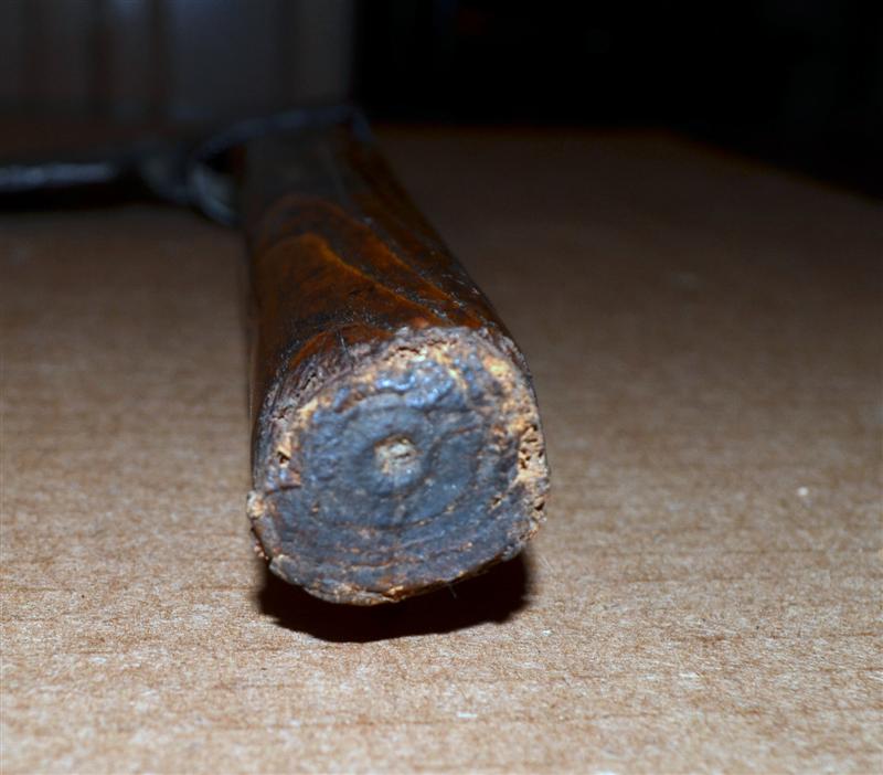

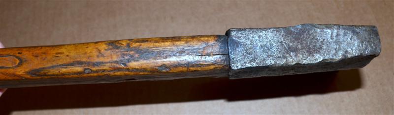

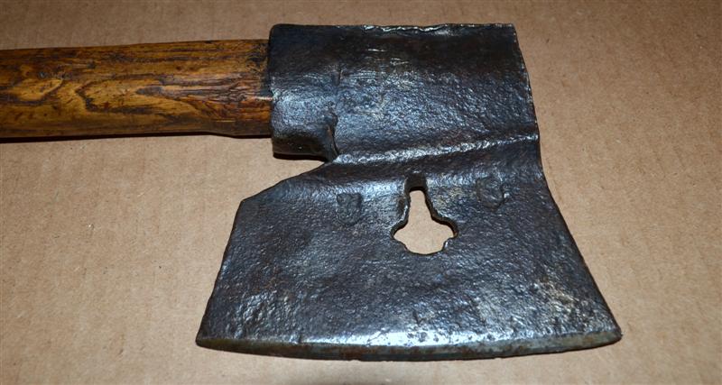

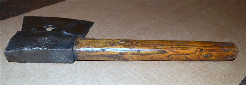

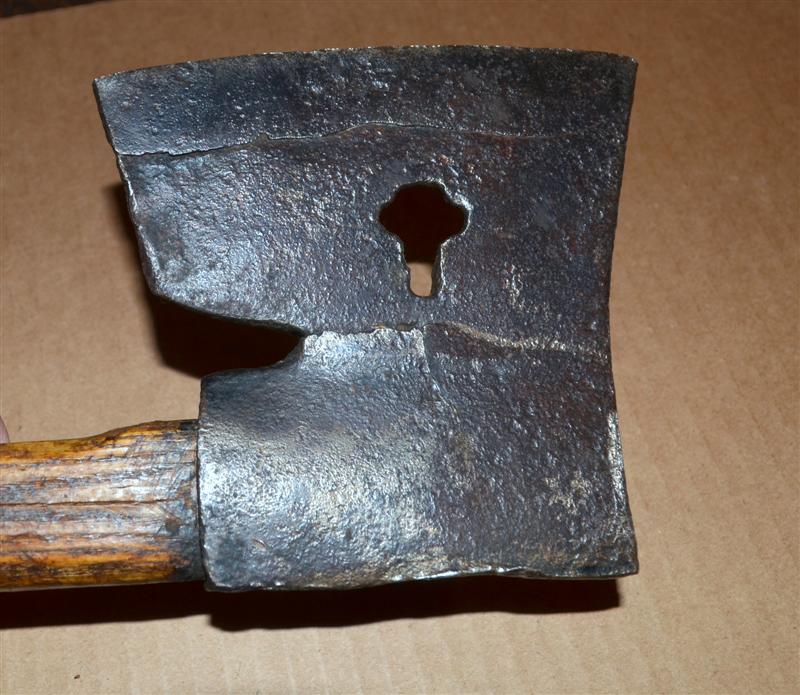

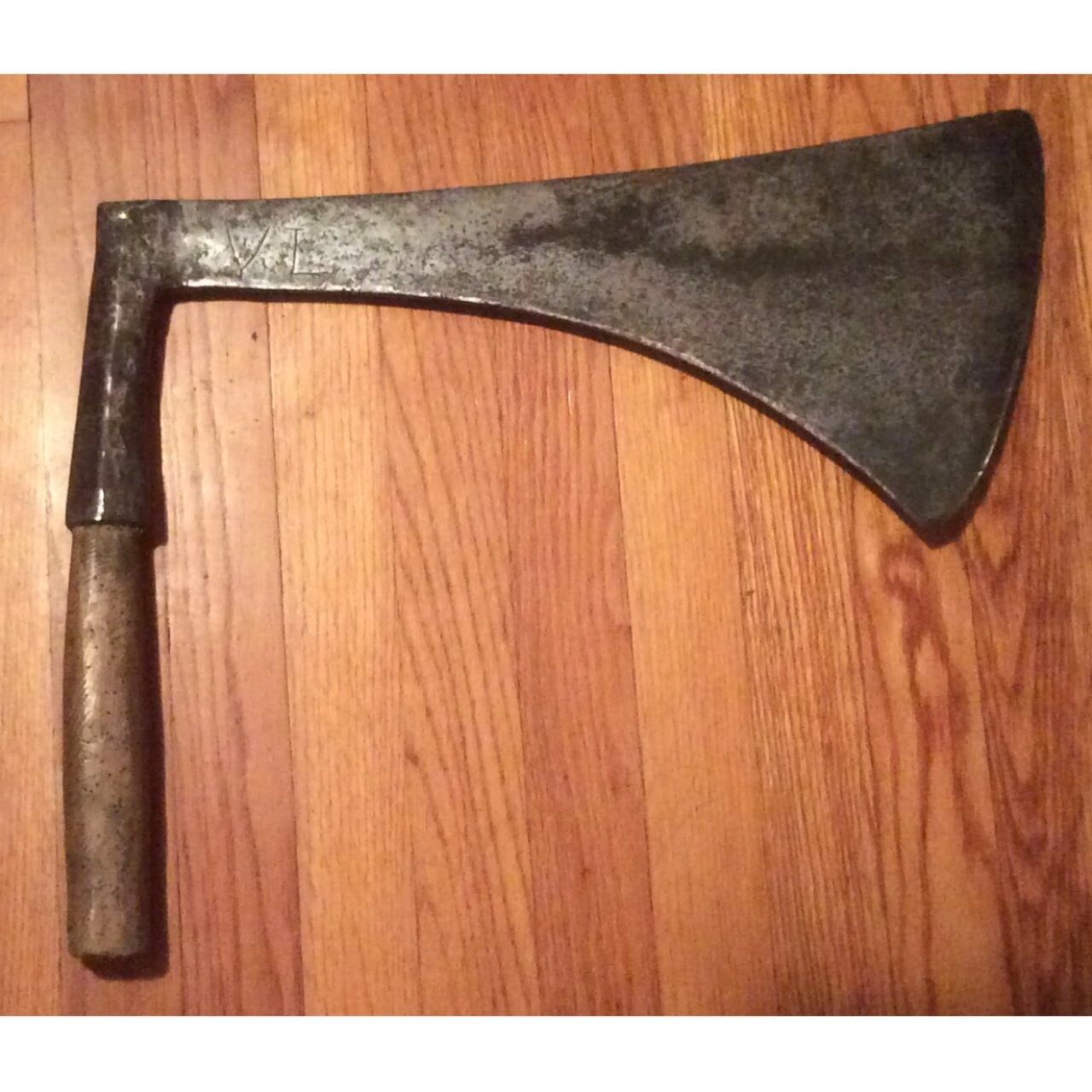

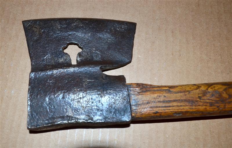

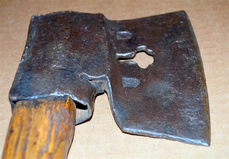

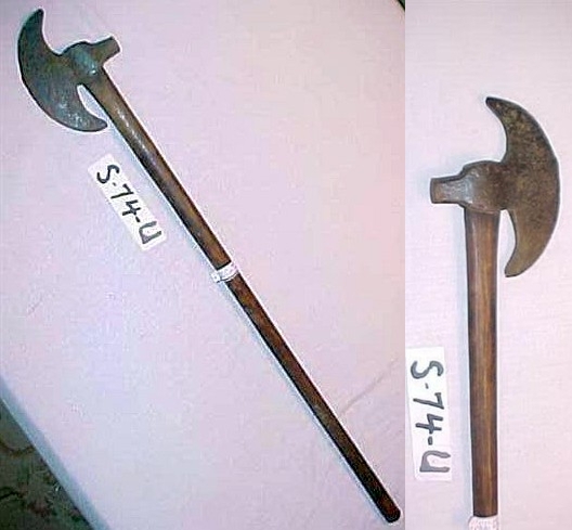

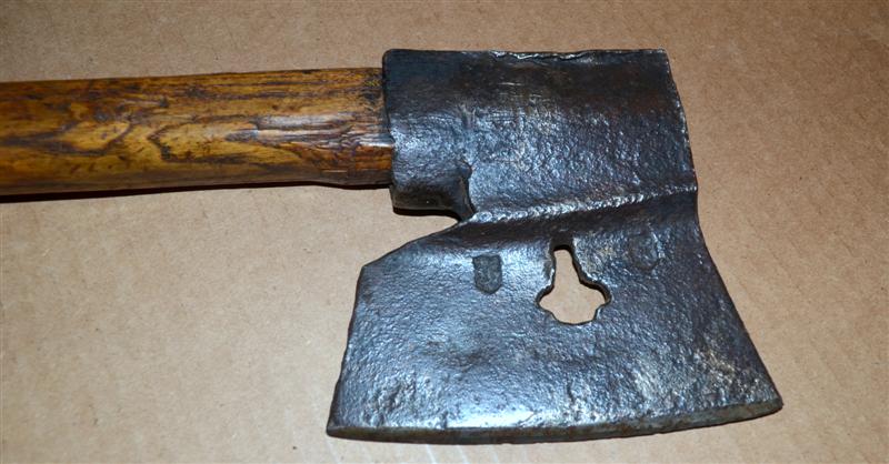

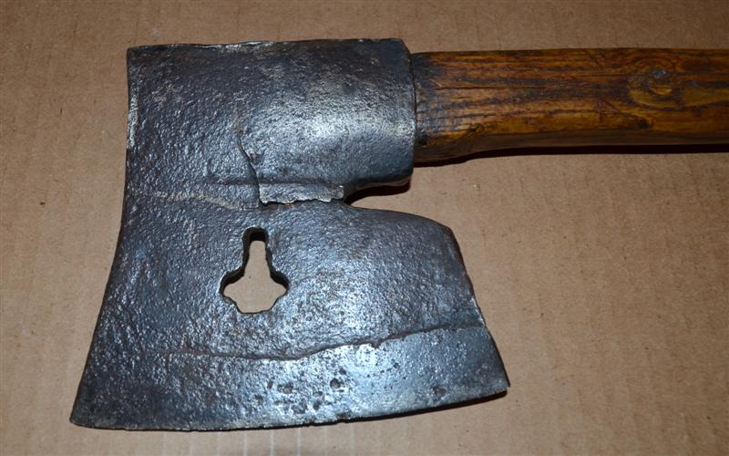

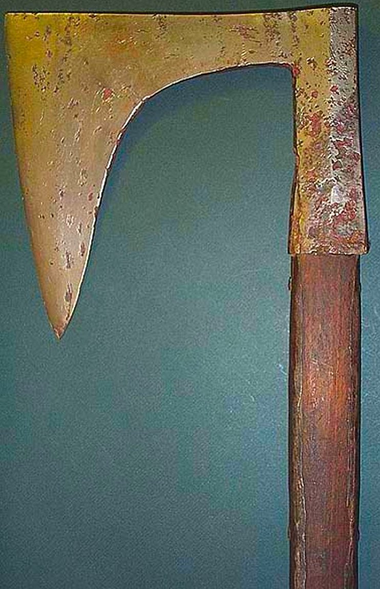

I got this about twenty five years ago in Normandy, in a small town I cannot remember as I was just passing through on a day trip from Paris.
It is inscribed "YL" or "VL", and is a little over 19 inches along the top from the edge to the heel, and is 15 inches from the heel to the butt of the haft, which appears to be oak and full of worm holes.
The haft, or what's left of it, is loose in the socket. It is roughly pentagonal at the socket.
The form appears to be very old, but I am interested in hearing what everyone has to say.
Shakethetrees is offline   Reply With Quote
Old 28th August 2014, 07:18 AM   #20
haft is a tad short for an executioner's axe
(i suspect it was a teeny bit longer in it's working life)
there is a very similar one on ebay at the moment. haftless. marked "AD" on one side, "CP" on the other. sadly we cannot discuss it, so no picture. try googleing images for 'executioners axe'.
here's another. hired him for my quickie divorce. a lot cheaper than going thru the courts as henry the 8th found.
Old 28th August 2014, 11:28 AM   #21
Matchlock
Matchlock's Avatar
Join Date: Sep 2008
Posts: 4,310

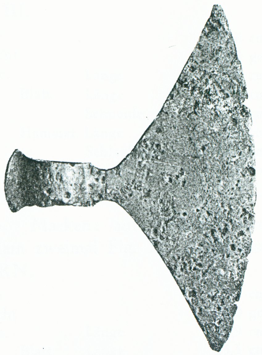

Hi Shakethetress,
You sure shook - no; not just the trees: YOU shook the WOODS, the very moment you spotted and acquired that fine battle axe, manufactured within the (then) borders of the Germanic areas (German: in den deutschen Sprachgebieten) during the High Gothic period, 13th to early 14th century!

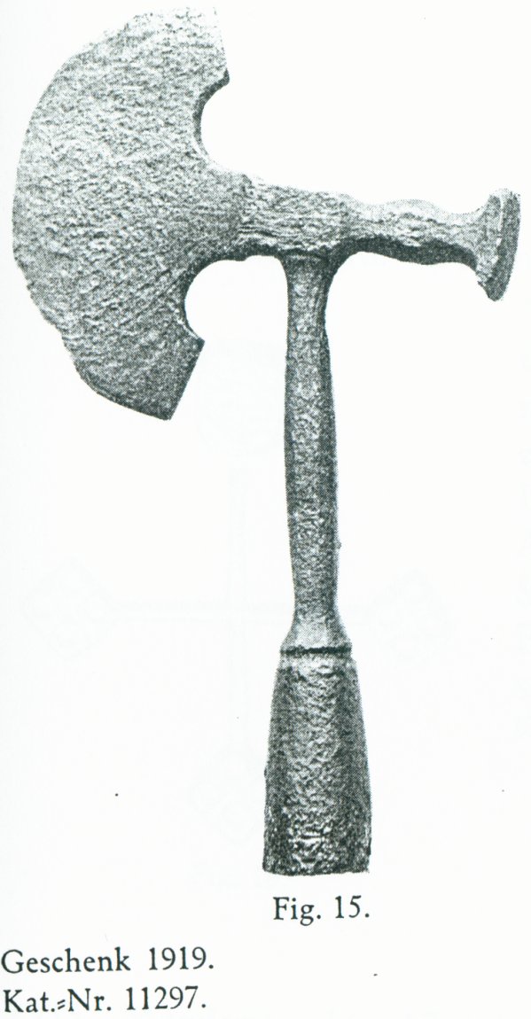

For its Viking stylistic formal predecessor, please cf.
http://en.wikipedia.org/wiki/Battle_axe
(the one on top - see attachment).
This item is of a very rare and elegantly wrought type mostly, and wrongly, just termed a 'beheading axe' in English; it was far more than that, though - both actually and originally. Most of all it. was a battle axe, made for the fight, and meant for the killing - when it all came down, when it was man to man, face to face, axe to ... whatsoever.
CONGRATULATIONS, you made it!
It has been, and will be yours - for decades.

If you feel that what is still left of an originally much longer haft may have been with the head for a very long span of time, leave it as it is, or lengthen it.
The original wood should be either ash or oak, and you should use the very same type.
You can make it whole again.
You can heal it.
You both earned it, the axe and you.
And please do send as good and detailed photos of that item as you can take. If you wish to, just send them privately.
I'm looking forward to seeing them.
I will also search for images of actuallc comparable axe heads but they are very rare to find.
All I can do for the moment being are two attachments concerning one of its typological and stylistic followers, dating to the Latest Gothic period of ca. 1500; that item was sold with Hermann Historica's, Munich, 19 October 2005.
That head, of course, was in a state of excavation, crudely cleaned and overpolished.
Nothing I would never even consider to touch.

I have thought about re-halting this axe for some time, but I have never settled on any particular form.
I've seen dozens of later axes with their hafts that can have a slight downward drop to the pommel, but I think these are later and somehow wouldn't be appropriate. And, I also suspect a lot are replacements.
A lot of old illustrations from later periods are a little vague on this detail.
So, any assistance is appreciated. I will post images once the project has been completed.
I believe the existing wood is maybe 200 years old. It is not secure in the socket, and, while without a doubt it was hand cut, it just looks too fresh to be as old as the head.
Exactly, but it is much too short for a battle axe, or a working man's tool as well.
I guess we realize that it is not the first, original haft; the proportions should, of course, be about equal to the axe that used to be mine - see opening post of this thread, and attachment here.
The length of the original haft of that fine axe was, of course, about equal to the overall length of that item, which was 119.7.cm.
m

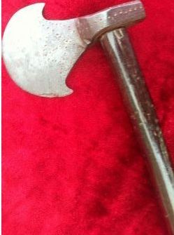

I've had this hatchet for a while: I always thought it was just a wood working ax, mainly because of the "cross," slot in the front, which I thought was for pulling out nails, but I saw a similar provision on some of the pictured battle axes.I also thought that because the back of the hatchet was flat , it couldn't be used for battle, but once again some of the pictured ones were also flat.
Can someone confirm that this is indeed a wood working ax ?

Great information on European weapons as usual. I have had a question about a particular axe since I first saw it, the owner says that it is a "Frankish axe" oak shaft 31.5", axe head 6.5" x 4.75", overall length 33.5", 6 lbs, I have not had much luck finding a similar one, any chance that this is any were near a correct description or even a type of axe that would have been used in battle? Any help would be appreciated.
nope. tho it could be used as such.
many soldiers battle axes were not only used as weapons, but as general tools around the camp. chopping wood, making defences, etc. the flat (or a poll) would be useful for driving in tent stakes, as well as for, as in agincourt, driving angled anti-cavalry stakes in front of archers. some of the designs were purely weapons of course, for the higher ranks i suspect.
soldiers hate carrying stuff they don't need, so why carry a tool axe AND a weapon-only axe if you do not have to. of course if you had a horse, you could have it carry & you'd likely have a groom or squire that would have a more general purpose axe. fixed defences like castles and walled cities also could have armouries with heavier more flamboyant non-tool axes. militia, and/or the levy of cannon fodder poorly trained troops would likely bring the axe or bill hook they used daily at home.
i doubt the cross was used as a nail-puller. more of a decoration.
woodworking axes tended to be well bearded, with enough room behind the beard to allow the hand to be choked up well behind the blade, for finer control. they of course could also be used as weapons.
carpenter's hewing axes can have the blade offset to one side or the other, off centre, chisel ground, to allow for easier squaring of the cuts when making square beams. less likely to be used as a weapon. sometimes even the handles are offset to the head to allow hand clearance when hewing the sides of larger objects while still presenting the edge parallel to the object...
anyhow, yours looks more like a general purpose weapon, an archer's axe or infantryman's. the handle looks a bit short & doesn't quite fit the head. i think it's a later replacement.
first impression is that it looks more like a horseman's axe to me, persia/india. doesn't look frankish (french) to me. could be wrong tho.
are you sure it's 6 lbs. (2.7 kilos) seems a lot.
Hi there,
The haft of that axe is 99 per cent ashwood, as it is, like I said in my opening post, the longest lasting because longest-fibered and consequently most durable, type of wood.
Next to it comes oak.
Experience, though, has taught me over four decades that ash was the preferred sort of wood used for hafted weapons in the Germanic areas, and from the 13th through 17th centuries.
As closely as possible, I have researched what must have been thousands of 13th-17th century hafted weapons, in hundreds of museums and private collections, plus previewings of items with the most important international auction houses, and after taking more than 280,000 analog photos.
Thanks for the reply, I have to take the word of the owner about the weight, I have looked for other "Frankish" axe but can not find one that is verifiable, it does have a little similarity with some Indo-Persian axe I have seen but not enough to call it that in my opinion, I will keep looking.
Old 29th August 2014, 12:10 PM   #30
googleing, found this indo-persian one, 30" haft, reminds me of your posted one...
