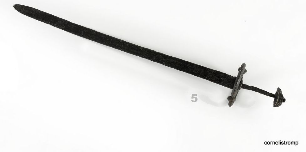

Dear forum members,
I'm currenly researching a sword that was found at an archaeological excavation of the medieval moat of the city of Eindhoven (the Netherlands) in 2007. The sword was returned in juni 2013 after a long restoration. The result is amazing! Because parts of the leather and wood were preserved, this sword is a kind of time capsule.
During my investigation I learned this sword is a Katzbalger, used by the Landsknechts in the 16th century. In this century Eindhoven was attacked several times. The most likely years that this sword was lost is probably 1542/1543, although there were also attacks on the town in 1529 and in the 1580's.
I have several questions about this sword:
- Where was it made? I presume in southern Germany or Switzerland.
- When was it made? The restorers dated it on 1550-1600, Cornelis Tromp from this forum dated it 1525-1550.

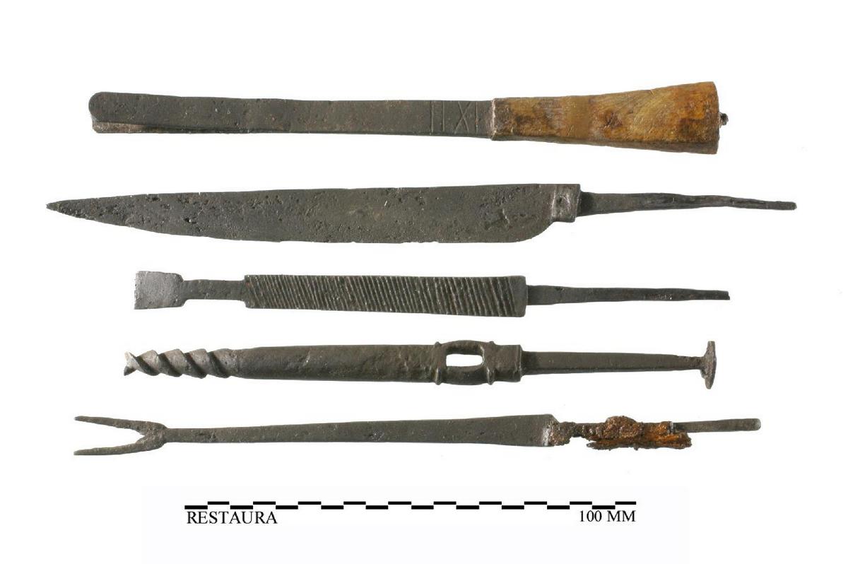

- In the scabbard were several tools found, like a Swiss army knife or a multi-tool. Was this common for this kind of swords of for swords in general?
Thanks in advance for sharing your knowledge on this interesting object!

After restoration

Could we get a close-up of the 5 tools?
I can't speak to to how common it is for Katzbalger swords, but it is not uncommon for tools to be associated. I am more familiar with the phenomenon in knives - occasionally happens in Ottoman Crete, and there's an excellent Persian example at http://www.swordforum.com/forums/sho...d-Persian-kard [see attached photo on, second post] - but I know it occurs elsewhere as well.
The association of a small knife (looking at the second tool of your five) with a sword is relatively common. I know this from later German hunting swords which are often paired with an associated knife, but it may be the case that this is common earlier as well. I do not know enough to comment on 16th century Netherlands.
For later German examples of a sword with small knife, see:
http://www.royalcollection.org.uk/co...d-and-scabbard (knife not pictured, but included in description)
http://www.christies.com/lotfinder/a...b-8816110ecac0 (Auction has ended earlier today, so I think it's okay to post. Someone throw something at me if it isn't.)
There is a Spanish-made example which is 16th century at http://www.royalcollection.org.uk/co...e-and-scabbard
I am not certain of the 4 tools other than the small knife; I would like a better photo to tell what they are. The 4th looks vaguely like a worm for a musket/arquebus, but take that with a grain of salt. Not sure what the two-pronged tool could possibly be in that context, and in any case not willing to commit to calling it a worm without zooming in a bit.

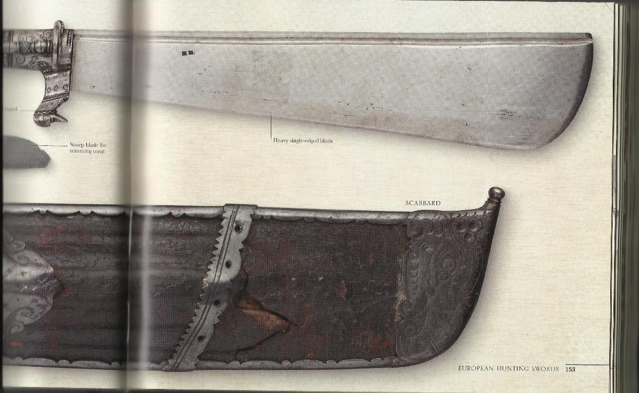

I thought I had seen something similar:
McNab, C. (Editor) (2010). Swords: A Visual History. London, Dorling Kindersley Limited.
Horrid book if you're looking for information, but not a bad place to find examples. Pages 150-154 are useful to you. I'll upload reduced images on here per forum rules, and imgur link to the full res versions of the scans. Apologies for doing it in parts; my scanner isn't large enough to do the entire two page spreads.
Both are German, dated 1662. A bit late for your date range, but the associated toolkit looks very, very similar. Perhaps an earlier occurrence of the same purpose?
Imgur links (should be sufficiently high-res to read what text there is):
http://i.imgur.com/Ha0i5Sz.jpg
http://i.imgur.com/FhSf3cR.jpg
http://i.imgur.com/3FTI5Ib.jpg
http://i.imgur.com/SYJ91cP.jpg

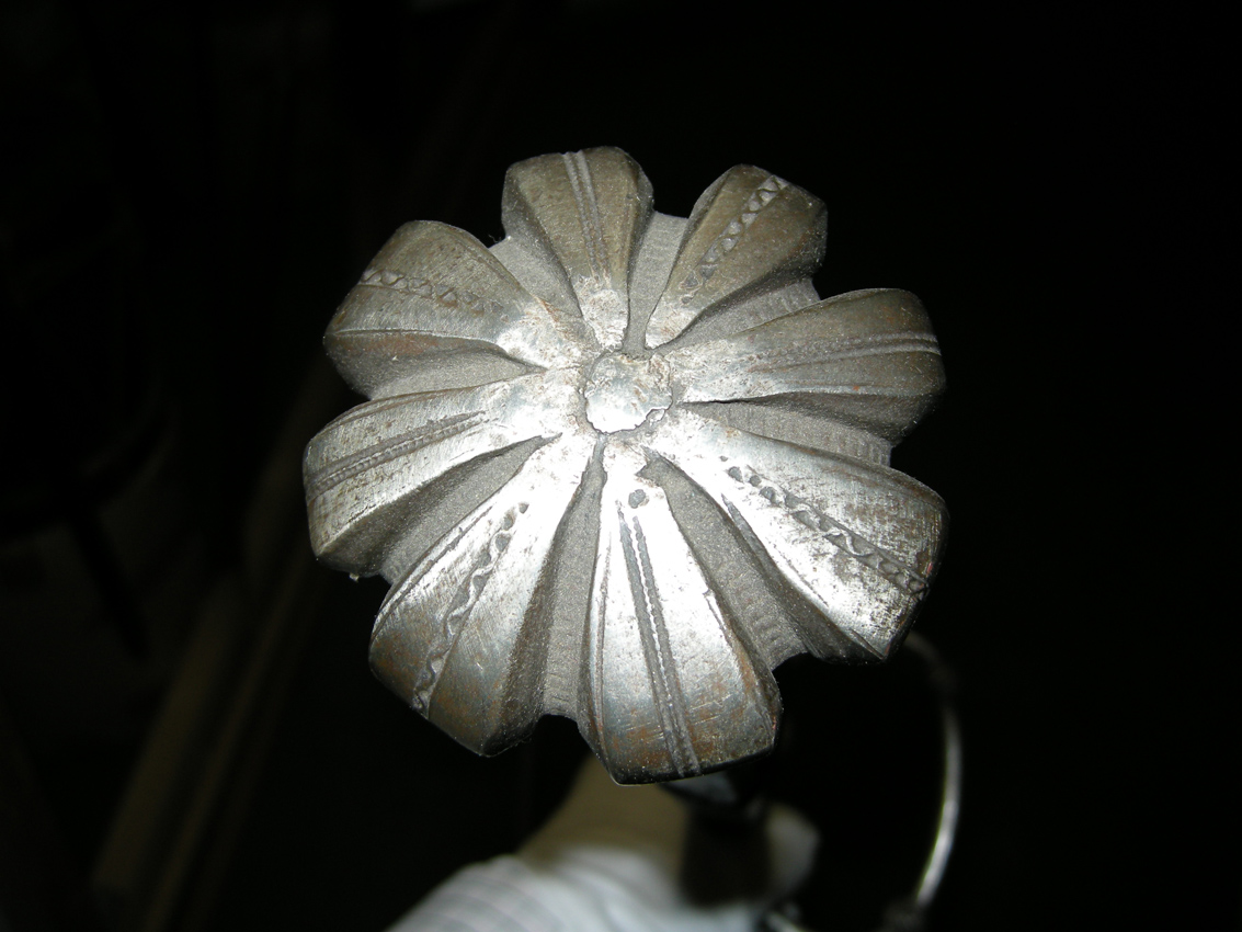

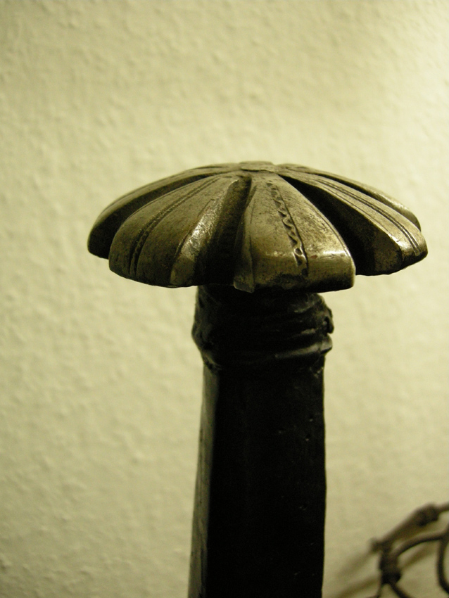

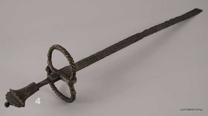

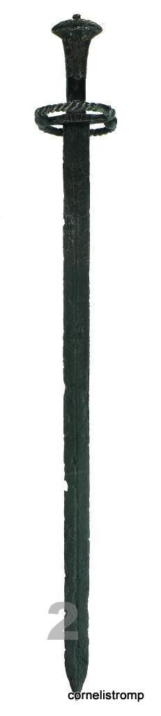

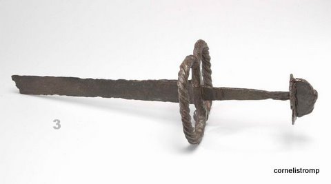

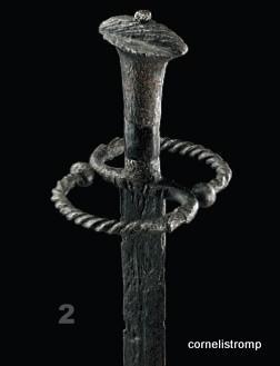

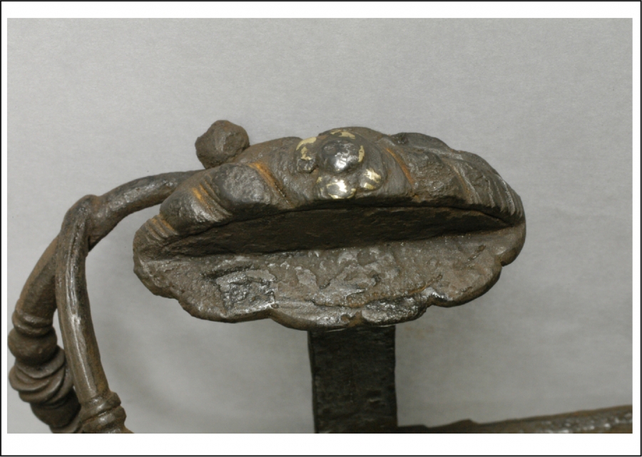

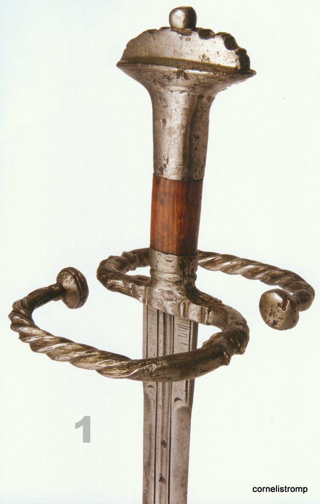

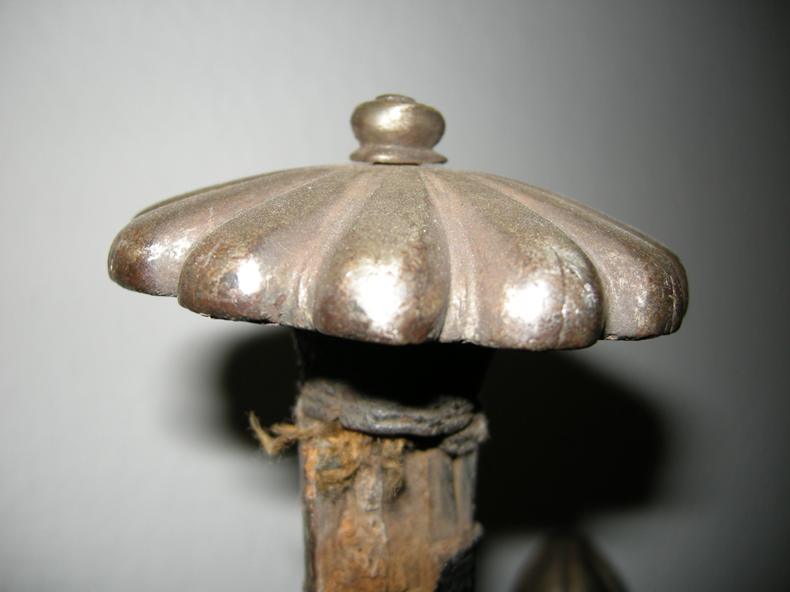

the Katzbalger with comb like the one under discussion is a very rare appearance among the already scarce known group of Katzbalgers.
The ones with a comb that I am aware of, I will enumerate them all, come from Dutch soil, Dutch museums and/or old Dutch collections.
This may be a coincidence, but it may also be that this type has been manufactured. in the Low Countries
the style attribute "comb" also occurs on helmets and body protection in the first half of the 16th century.
The Blade of two of the examples mentioned in this post can be traced to southern Germany;
-the blade of the Katzbalger in the Dutch army museum has crossed flails and bavarian arms, a checked shield struck into the blade of Melchior Diefstetter, a blade smith working in or around Munich in the second quarter of the 16th century (1520-1555). another found in Millingen has the Passau wolf inlaid in the blade.
There was a thriving trade of quality blades in the 16th century, it can be that this type was Katzbalger made or let say composed ​​in the Low Countries with an imported blade.

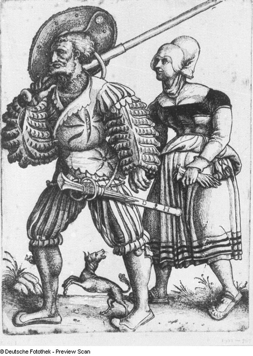

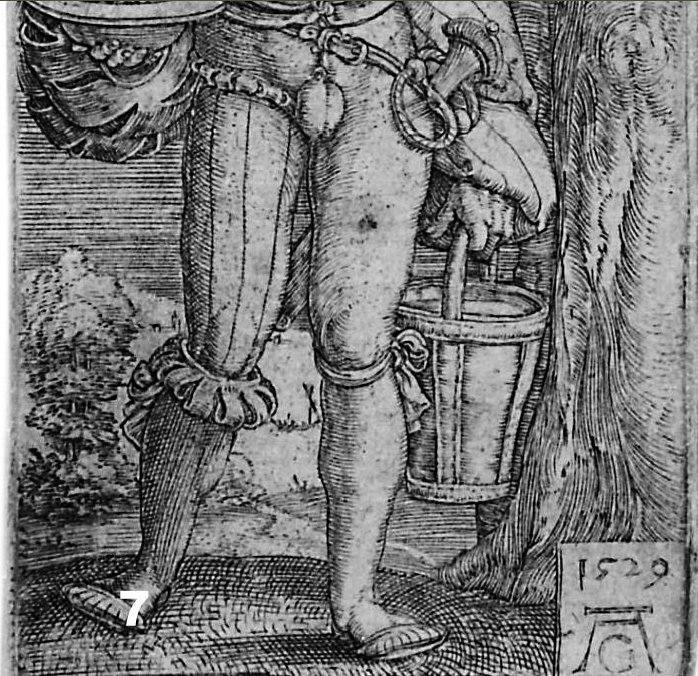

In art, the Katzbalger with comb sporadically appears, a clear example is a drawing made by Heinich Aldegrever and dated 1529.

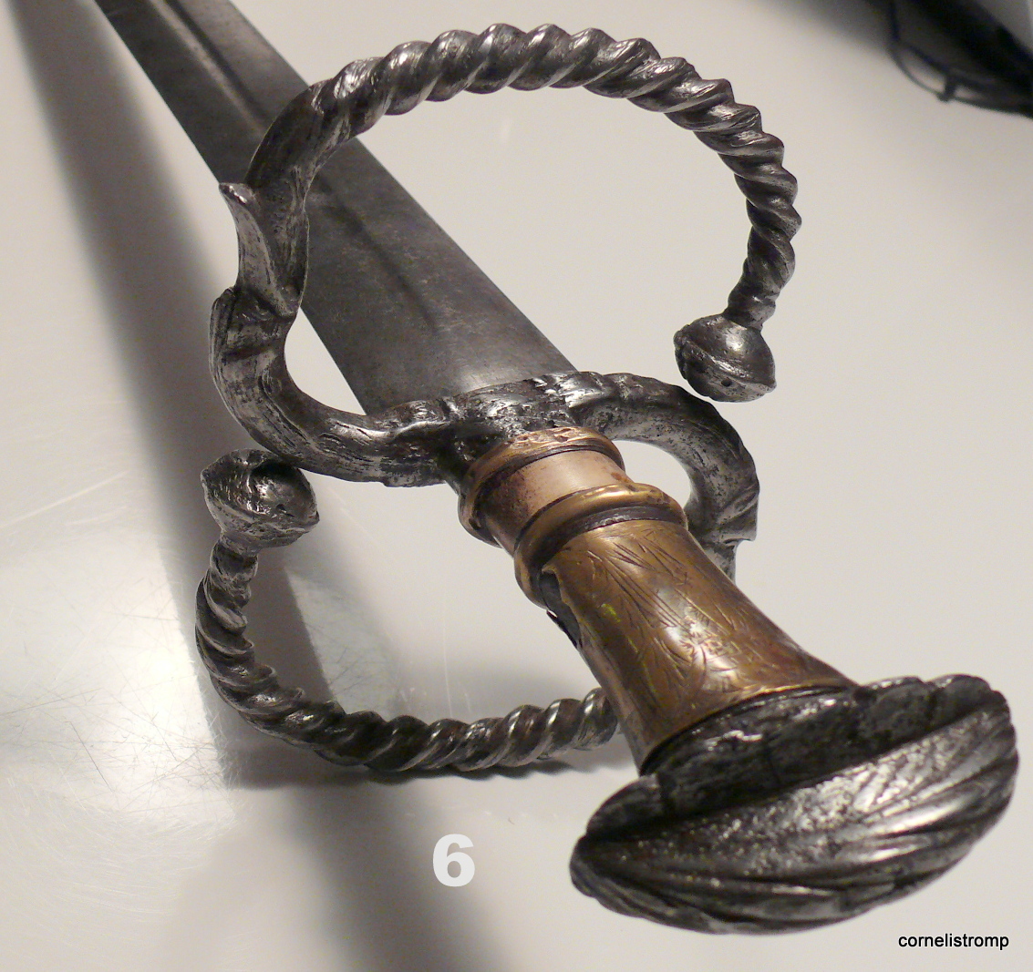

1. Katzbalger legermuseum dated by JP Puype 1520-1550, blade by Melchior Diefstetter.
2. katzbalger, auctioned by Thomas del Mar in 2006 and dated in the second quarter of the 16th century.
3.Katzbalger found in Millingen and published by J.Ypey.
4.Katzbalger found in Rotterdam
5.katzbalger probably found in zeeland
6.Katzbalger in private collection, published by J.Ypey.
7. drawing By Heinrich Aldegrever.
best,
Jasper

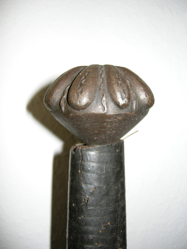

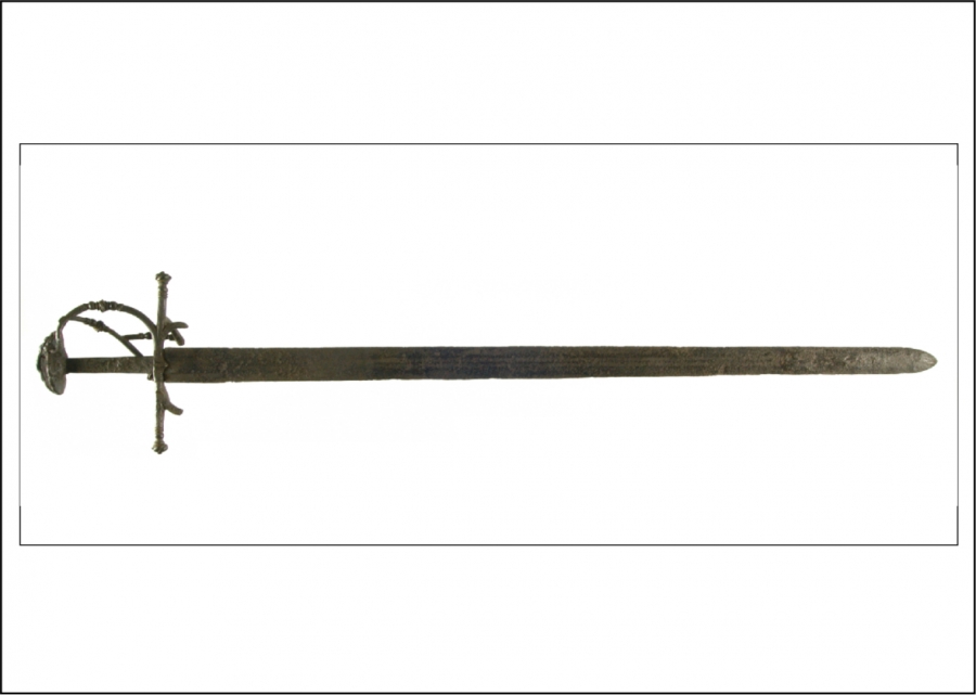

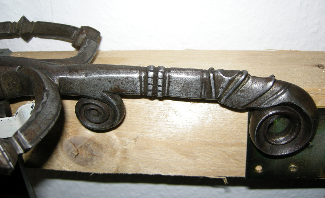

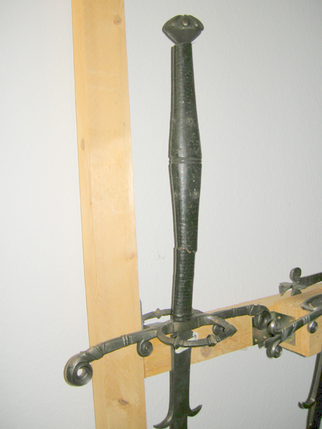

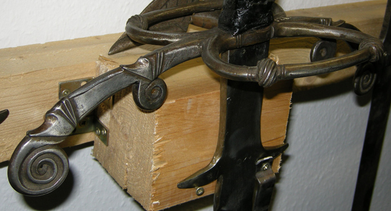

I would like to add another landknechtsword with comb pommel, it is a composite sword cq. ex. Katzbalger found in 2012 in Oirschot/Netherlands.
the pommel and blade are belonging to a early (first half of 16thC) Katzbalger as the examples shown in this thread.
but the parry guard is of a later date (mid 16thC) and has been added later and adapted to the new sword function.The upper bracket and pas d'ane are broken off.
it looks like a developed Katzbalger without the 8 shaped guard.
very interesting is that it probably has been done in the 16thC.
also note the serrated edge of the pommel that can be seen even at some landsknecht dagger guards. fe http://www.vikingsword.com/vb/showthread.php?t=15420
best,

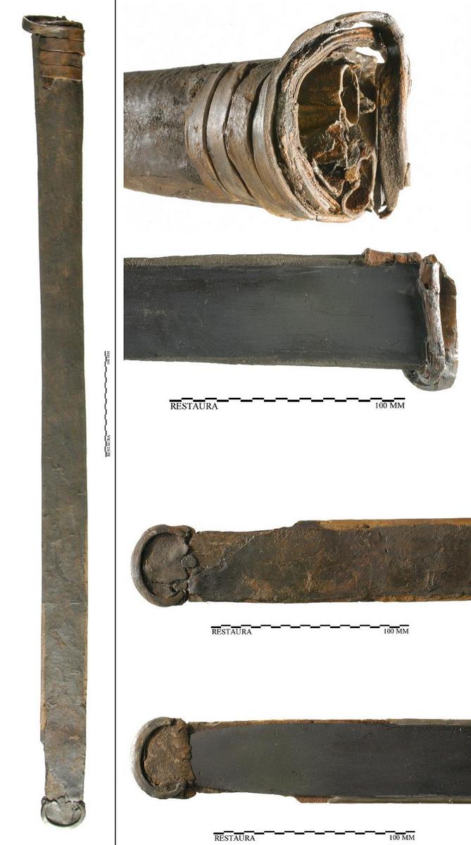

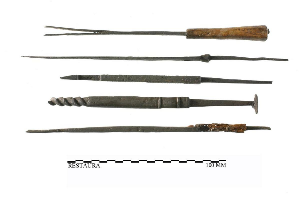

herewith a close up of the tools.
best,

Here we have are another superb example of 16th c. combination tools:
the one on top acted as a scourer for the barrel of an arquebus (which of course makes this the Katzbalger of a Doppelsöldner!), one is combined with a screwdriver, another is threaded for acting as a corkscrew ..
Michael

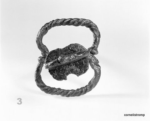

Posts: 1,071

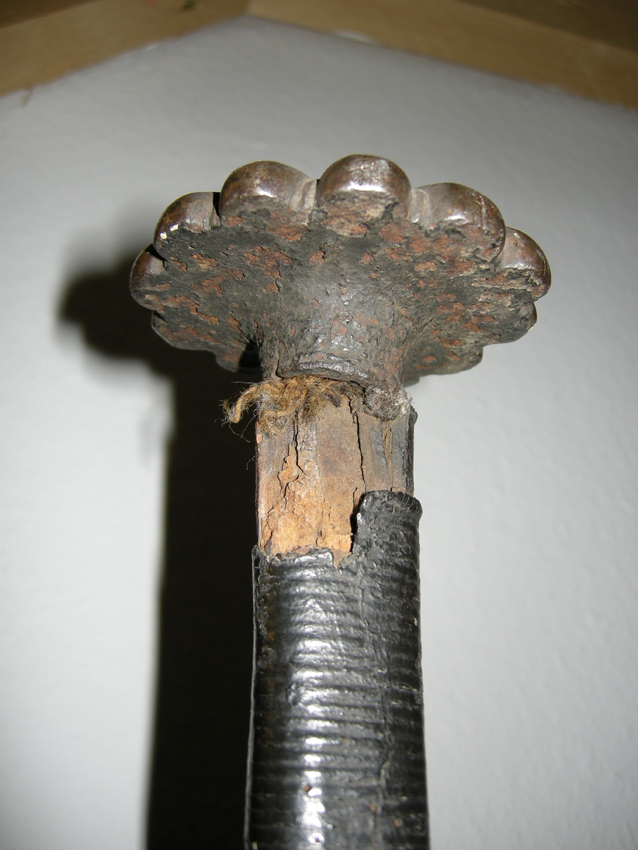

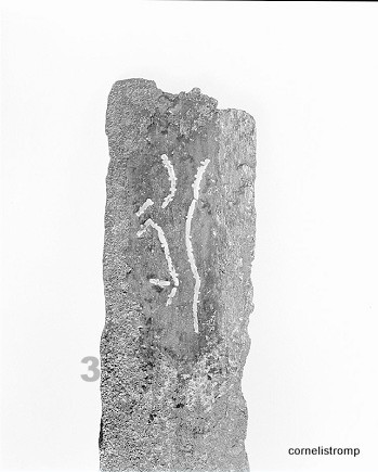

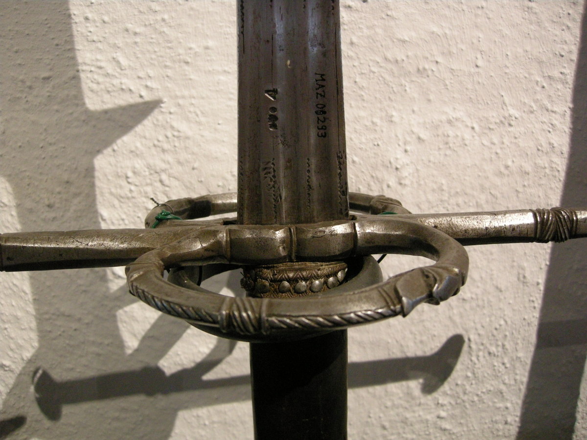

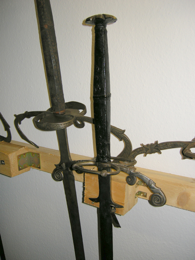

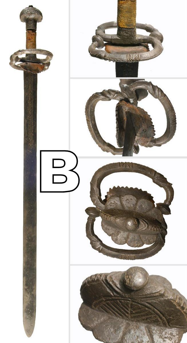

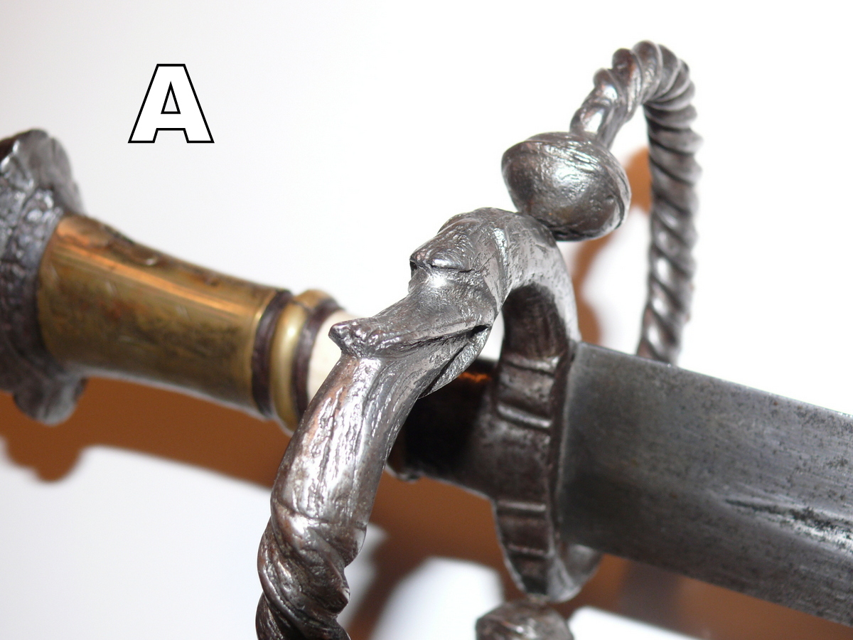

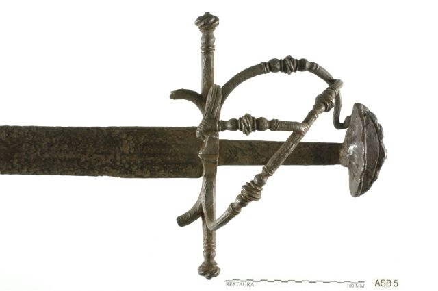

while studying various katzbalgers in museums and private collections , I found that this interesting weapon was subject to fashion of the time.
I will not list all features here, only those features that are relevant to the dating of the excavated Katzbalger in # 1 .

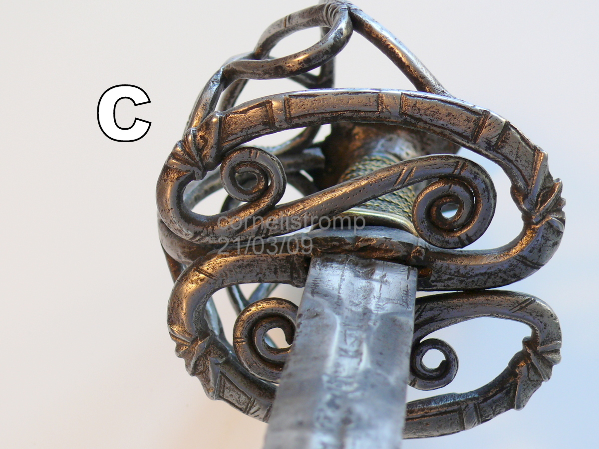

early katzbalgers often have a twisted eight shaped guard , round in cross section , and when there are mythical creatures chiselled in the guard are these larger and recognizably realistic in appearance , 1 mythical creature per guardarm, 2 per sword . see the Example A datable around 1525.
in later often developed Katzbalger hilts around the mid of the 16tthc , the twisted guard gradually disappears and is replaced by a guard which is triangular or rhomboid in cross section , the mythical creatures have become very stylistical and less recognizable and there are often 2 animalheads per arm , so 4 per sword .
if you look at the guard of Katzbalger of post1 , see picture B , you can see that this guard is of a later type; triangular in cross-section with four stylistically carved mythical creatures .

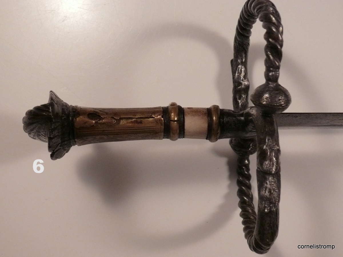

A fully developed Katzbalger in my collection ,picture C datable around 1550, has a guard which is quite similar in terms of style .
A guard triangular in cross-section and with 4 similar stylistic mythical creatures chiselled in the guard.
the Katzbalger of #1 is found at the main gate/old entrance of Eindhoven.
Three events can be mentioned in which the katzbalger may have ended in the canal in front of the city entrance.
1. In 1528, a major blow against the Gelderlanders was delivered at Eindhoven , they were being driven back.
2. In 1543 Maarten van Rossum took the city of Eindhoven with an Army of 15000 men, plundered it and took the castle Cranendonck.
3. in the early 16thC most cities in the Netherlands had restrictive municipal ordinances, it was not possible to get into the city with swords and daggers above a certain blade length.
at cannels in front of old city gates swords and daggers can still be found, they were likely thrown in by the city guard after inspection.
So many ballock daggers and some swords have been recently found in the cannels of Haarlem that treasure hunting is now prohibited there.
it's hard to tell where the Katzbalger has been made.
because Katzbalger with comb pommel is found primarily in the Netherlands, an assumption that it is a Dutch weapon with probably a german imported blade, is to justify

you are welcome, I expected it to be the tools of an arquebusier
does a doppelsoeldner not mean that some landsknechts were fighting at both sides ?

Attached please find early-16th c. egravings.
The caption to the first image says Doppeldöldner.
In attachment #3 you can clearly identify the bodkins in the Katzbalger sheath.
Michael

yes you are right, these were the mercenaries with multiple weaponskills, deployed in the front line, and were paid double for this increased risk.
moreover, the scabbard construction of your image 3 in post 19, with the wrapped leather strap has great similarities with the Katzbalger found. see picture collection.
further, it is remarkable how much organic matter there has been preserved at this find.

2 pictures of landsknechts with tools attached to the Katzbalger scabberd.
it looks like that 5-9 different combination tools were worn more often by mercenaries.
Indeed, the predecessor of the swiss army knife.
best,

here are detailed photos of beautiful landsknecht two handers, with the stylistic characteristic mythical creatures to see on katzbalger guards.
around the mid of the 16th century these mythical creatures are more abstract.
Also note the pommels of the two swords they also came on katzbalgers.
Pictures © Carl Koppeschaar , thanks Carl

I forgot the close ups of the lovely landsknecht pommels of the above posted 2 handers.
especially the star-shaped pommels are great looking and impressive
here they are!

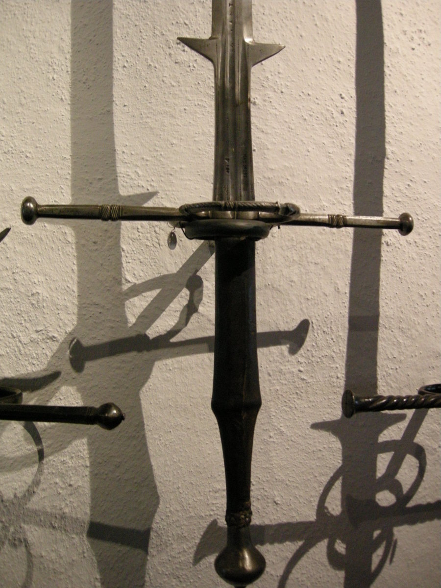

a landsknecht two hand sword from the armory of Solothurn, Switzerland.
see the similarity in the style of the guard with the Katzbalger found.
The mythical creature here is still very realistic in shape, even de eyes are visible, suggesting an earlier date from 1520 to 1530.
the Katzbalger under discussion has stylistically shaped mythical creatures spitting the guard from the mouth.
best,
jasper
© Carl Koppeschaar
