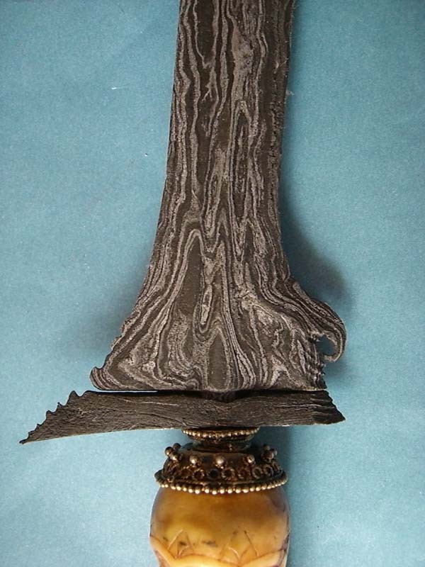

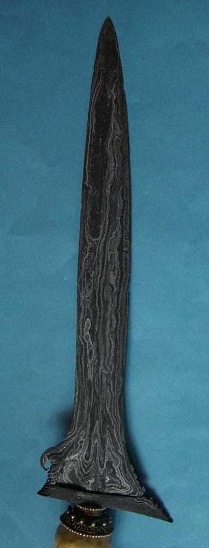

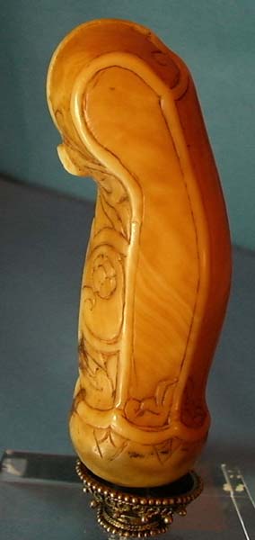

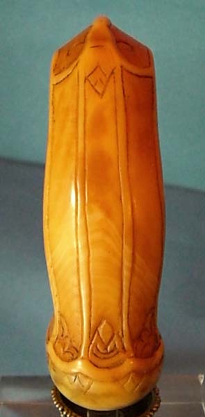

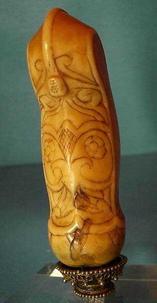

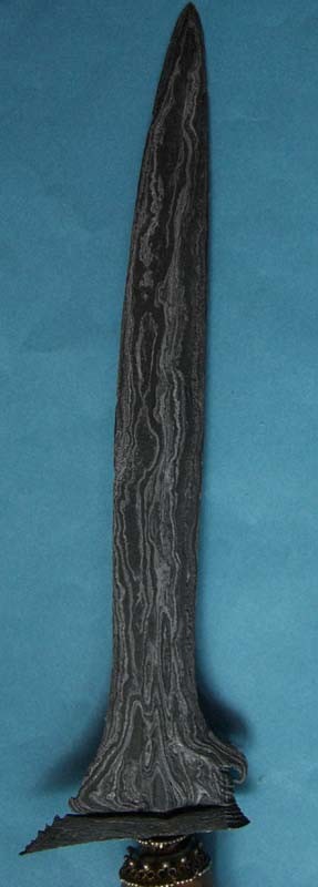

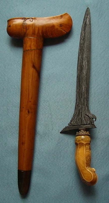

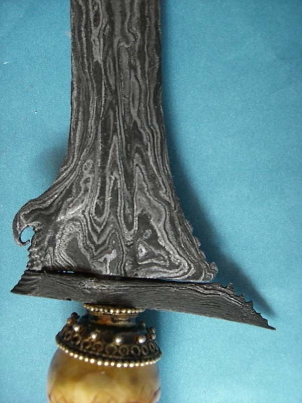

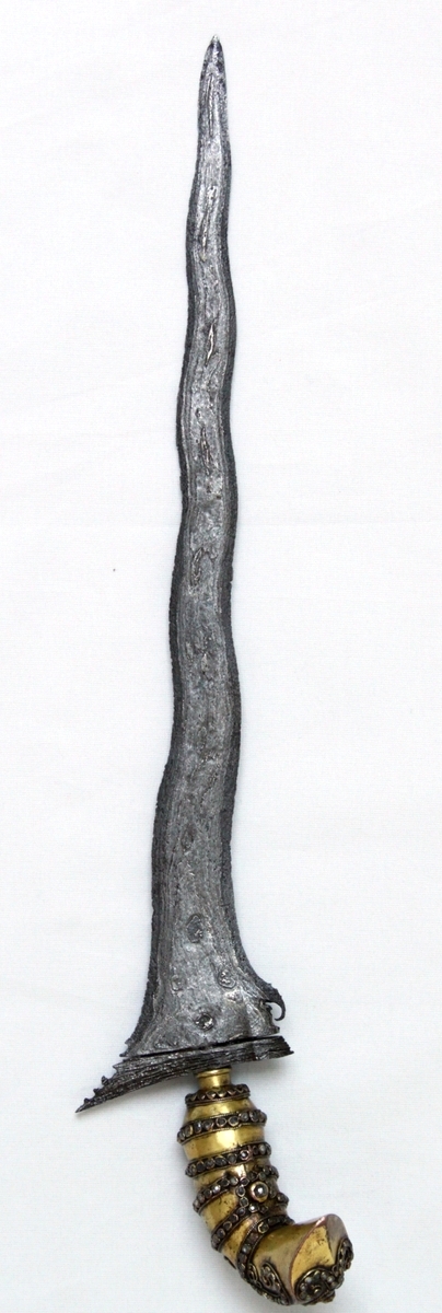

I get offered this keris and want to ask you if you agree that this keris is maybe a Banjarmasin keris. I am allowed to show the pictures here. Handle is maritime ivory and very well patinated.

Posts: 171
Very nice hilt, Detlef, albeit the carving was rather crude!

Old 11th June 2013, 08:12 PM   #3

Hello Moshah,
nice to have you back here! Thank you for comment. Yes, the carving is crude and not very deep. I don't know if there are members who have a deep knowledge abaut Banjar kerises. Many will have seen pictures from kerises described as Banjarmasin but I doubt there is someone with a really deep knowledge.

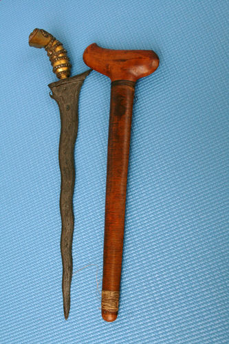

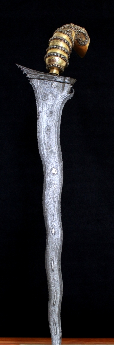

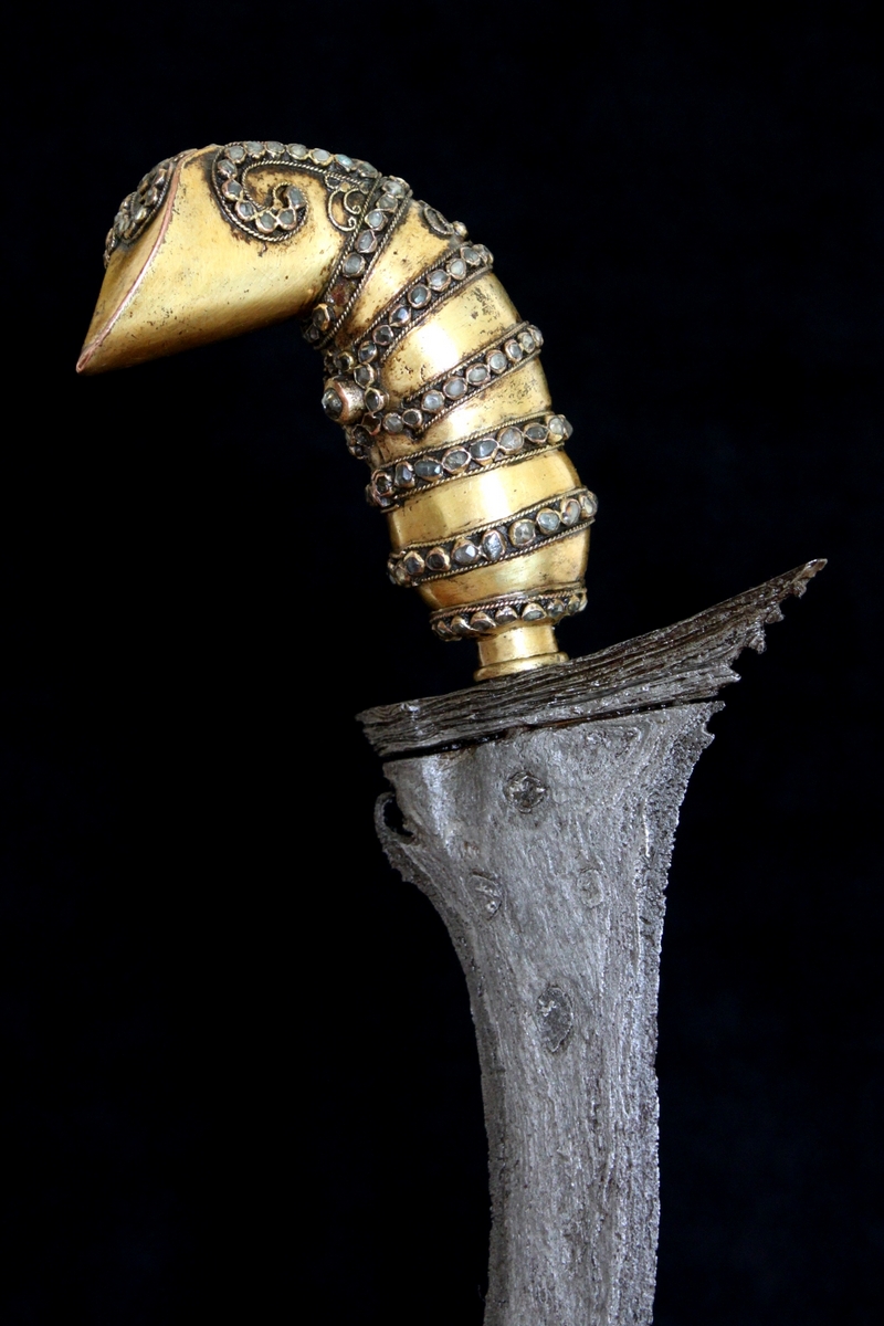

Old 11th June 2013, 08:45 PM   #4
Jean
Join Date: Jun 2009
Posts: 1,740

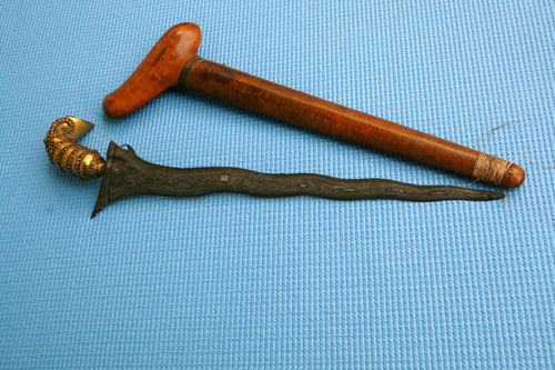

I just won this piece on Ebay (sorry for the poor pictures) which at least has a genuine hilt & typical gayaman sheath from Banjar

very nice keris, can you post bigger pictures from the blade? My first impression is that the blade have a strong Palembang touch.
Old 12th June 2013, 07:19 AM   #6
Congrats, Jean!
I believe your piece does deserve a seperate thread with larger pics once you receive it.
Old 12th June 2013, 07:57 AM   #7
Hello Detlef,
In the keris you inquire about I don't see any feature that IMVHO clearly points to a Banjar origin; the hilt doesn't look like Solo, Yogya, nor Madura craftmanship to me either. Banjar carving work tends to be very neat, especially floral or geometric design elements found with (non-figural) wooden hilts. I agree that this hilt seems to be old and exhibits some genuine wear; it's certainly desirable and warrants further research. I'd hesitate to associate it with the buzzing economical hub and international melting pot of the Banjar/Negara area and would tend to look for more of a backwater in those days as a possible origin.

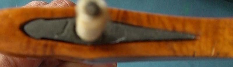

This seems to be a kinda odd ensemble: How well does the blade fit into the scabbard? Any close-ups of the base of the blade as well as of the mendak? I hope our members specializing in Java/Madura will also chime in...

Old 12th June 2013, 11:35 AM   #9
Marcokeris
Marcokeris's Avatar
Location: Italy
Posts: 928
I dont' know about the blade but i think the hilt is not from kalimantan. It seems made for dress a selut (jogja or solo). I never seen ( of course in my personal experience) a banjarmasin hilt with a javanise selut. Imo maybe this hilt hade a lost selut that married well the mendak of the pic
Old 12th June 2013, 12:12 PM   #10
Hello Marco,
It's based on the style of hilt intended for a selut. However, I don't think it was ever meant to be fitted with such a mendak+selut combo: There is decorative carving below the waved line that a suitable selut would cover. Thus, I believe it's an outsider's adaption of the central Jawa (Solo) style.
Old 12th June 2013, 01:16 PM   #11
Marcokeris
Marcokeris's Avatar
Location: Italy
Posts: 928
You are right Kai . I agree
Old 12th June 2013, 01:25 PM   #12
Marcokeris
Marcokeris's Avatar
Location: Italy
Posts: 928
Strange is the oval base of the hilt ...created not for the mendak of the pic. It would be right for a ring as Bali or Lombok ring but ( i have looked some of my banjarmasin hilts just now)...also for the little selut of banjarmasin wood -gold leaf hilts. So i am more confused than before :-p
Old 12th June 2013, 06:13 PM   #13
Posts: 9,708
Originally Posted by kai
Hello Detlef,
Hello Kai,
this was the reason why I post it. But it seems that the blade, scabbard and hilt belong together but wouldn't be surprised when the mendak is a later addition. This keris is a real puzzle for me.
Here some additional pictures.
Old 13th June 2013, 09:15 AM   #14
Jean
Join Date: Jun 2009
Posts: 1,740

And regarding the ivory hilt shown by Detlef, I never saw a similar piece but would posibly attribute it to East Java with a specific local style.
Hello Jean,
you could be right by your guess. How longer I look to this hilt I get the same feeling. Any guess about the blade?

Originally Posted by Sajen
Hello Jean,
Hello Detlef,
Frankly I have no clear idea about the blade as well and was expecting Alan to comment on it. It has some very specific features such as the shape (short and wide), the thick and protruding kembang kacang, the peculiar lambe ganjah and grooves on the front of the ganja (a bit similar to Balinese blades). It seems to have some age from the worn greneng and gap between the blade and ganja. Because the hilt has some balinese influence, I would guess East Java Hindu area (Banyuwangi) but it is just an unsupported impression.
Anyway I find this mysterious kris very interesting! The engravings on the warangka are unusual also, the horn buntut looks Sumatrese but it could be a more recent repair.
Old 13th June 2013, 08:44 PM   #17
Posts: 9,708
Originally Posted by Jean
Hello Detlef,
Hello Jean,
thank you for your thoughts about this keris. My friend who offered this keris has had similar thoughts about this keris but we both are very unsure about the origin. All parts, scabbard, blade and as well the hilt are very unusual IMHO. The engravings at the warangka and the horn buntut are the reasons which let me think that it could be Banjarmasin.
I also have the hope that Alan will share his thoughts about the blade.
Old 13th June 2013, 11:29 PM   #18
Posts: 7,200
Probably the vast bulk of keris have been made according to established patterns:- patterns that follow the lead of either a tradition of a ruling house or of a group of people.
But sometimes a keris will be produced by a person, or in a place , where there is no established lead from either tradition or ruling house. When this happens, guidance is lacking.
The first keris that I made was certainly recognisable as a keris, but nobody could ever guess where it was produced, because although I knew very well what a keris looked like, I had not been taught the necessary elements of structure that would permit me to produce a keris that had some relationship with other keris . My first keris lacked a foundation. The same is true of every attempt at the making of a keris by any person who has not had the tuition of an established maker, and who is working outside a community with a keris tradition.
In my personal collection I have several similar keris. Keris that have been produced by somebody who had no tradition to draw upon. The makers had seen a keris, and they produced something that was keris-like, but it did not conform to a tradition.
Possibly what we are looking at here has a similar history:- a keris produced outside any recognisable tradition. Look at the individual elements:- a straight gonjo that is almost nguceng mati, but not Tuban, additionally the material seems not to be the same as the iron in the blade, and a different hand cut the attempt at a greneng than cut the greneng features in the blade; the kembang kacang looks a bit like nggelung wayang but doesn't quite make it; the proportions are not in conformity with anything I can recognise; it has pamor, but the maker had no idea at all of how to manage pamor.
So --- did this maker have any guidance or tradition to draw upon?
I doubt it.
The wrongko looks like a mixture of different elements. Since one of the functions of a wrongko is to provide an item of dress that conforms to dress in its particular area, and since this wrongko does not conform to any dress standard that I have seen, I'm only prepared to agree that yes, it is a wrongko.
Similar story with the hilt. It mimics some elements that appear in Central Javanese hilts, but all that additional ornamentation is not a part of anything I know.
Overall, this looks like a Javanese keris to my eye, but not of a Javanese tradition. I'd be inclined to classify the whole thing as folk art:- a collaboration between somebody who wanted or needed a keris and the village smith. Lots of little isolated villages in Central Jawa, even now. What would it have been like 100 or so years ago?
Actually, I rather like these keris that don't follow a tradition. They possibly get closer to the feeling of the people than any elite art work adorned with gold ever has any hope of doing.
The mendak is North Coast/Madura.
One question:- is the gandar from a single piece of wood, or is it from two pieces of wood that have been joined?
Old 15th June 2013, 02:58 PM   #19
Posts: 9,708
Thank you Alan for your thoughts about this keris, very helpful.
The gandar is built up from two pieces.
Thanks again and best regards,

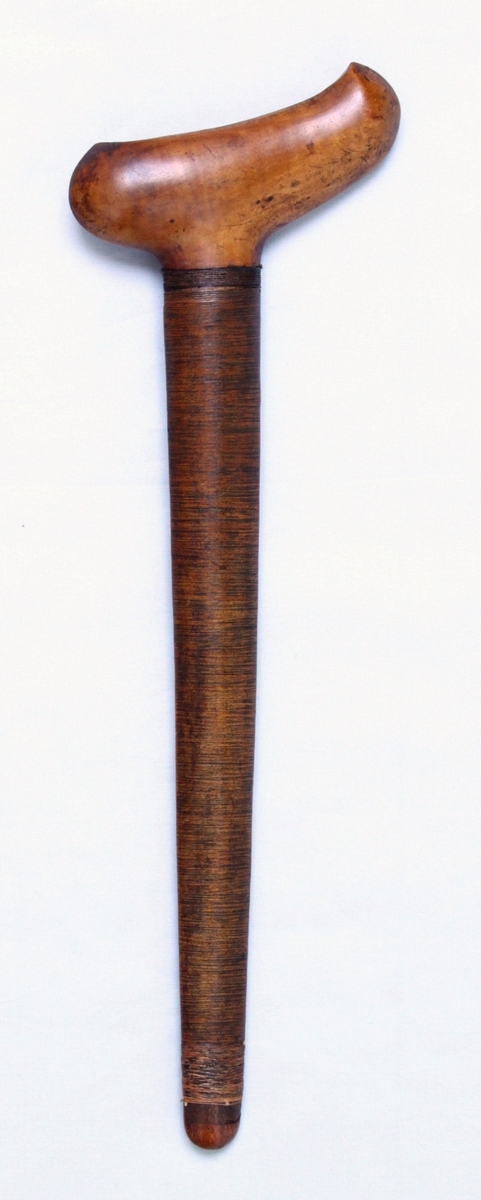

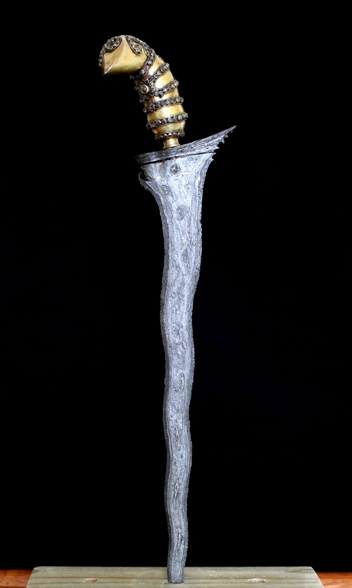

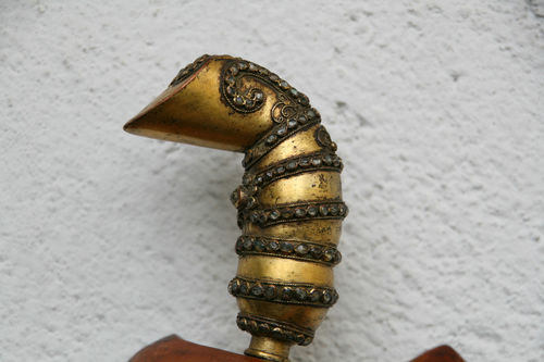

Old 4th July 2013, 09:31 AM   #20
Jean
Join Date: Jun 2009
Posts: 1,740

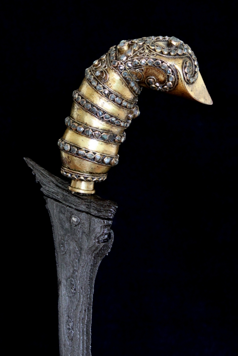

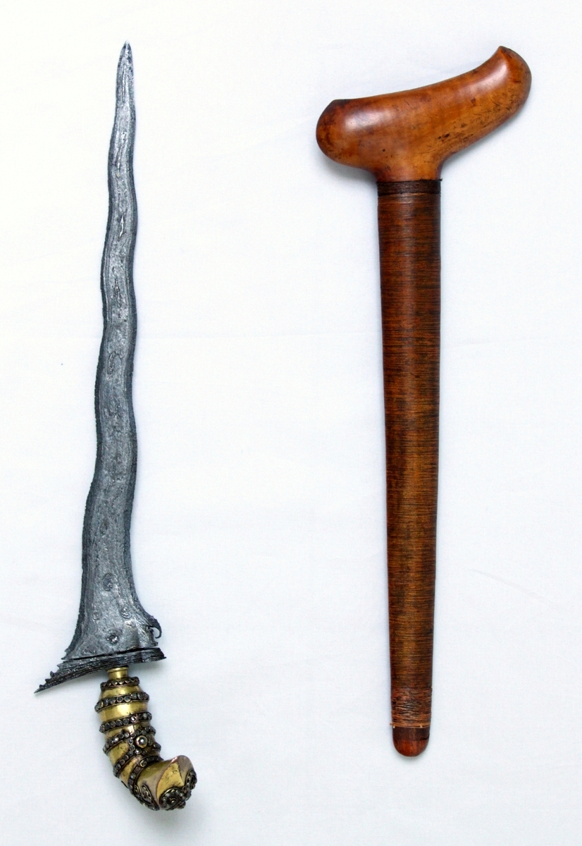

As promised I attach the pictures of my recently acquired Banjarmasin kris with the following comments for discussion:
The blade has a rough surface and it does not seem to be Javanese nor Buginese; a specific feature is the presence of small dots of pamor (tambal) regularly spaced along the blade. This is also found on another kris from Banjarmasin shown to me by another collector, does it mean that this style of blade is indigenous to Banjarmasin?
The hilt in Sumatra style is made from gilt brass and in excellent condition, the selut and virtually all the intens are still present.
The gayaman sheath is typical of Banjar, the gandar in 2 pieces is fully covered with very fine cotton thread which was replaced on the top part and a bit damaged at the tip but I will leave it in this condition.

Thanks David and Marco, this was a rare opportunity which I was pursuing since many years and I was surprised to be the only bidder on Ebay!
Old 5th July 2013, 08:59 AM   #24
Oh my, a lot of folks must have been sleeping - I for one certainly did!
Congrats, Jean, that's an outstanding nominee for the bargain of the year...
Maybe we can put this piece in a seperate thread? David, can you lend a helping hand with some mod magic?
The maintenance of the blade looks kinda (generic) Bugis style to me.
I can't read the blade well enough (and it probably never was intended to conform to kraton quality standards of central Jawa); I wouldn't exclude an East Java/Madura origin though.
Jean, could you please also post a pic of the other side of the blade (in standard upright posture)?
Considering the huge amount of firearms as well as blades (multiple types!) of local Banjar/Negara production, there must have been some keris bladesmithing as well. I have not found any references on immigrated prominent empu or pande keris. Obviously, there were a lot of local talents (Dayak) available as well as a very strong Chinese community. For early grafting of specialized knowledge on keris blades, the Javanese North coast, Madura and East Jawa would be the most likely contenders. Later on, there was enough Bugis and Malay/Sumatran influence to also suspect exchange of skills or craftsmen.
I also have seen keris Banjar with similar pamor; will try to look for pics. Can you ask your friend to post his as well, please? For the time being, I'd agree that this pamor seems to have been en vogue. I don't think this feature is unique enough to claim this must be of local production though.
While apparently based on Sumatran/Malay hilts, this evolved into a distinct Banjar style. I'd call it Banjar Garuda style if you want to differentiate it from the Banjar planar hilt (Jawa origin) and Banjar pangulu (Bugis origin).
Yes, agreed.
Old 5th July 2013, 01:12 PM   #25
Jean
Join Date: Jun 2009
Posts: 1,740
Hello Kai,
Thank you for your kind and detailed comments;
Regarding the blade, I showed it from both sides actually and can't do better because the hilt is stuck on the peksi. May be later I will try to free it but I feel concerned about damaging the intens.
I will check with my friend if I can show the other blade with a very similar pamor but it seems to be part of a commercial site (please check your PM box).
I agree that the blade has some Bugis influence but the ganja and kembang kacang are not very typical of Bugis blades and this tambal pamor dots are unusual.
Best regards
Jean
