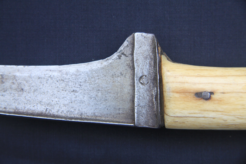

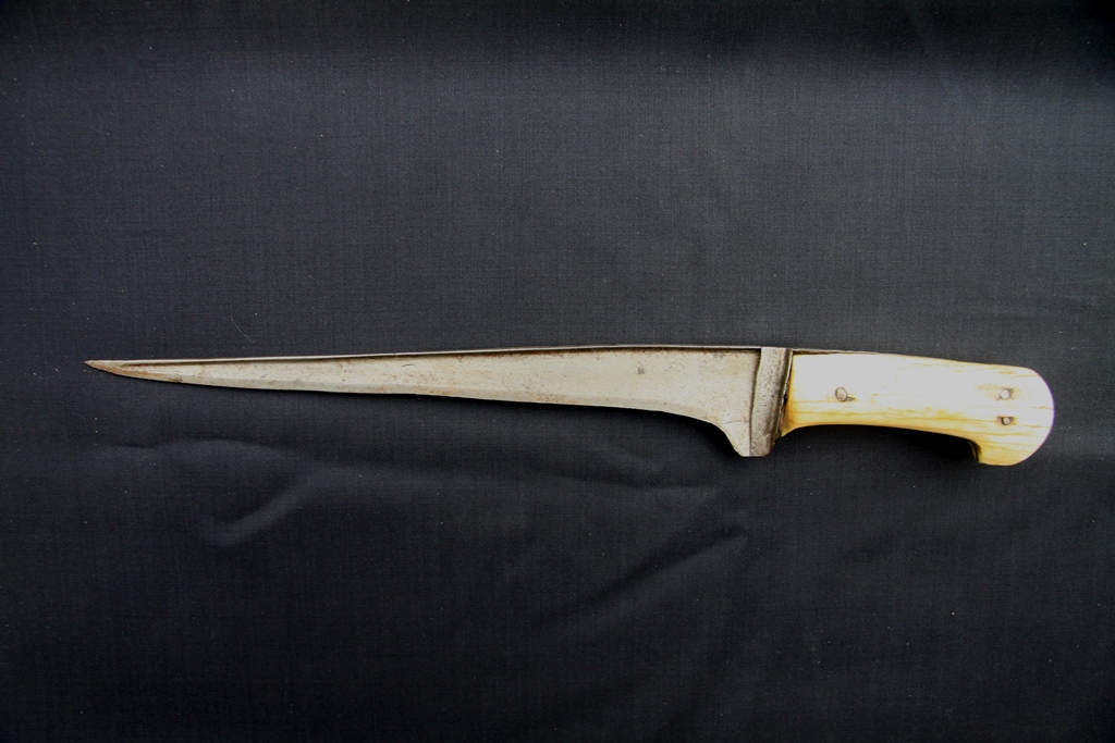

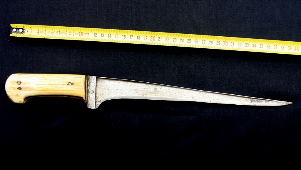

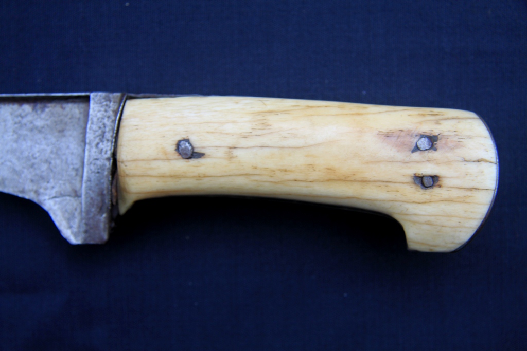

Who can tell me more about this Pesh-Kabz ,How old it could be ?
The grip is of (walrus ?) ivory and a heavy T-section blade ,16 inches long.
Any comment on it will be welcome

I would say Afghan, not Indian.

Hi,
In my opinion the grip slabs are elephant ivory and not walrus.
A nice piece though....!!!! My inclination is North India Mughal influence late 18th century.
We should be able to find more as the experts come in
Bhushan

salut cerjak
ton peshkabz est afghan 19ième , je pense que la poignée est en ivoire d'éléphant... pas du morse..
It is an afghan peshkabz 19th, I think that the handle is of the elephant,not the walrus

Thank you for your answer unfortunately It 's not helping me about age and origin so 18 or 19 Th century ? Indian or Afghan ?
About the hilt yours opinion are the same so I safe

Looks more like camel bone, but a nice real old knife.

As others have stated, it is Afghan not Indian, the grip would be elephant ivory. I'd say 20th century, not 19th.

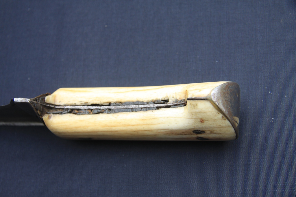

Is anyone else seeing the porous nature of the hilt scales....might this be bone, rather than ivory?

Grip is ivory and seems to be Indian.
It may be influenced from afghan pesh-Kabz form.

I believe that this is an item from Afghanistan. Late 19th century - beginning of the 20th century. Bone handle - not an ivory (elephant tusk), and the usual bone (such as the legs of the animal)

I tend to agree with mahratt; this was not an expensive dagger when new so I doubt it would warrant ivory scales .

Generally crack type linings comes in ivory but i didn't no that such crack type lining comes in bone also.

One can see short longitudinal dark lines: these are periosteal blood vessels.
To simplify: bone. Not ivory.
