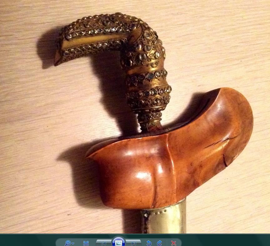

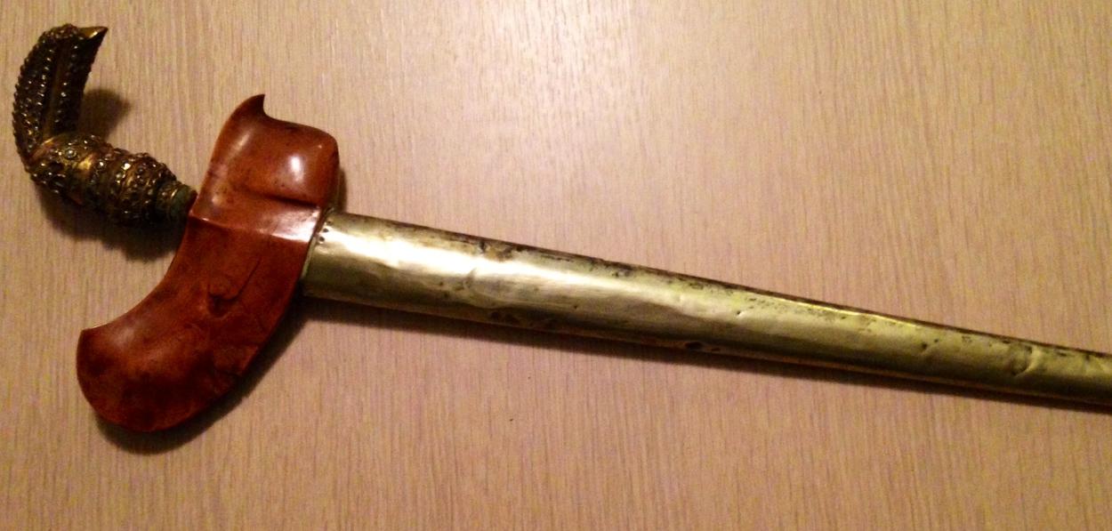

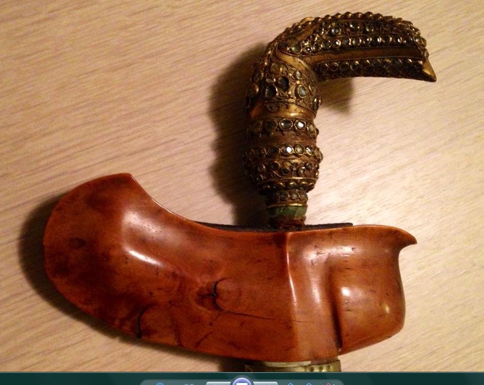

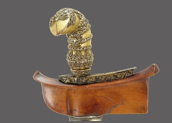

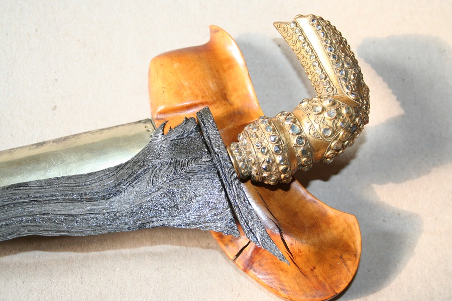

Today was my lucky day in personal life.
Daughter turned 8, family and friends visited and we had a wonderfull day.
Unfortunately I missed out on an auction of a imho banjarmasin keris.
Posting pictures here for comments and sharing.
Willem
Old 25th March 2013, 07:44 AM   #2
PenangsangII
PenangsangII's Avatar
Join Date: Jun 2007
Posts: 401
a marriage made in heaven
the sheath is of Cirebon and Solo influence. The hilt is stylized from the Bugis rekko hilt but has strong Kalimantan flavor. The blade... well we need a clearer shot.

Originally Posted by asomotif
Unfortunately these are all the pictures I have, and I was not the lucky buyer.
Better pictures of the blade would have been interesting indeed.
its an unusual tipe of warangka.
it would be nice to see the whole keris indeed.
since there is no certain tipe of kalimantan keris, we can only see the different fron the tipe of jejeran. its common to see bugis, java,sumatera keris mounth with kalimantan jejeran and warangka.
ferrylaki is offline   Reply With Quote
Old 26th March 2013, 11:24 AM   #5
Gustav
Join Date: Jun 2009
Posts: 1,346
The same type of Wrongko is depicted in van Duuren's bibliography, the last colour plate, also atributed to Banjarmasin. On this Wrongko besides the exagerated Lambe the most distinctive feature is the straight Loto. Solonese Gayaman Wrongkos generally doesn't have a Loto, except one type on which it appears, yet curved.
It says nothing of course. The makers in Indonesia are using Keris books for their creations for some time already. It could be just the light in the pictures, yet the right side of Wrongko (when held correctly) looks a bit like reworked, like sanded down, the surface has slightly other, lighter colour then the left side.
There is a possibility the Lambe and Loto are worked out on a common Solonese Gayaman.
The hilt looks like Peninsular Pipit Teleng hilt, yet without being Teleng.

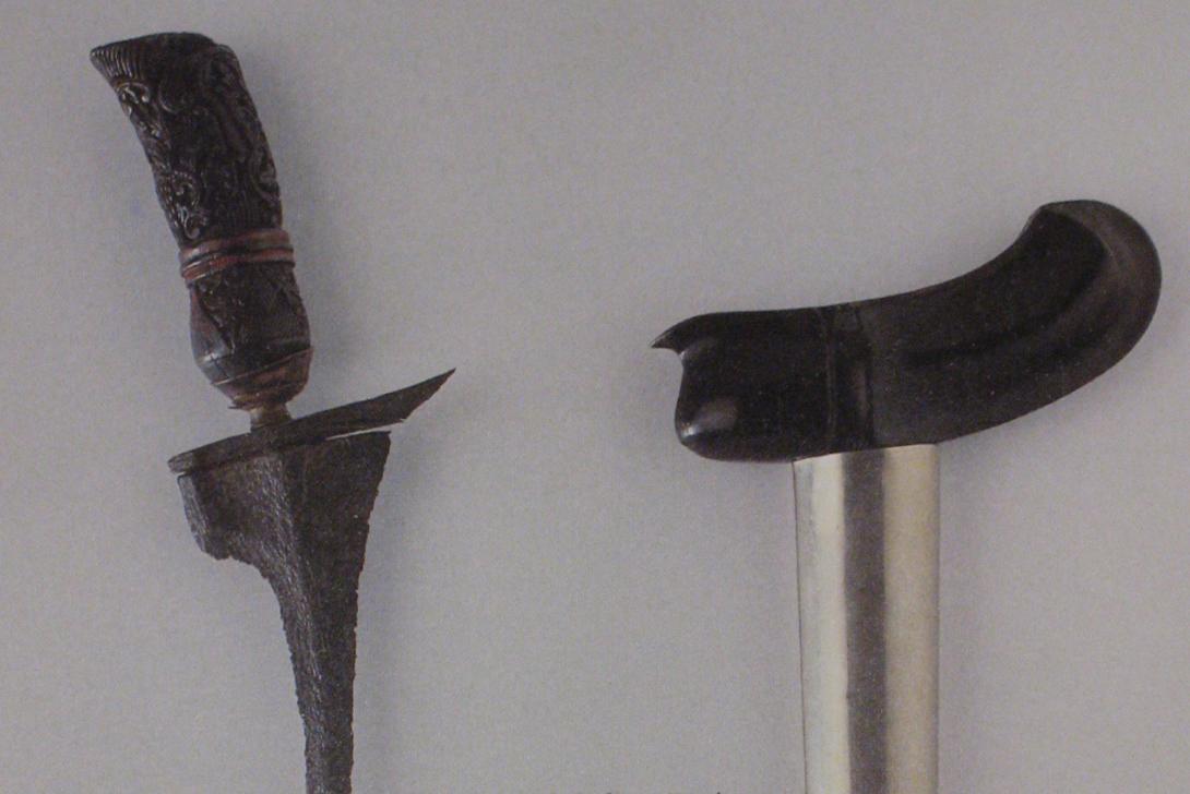

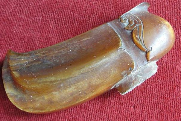

Check out this Wrangka, on a keris that I missed out on 2 years ago.
http://www.vikingsword.com/vb/showth...ht=banjarmasin
Old 27th March 2013, 11:00 PM   #7
Maurice
Maurice's Avatar
Join Date: Jan 2007
Posts: 1,464
Willem,
it seems you misses all the good stuff...
I would love to add this last one with horn wrangka to my own collection.
Do you know where it went?
Maurice

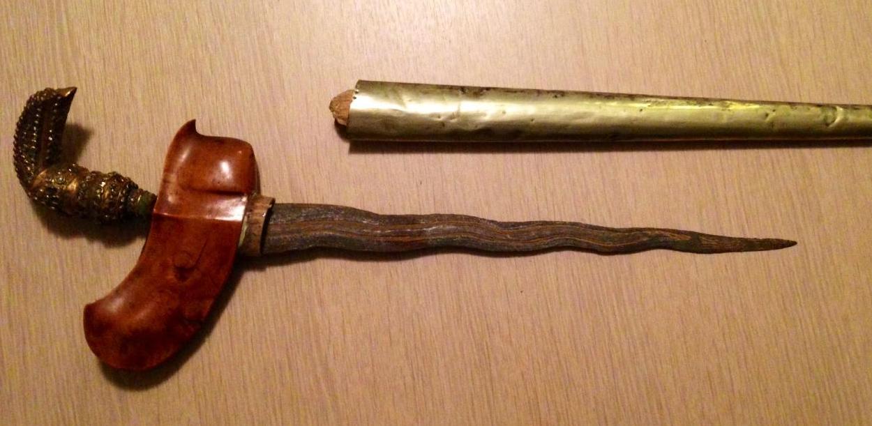

Here the 2 wrangka's together.
Notice the similarities in form.

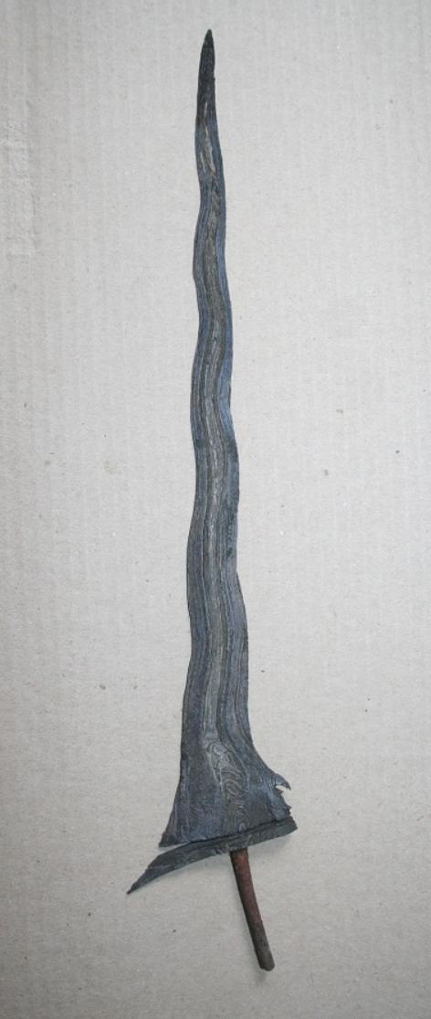

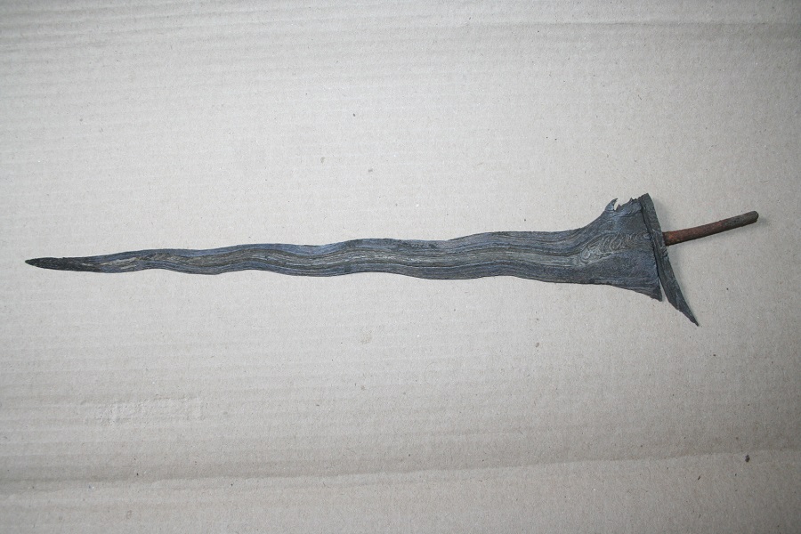

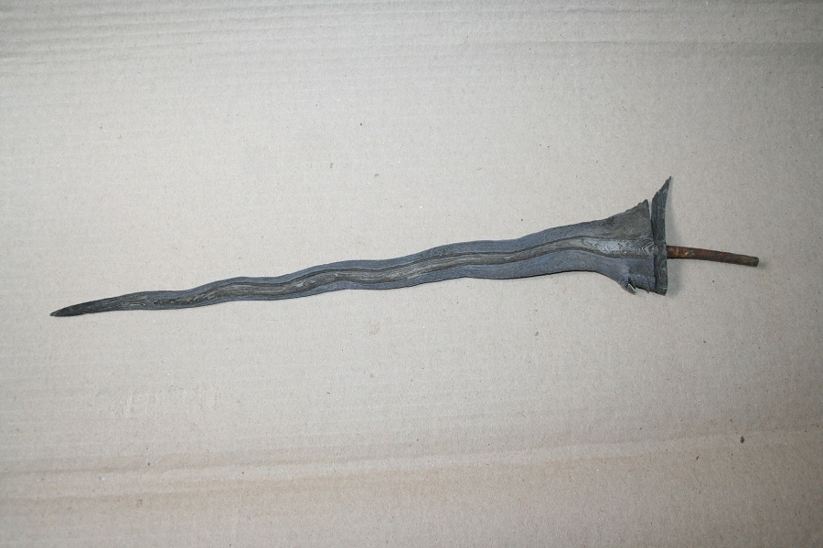

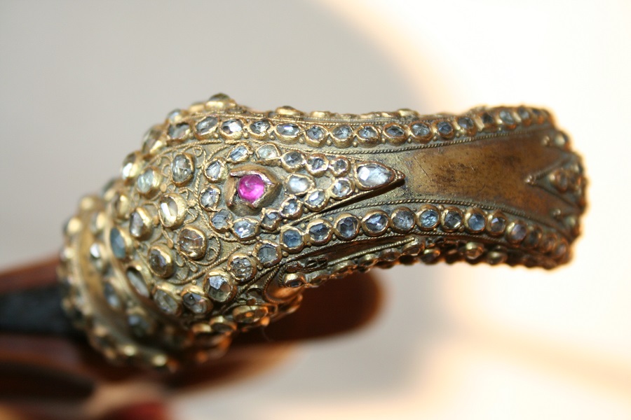

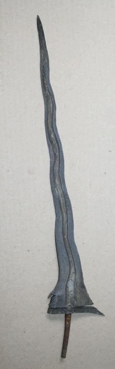

I've had contact with the new owner of the Bandjermasin keris and he emailed me some images of the kris, which I was allowed to post in the forum.
Maurice
Old 29th March 2013, 08:54 PM   #11

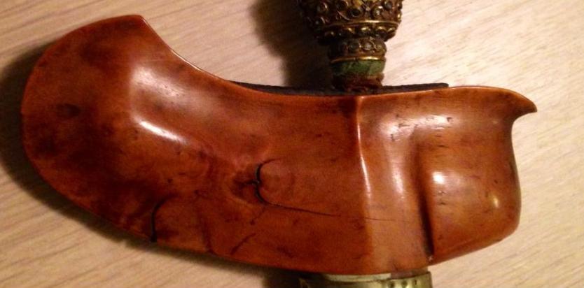

Here a picture of the keris Gustav refers to.
Maurice
Thanks Maurice,
Nice to have the full picture of the blade.
I have enlarged and turned them to get a better view of the blade.
Old 29th March 2013, 10:27 PM   #13
Posts: 6,436
Question
When I see a blade like this I always wonder what it looked like new .
How does the gonjo become seperated like that, from the wilah ?
Couldn't have been that way when made, right ?
Old 30th March 2013, 02:49 AM   #14
Posts: 7,229
Rick, last year I had the opportunity to handle a lot of very old keris that are located in European museums, keris that entered Europe before 1700 in most cases and in a few cases before 1600.
If I had not known the provenance of these keris my opinion would have been that I was handling keris from no earlier than about 1850, probably much later.
What happens with keris that have been located in their native environment for an extended period of time is that repeated cycles of cleaning followed by lengthy neglect results in a large part of the body of the blade being eroded. This erosion also occurs between the blade base and the gonjo, and thus we get a gap, even a light knock can push an old gonjo out of place.
In blades that have been restored in Central Jawa over the last 40 or so years, many m'ranggi have used epoxy resin, or a mix of epoxy resin and iron filings to fill the gap between the blade and the gonjo, thus providing a degree of protection to this area.

Hullo everybody!
Just referring back to the original post, to me (in local terminology):
Blade: form: Sampana 9Lok
damascene pattern: Lidi Sabatang
Sheath: form: Jukungan
Old 30th March 2013, 11:31 AM   #16

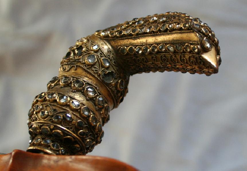

Just for sharing I would like to add a picture of a superb banjar keris that was recently sold by an antique dealer.
best example I have ever seen.
