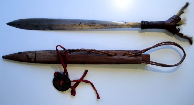

Originally Posted by VVV
Outside Banjarmasin (Ngaju Dayak): duhung (spear dagger), ilum (= sadup), dua matu bayu (double edged sword), parang negara (flat "mandau" with floral motifs).
Michael
as I am ngaju.. I only know.. duhung/dohong, ambang, pisau lantik/ parang bungkul, ladok, keris, mandau..
sadop/sadup is not ngaju but it belongs to Dayak Paser...
I never heard dua matu bayu.. its definitely not ngaju language..
do you have any literature of picture about this "dua matu bayu"?
Cakszz is offline   Reply With Quote
Old 21st August 2013, 01:25 PM   #10
Gavin Nugent
Gavin Nugent's Avatar
Posts: 2,818
A bump to the top...as previously asked above, is there photos of the presentation?
Gavin
Old 21st August 2013, 04:15 PM   #11
VVV
VVV's Avatar
Location: Sweden
Posts: 1,637
Originally Posted by Cakszz
(snip)... I never heard dua matu bayu.. its definitely not ngaju language..
Sorry I first saw your post now.
As I explained on the seminar dua mata bayu is not from any dayak language but is Indonesian. It roughly means two eyed wind, i.e. a sword that can cut from both sides (being double edged).
Michael
