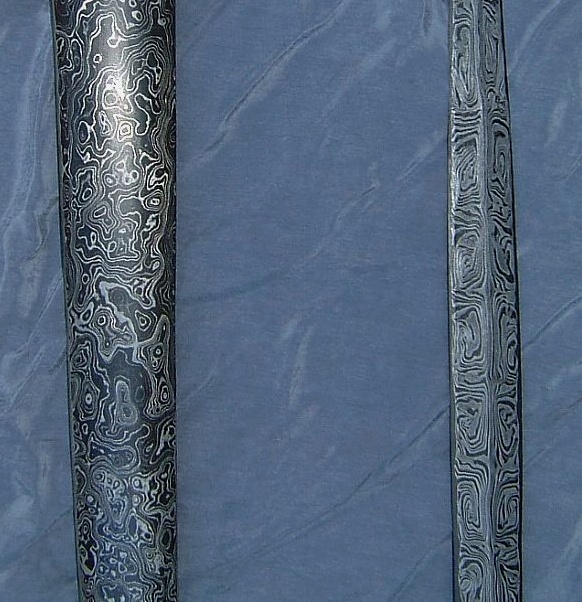

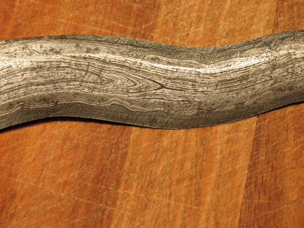

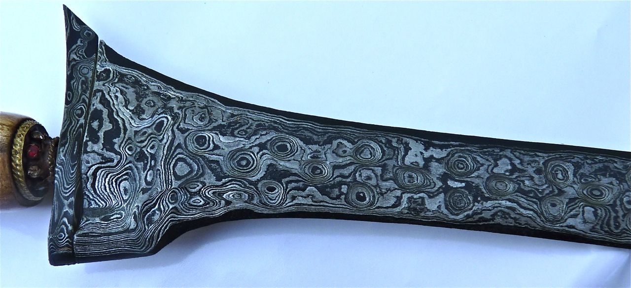

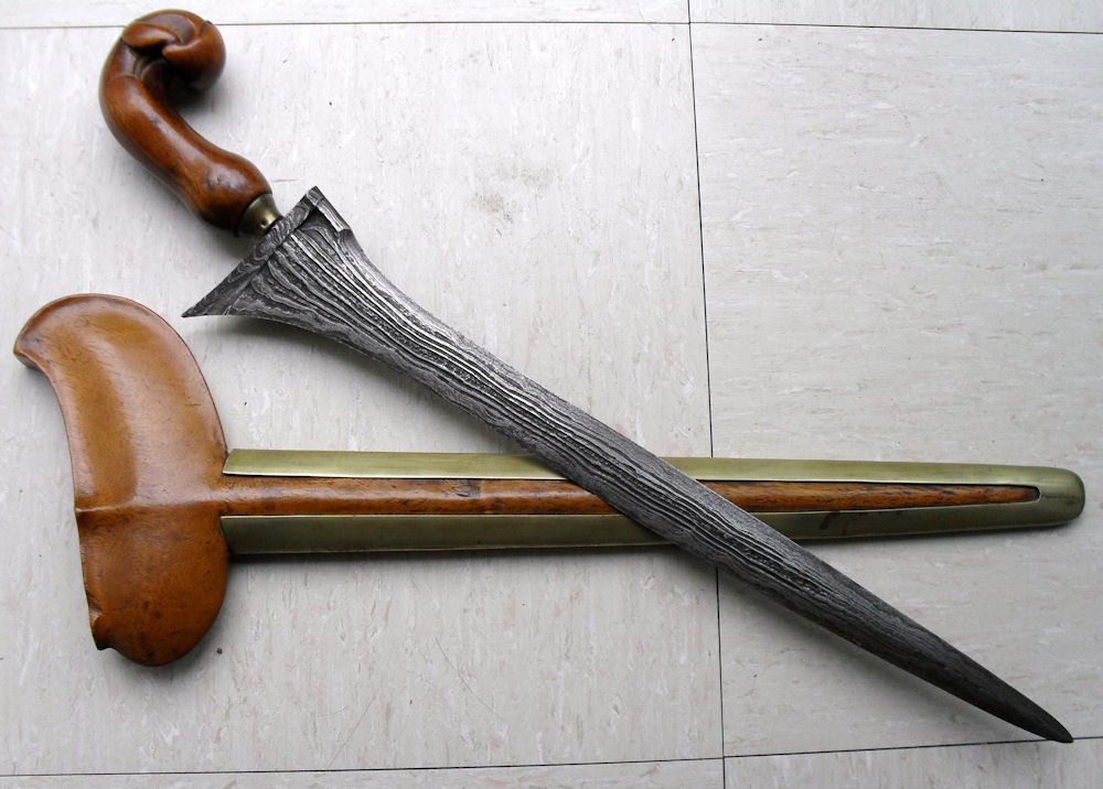

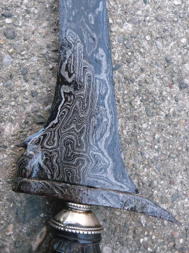

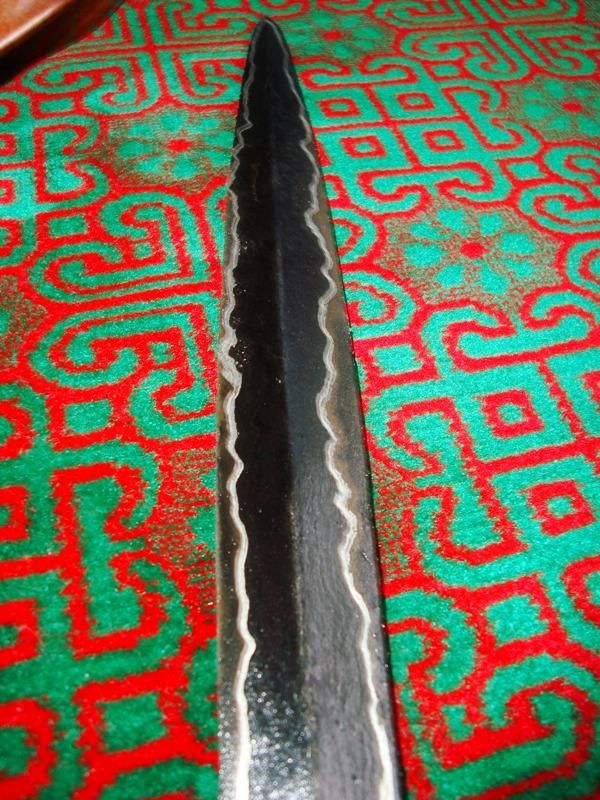

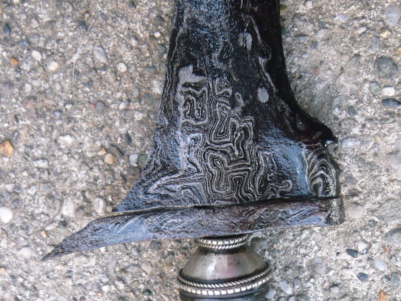

Here I believe is the first batch.
I selected what are interesting to me in no particular order.
Ric

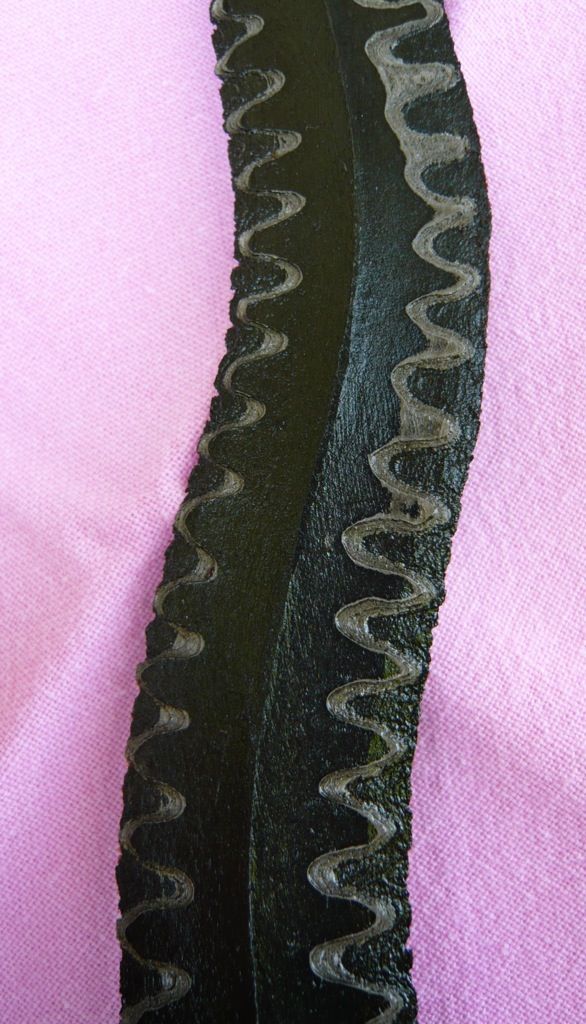

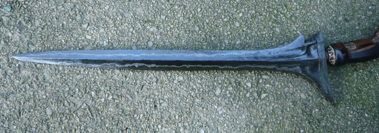

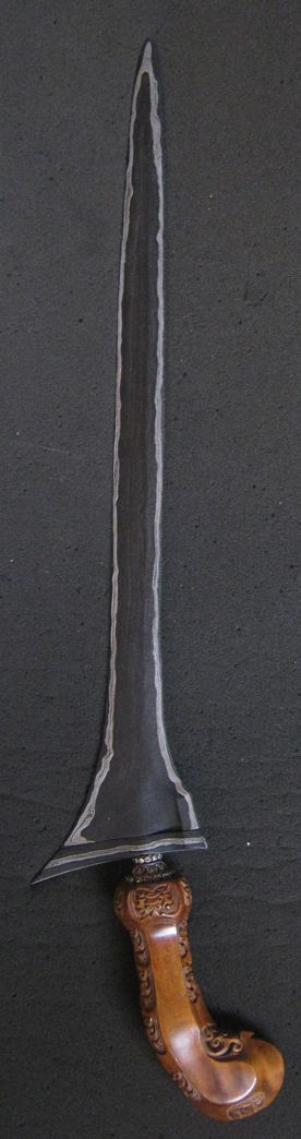

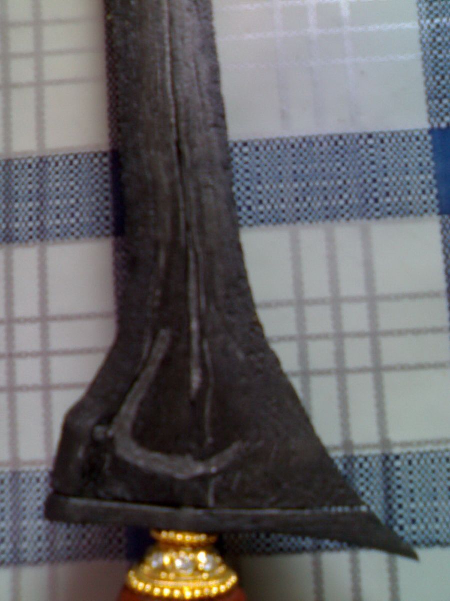

More
Ric

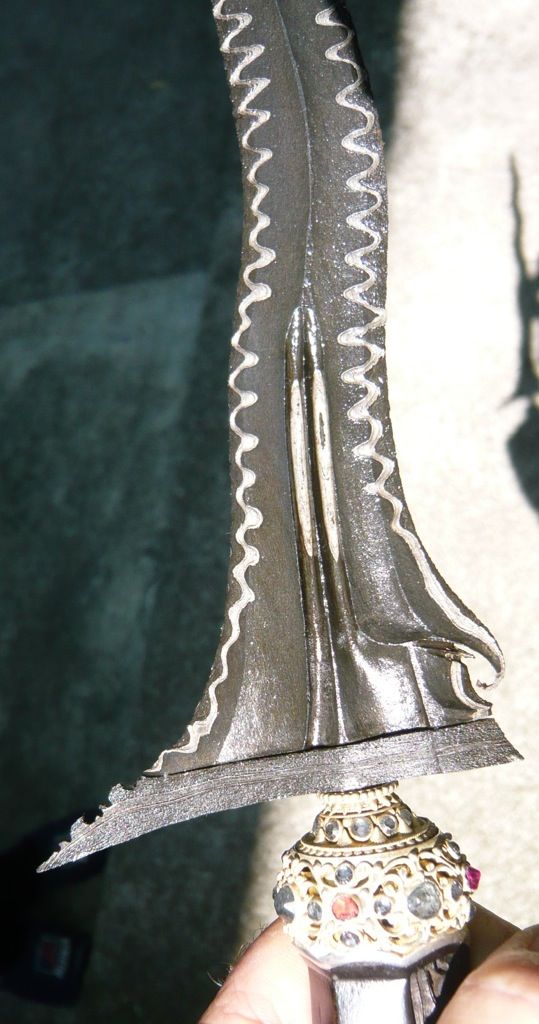

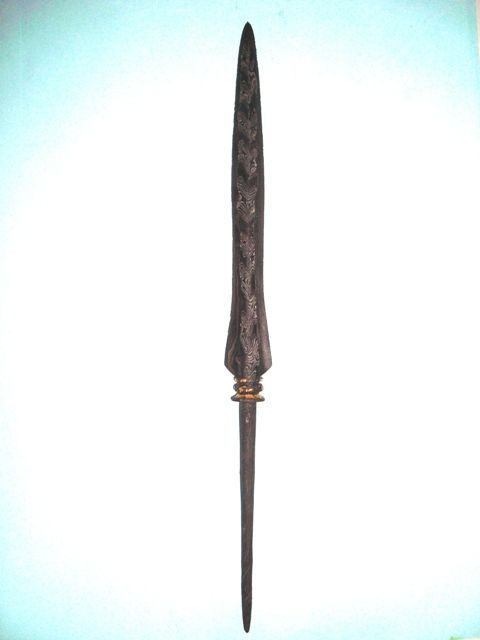

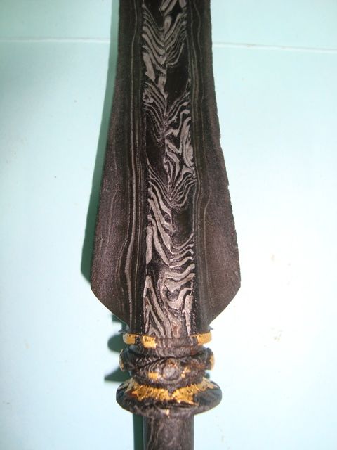

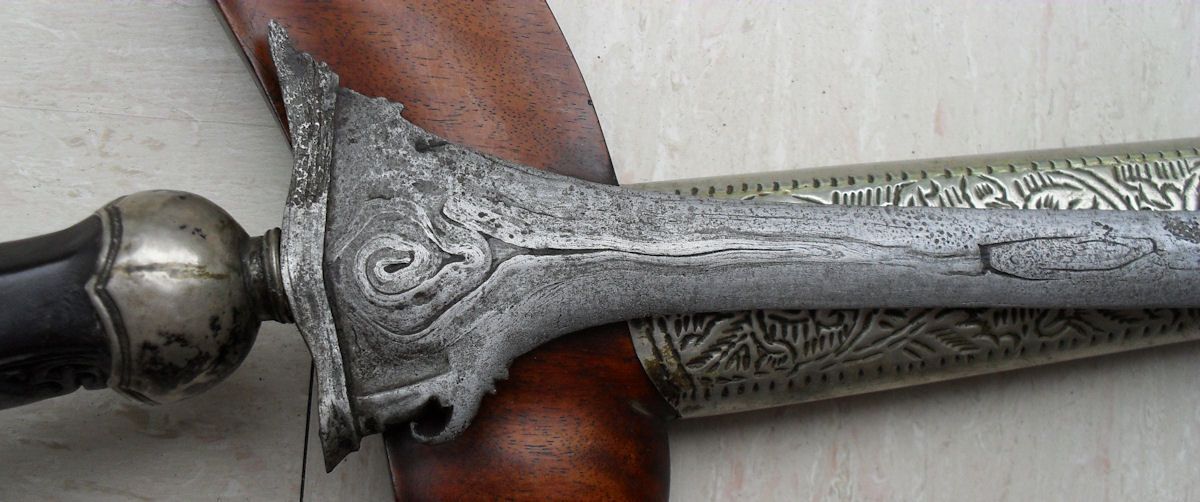

More
Ric

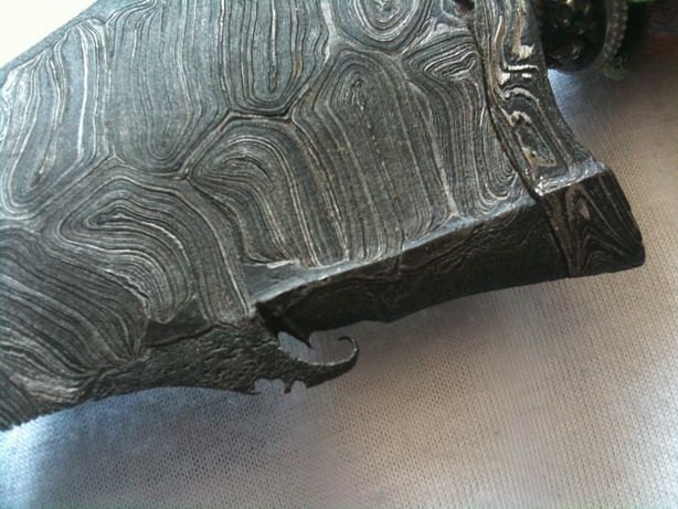

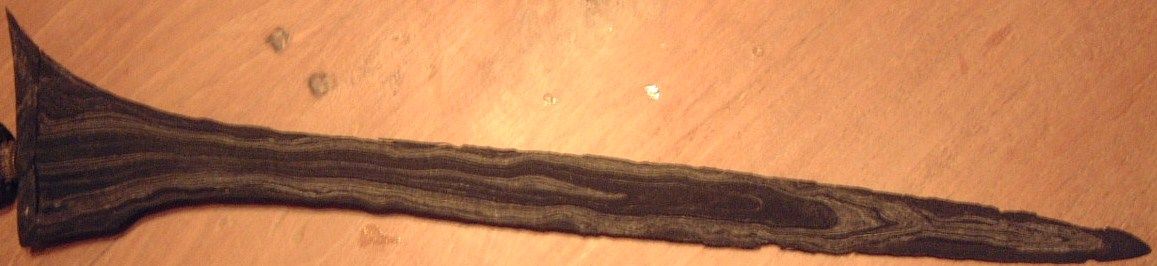

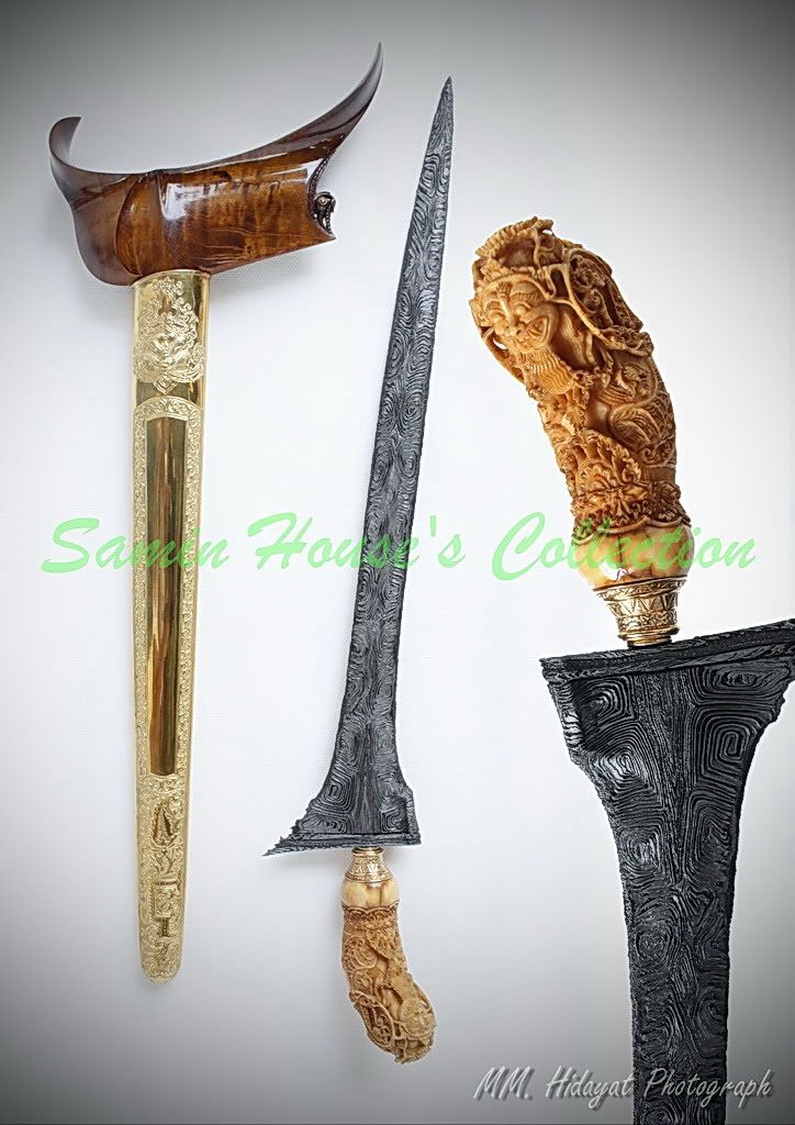

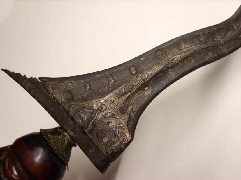

More
Ric

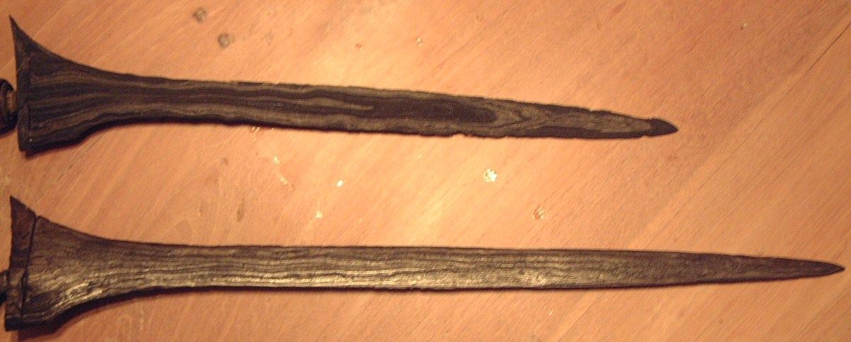

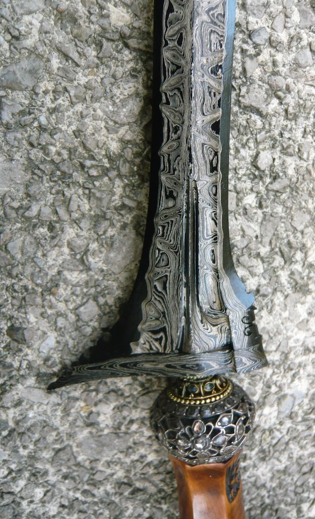

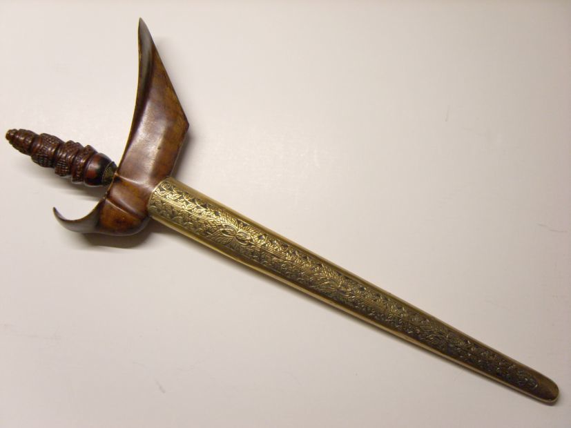

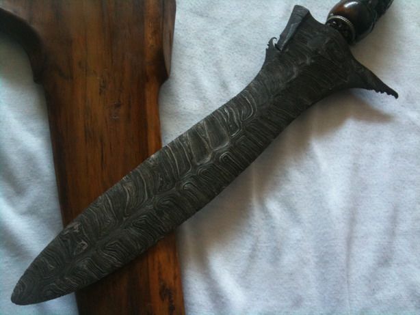

Yet more
Ric
