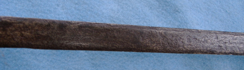

Here is a rather unique Piso Podang, likely from Sumatra. It is a rather small sword at just 29.5in. overall, with a 24in. blade that is of very thin and flexible pamor steel, and is only 1 inch wide at its widest. The blade's pattern can be seen as it has been gently rubbed and the patina now shadows the pattern.

Both the hilt AND that the blade has pamor is very unusual.
However, I don't think it is a piso podang but a chenangkas, because the blade is straight.
Could it be Javanese (which I haven't seen before)?

Yes VVV, you are right, more correctly this should be called a chenangkas. I was simply using the hilt form to categorize it. Javanese???....when we are talking about such an oddball...who knows??!! It is certainly possible.
