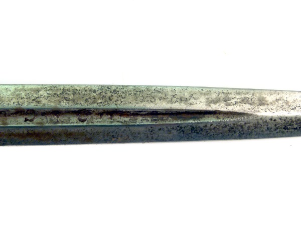

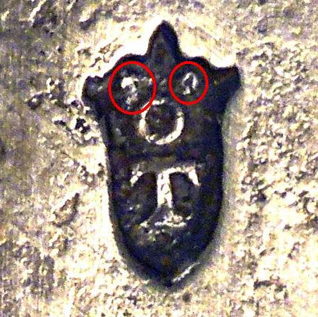

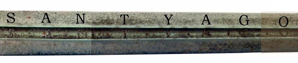

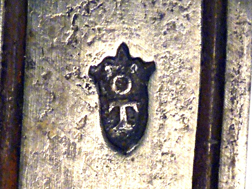

Does anyone recognize the makers mark of this parrying dagger? I wish I could find a reasonably priced copy of the three volume edition of HEER DER NEUE STOCKEL, but I can't speak German anyway.

That would be the Toledo inspection mark. Are those inscriptions in the blade. Can you show us close up pictures ?

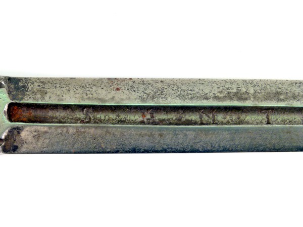

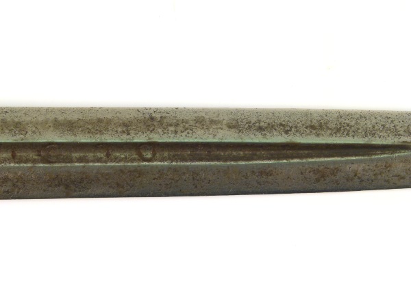

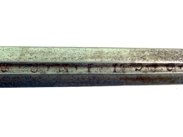

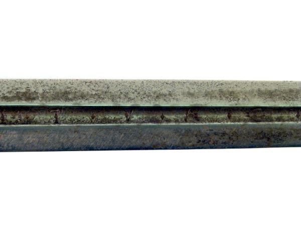

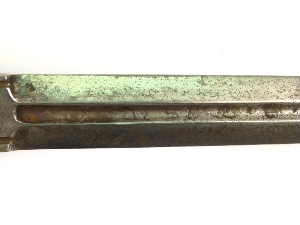

Sure, but the inscriptions are hard to decipher. Here the first three are the front side, the next three are the back. I have higher resolutions photos, but it doesn't make much of a difference.

Perhaps having the blade in hands and burning your eyelashes for a while, you figure out the contents of the inscription ... a high probabilty to be the maker's name, as they often used to do.
Assuming you know the following charts ... which are a good inspiration.
HERE see post #152

der neue Stockel is about marks found on firearms, not on edged weapons.
I would recommend "1000 marks of European Blademakers"by Zygmunt S. lenkiewicz.
the city of toledo hallmark , because that's the OT mark, was often used in combination with another mark of one particular swordsmith.
because the Hallmarkstamp quickly weared, there are (at least)four different versions known of this OT mark.
beautiful dagger with a shell as parry plate, pommel and guard ends would be a very good match/dagger for a naval officer at the beginning of the 17th century.

I haven't found much info about the city of Toledo hallmark. Can one of you point me at something. The mark looks a lot like some of the maker marks fernando posted. I'll include another photo closeup photo.
After looking closely at the blade I have made a drawing of the marks on each side. They seem to be made up of a triangular stamp and lines.

This is a most attractive left hand dagger of 17th century form, obviously Spanish with the T stamp at forte which is as noted a compliance or acceptance type mark, I cannot recall what the OT means (memory slipping. These were of course usually en suite with a rapier so the rapier associated must have been a beauty! Spain and Italy were the last holdouts using the left hand dagger in fencing, but by the end days most were simple quillons and ring guard except for the Spanish who held more to traditional styles.

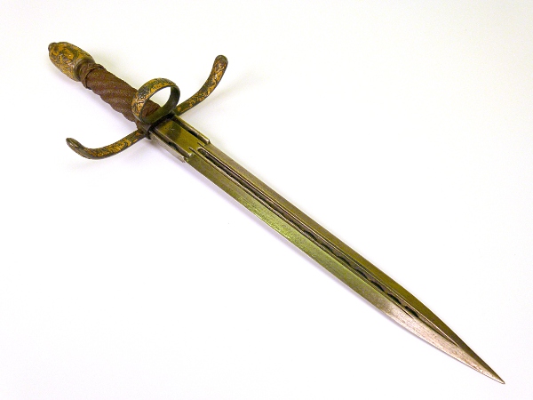

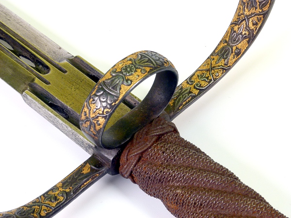

I am glad you like it. Here is another that is sitting on the desk

... because that's the OT mark, was often used in combination with another mark of one particular swordsmith....
Sure thing Jasper but, less often they only used the To mark, with little variations on the estucheon design and, i guess, others would use the To mark with their own initials inside the same estucheon.

I get it now, the 'OT' is Toledo, reversed initials.

@ Fernando and Jim, you did a really great Job, this is of course the right
track. SANTVAGO and the reverse side "IN TOLEDO"?!?
Indeed maybe the dagger of a member of the Portuguese Military Order of Saint James of the Sword/ Ordem Militar de Santiago da Espada 1172-1834.

Dana, that other dagger of your yours is also a beauty. Perhaps you wish to start a new thread with it ?
