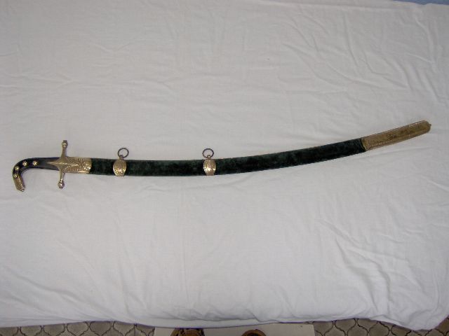

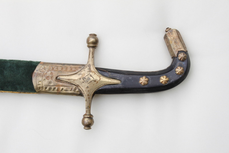

can you give me the origin of this sword, I think Hungarian?
It is 98 cm long, the blade 86 cm
thanks

the front frame is not part of this sabre

Very interesting. The form is Syrian/Badawi but the work is not typical and intriguing. I have a Badawi saber with an old blade refurbished in contemporary improvised fittings, with a similar green velvet sheath, but the work is plain, not to say crude.

Yep, this is an interesting piece. It does look like the Syrian saif but there is something off (very) with it.. I dont know, it could be as Broadaxe says?
Things does get rehilted often in Syria and KSA.. so its all possible.

the person who sold it to me told me that it would be Hungarian !!!!

Well its possible. I am not knowledgable with East European arms but I always thought Hungarians had swords similar to Ottoman and sometimes Syrian stuff?

I'm holding the best source about Hungarian swords, Kardok by Lugosi & Temesvary, besides I'd visited several collections in Hungary. While the design looks very closely to Syrian, this could be late court sword for lower rank nobility. Both Hungary and Poland adopted turkish-style sabers, often fitted with turkish to persian blades. The epitome of such sabers was during the 16th-17th centuries and they mostly lost favour as fighting swords by the beginning of the 18th century. Early style Magyar saber however, remained as a mark of status for nobility, usualy highly decorated, like this one http://www.oriental-arms.com/item.php?id=3670
The small stone fixture on the pommel is hungarian motif, so it's possible.

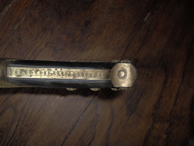

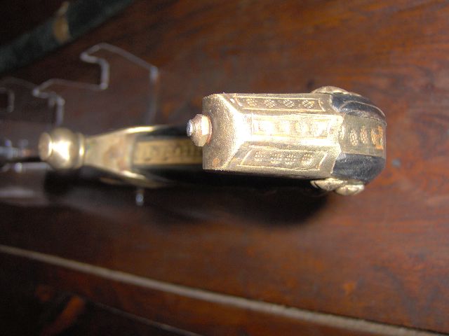

Old 31st October 2012, 09:03 PM   #8
laEspadaAncha
Posts: 608

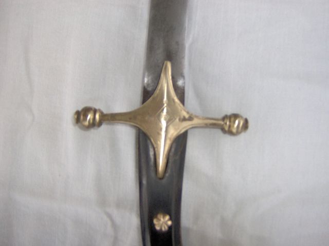

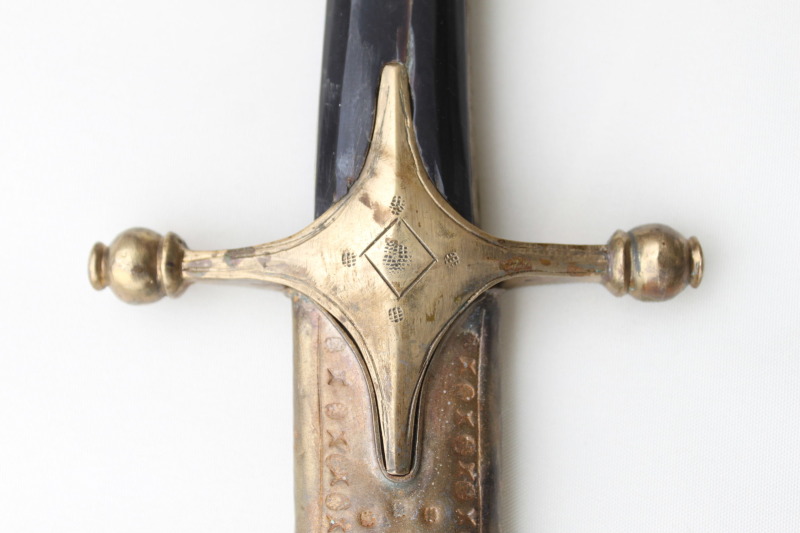

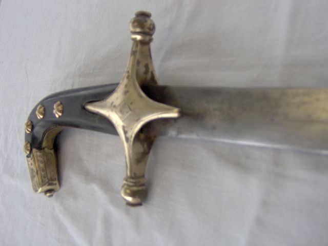

What would those rather globular finials indicate? They seem atypical to the aesthetic of the rest of the hilt and appear out of proportion.
Would this indicate a more recent manufacture, or a provincial styling or interpretation? Either way, IMHO the execution of the finials is somewhat crude.

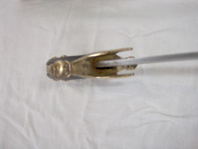

Also, there appears to be a hexagonal nut at the pommel cap. Can you please post a close-up of this construction?
Aside from the crossguard, I like the hilt, but between the atypical crossguard and blade, and what appears to be a hexagonal pommel nut, I'm wondering if this might be a marriage piece...

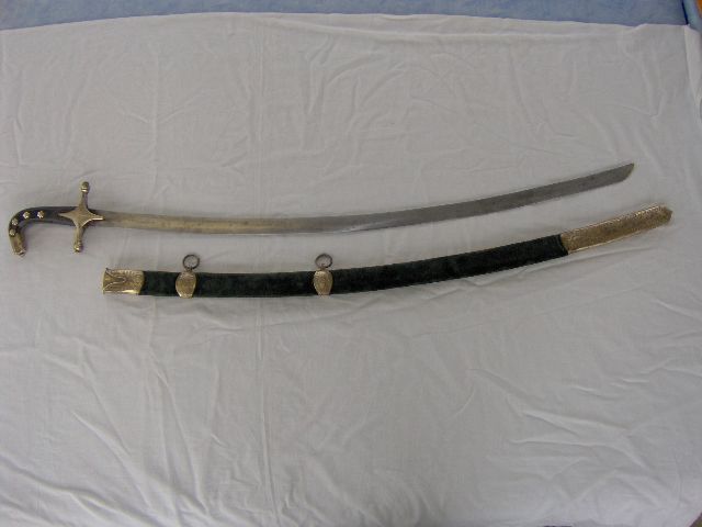

I saw it on e-bay and was only shaking my head... IMHO, this is as Hungarian as Chairman Mao. I cannot recall any Hungarian or Polish sword with a downturned pommel. I strongly suspect that the scabbard, its fittings and, perhaps, also the handle, are modern. Also, check the wooden core of the scabbard: likely it will be quite fresh.
Rather than traditional marriage, this is a case of swinging and swapping :-)
I would try to return it ASAP.

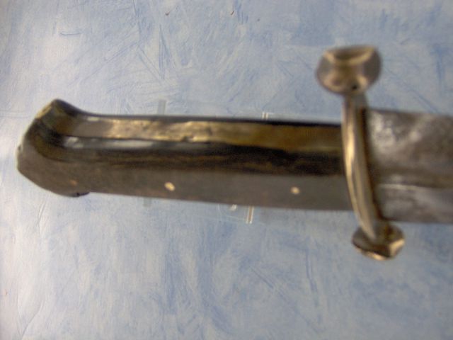

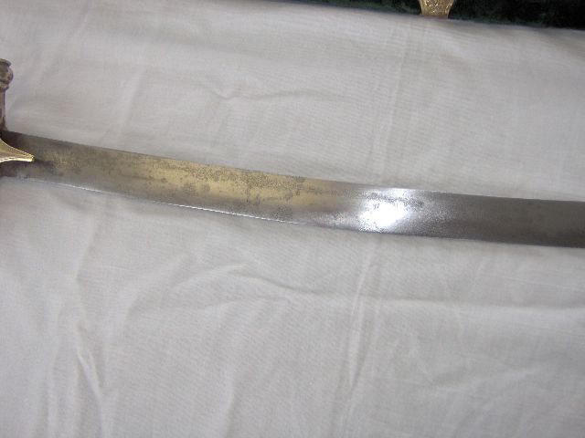

Old 1st November 2012, 06:45 AM   #10
weapons 27
Join Date: Feb 2012
Posts: 462
Here are some pictures before his cleaning, polishing and protective wax...the wood of the sheath looks me old...

I was holding my tongue as not to offend anyone. Thankfully, Ariel said it all quite nicely.
Quite often the collectors argue about some "features" and how they appear and could be, and that someone (mostly the seller:-) said it was something, etc. Just because something "looks like" or "appears" does not mean "it is"!!! Unless one spends considerable amount of time and effort to acquire genuine knowledge and expertise - these arguments, and sometimes denials, are costly downsides of the learning curve.

You also touch up on an important point, something I think we all have experienced as part of the learning curve inherent to collecting: it's easy for collectors to find something right about a piece to justify its acquisition. However, the wise path is to recognize what's wrong.
And with regards to this particular example, unfortunately there is far more that's wrong with it than is right.

so if I understand your comments, the handle is not original and would be a recent wound...

First, you have to define "original" in terms of your collecting interests. It will depend on your individual preferences. Are you collecting any swords and weapons, or interested in certain time periods, origins, features and/or qualities?
So, first define your collecting goal and then match the item.
Also, what do you think this sword represents: like how old it is/time period, quality of fittings and blade, quality and type of work, details, materials used, etc?...
Look for more defined answers, not just overall look or form, like: "it looks like Hungarian". Finally, what do you like, or dislike" in it? What can you compare it with, i.e. another similar swords/references?
These questions are a must for any serious collector though:-)
P.S. this Forum's own guide will be helpful: http://www.vikingsword.com/ethsword/guide.html
Good luck in your collecting!

I removed the back of the handle, I found a piece of threaded iron taken in a fairly hard resin that I removed .the mounting was used to maintain the tip.the Horn of the handle is a little attacked by insects and Horn sawdust fell, all former...I reattach the tip with a resin

Dear member,
I hate to say this but this sword has got nothing thats Ottoman /Turkish and what looks like is a syrian imitation with the exception of the blade all the fittings are new.As for the blade its is difficult to determine its origin age etc from the little picture that is supplıed bot I doubt very much if ıts Ottoman.
