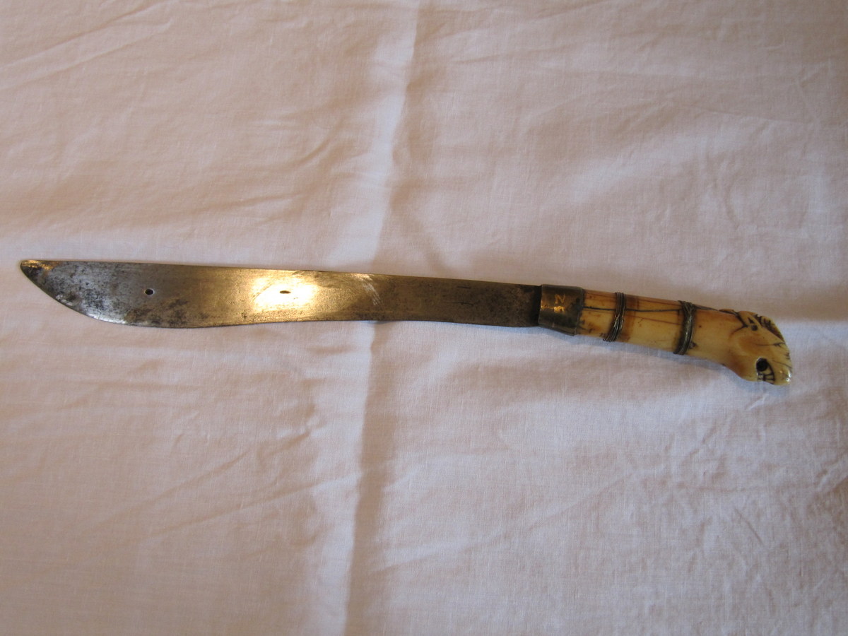

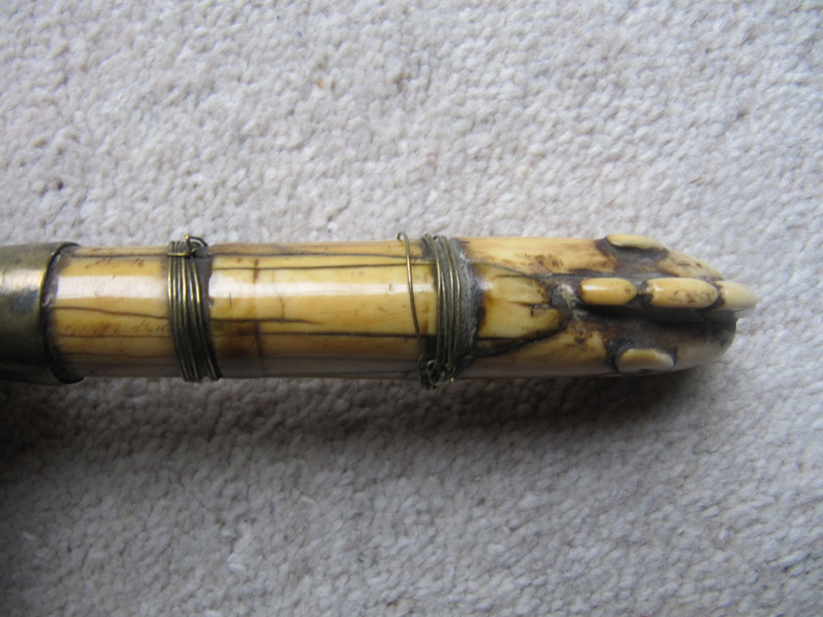

Any ideas on the place of origin of this dagger? It is 37.5 cm long, the tip broken and the blade filed down to give it a new point. Brass wire on the hilt perhaps a replacement?

How about a luju/loedjoe Alas variant?
Seriously, this seems very tough to pin down. I'm not even positive it is Sumatran/Indonesian.
Please post more close-ups of the hilt. Which kind of ivory?
How does the back of the blade look like? Maximum thickness?
What is the round depression towards the tip? (The other irregularities are forging flaws?)
I'd be inclined to etch the blade for obtaining more info, too.
The wire looks like an attempt to stop the splitting of the ivory - the marks seem to suggest that there were originally 2 bands of silver? (Ferrule is silver, correct?)

Thank you all for your comments.
A luju Alas variant would be great, as Sumatra is my main interest, but like Kai I am not sure it is Sumatran/Indonesian - I was so intrigued by the hilt that I could not resist buying it. I had assumed that the hilt was elephant ivory - I shall try to take, and post, more photographs of it in the next few days, which may help identify it for sure. It is 12 cm long, to the bottom of the ferrule (which is pale brass, rather thick and crude, perhaps a later replacement).
The back of the blade is flat, maximum thickness 4.5 mm at the base. The oval depression near the tip, the tadpole-shaped one near the middle, and the two thin ones near the base (just visible in the photo.) are all identical on the other side of the blade - perhaps the oval one, at least, once had a metal inlay?
As for etching - same comment as in the reply to the comments to my other query, lack of knowedge, and nervousness about causing damage.

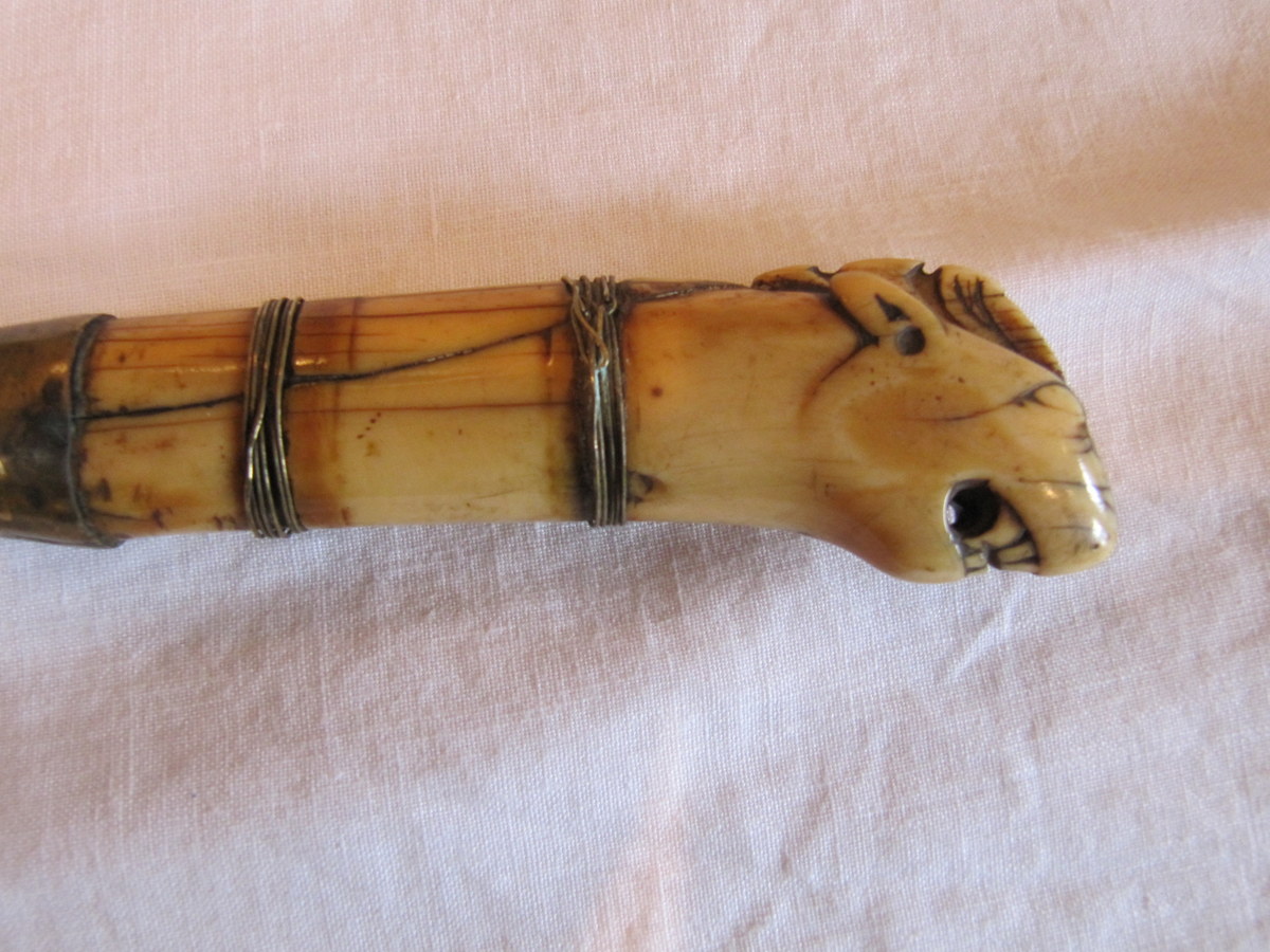

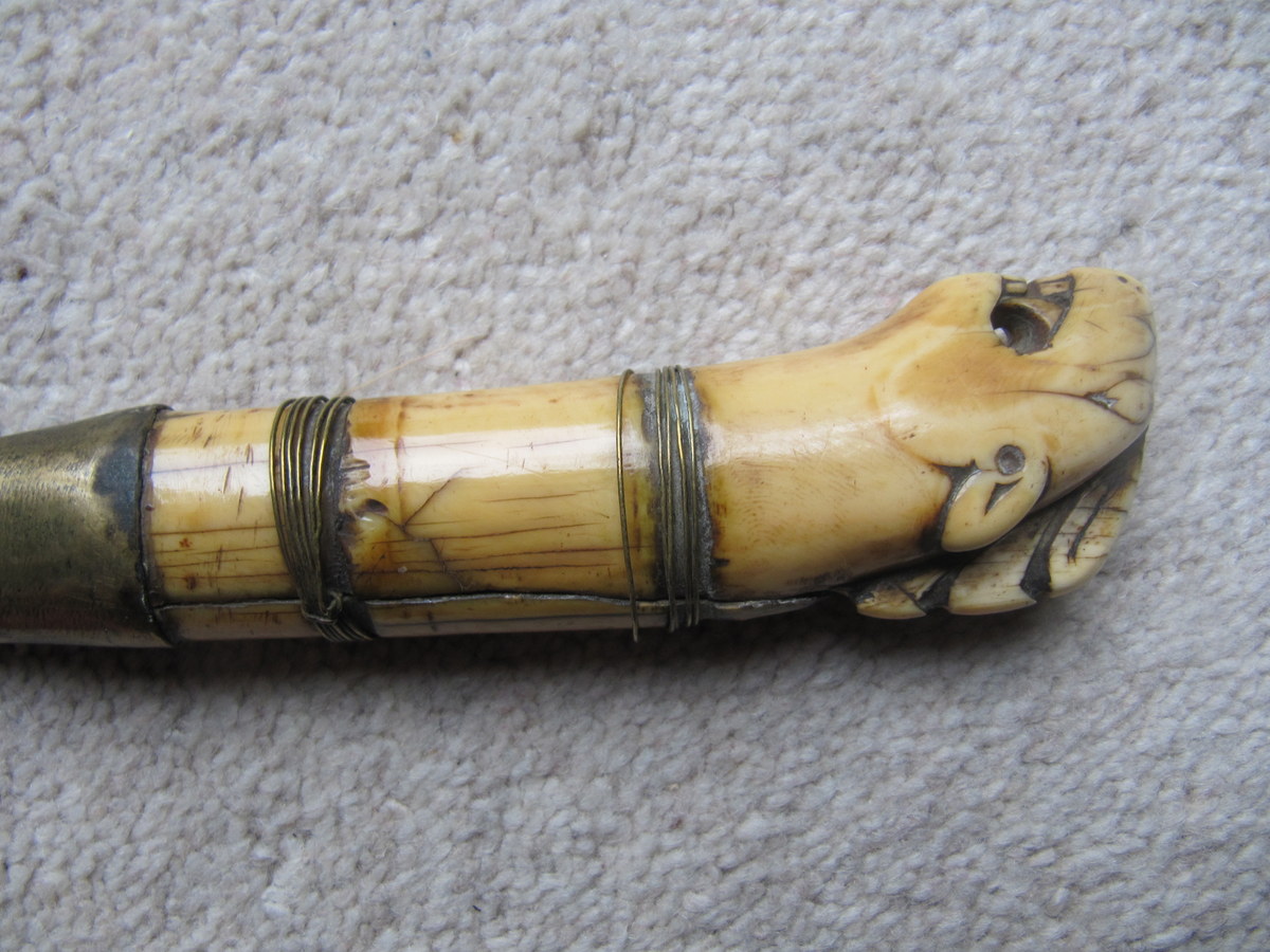

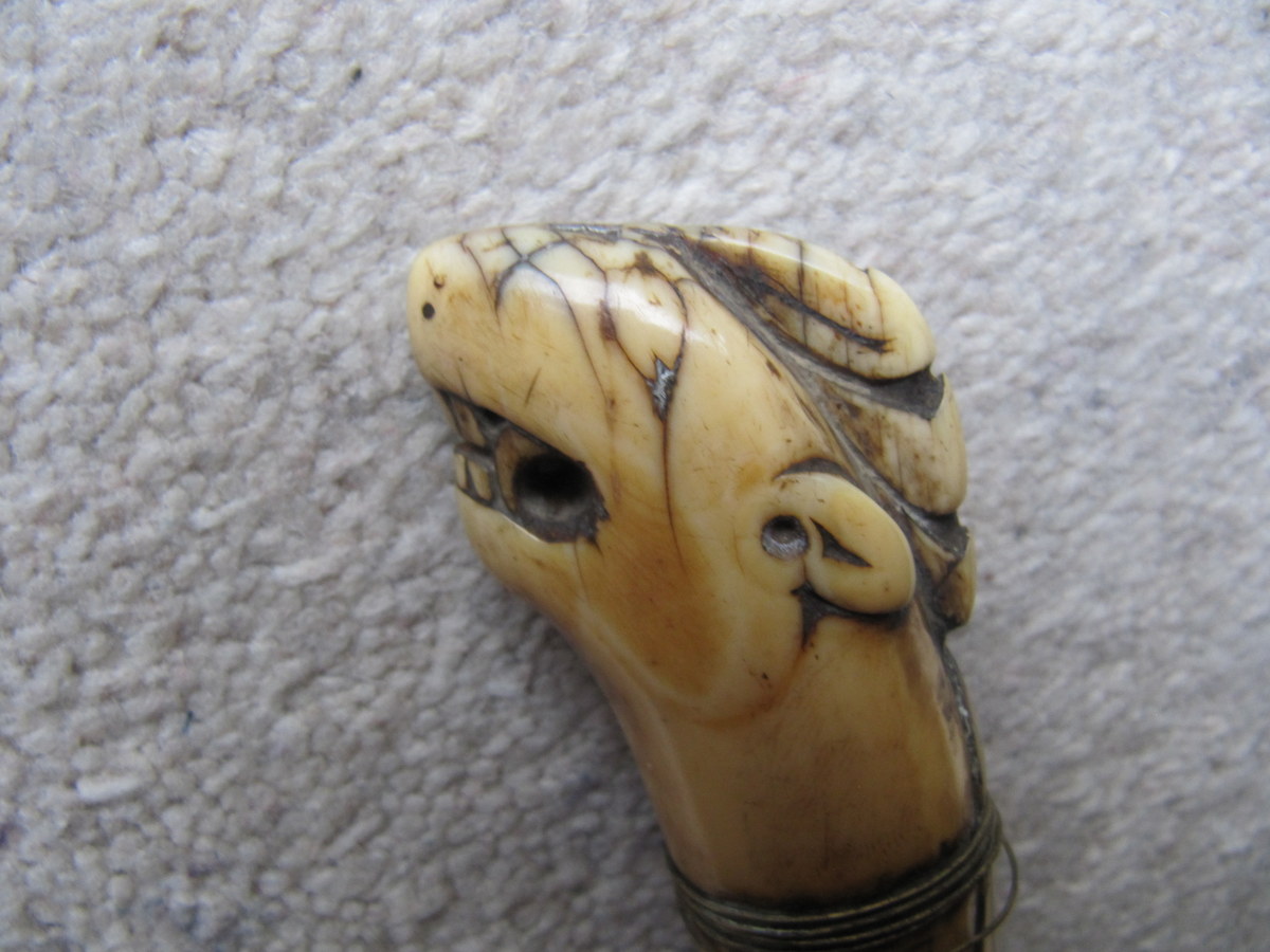

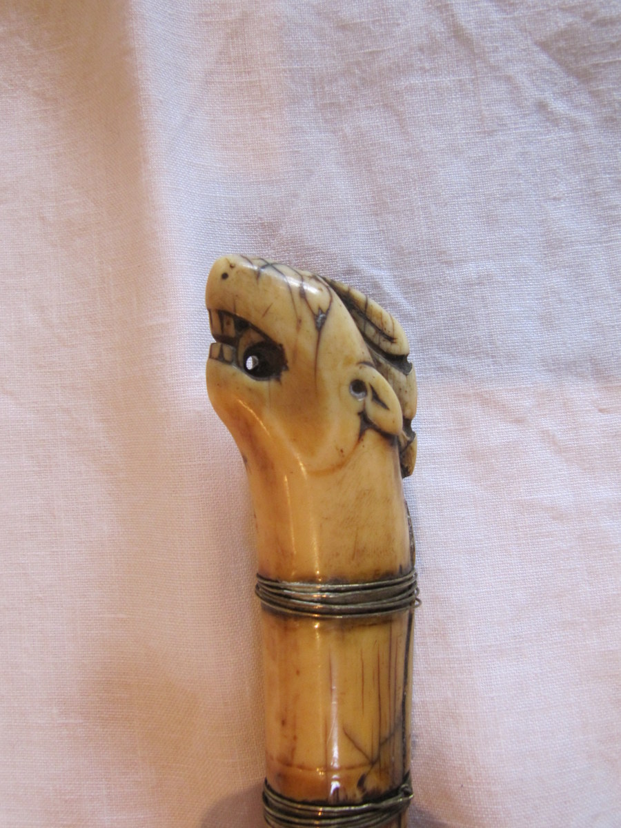

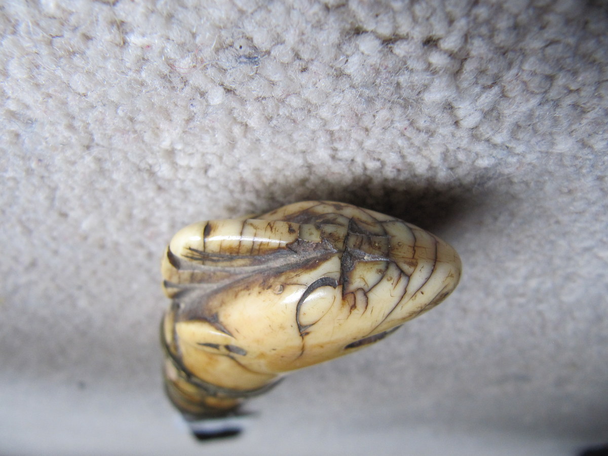

Here are a few more photos. of the hilt

Wow, those are some impressive pics! As good as it gets without having the piece in hand. The concentric age cracks visible on the end of the pommel do look mighty like those of elephant ivory.
Try having a really good look at the pommel end in good clear daylight. Does the material have overlapping angular lines like these?:
If so, it's elephant ivory. Those are called Schreger's Lines and only ivory of the proboscidians - elephants, mammoths, mastodons, etc. - show these. If you can't see anything like this, my vote is back on some kind of bone.
Super nice piece regardless! The figural hilt reminds me of the lion/Makara hilt of the Sri Lankan Kastane as discussed over in this very awesome thread: http://www.vikingsword.com/vb/showthread.php?t=14998 - however, I'd be surprised if that was anything but mere coincidence.
Congratulations on the score and may you enjoy it in good health!
Best wishes, - Thor

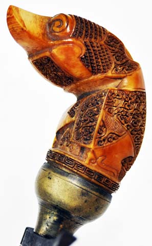

Old 31st October 2012, 08:14 PM   #10
Here is a picture from an old thread of a Palembang hilt made from dugong ivory.

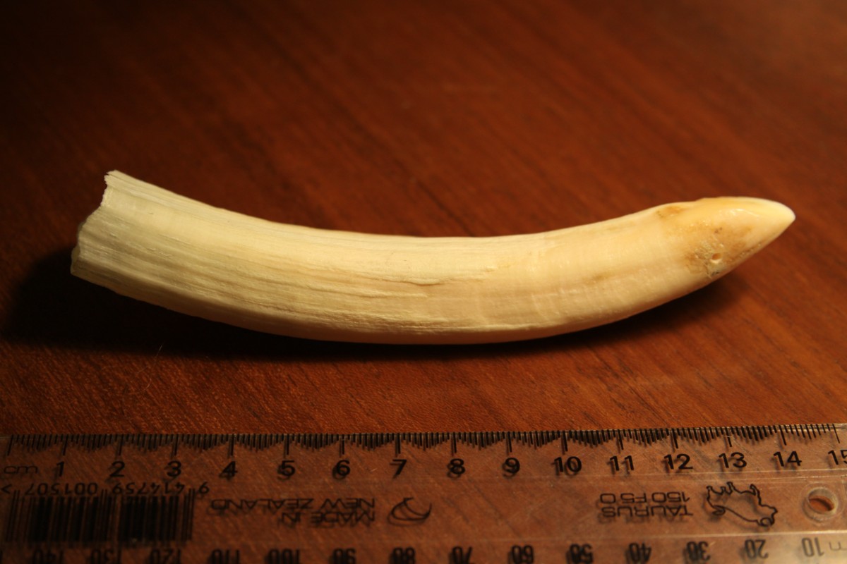

Thank you very much to all who have commented on this - it has been most interesting and helpful.
There are no black dots in the black lines, so I think we can safely exclude hippo ivory as the materail of the hilt.
Loedjoe is offline   Reply With Quote
