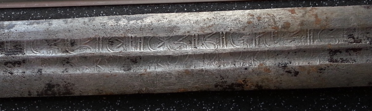

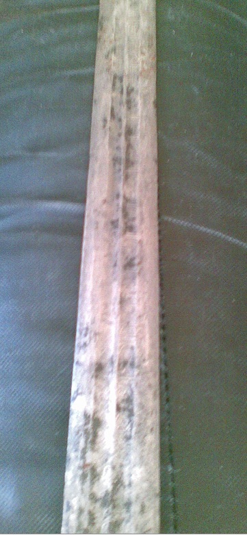

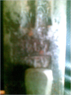

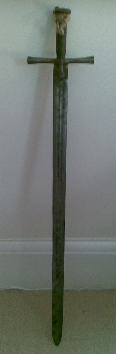

Hello everyone and a thanks in advance for any advice to a first time poster.
I bought the kaskara shown in the photos in the late 1980s and after coming across this forum thought that someone may be able to provide some detailed info on it.
Underneath the tang the number 557 is stamped in arabic numerals within a rectangular indentation. The number might be 857 or 357, and this photo shows it from the right hand side where i believe you can see the last two numbers, five and seven.
Two fullers running about 80% length of the blade. The text within them is raised (i assume this isnt done bas relief so was wondering how). The text repeats only a few characters over and over, those being 'II' 'I' and combinations of a paranthses and greater/lesser than symbols, for example (> or >). I do not know how clear that has come across in the photos and am not sure my unsteady hands will allow much better, but obviously willing to try on request.
I am a professional medievalists (my website is medievalstudies.co.uk) and am under no illusion about the origins of this kaskara, but what a strong, sharp, well made thing it is. I told Lee upon joining, this is the closest I'm likely to come to owning a medieval long sword!

Hi Randall,
Welcome to the forum, and thank you so much for posting a kaskara! As you have noted, there are of course distinct similarities to these broadswords of the Sudan and those of medieval Europe. Actually many 'medieval' broadswords have been created using old kaskara blades brought back from the campaigns in the Sudan over a hundred years ago, as described by Ewart Oakeshott in some of his works. Though there are occasionally European blades found in the actual examples in North Africa, most are trade blades from Germany of early 19th century to about 1870s.
I hope you can try to get more detailed photos, especially of the markings on this example. You have amazing patience having had this sword since the 1980s!!! my curiosity would have had the best of me the next day!!!
I do think that what you have is a most interesting example in that the fullering seems of more desirable type of these blades of latter 19th century form, and these markings are intriguing.
Thank you for joining us, and look forward to more pics!

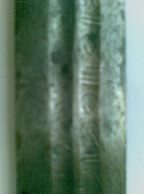

I've tried again but that's the limit with my phone's camera, it just wont focus any more clearly at that distance. The scripts run the full lengths of both fullers on both sides of the blade. It is hard to tell if it is a full arabic script as some of it is covered by corrosion and much is worn down. I can never be certain that I am seeing a more varied script than a few symbols because much is covered by corrosion, much is worn smooth and various pits and disfigurements in the metal blend in with the script.
I am infatuated with it, but only had Stone available to me at the time in Oklahoma. When I moved to England in the 1990s i was able to focus on medieval armaments and never cared to know more about this until now. Nineteenth/twentieth century Sudanese was enough for me even though I was working in collaboration with the Royal Amouries and they offered to look at it for me! i dont think I wanted to share it, it was mine all mine, until now

Welcome on board "randallstorey"
too kind from you, if you offer us, other photos taken with "focus"
your signs > and > could be a digits ... 7 and 8 ...
also, you've to take in consideration, that Sudan is particularly affected with the talismanic effect, as many other Muslim countries
these signs might be to conjure the evil eye
if I've pics with better resolution, I should be more formal
best regards

Hi Randall,
Having browsed your website in the past - very nice to have you here! Better photos will certainly help (try some pictures in daylight and outside, it should reduce the blur and shake issues) but I’ll try to add a few comments for a start.
This appears to be a very good quality kaskara with a European blade – the hilt with the flared tips is typical of older mounts. The most interesting aspect of the sword is the blade – two fullers is not typical for kaskara blades or European trade blades found in them. Usually three small fullers or one large fuller are encountered.
The only blades close to the region I can think off that feature this configuration are some Ethiopian saifs with imported blades. What is the length of your blade and is there a ricasso? The Ethiopian blades often feature extensive floral patterns in the same raised style you are describing.
Looking forward to more photos and helping to solve what this blade is and where it came from!

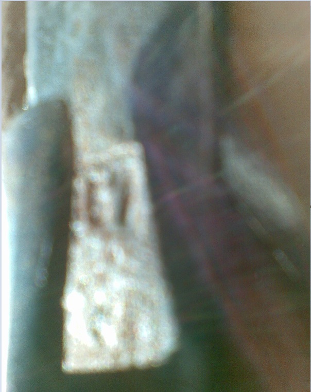

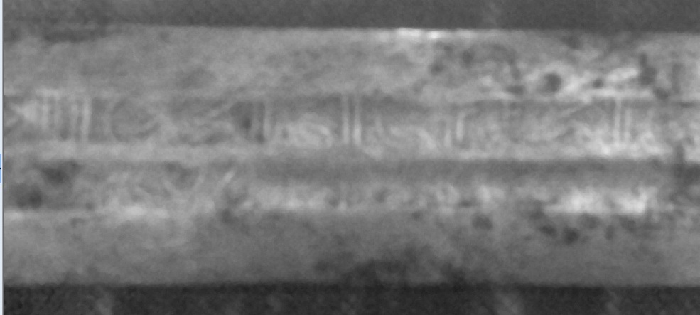

A more accurate description of the blade is
835mm long
39mm at widest point before tapering slightly near shoulders
fullers each 6mm wide and extend 560mm beginning 60mm down from the guard ricasso both sides of the blade extending 140-145mm.
I've included two more photos, one shows the 857 stamped near the shoulders but not obscured by the crossguard this time.
The other I hope is a better shot of the script. I had a professor of mine who studied Near East ancient history at Harvard take a look at it long ago and he too thought the script as such was glyphs and/or abbreviations which he did not recognised based on the limited number of characters throughout and the short patterns of repeating these characters interspersed frequently with vertical lines (ie the 'I' and 'II'), the latter I do not know if they are indeed characters, punctuation or decoration.
I was not hoping for anyone to try to decipher the script I was more hoping that someone would recognise its kind, but whatever can be gleaned is appreciated.

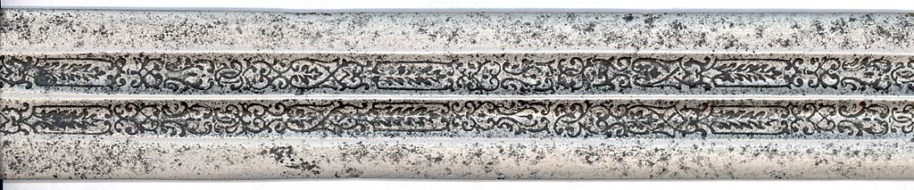

Here is another image of a double fullered Ethiopian blade remounted in a style, I am told, consistent with work from Sanaa (unfortunately, search as I can, I cannot find the thread where this whole sword was discussed).

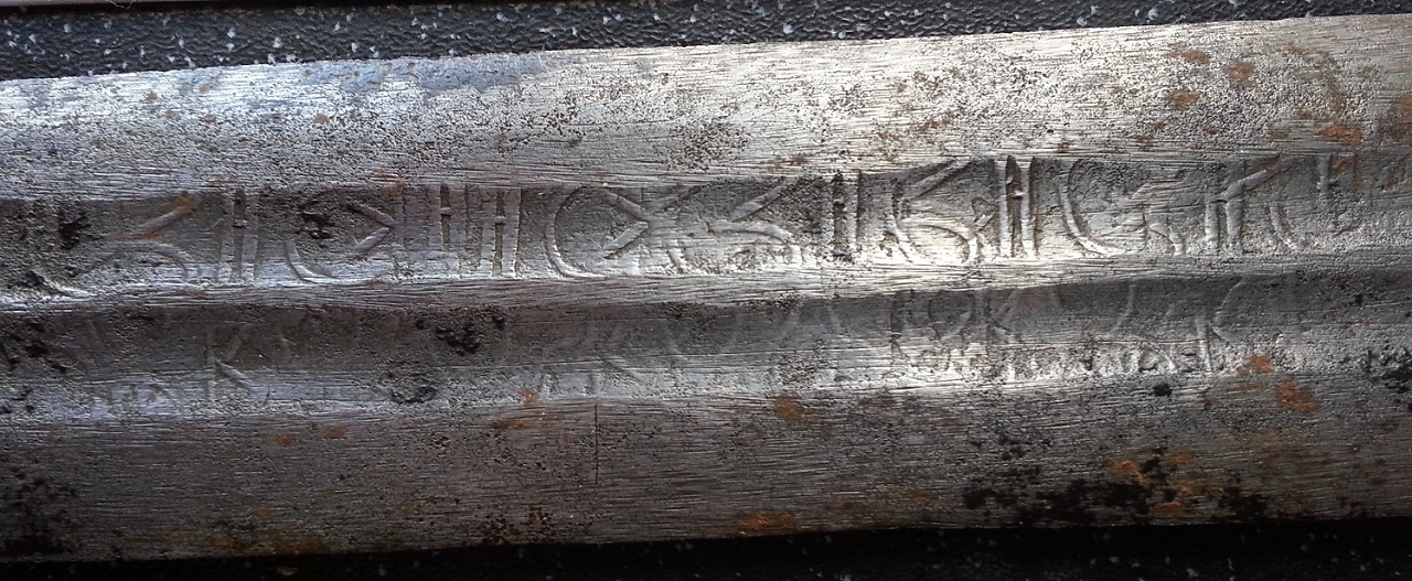

2 high quality photos
randallstorey is offline   Reply With Quote

I think Lee might be on the right track. I have a feeling these marks, which seem to be partly erased, may mean something in Amharic or another Ethiopian language. With a little imagination you can see a similarity to the inscription on this tray. Can anyone confirm this is an Ethiopian language, or even a language at all, and if so what it says?
Many thanks

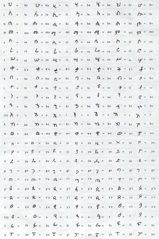

Thanks for these interesting pics
unfortunately, no one Arabic letter has been determinated
I have been to have a look on Ethiopian/Nubian/Eritrean alphabet
the Ge'ez alphabet here attached (but I haven't time to analyse correctly)
has may be (?) some similitudes with the blade's inscriptions
apparently, I didn't saw a single date, even digit ??
I saw nothing, could be attributed to some talismanic practices
anyway, really amazing and gorgeous kaskara
all the best

I am pretty sure now this is at least in the Ge'ez alphabet although I do not have the knowledge to tell you what language.
I can at least make out some of these characters: (if they don't show up here try visiting wikipedia: http://en.wikipedia.org/wiki/Ge'ez_script)
ዘ ፈ ር
Now the real question is... can anyone figure out what language its in?

I very much agree with suggestions to the potential for Ethiopian connection to this blade, perhaps the entire sword as hilted. As has been noted by Lee, there are a number of these kinds of straight blades with double fullers mounted in San'aa which have notable Abyssinian inscriptions and markings.
This blade does not have the usual 'lion of Judah', Star of Solomon or other typically associated markings often with these kinds of motif, but the acid etched script does seem to correspond to Ge'ez or the alphabetic variations in the numerous dialects in Ethiopia.
I think that we must consider this etched application much in the way we do the heavily decorative thuluth motif on Mahdist period weapons. If I understand correctly, this is often repeated and interlaced using alphabetic characters which may have some distinct and intelligible meaning in the core of the inscription. These inscriptions were often applied by workers who were not necessarily literate, or non speakers of the language, so may have been applied in a rather artistic interpretation. I think that is why many of the thuluth inscribed weapons and items may not lend to literal translation, as many items whose motif is based on these kinds of script, and may well be the case here.
We know the kaskara was widely used outside the Sudan, into Eritrea and Ethiopia, so certainly this may be an example from these regions as well as possibly from tribal groups within any of them. As far as accomplishing a literal translation or identification of distinct alphabet, I am not sure it will be possible as this may be simply artistically applied motif based on one or a number of dialectic characters.

Just discovered that the numbers in cartouche are probably item numbers in contract lot. Apparantly Luckhaus & Gunther numbered thier blades at the forte around 1895-1900 though not in cartouche. I found notes with a pair of Cuban machete type blades with two close numbers, otherwise identical, suggesting being of the same lot. As Solingen was producing blades for a variety of markets in these times, perhaps this suggests this practice was being used by the firms in fulfilling blade contracts. As previously noted blades of these types were being supplied to Abyssinia at this time for straight blade shotels, and these often ended up rerouted in trade entrepots, so being on a kaskara quite expectable, especially since Eritrea and Ethiopia also used them.

Thanks Jim, that's what I assumed the numbers indicated, and I'm fairly sure there is yet another very faint character or symbol preceding the numbers. Do we have any information on how many blades were produced per consignment? The kaskara in Stone's Glossary is also described as having a three digit number in cartouche as you put it. He thought that it indicated the Islamic year and that an AH was also stamped with the date, which supported his assertion that kaskaras often have medieval blades.

For some much better illustrations of these type blades in kaskaras with Islamic inscriptions a good reference is "Introduction to Islamic Arms", an outstanding book by the late Anthony North.
