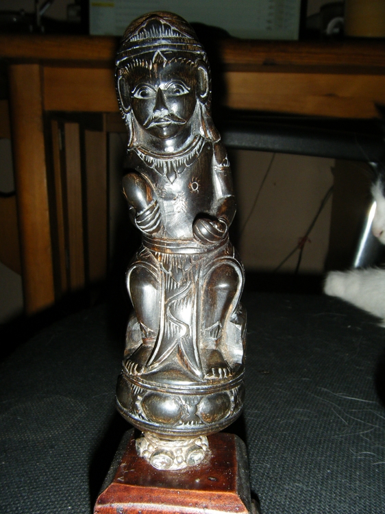

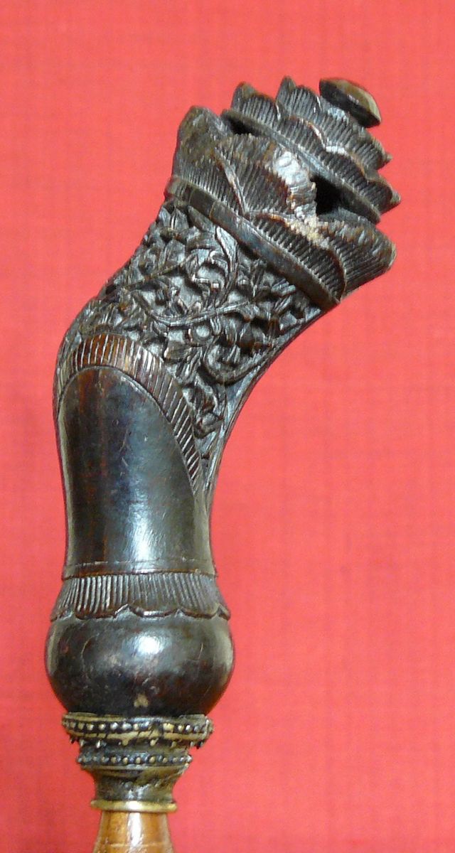

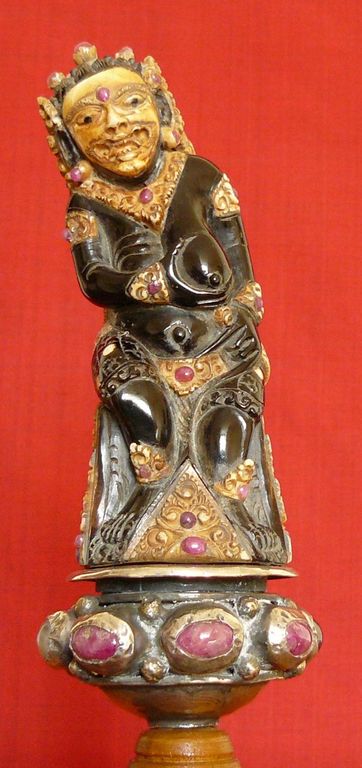

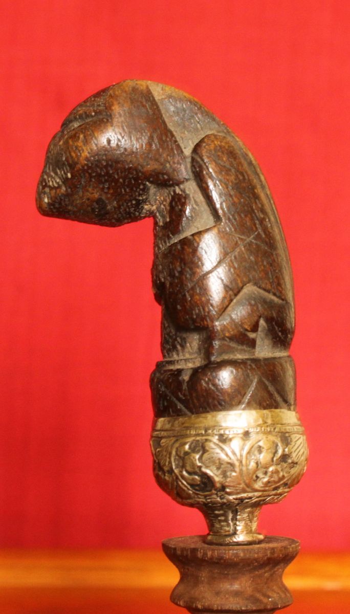

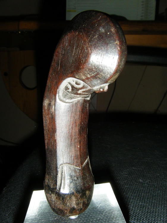

Some examples from my collection.
First two are from Java, third one from Bali, fourth from Sumatra (Minankabau), fitfth from Peninsula and the last again from Sumatra (again Minangkabau).

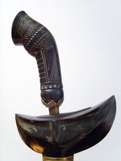

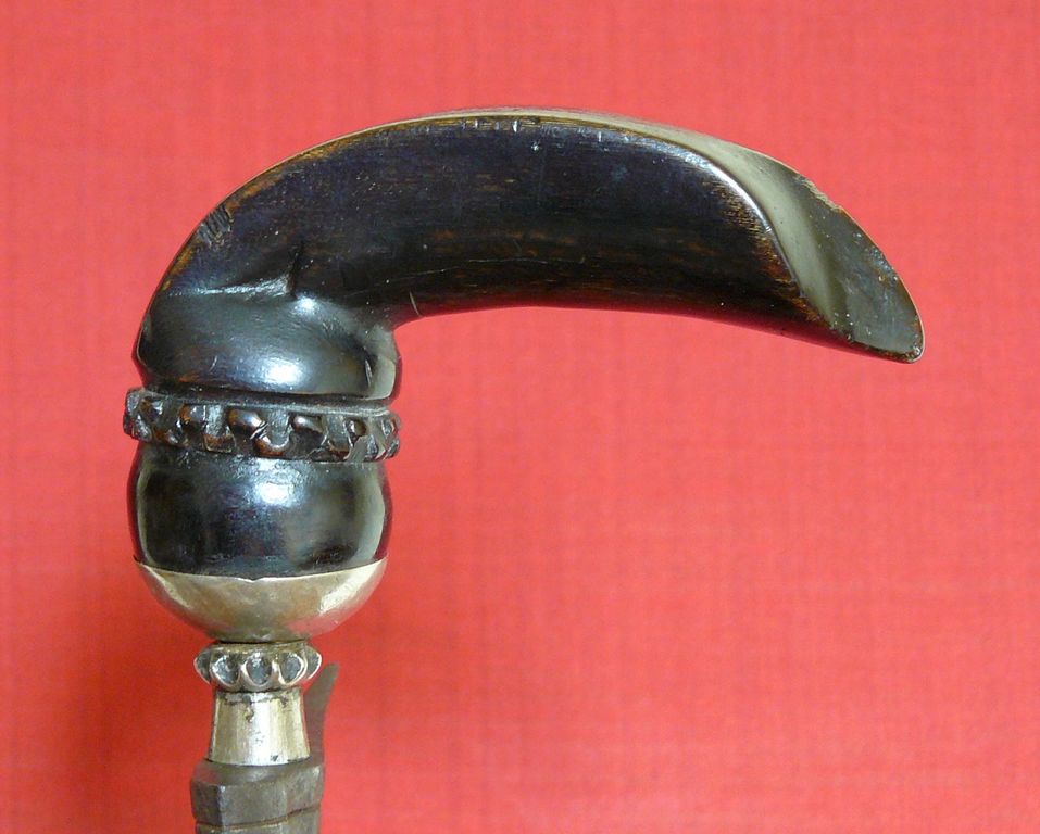

these are also old one's made of buffalo horn
(the Panjang has also the Warangka of horn)

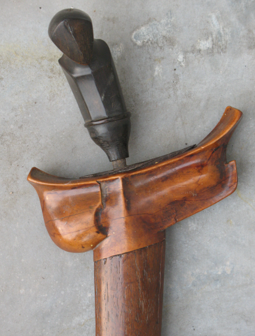

I have this example in my collection.
Willem

Originally Posted by asomotif
Hello Detlef,
Based on these pictures, I would guess the first 2 from java to be wood. (not horn)
Willem
Hello Willem,
I every time was sure about the material but when I look at the pictures I get doubts. Will test them and post the result here.

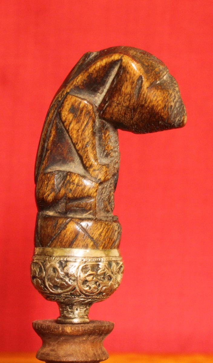

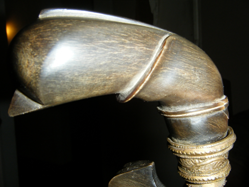

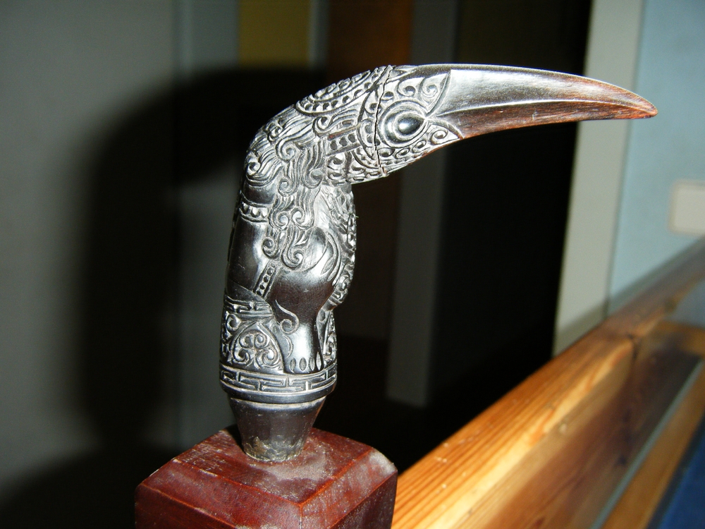

Some of the hilts shown appear recently made.

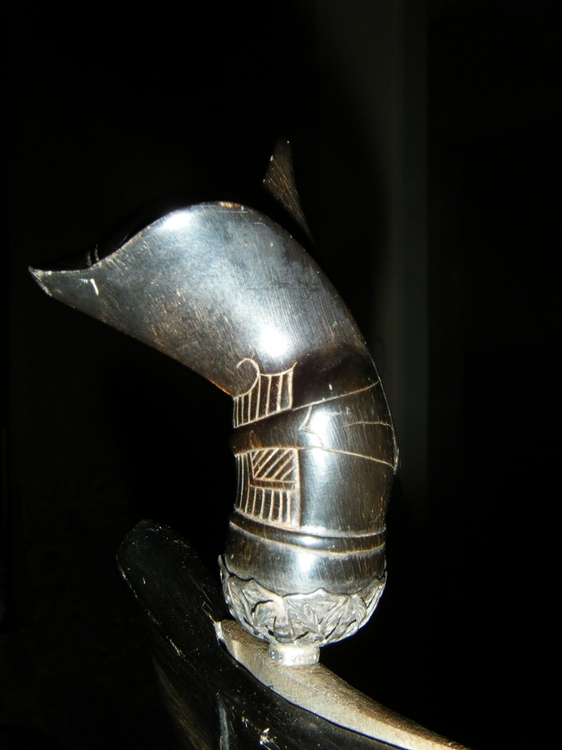

Attached are 3 specimens from my collection and made from black horn, 2 from Sumatra and one from Bali (with ivory inserts).

Willem,
I have tested both Java hilts and both are from horn, I have burned small pieces from the pesi hole and the smell was typical.
Hello Jean,
when you mean amongst others my Bali hilt you are wrong. When I bought it there was still a corroded broken piece of a pesi and hair inside the pesi hole and I need some time to get all out. From outside it have had a lot of dirt patina. Since the hilt is from horn I have cleaned it with water and soap.

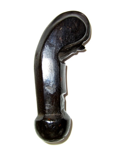

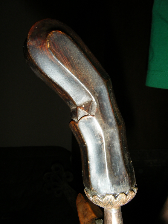

Here a small Lampung hilt set together from two pieces of horn.

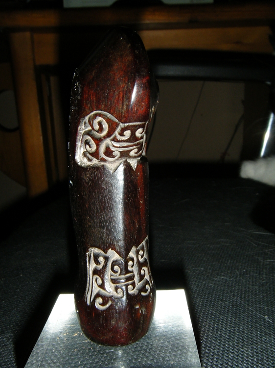

Old 8th May 2012, 01:52 PM   #12
Jean
Join Date: Jun 2009
Posts: 1,740
Originally Posted by Marcokeris
Very very very difficult to find is rhino horn, also shell and coral are difficult but not as rhino

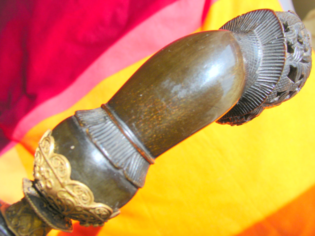

The hilt shown on the picture is deemed to be made from rhino horn but I am not fully sure about it although I am a little familiar with the materials which was also used on old khanjars and jambiyas. I did not perform the pin test but assume that it will be positive (burning smell) but not specific. Any opinion?
Old 8th May 2012, 07:58 PM   #13
Marcokeris
Marcokeris's Avatar
Location: Italy
Posts: 928
Jean congraturation you are very lucky! It seems (from the little circles) real rhino!!

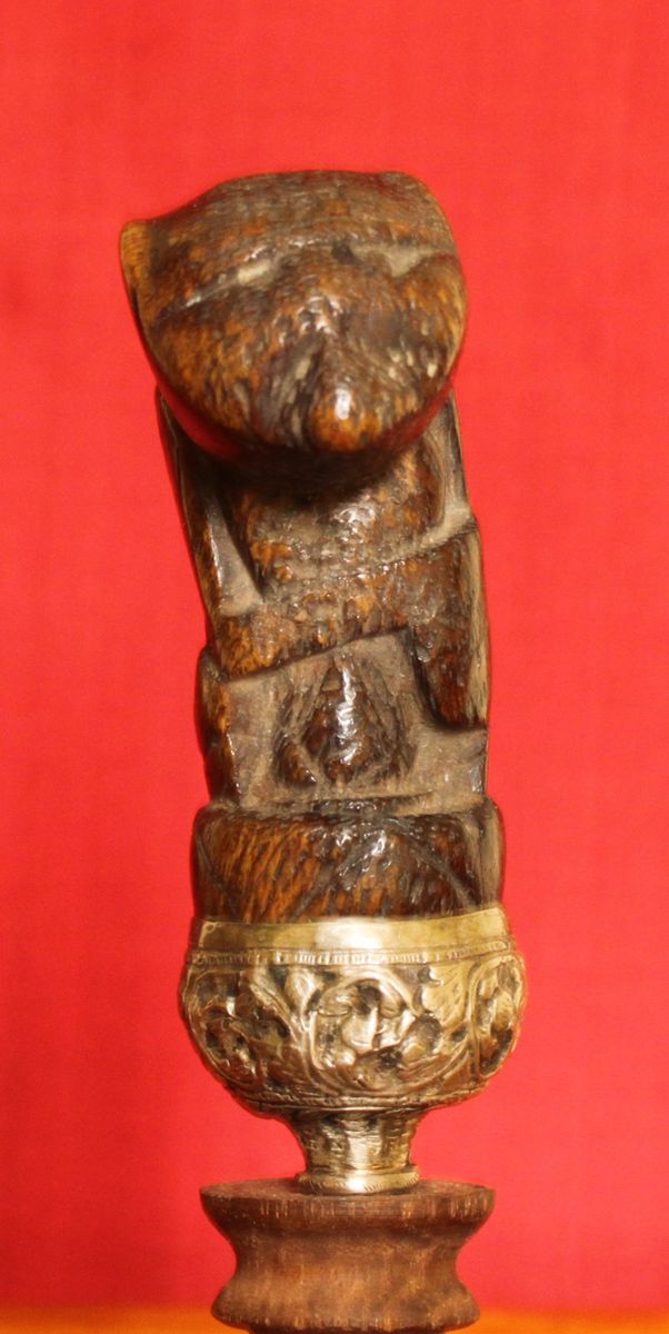

I have been told this is rhino horn, but now I am not convinced.
Any idea ?
Old 10th May 2012, 07:52 PM   #15
Marcokeris
Marcokeris's Avatar
Location: Italy
Posts: 928
Gio your hilt seems to me the same rhino horn material
Old 11th May 2012, 07:27 AM   #16
Gio, we need a close-up of a part where the grain has been cut (preferably close to a right angle) - a top view of the curved part should do.
At the moment, I'd guess it's kerbau or some other "real" horn.
Detlef, the pics are not sharp enough, I'm afraid. If you examine your hilt under magnification, it should be able to verify the material.
Old 11th May 2012, 07:49 AM   #17
Old 11th May 2012, 07:57 AM   #18
Hello Detlef,
Sorry, I meant Jean and the hilt he posted above!
We need to see the endgrain: i. e. the top of the head of Jean's hilt (or the chin area or even the base of the hilt if clean/polished enough).
Easier to examine/see when actually handling a piece. A 10x magnifying glass (jeweller's loupe) does help a lot.

As Kai already explained, identifying rhino is not that simple from pictures.
If I look at Jean's pictures I would guess that it is old worn antler.
Sharper pictures of all angles are helpfull.
Translucity of rhino is also an important aspect.
Willem
Old 11th May 2012, 09:08 AM   #21
Jean
Join Date: Jun 2009
Posts: 1,740
Sharper pictures won't be very helpful but I agree that my hilt could be made from old antler or whale bone from the "dots", see the left side which has a more whitish colour on the surface. The translucence is indeed a specific feature of rhino horn but it is not always visible.
