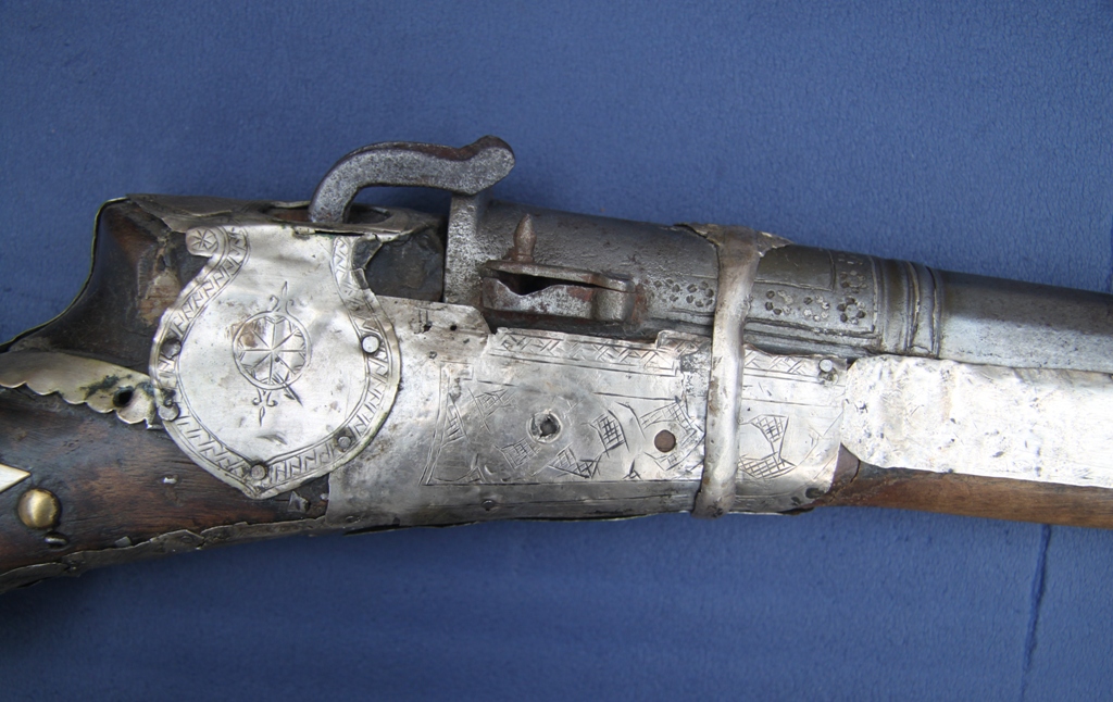

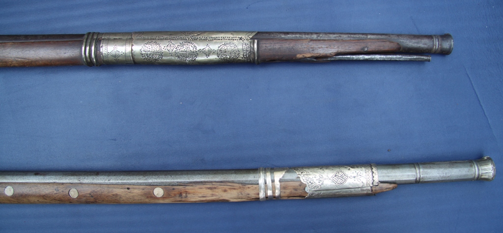

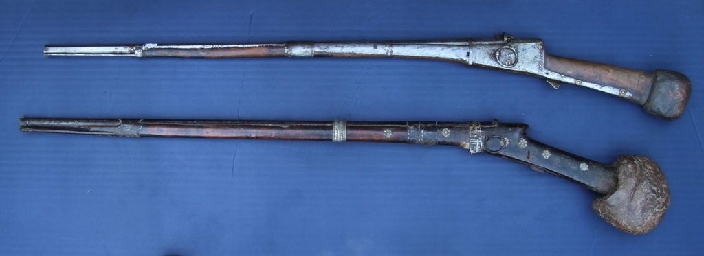

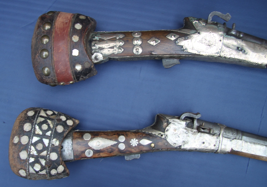

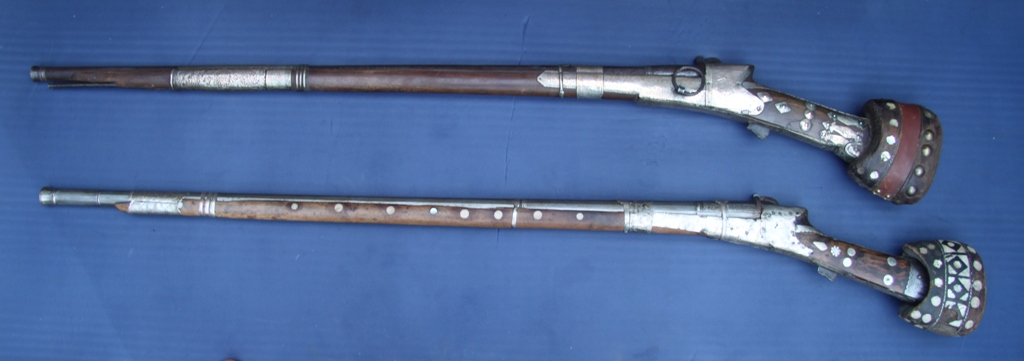

Hi everybody
This is 4 matchlock guns for my collection I guess from INDIA or YEMEN .
I Would like to know more about this guns ,the only information I fond was from Robert Elgood ( Firearms of the Islamic World).
So if somebody could tell me more about this gun it will be nice.
Any comment on it will be welcome.
kind Regards
Cerjak

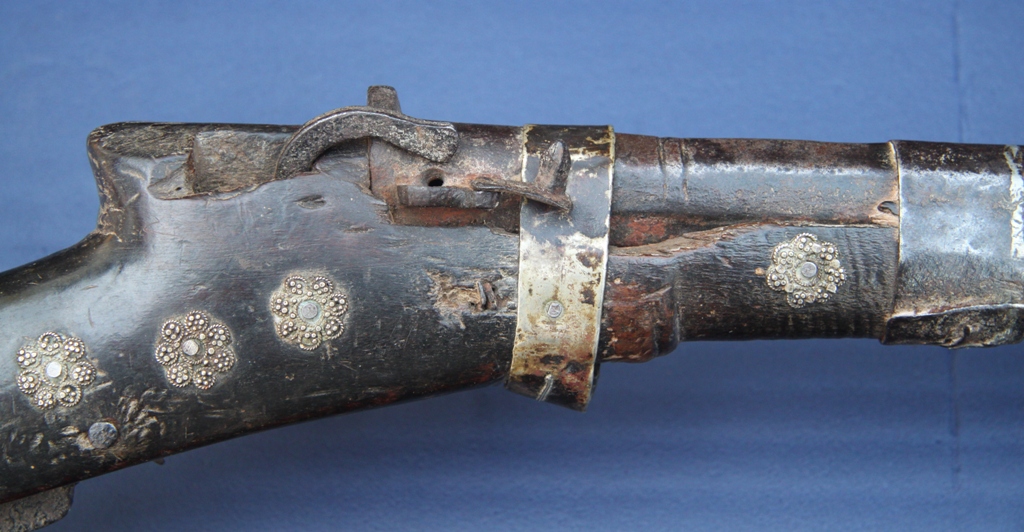

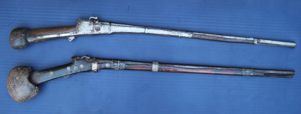

Default new pics
more pics

Nice guns!
I've always assumed these came from the arabian peninsula, so I'd say Yemen rather than India, but more than that I don't know. You can see mine in the post below this on about the Indian battlement gun.
I for one will be watching this thread in the hope that some of the more knowledgable folk will be able to help
Chris

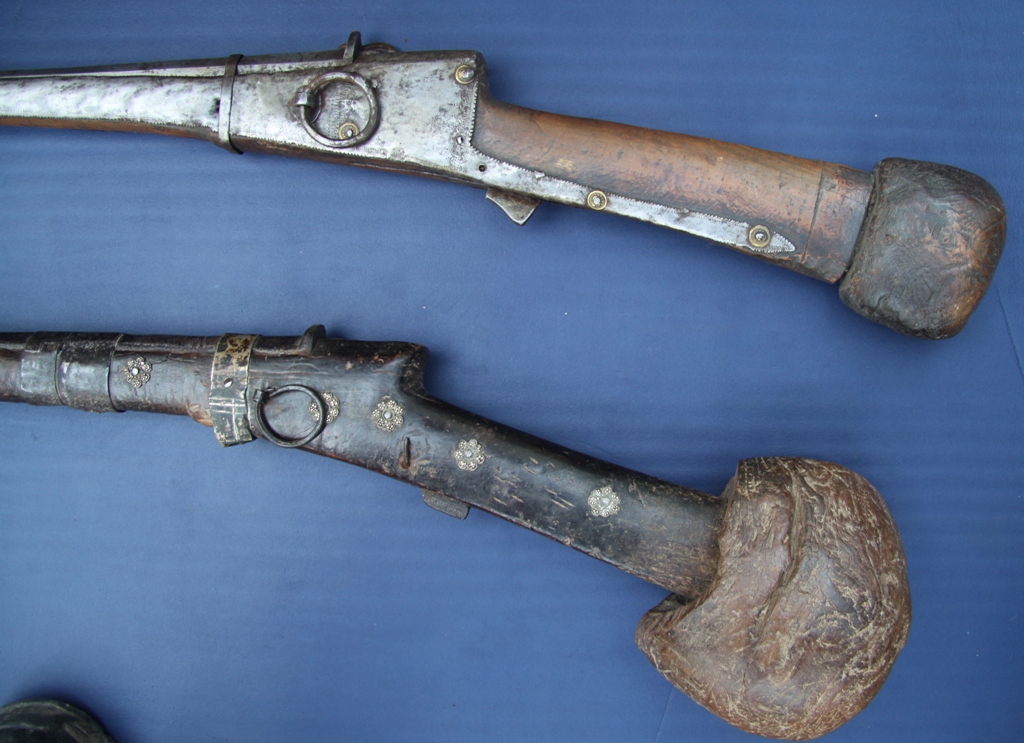

Generaly guns with the padded butt are Arabian, Indian stocks tend to be narrow and of a pentagonal section. Afghan / Sind tend to be the deeply curved hooked style. Personaly I know of no exceptions, though that does not mean there are non.

Very nice, I like this type of Arab matchlock. They are from Yemen (but maybe the barrels were made in India). I had one some years ago, but sold it to my regret now.
If you have any of the travel books by Freya Stark, some are illustrated there. Seemingly they had a heavy recoil, hence the large butt piece.

Thanks for the info guys. Unfortunately I don't have the travel books, but I assume these were used from horseback. They are light by comparison to both the Afghan and Indian guns I have, and slightly shorter, although not carbine length.
The bore diameter of mine is 15mm, not the biggest of my examples by a long way (Sind example is 18mm), but more or less average I'd say.

I agree these guns are associated with Southern Arabia, the enlarged butt is the distinctive feature, but I do not think this necessarily means they were made there. There was much trade and many links with other countries around the Indian Ocean and in particular between the Hadhramaut and Southern India. Many arabs served as mercenaries in the Nizam of Hyderabad's army and there is a particular type of jambiya, often considered to be Yemeni but which I think might well be actually from Hyderabad. I think it quite probable that many of these guns may also have been made in Southern India or Hyderabad for sale to and use by these arabs.
As Colin mentions, Freya Stark's books have pictures of these guns in the Hadhramaut. Wilfred Thesiger's books have pictures of of them in the Tihama and Dhofur. I have also seen Martini-Henry's and Gras' with this type of butt. I have also seen a hybrid with the Indian type of butt David describes.
It would seem to me the decoration on the butts of the second pair of guns suggest more of the Indian influence.

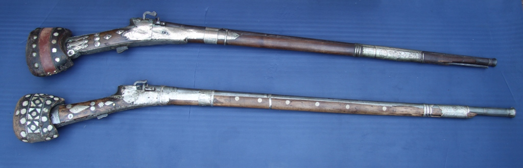

Norman McCormick
Norman McCormick's Avatar
Posts: 1,657

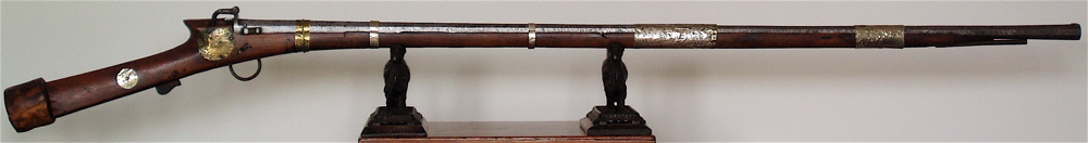

Hi,
My two for comparison. Apologies for the picture quality.
Norman.

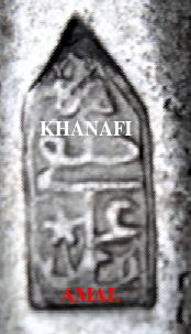

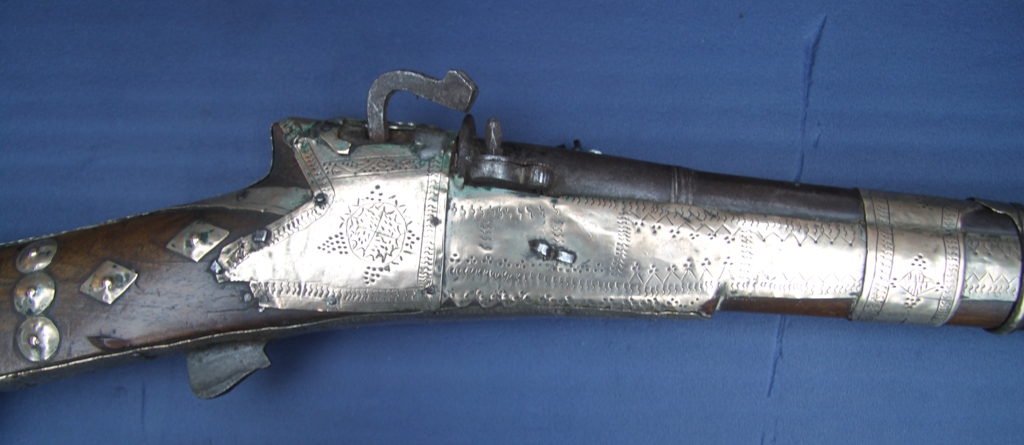

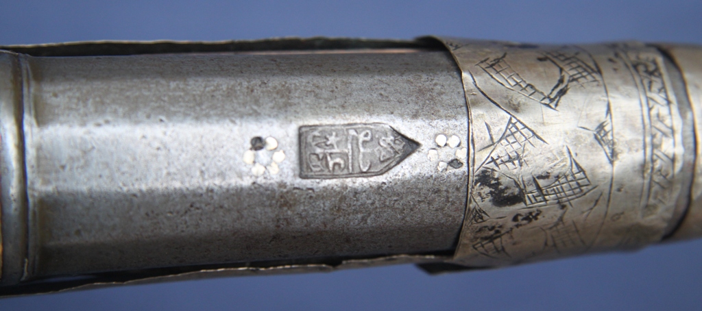

Hi Cerjak
just for the pleasure, even if it wasn't requested
translation mark's , not guaranteed 100%
AMAL - either - MADE BY
KHANAFI - either, just a name
all the best
à +
Dom

Originally Posted by Dom
Hi Cerjak
all the best
à +
Dom
Fantastic Dom ,I was not expect to find the translation
Thank you !
Cerjak
