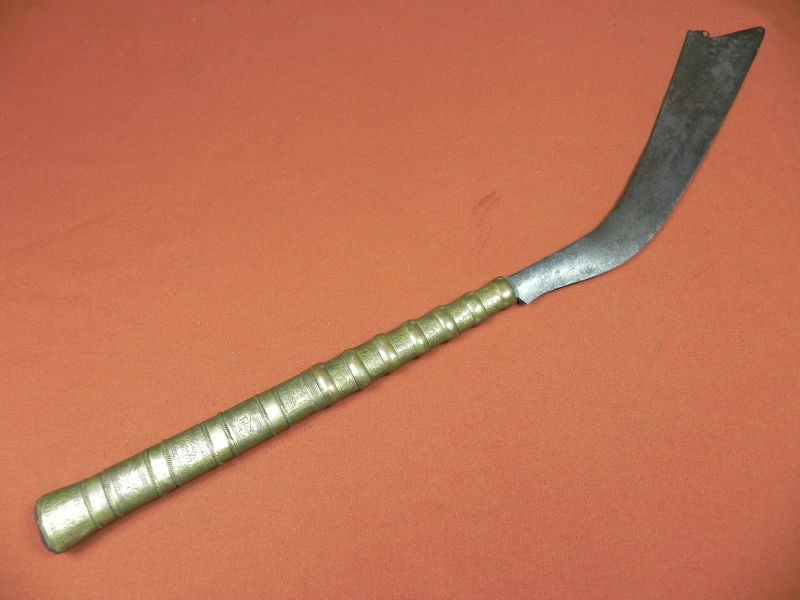

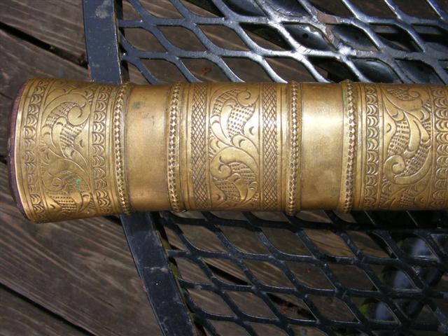

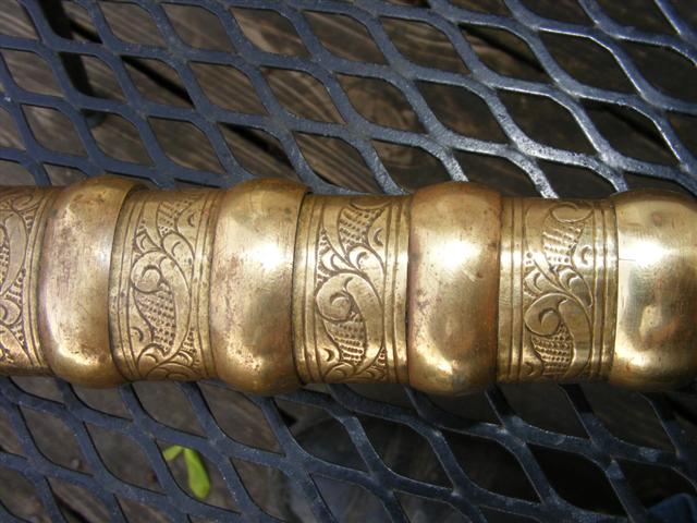

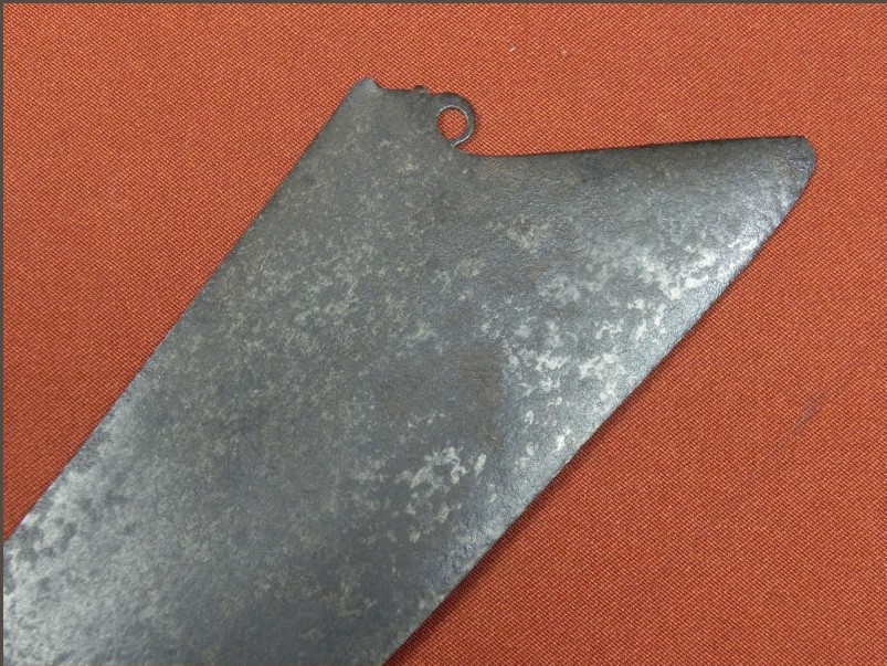

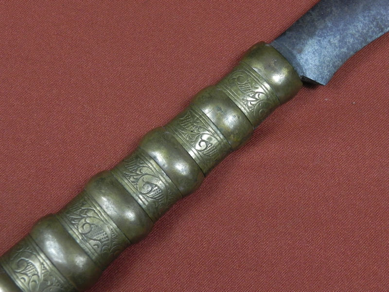

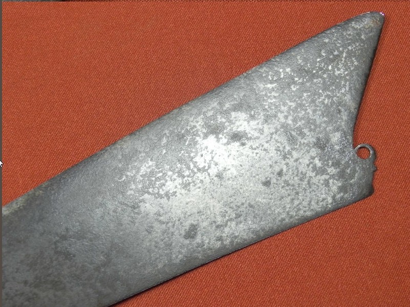

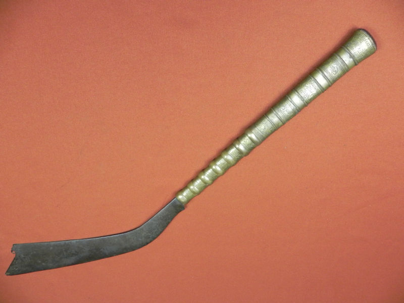

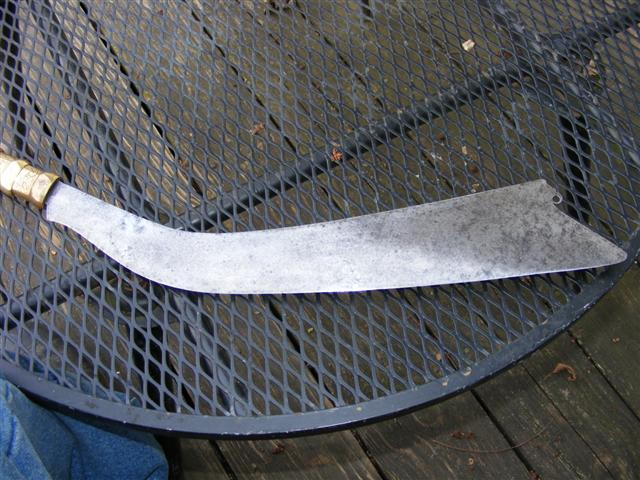

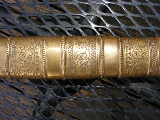

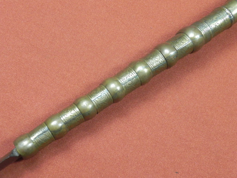

I just received this Maranao Panabas on a trade and would appreciate
your thoughts on it. The overall length is slightly over 32 inches with a blade length of slightly over 16 inches. These measurements were taken in a straight line from the tip of the blade to where it connects to the hilt and then from there to the end of the hilt. Heavy brass bands hold the blade tight with decorative brass panels covering most of the wooden hilt/handle. If you look closely, all of the brass panels are slightly different from each other not only in size and width but with slight differences and imperfections in each piece that show that each one was made separately and not just cut from one longer strip of decorated brass banding. Unfortunately one piece of decoration on the very end of the hilt is missing. The wood of the hilt has shrunk from age leaving some of the decorative brass slightly loose. The pictures for some reason do not show the patina on the brass anywhere near as dark as it actually is. All information and thoughts you have on this piece will be greatly appreciated.

Congrats! ...a very attractive piece. I am most curious to see imput on its age, though it clearly is not new or recent.

Hello Charles and thank you for your kind words. I too am most interested in hearing what the experts have to say about the possible age of this most unusual piece as well as any other information that they may offer. I wish that I could get at least one picture that would show the true patina of the brass work.

Nice piece. Hard to determine age on this. I would guess at 1910s to 1920s. It is Maranao in origin (possibly Maguindanao but leaning more Maranao) according to the okir I see in the bands.

Detlef, thank you for your interest and compliments on this. I am sure that you will be able to find one for your own collection soon. As for etching the blade goes, I really haven't decided if I will or just leave it as is.
Jose, thank you very much for your help in dating this item. Do you think that by the way this is decorated that it would have been more of a status piece or possibly a ceremonial item? Again my thanks to everyone for their comments so far.

Certainly it would reflect the status of the datu to whom it ultimately belongs (one of his retainers would actually be holding the piece).

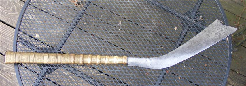

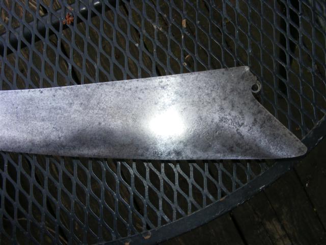

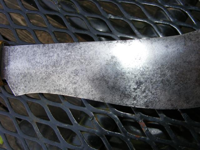

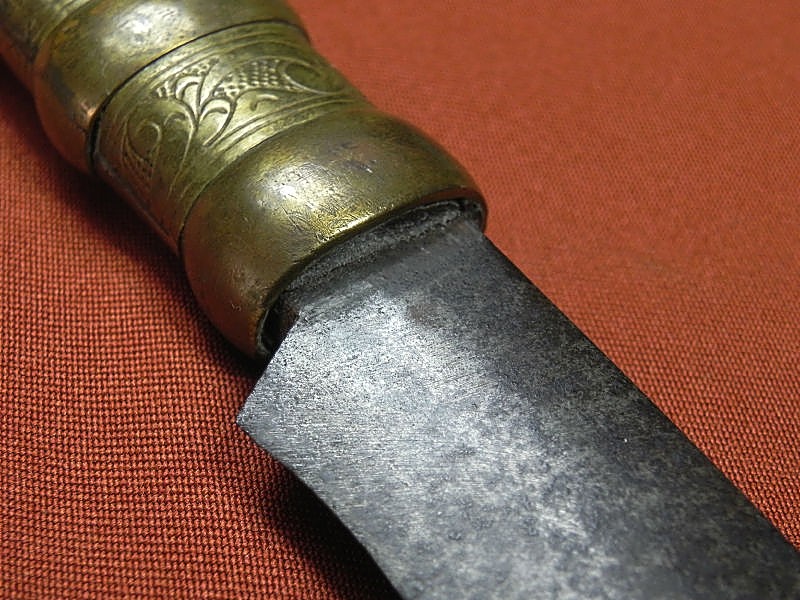

A few new pictures after a little cleaning. I'm not sure if they are any better than the first ones or if the are worse. The brighter part of the brass is from where I was holding on to it when cleaning the rust from the laminated blade. Sorry that I couldn't get better pictures of the blade but it was getting dark when they were being taken and the flash made a mess of things.The brass was just washed off with soapy ammonia and a wet rag.

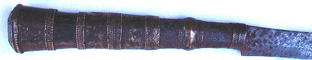

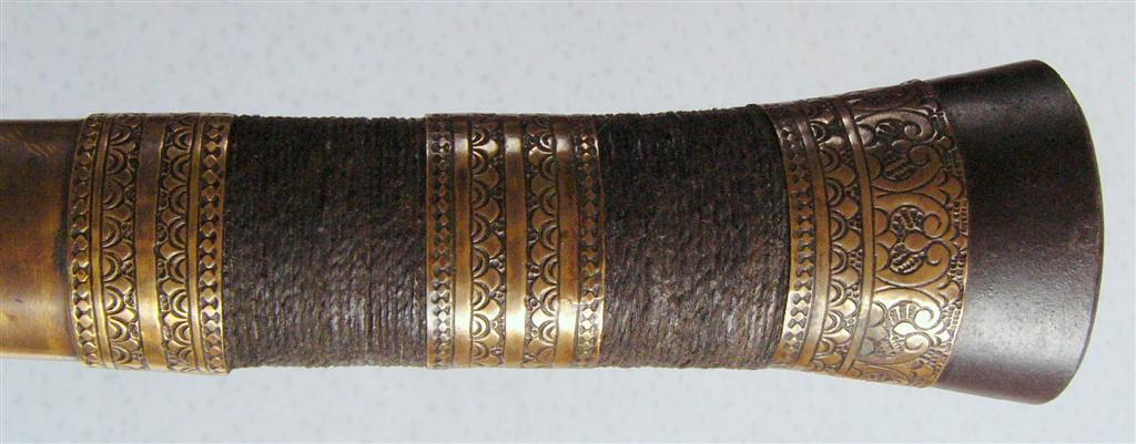

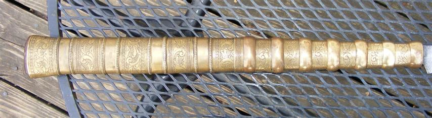

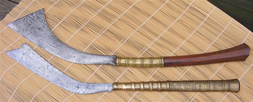

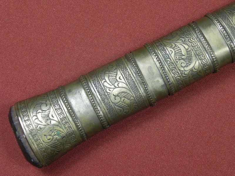

A friend suggested to me that the end of the hilt on this was probably covered by a decorative cap originally. Now after looking at most if not all of the panabas pictures posted on this forum as well as every one I could find on the net I tend to agree. It does looks as though the ones of these that were covered or mostly covered by decorative or even plain panels and bands had a good possibility of the end of the hilt being be capped as well. Below is a picture of the hilt of a panabas that was originally posted by CharlesS (I hope you don't mind) that shows this, while having the same amount of bands (though these are silver where mine are brass) securing the blade to the haft, as well has having decorative panels that look to be very close if not identical to the ones used on mine. Comments on this as well as any other information you can offer would be greatly appreciated. My thanks to those who have commented so far.
Robert
P.S.
I have added a picture of this new panabas with his brother who has been living with my wife and I for a few months now.

Judging from the picture you borrowed from Charles I can see no actual 'cap' on his piece .
I'm not so sure your example is missing anything .
Old 4th April 2012, 04:11 PM   #13
I am with Rick, don't think that there ever have been an endcap.

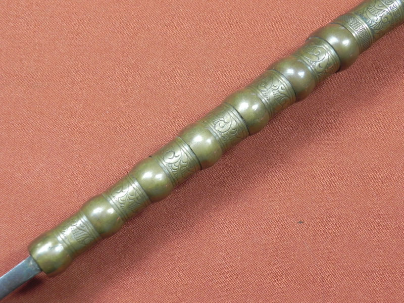

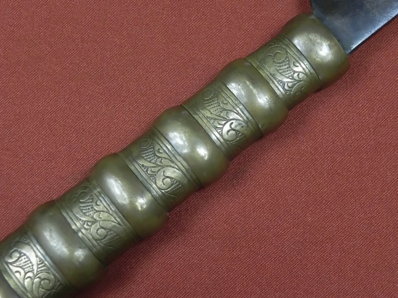

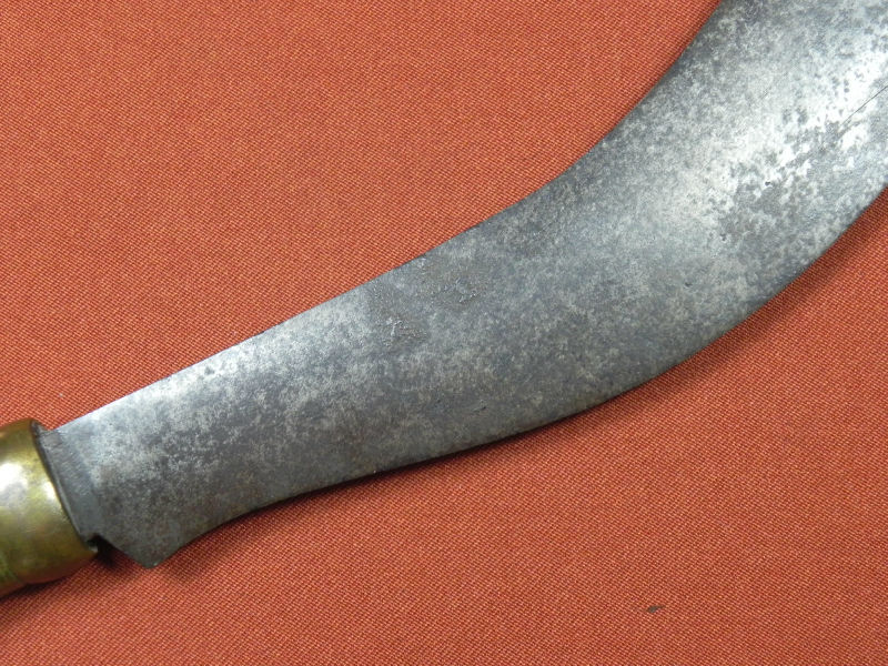

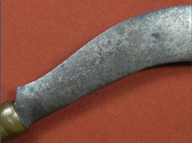

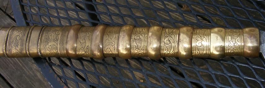

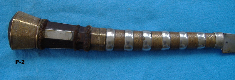

Hello Rick and thank you for your help. The picture I posted of Charles panabas was more for the comparison of the okir on the panels and the number of bands being used. There are more pictures of ones that look to have the end of the hilt caped including the two examples below. The first one is Bill M's and looks to have an iron cap and the other is Ian's and looks to have a brass cap. Again I hope that no one minds my using their pictures. On my example the last panel on the end of the hilt definitely shows a broken solder seam that makes me think that a piece is missing. Seeing that none of the other bands and panels look to have ever been soldered together at any point, it would indicate to me that it could have had either another of the narrow bands with the raised dots or a combination of that and a cap that would have covered the end of the hilt. This of course is all just speculation on my part.
