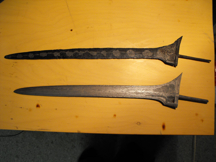

I hope you can help me out with 2 of my other wilah's, in total i have 8 wilah's without a sheath, but i shall post them by the two.
The one on the top is i think pamor rante, but thats all i know about it, the blade is very thin, the blade is without the pesi 40 cm.
The one below puzzles me the most, my first thought was that it's factory made, it is a heavy wilah with a thick pesi, the blade is without the pesi 37 cm.
The most importance for me is to know if the are worth it to make a new sheath, and what kind of sheath(area they come from).

The heavy and sturdy # 2 keris could be tangguh Tuban. maybe a warangan treatment would suffice its true worthiness of a new sheath, or at least a secondhand keris sheath.

I suspect that with a warangan treatment you will discover that the second blade has a very nice pamor wengkon pattern. Looks like a nice keris to me.

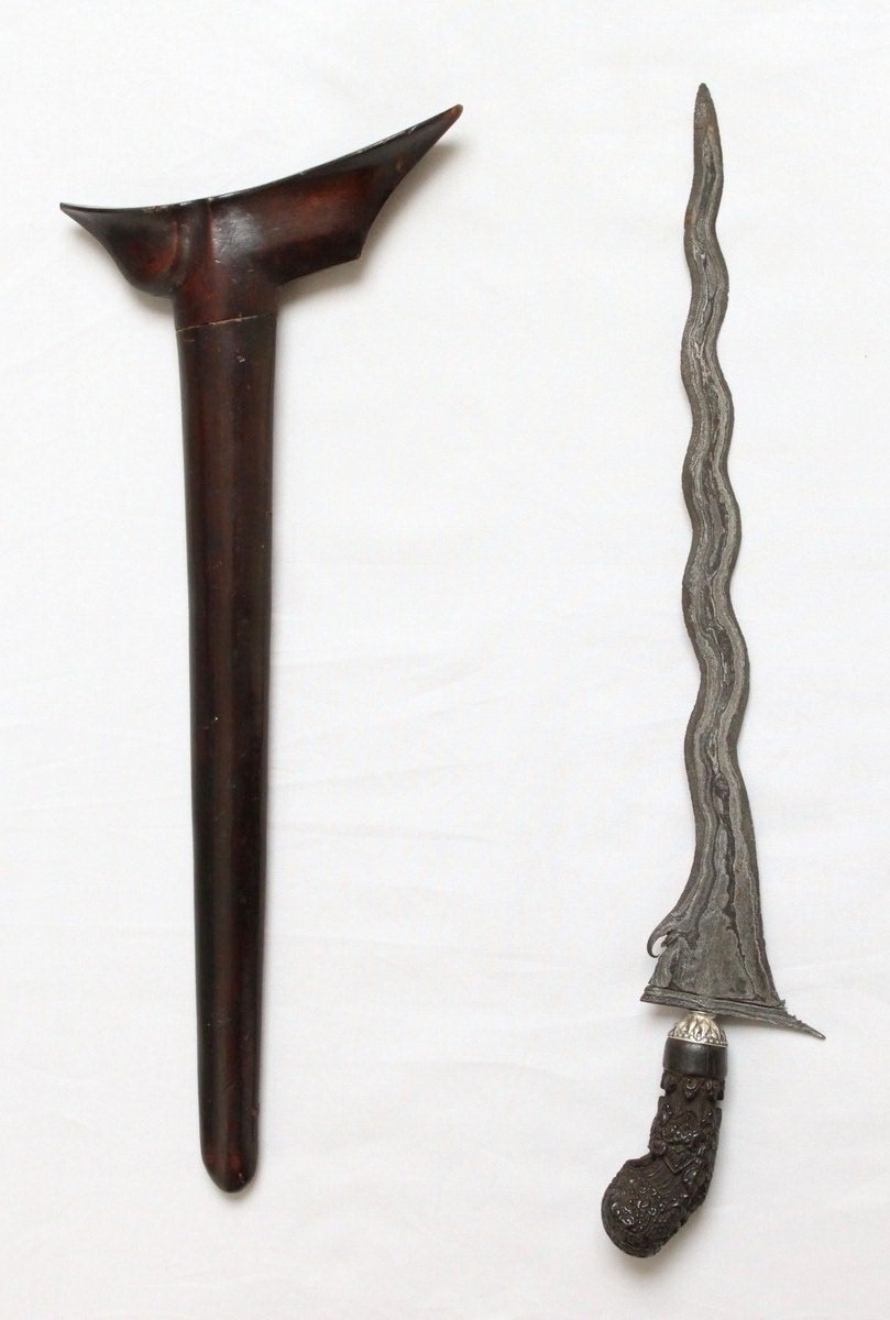

This is approximately how your thick blade should look like after warangan treatment. A sheath in East Java or Central Java style would be convenient.

PenangsangII, i didn't expected it was a good wilah, if it is, for sure i make a new sheath for it.
David, i bought this wilah from a picture, to me was told it was gonjo iras, but it wasn't, and the tikel alis(Ithink thats the name of the comma?) looks like it's done with a dremel, and the overall appearance seems to be to neat/tight.
And on top of the gonjo there is some kind of a marking, 3 lines in a V shape, but i see that i judged to quickly.
Jean, that is a beautiful keris, i have once tried to wash mine, but with no good result so i cleaned it, i hope when i get it right it looks somehow like yours.
And the one on top guys, or is that impossible to tell from a picture?

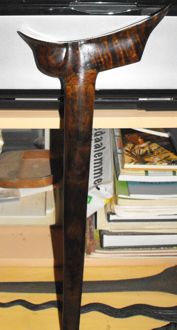

I also have this sheath, and i don't know where it's coming from.

AFAIK this style of sheath is from Cirebon/ Northern Java, see attached picture.

The sheath & hilt of my kris were made quite recently (not later than 1995) but by a master craftsman indeed. Regarding the blade, the dapur is not Tilam Upih but Brojol (no tikel alis), it is not a fantastic piece but a strong one with some age.

Thank you Jean, that mystery is solved, for me it was, you guys are of the greatest help!

agree with Jean that your sheath is from Cirebon/North Java. BTW a very very nice one!

Harley, I'm only going to endorse what has already been said:- both blades are old, both are well worth the effort of redressing.
However, in my opinion, neither are worth putting a lot of money into. If I had these blades they would be dressed in Solo gayaman.
