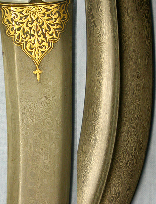

Yes Lew, you are right, the blade is pattern welded.
The attached picture shows – to the left pattern welded and to the right wootz.
Jens

Sorry my former post seem to have been placed wrongly.
Jens
