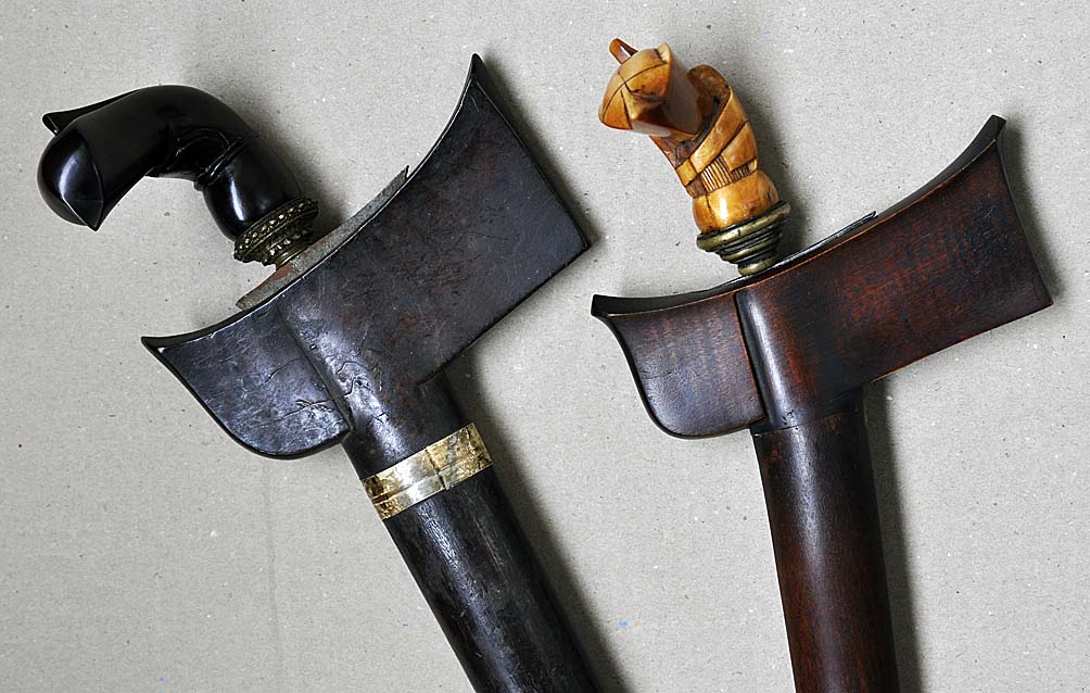

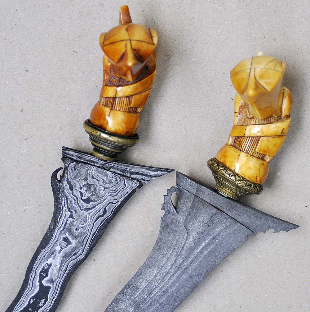

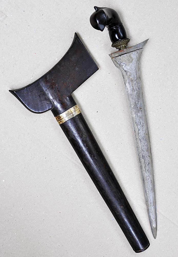

Really want to know, whether these are of Riau-Bugis kerises and hilts. The two hilts are of "gigi duyung" (dugong tusk) with certain sign of (according to one of my Bugis mentor) "temu ure" along the hilts. I can't even explain, what "temu ure" is, and what is the philosophy on the "ure" (or "urat" in Bahasa Indonesia)...

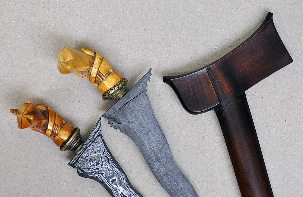

Riau-Bugis kerises and hilts, with the warangka...

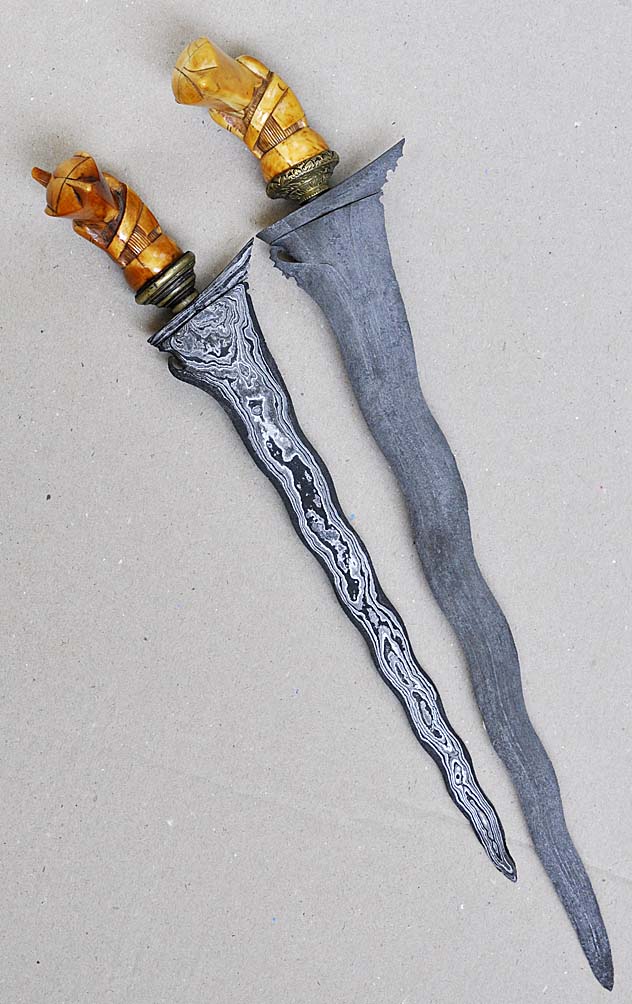

And this is the overall view of the two blades...

Hello Ganja,
this could be Peninsula keris as well, look here: http://www.vikingsword.com/vb/showth...ight=peninsula
The "temu ure" are the small black dots along a line which are normally typical for hippo ivory which I think to see at your both hilts as well so I think that it isn't ivory from dugong but from hippo.
Others with more knowledge than I am will be able to tell you more about the origin of this both nice keris. Do they have both a sarung? Can you post pictures when they are inside?

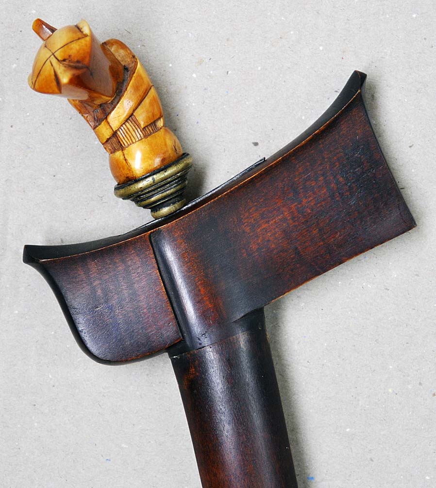

Not changed yet, since acquired couple months ago... The "malela" one, has no warangka. I acquired it, just blade and hilt only...

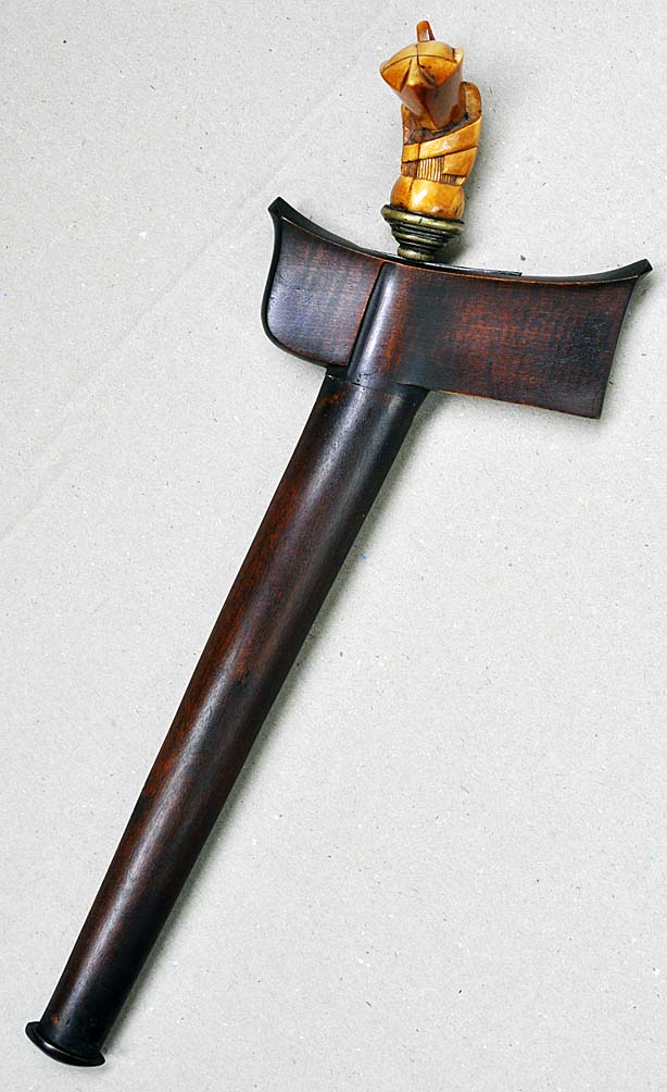

And the whole warangka with blade and hilt...

And with another Sulawesi Bugis, newly acquired couple while ago...

This newly acquired Bugis has no 'buntut'...
Very nice keris in my opinion. The wood seems to have a nice grain but not good to seen under the dark paint. Do you have thought about to give it a new appearance? Look for example in the thread I have given before.
I've been told by Adni of the Malay Art Gallery that the wood wrangkas of Sulawesi keris were often traditionally stained dark. I would advise against removing the stain, unless you are certain it was a change made to the wrangka outside of the original culture.

Malay and Bugis keris are a bit outside my special area of knowledge, but I have owned a lot of them during my life.
I have noted that sometimes they have been varnished with black varnish, not paint, but a type of varnish that gives a very dark, or black finish.
Others I have had have had a normal brown varnish, but age and neglect had turned this varnish very dark to the point of almost black; these have been brought back to a good finish by polishing with car polish broken down with gum turpentine.

@Detlef, thanks. Recently, I have a new "habitude": heavy-hearted to change the 'original' warangka condition, and let the keris' warangka as it is. Or, change totally with new warangka, and let the 'original' warangka stay as it is... So still no decision on this very black (the Sulawesi Bugis) one. But the first blackish one, I think the former owner had once removed the original black-stained varnish...
@Laowang, thanks for reminding me not to change immediately this blackish stained Bugis warangka. Cleaning it, maybe the best way, or change totally with new warangka, and keep the older warangka as it is...
@Alan, thanks also for the tips. It would be very useful for me to try some practical way to maintain my kerises cleaned. I have some practical way too, to use similar items such as car polish (we call it in Jawa, 'kompon', in green plastic cup, or white plastic for the soft one) to keep warangkas cleaned...

Jimmy, I wouldn't use the car polish approach on everything, only on a piece of wood that has got really dirty deteriorated old varnish on it.
Fine quality furniture oils and waxes are possibly the best thing to maintain an already OK finish with. I grew up surrounded by and working with fine furniture, and I always think of keris dress in the same way as I do any other finely finished piece of wood. The medium you choose to maintain the finish should be selected in accord with the nature of the finish itself. One product does not suit everything.
Prevention is the best medicine, so it is really advisable to not store the keris in the wrongko, but rather in a plastic sleeve, and to store the wrongko in a singap, and the singap in a cupboard or drawer.
