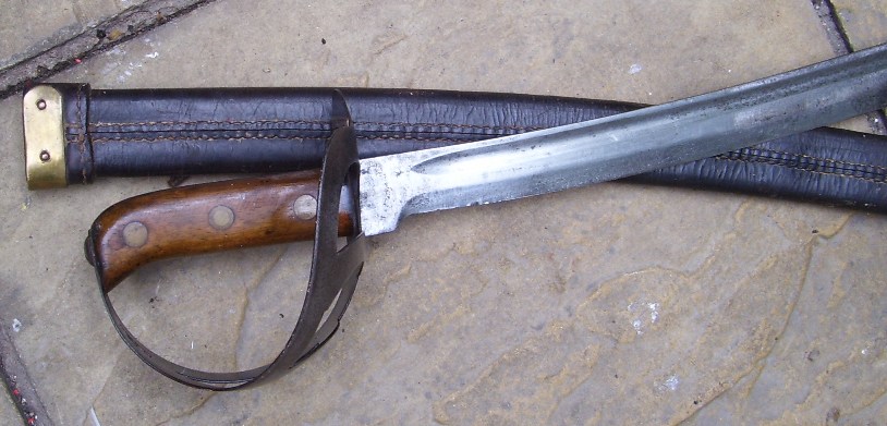

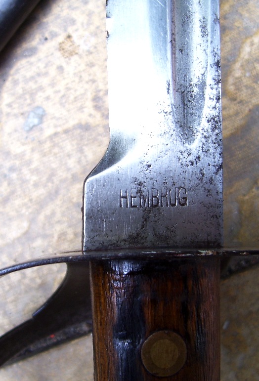

Hi,

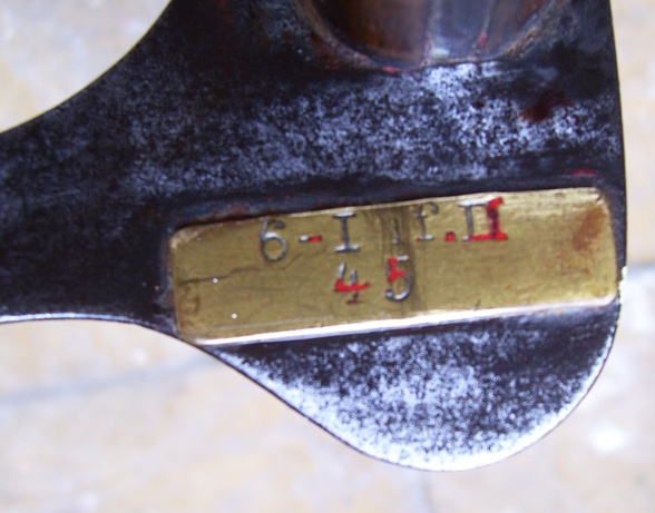

not certain whether to put this on the European forum ....but seeing as this is based on a ethnographic design thought it may be better here. Hemburg Klewang seems to be WW2 issue (brass plate on inner guard is marked....
6-I aF.II
45
Does anyone what this means...I am assuming 45 is the year.

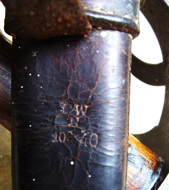

Scabbard is stamped
O (or C) W
I or N (?)
10 40

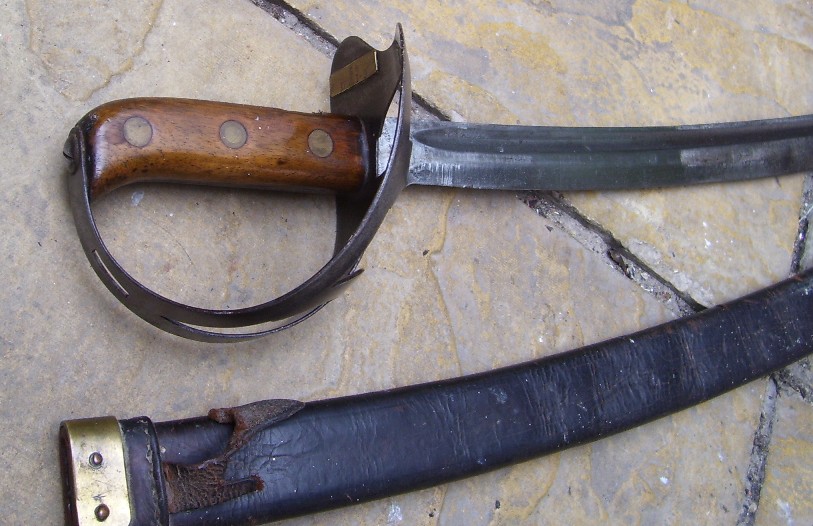

The HEMBRUG stamp seems genuine. On the opposite side of the blade is a crown with a W underneath
any info. or comments greatly appreciated.

I found out that the scabbard marking is ...
"CW" = 1900: Constructie Werkplaatsen Artillerie, Delft (NL)
Leather scabbards were marked by makers ...a scabbard that was damaged would have been returned to the manufacture for repair.

Just discovered the crown and W are inspection marks...
Crown-W : Wiersma - apparently succeeded O (crown-O ended 1898 )and was active through WW1.

Hello David,
Your klewang has been made in the Hembrug factory in Zaandam,Holland.
This one was issued for the Dutch colonial troops in the Dutch East-Indies.
Most likeley the brass stamp says 6-Inf.II and not af (the ink may have been disappeared over the years). If so, this would mean that your klewang was used by the 6th company of the II Infantry Batallion. The number 45 has nothing to do with the year of manufacturing, it's a weaponnumber.
The scabbard is not the original one that was made for it (not uncommon, since leather does not lasts long in the tropics) and was locally made in Bandoeng, Jawa.
CW stands for Centrale Werkplaats, something like ''Central Workingplace''
N stands for Nieuw Model, New Model
10 and 40 stands for the date of manufacturing, October 1940.
These types of klewangs (yours is the m1911) were made from 1911 till 1940.
Hope this helps,
regards Chris

Hi Chris,
great information , thank you very much. Extremely happy with this being colonial . Now to research the 6th company of the II Infantry Batallion ....yes, you are correct, using a magnifying glass the 'a' does look more like an 'n'

Hullo David,
Slight correction: 'N' merely stands for 'nieuw'/new i.e.the date following refers to when the scabbard was made.
'CW' stands for (Artillerie) Constructie Winkel or (Artillery) Construction Shop /Factory. The stamp was originally 'ACW'. The 'W' is also often referred to as 'Werkplaats'/Workplace.
There was a 'Centrale Werktplaats' in Bandoeng, constructed in 1947, but it didn't last long.
